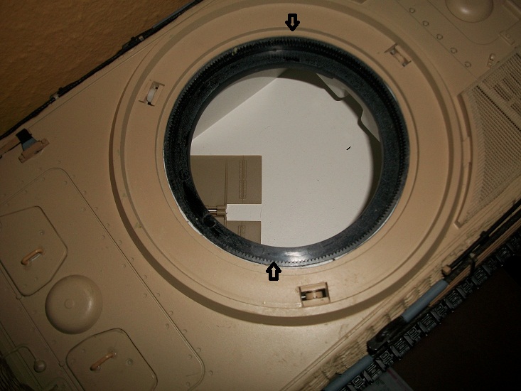

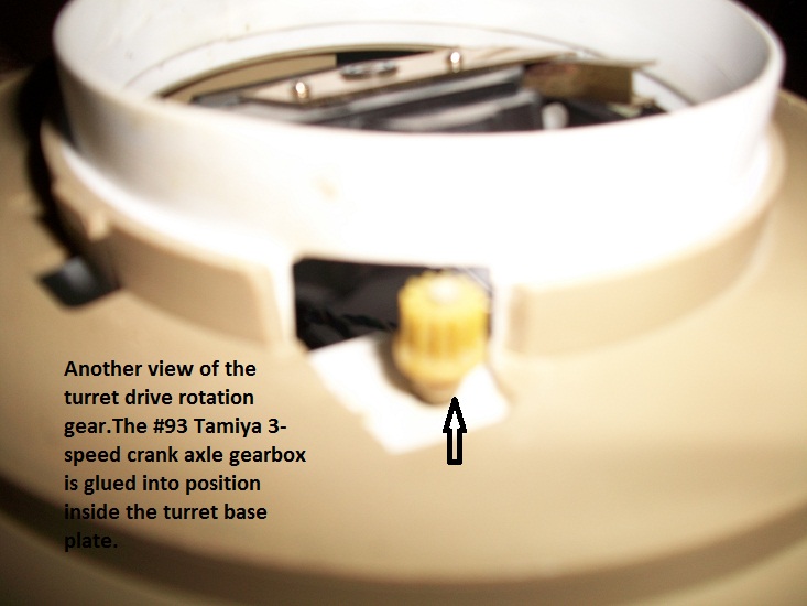

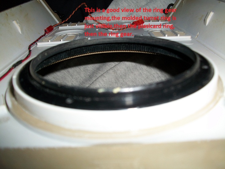

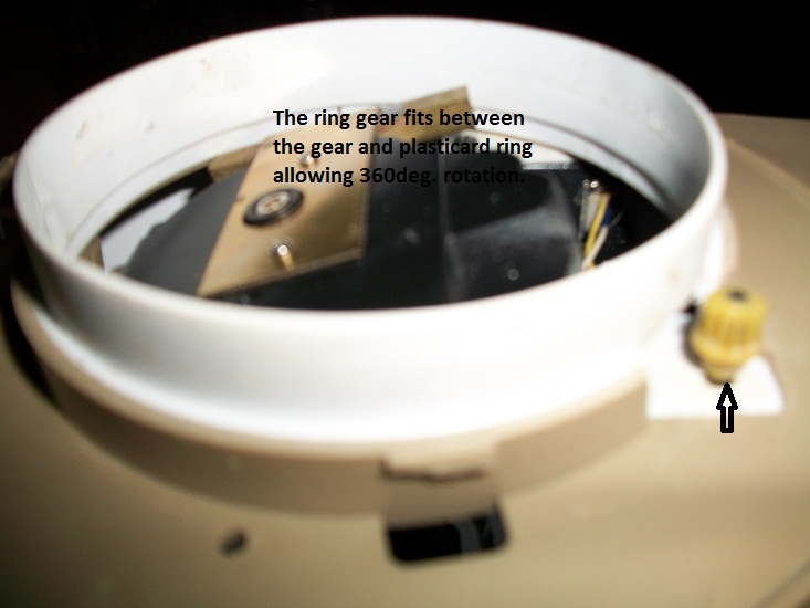

This is a little late to mention,it is a modification by Bubbajoe involving the use of a Panzer four ring gear, and a Tamiya angle gearbox for turret rotation with 360 degree rotation, and turret removal in any position.
The down side,the plasticard ring on the lower turret section has to be a tight fit,otherwise the turret can bounce out of the ring gear.
