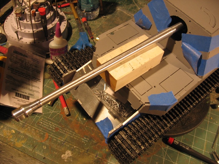

After an hour or so of careful filing..coarse, medium, smooth then emory paper..and repeat...and repeat..until I got the contour I'm happy with for the L71 gun of the Elefant. I takes almost the whole length of the King Tiger tamiya barrel to be accurate.
Now it looks like the one piece unit..

Beautiful workmanship, xrad. It will be something to envy when it's finished.

realy nice cannon, exelent work :O .
i looking forwart to see what is comming next.

Good job Xrad, I have to say very good job with the barrel. Watching this build with interest. Saxondog

thanks Sax! would have been much easier with a lathe..

This I well know as our gun system barrels had to be made, but first the tooling was not available for the line bore. It had to of been a very tedious process for you. Great work, especially considering the patients required.

xrad wrote:started with the barrel:
1/16 king tiger tamiya two part barrel converting into 88mm L71 one piece with some light machining. Of course, i don;t have a nice lathe so luckily, the barrel fits into my drill press chuck. I ground down the thicker stuff on a grinder, then stuck it into the drill press. with gently pressure and a bar file, aluminum comes off easily. Don;t press hard since only one end supported. Don;t get it hot or alu does not file well.
smoothing with coarse emory cloth..then fine cloth.
1/16 Elefant is really good.
You use a drill to two part barrel converting into 88mm L71 one piece , just great!
