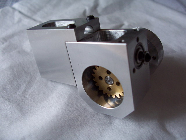

Here is our gearbox,hope you like it...
Gearbox for Tiger I 323#
Yellowshaker
Posts: 432
Joined: Mon Dec 28, 2009 6:34 am
Re: Making a 1/16TH metal tiger I
Post by Yellowshaker »
That gearbox looks serious. Very nice work. Can you tell us how much these tanks will be and when they are goingt o be available?

Nice finishing.
Consider manufacturing some things in common with other systems such as Tamiya or Impact. Gear teeth spacing on drive wheels so we can buy other tracks if needed. Driveshaft diameter/length/flat areas....
Although it is very nice to buy a 'one off' type of tank, I personally enjoy this hobby because I can buy from many vendors and almost all the parts fit together. This allows me to make several variations of the same tank.
Keep up the great work!
971wright
Posts: 2733
Location: nelson Lancashire
Post by 971wright »
Hi Like the gearbox looks like it will handle plenty of torque,I have a question when they become avalable will they be in kit form or ready made?
It As been mentioned but we do like to modifie our tanks,Some like Early Tigers some like late Tigers,You might have to consider this when making after market parts to change from Early to late,also some of us battle them with Tamiya compatible systems,would it be posible to make the system you are fitting Tamiya compatible,or would we have to fit a new system such as El-mod.
regards pete

971wright wrote:Hi Like the gearbox looks like it will handle plenty of torque,I have a question when they become avalable will they be in kit form or ready made?
regards pete
Thanks Pete.
We do a lot of work on compatible when designing or manufacturing... it is complex. We finally found that true to the orignal is a best way.
Our battle system is compatible with trumpet and tamiya. Most parts can be used in other brand tiger I tanks too.
Talking about Early/Middle/Late version, we have our plan to made them all. When we sold out Early, we will have Middle , then Late. But not in same time. All version will be rated. What is your suggestions?
We will keep it in mind--compatible.
