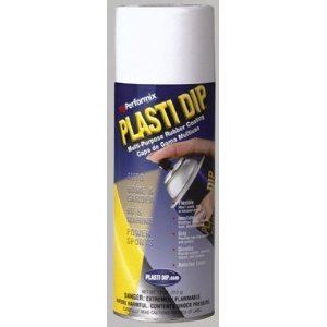

I have a suggestion that has worked well for me to water proof the different sections in some of my boats.I did this as an extra protection on the bulkheads to protect the electronics.It may well work for the machines you guys are building,cheers Blake
Tool latex coating spray
