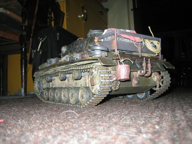

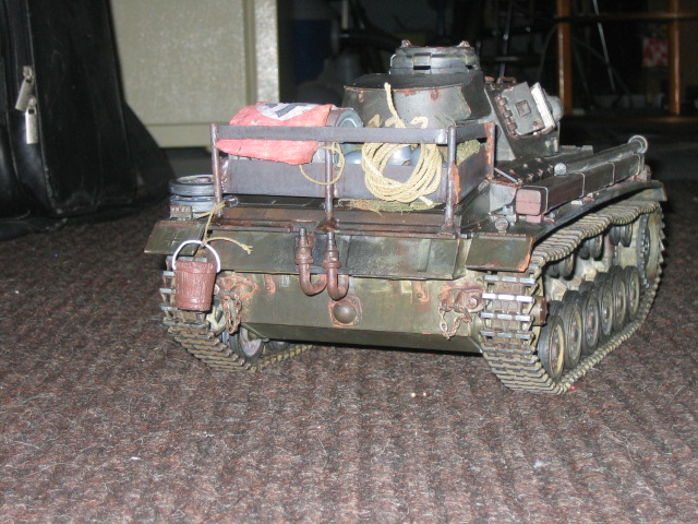

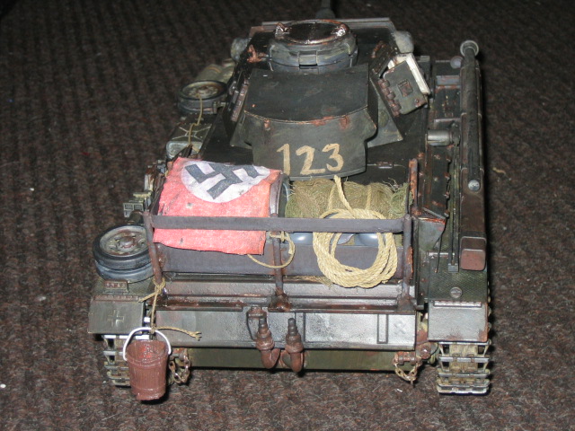

Well guys, I took a beather from the frustration of trying to figure this out and made some add-ons for the build...it's all done now except for my little problem... What do you think?
"All truth passes through three stages. First, it is ridiculed. Second, it is violently opposed. Third, it is accepted as being self-evident."
BREL
Posts: 2473
Re: I need some help guys...
Post by BREL »
great looking tank and a credit to your modeling skills,
