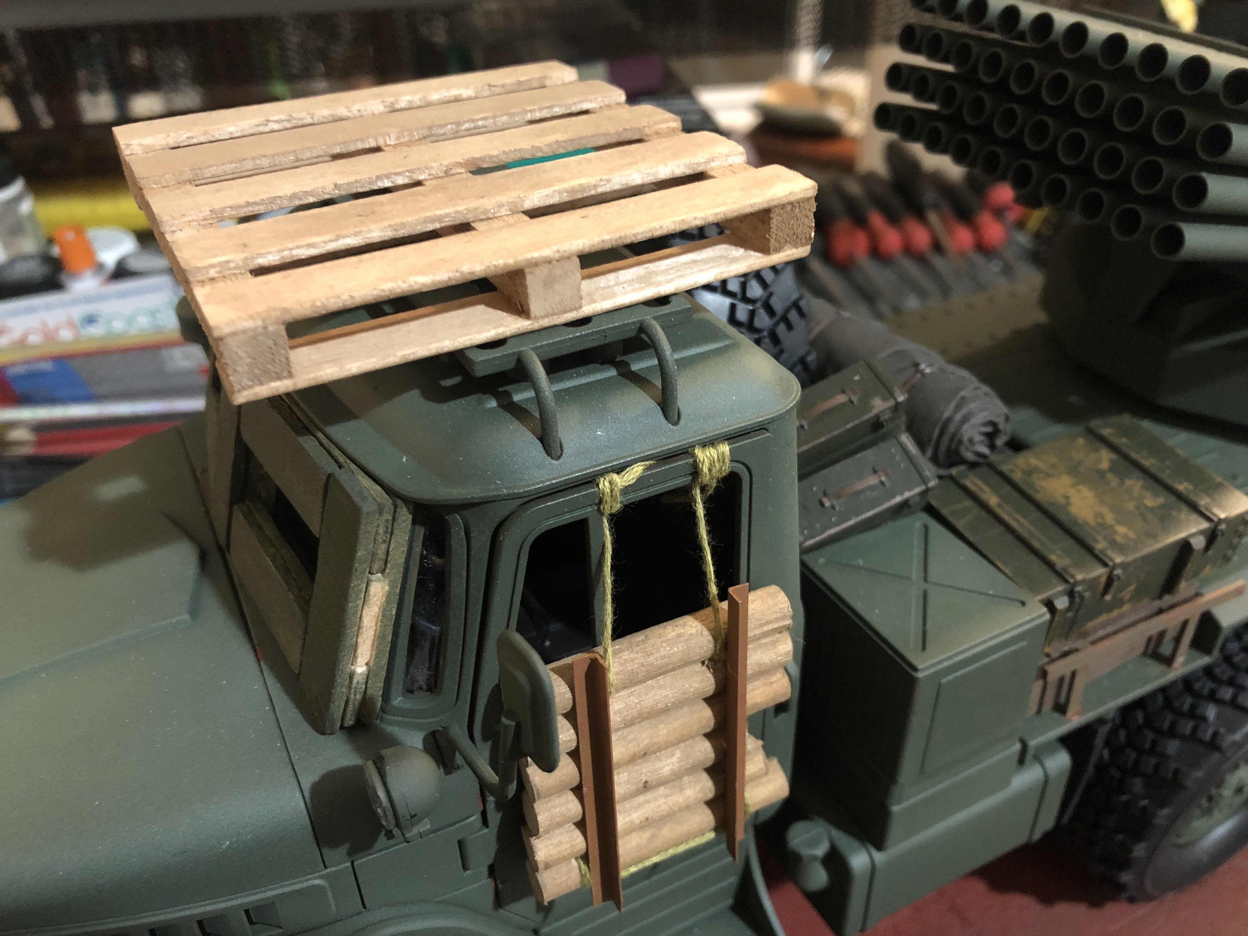

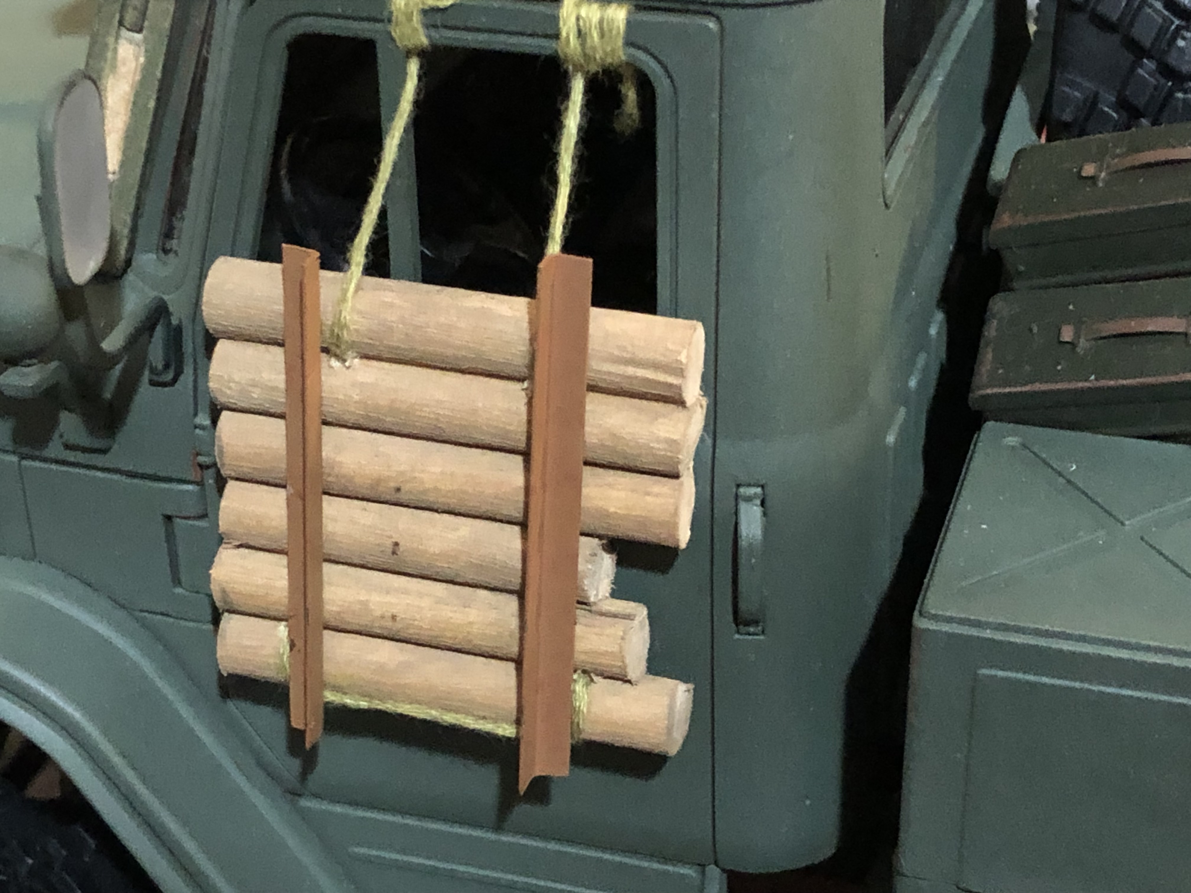

Well folks, sorry to break the news, but those sticks are all new!..........no fun stuff on the end of any of them.
The windscreen timber got a wash of green while the pallet & door armour got a very light XF-52 Flat Earth wash thinned with water to add a light shade but not add colour to overpower the real wood.
The door armour has brass angle glued onto it like the picture & rust washed, then tied off using embroidery thread. That trick to use embroidery thread was a tip from in here years ago offered by one Mr Fynsdad.
The pallet is going to be a support for mesh or netting spaced drone armour, anything to put space above the target from where you sit while driving!
Not entirely sure what I going to use for that, buit I will work it out by mistake like I usually do ;)
Its not attached yet pending that Eureka moment.

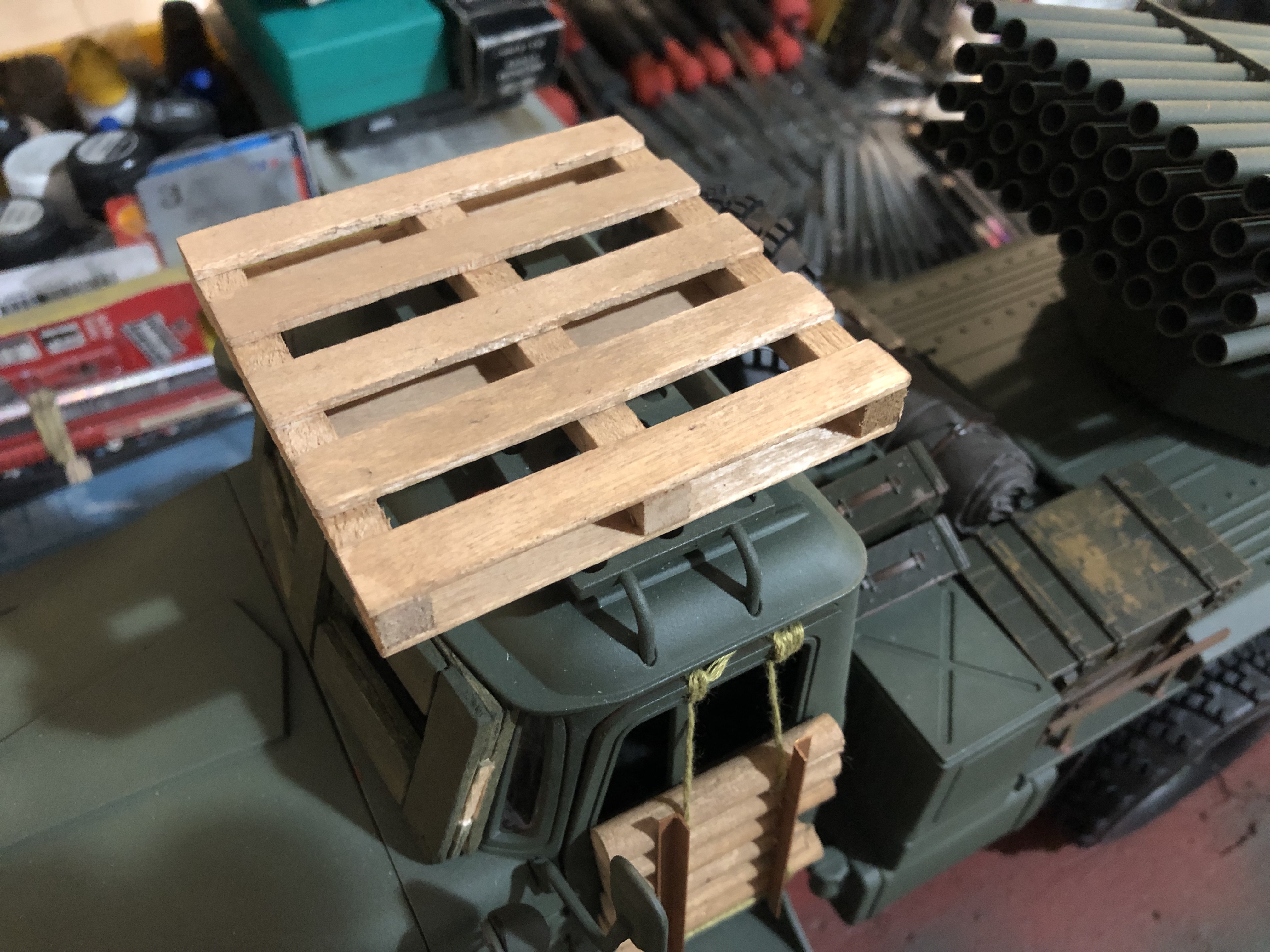

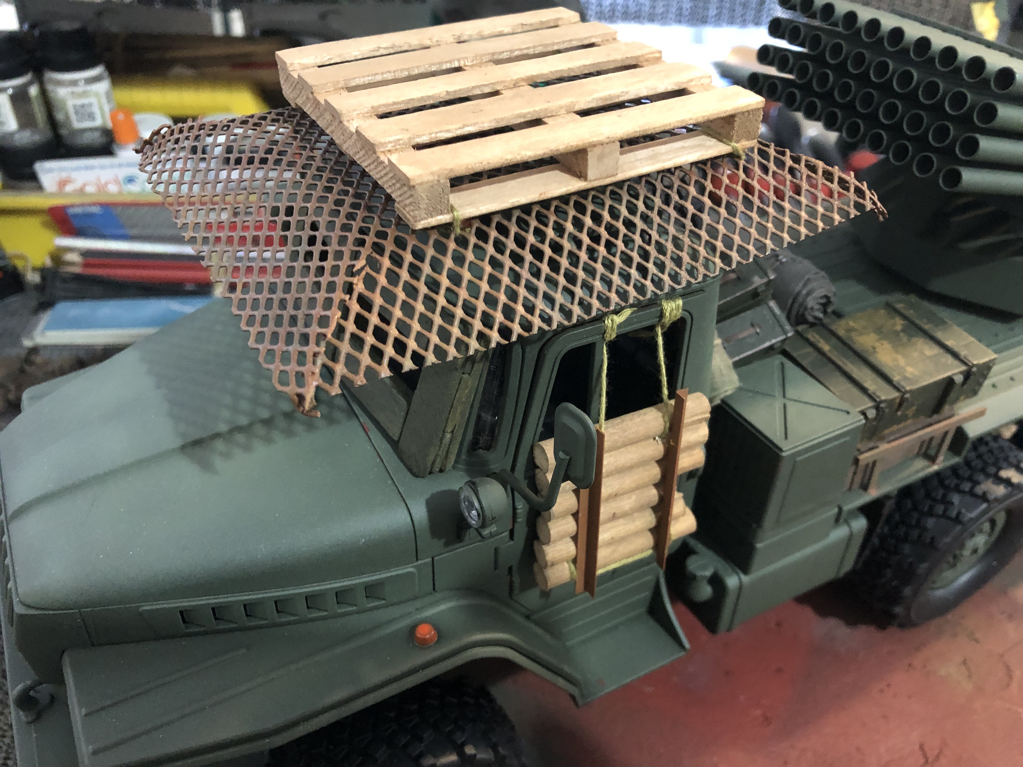

The drone armour on the roof of the drivers cab took a different tack.
Rather than the pallet on the rack then mesh on that, I went with the mesh on the roof rack first, then the pallet.
Sits better and after a lot of looking, looks better too.
The pallet was tied onto the mesh with embroidery thread & the knots glued.
Then the lot was set in place on the roof rack ready to weather with the rest of the vehicle.
A bit of rusting paint with Tamy acrylic's and Mig Oilbrushlers & its on & looking ok.
