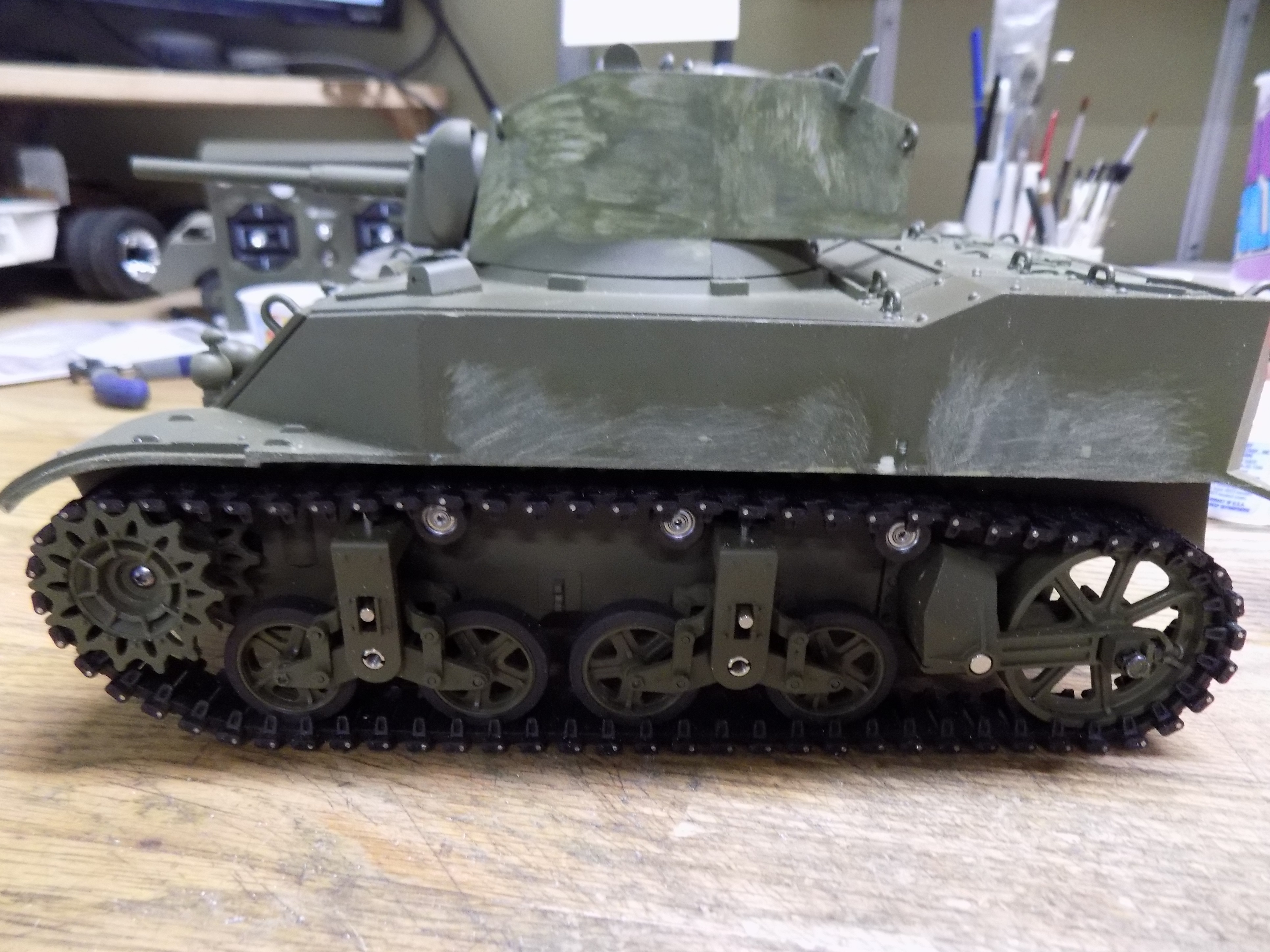

Ecam wrote: Sat Sep 27, 2025 10:51 pm I see what you are talking about now! I will probably start with weight like E-brute mentioned and I'd like to take some spring out of the rear idler (soft front/stiff rear).
Yeah when you see the side skirts+the high suspensions stance, the Coolbank looks very massive when viewed from the side 😂
If you can get it lower it will look perfect, I hope the extra weight will work!

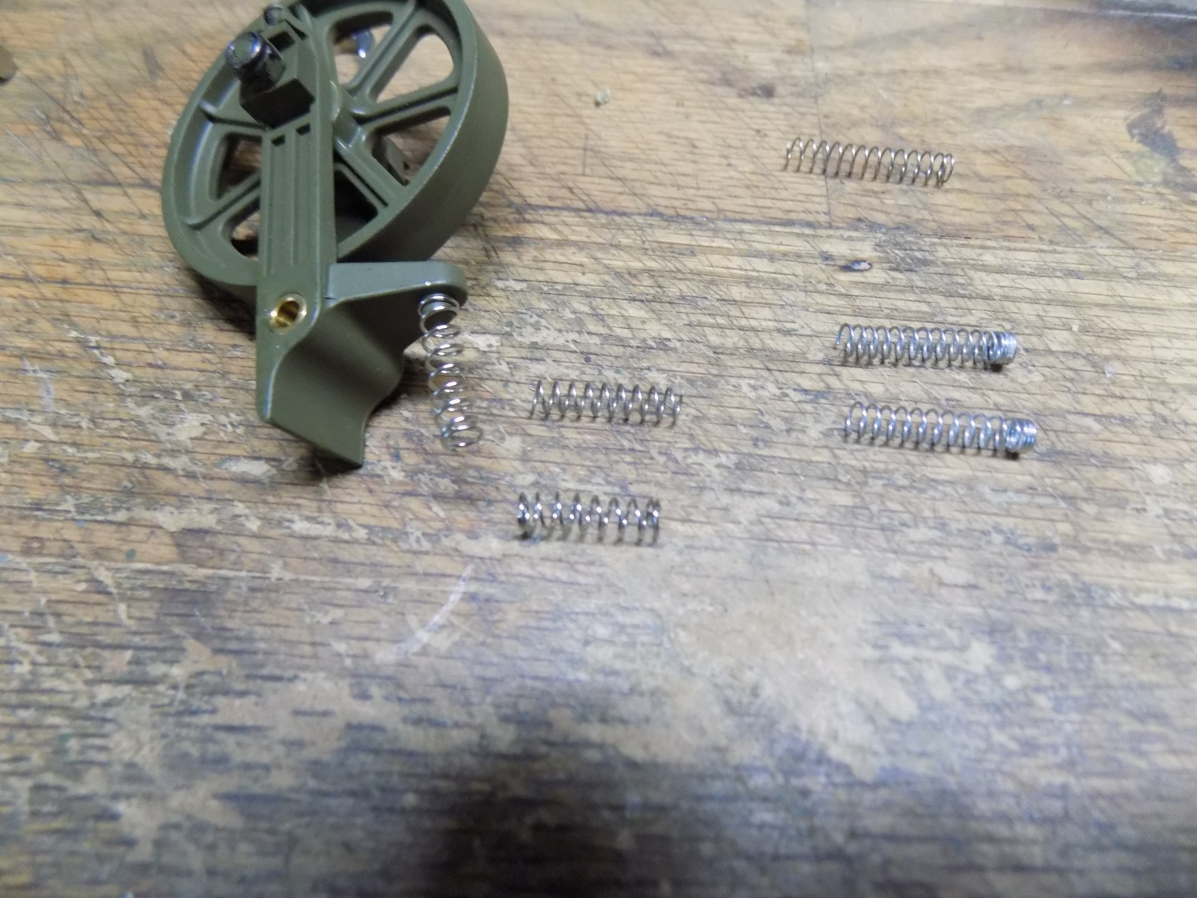

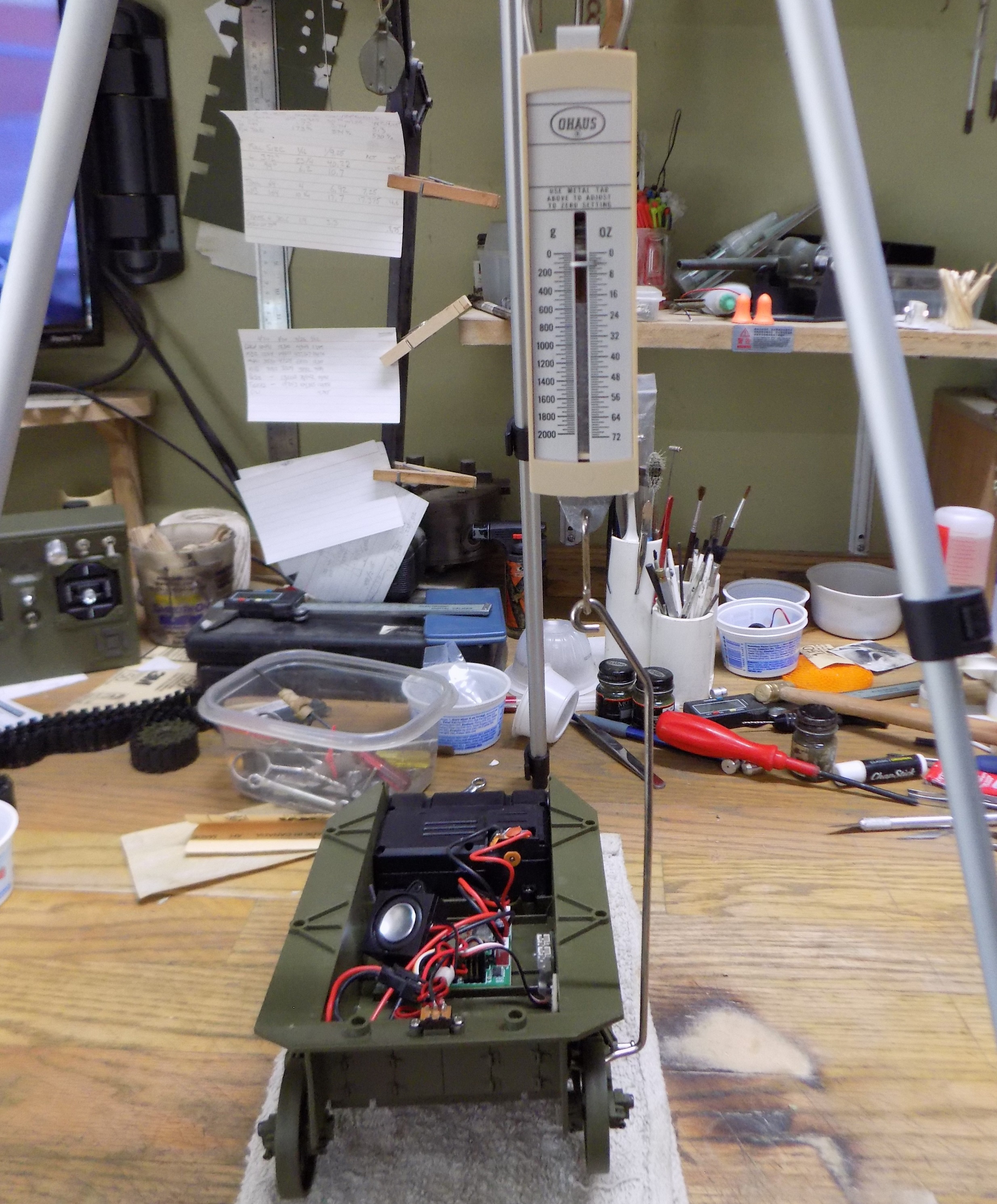

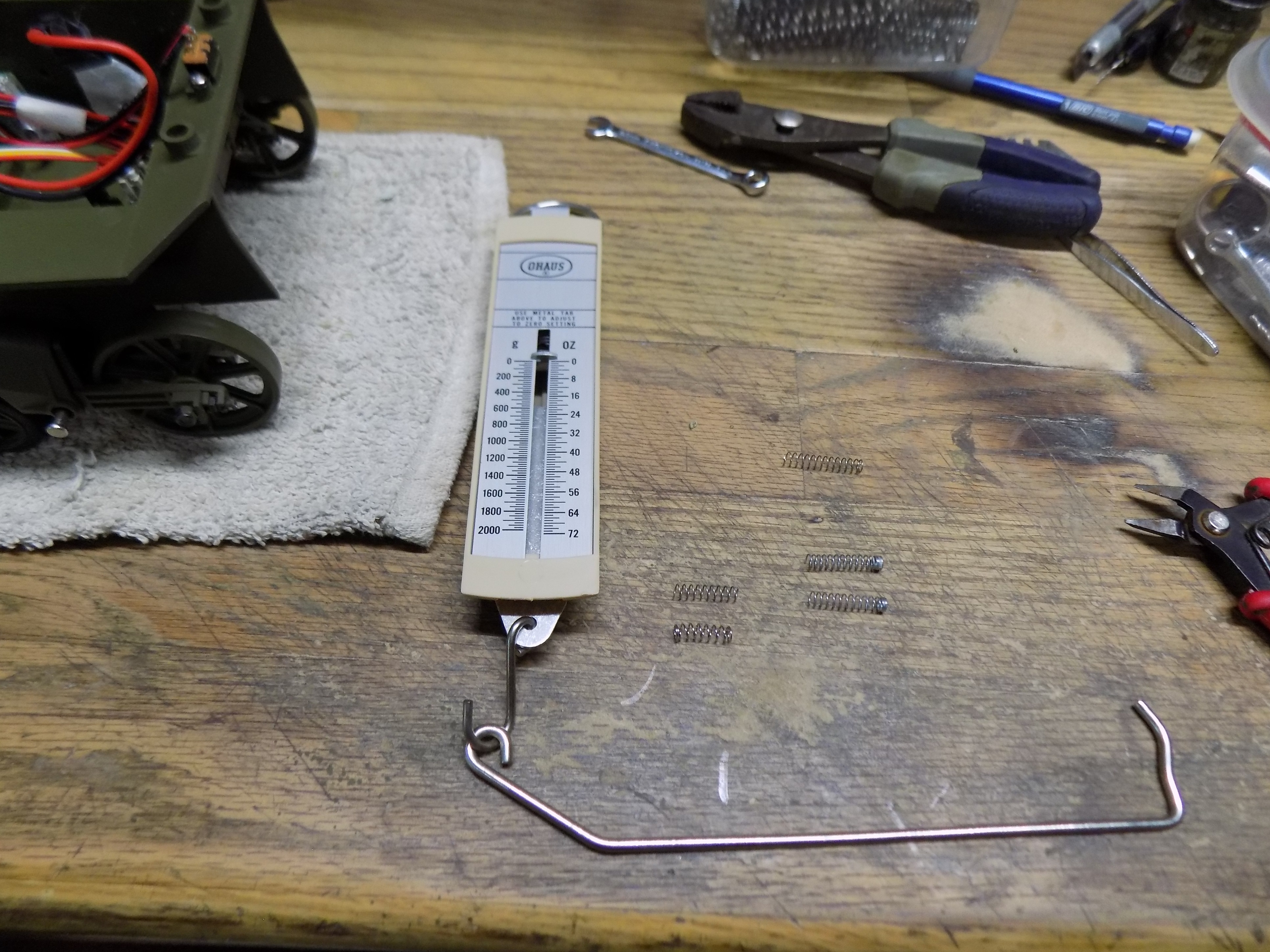

Before anyone asks... I have no idea where this spring came from. I tend to keep certain parts in containers for use in tanking. The original spring was about 3 inches (7.5 cm) in length before I cut it down. I used a trigger pull gauge to measure the stock springs against the new. 400 grams (14 oz) original and down to just less than 200 g (6oz) with the replacements. The stock Stuart kit reminded me of a 60s American muscle car, heavy big block up front on relatively soft springs and massive stiff leaf springs to control axle wrap in the back. Over a speed bump, you got a Caddy like ride from the front and an unloaded one ton truck from the rear.
The installed spring and the bottom spring near the idler are the ones that came with the kit. The upper spring near the idler (and the one top right) are the pieces/parts I cut from the 3" spring. Those two on the lower right are from ball point pens.

It is going to take someone smarter and braver than me to figure out how to get the bogie springs out of the Stuart. The outer part of the bogies are moulded onto the hull. I flexed one as far as I dared but could not free the spring assembly. Any more flexing and I fear a "snap" is next. So I'm going with a little of both methods. I did trim the Idler spings I installed yesterday an additional coil and a half. Down to 100 grams (3.5 oz) in spring rate. Then 550 grams (19.4 oz) of additional weight and I think the suspension is reasonably compressed.
I did not use the tripod in testing, it was only for the picture.

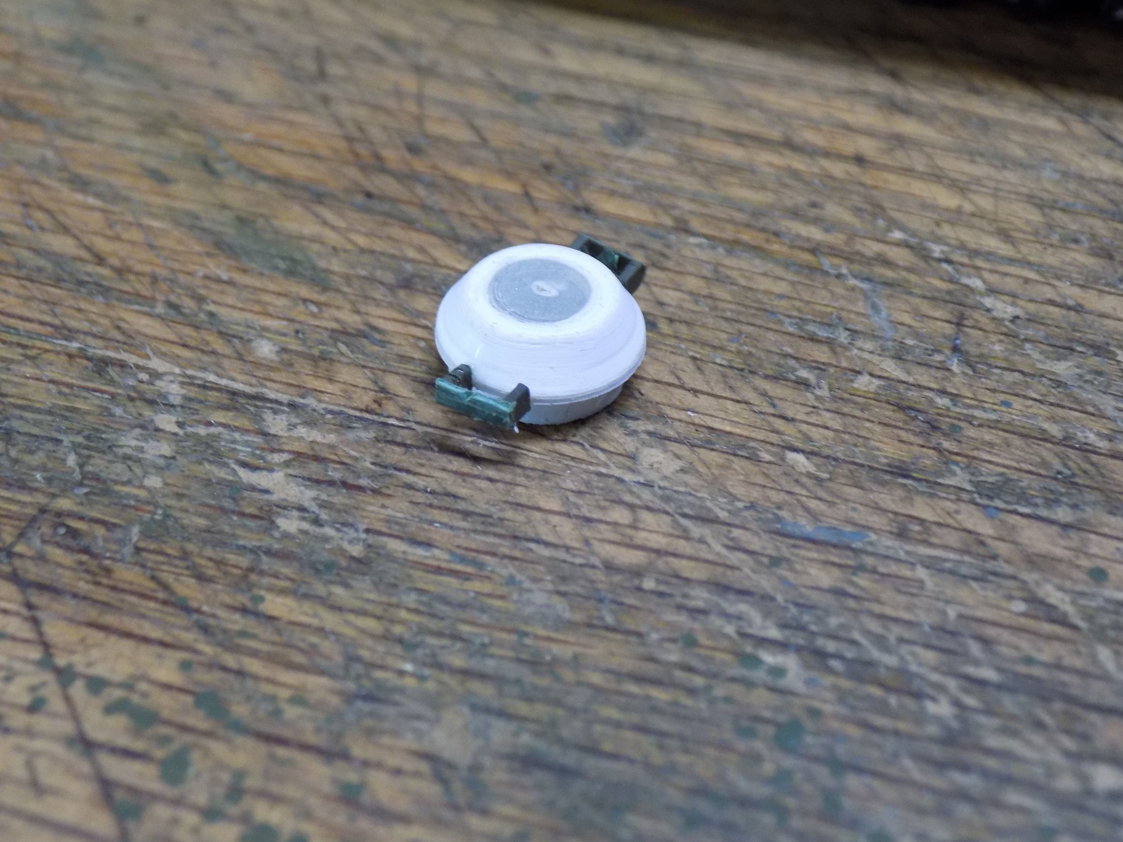

And finally, those of you who have this kit, did your left rear fuel cover (smoker fill port) come installed on your tank? I went through the packaging several times and mine was MIA. Decided to make a replacement.

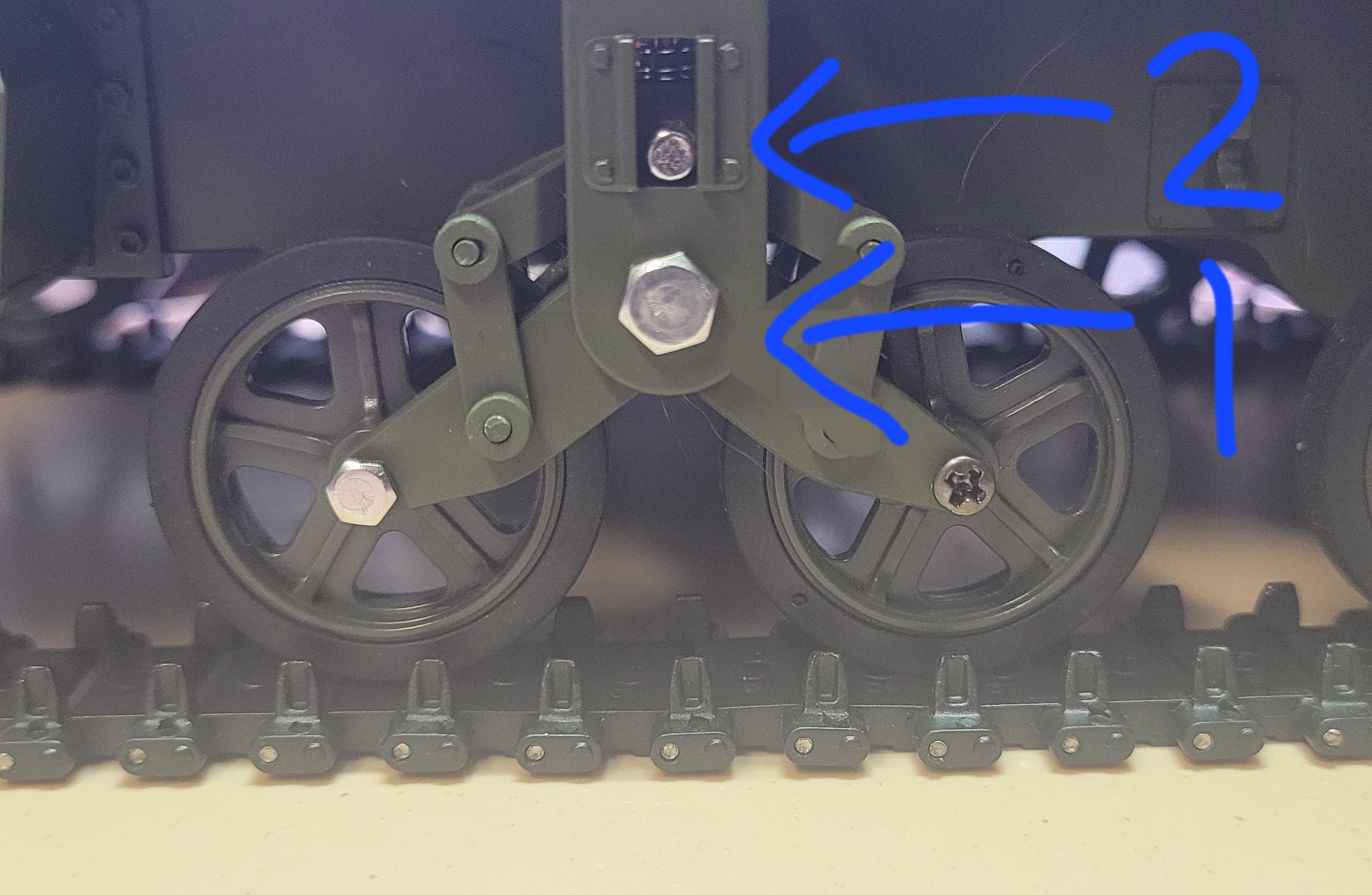

I removed the suspension arms by removing the pivot screw (1) and then pulling out the pin (2) that moves up and down in the slot. That releases everything for work. Fun to put back together!

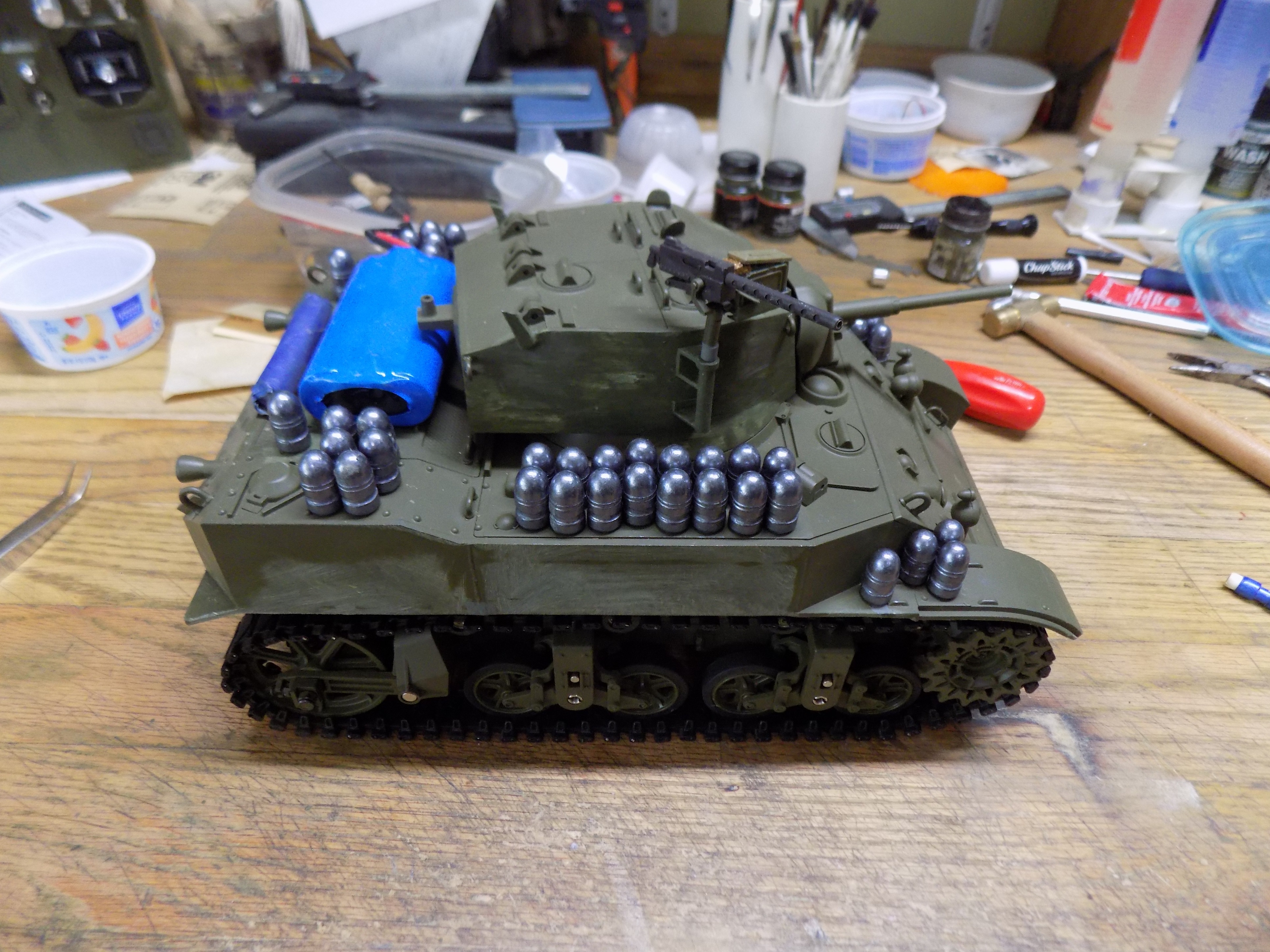

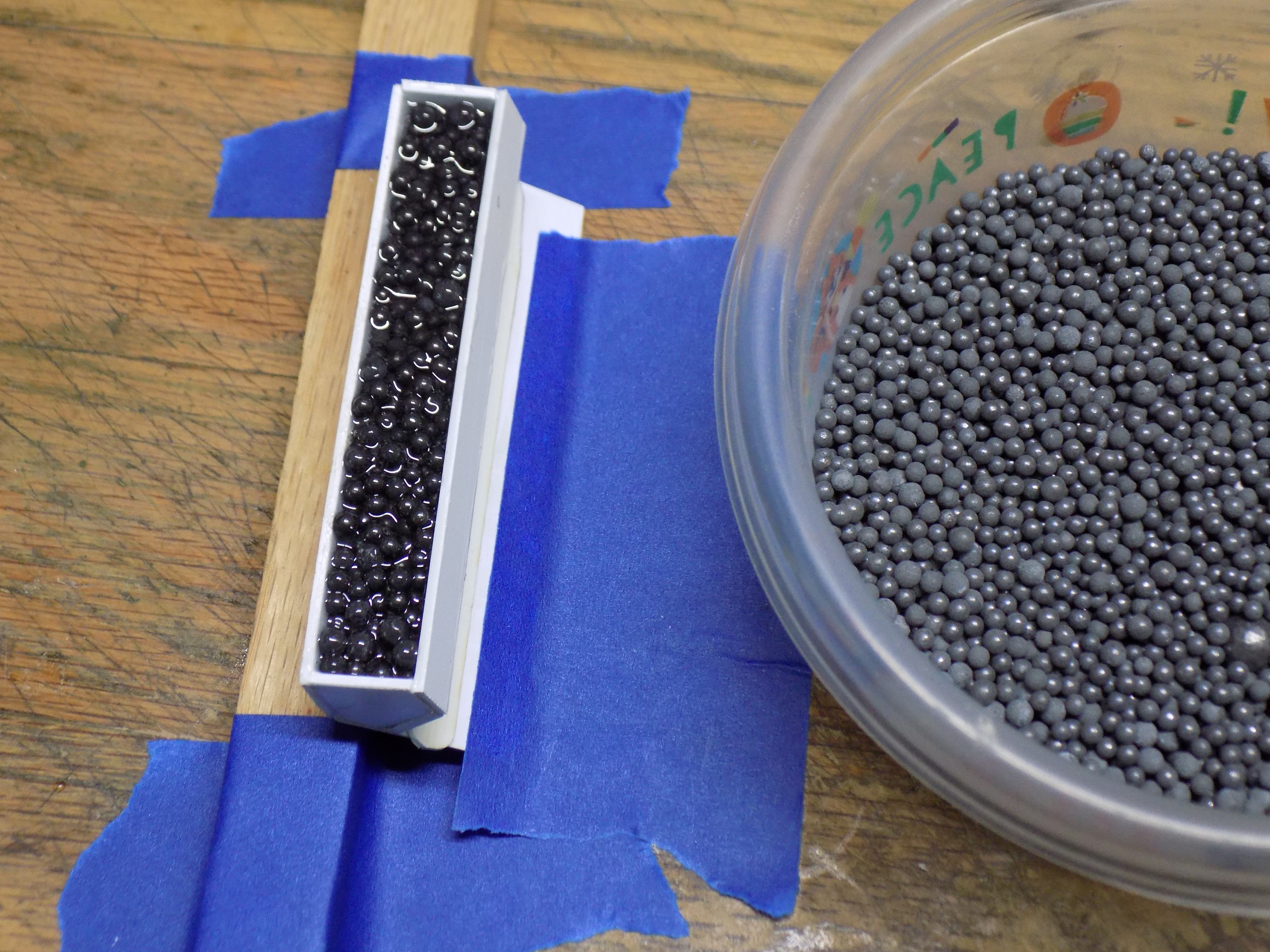

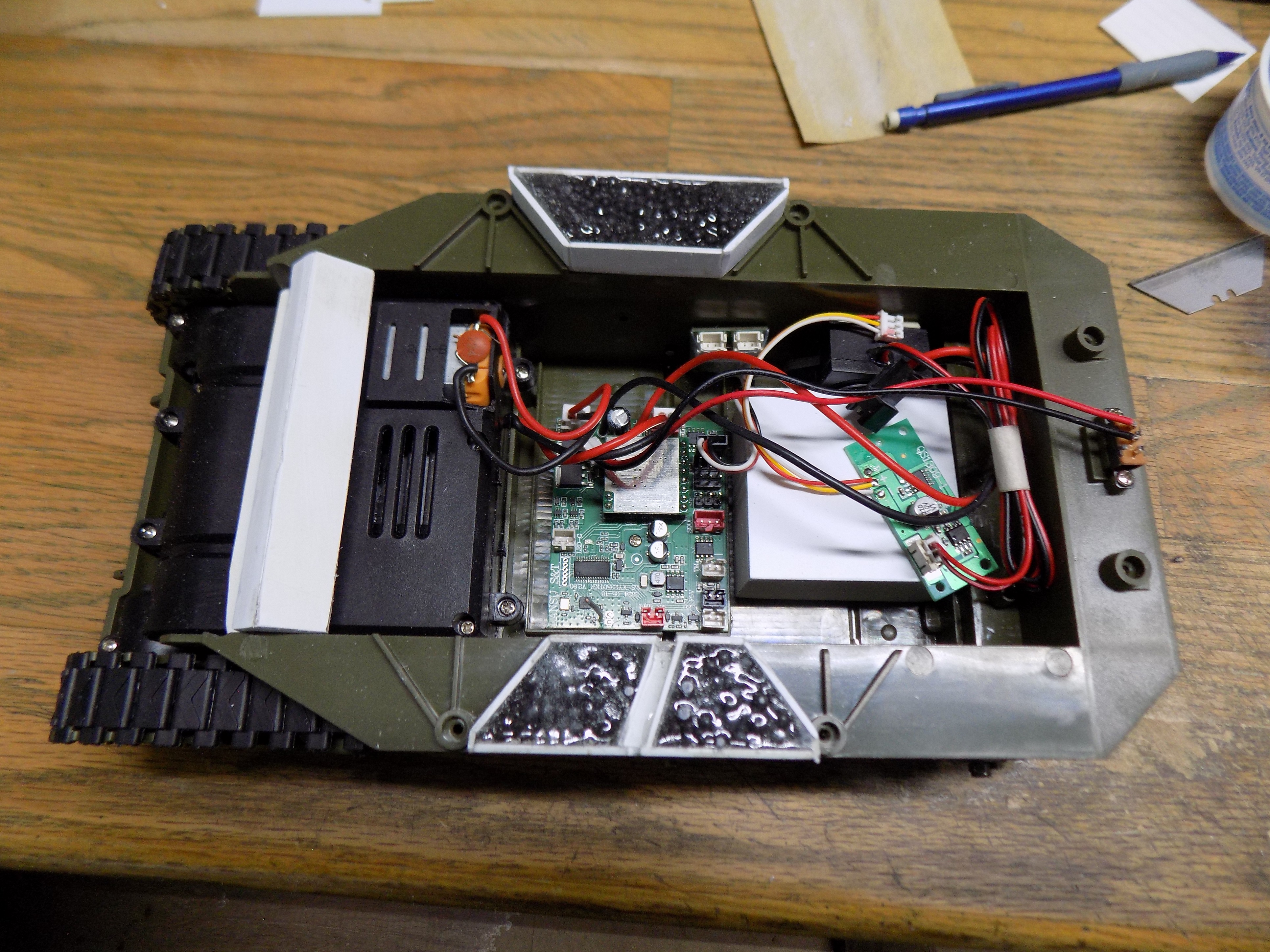

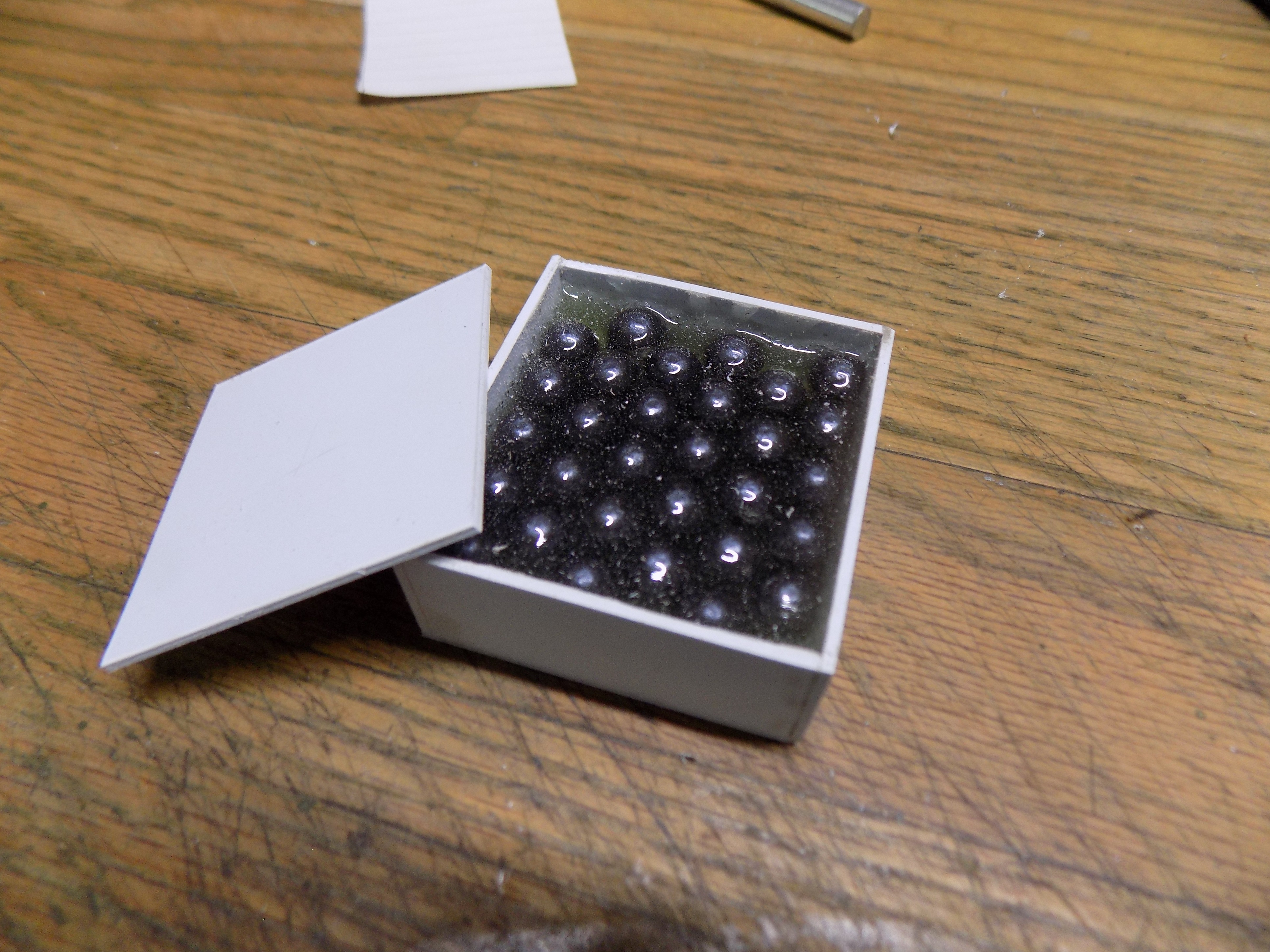

Rear box
Front box
Side boxes with front and rear installed. That space in the left side box is for a rib (in the upper hull) that runs to the turret (turn) servo mount.
With battery onboard as well. Spring rate at 200 grams (per side) was too stiff - 100 G too soft. Goldielocks will try for 150 grams next.

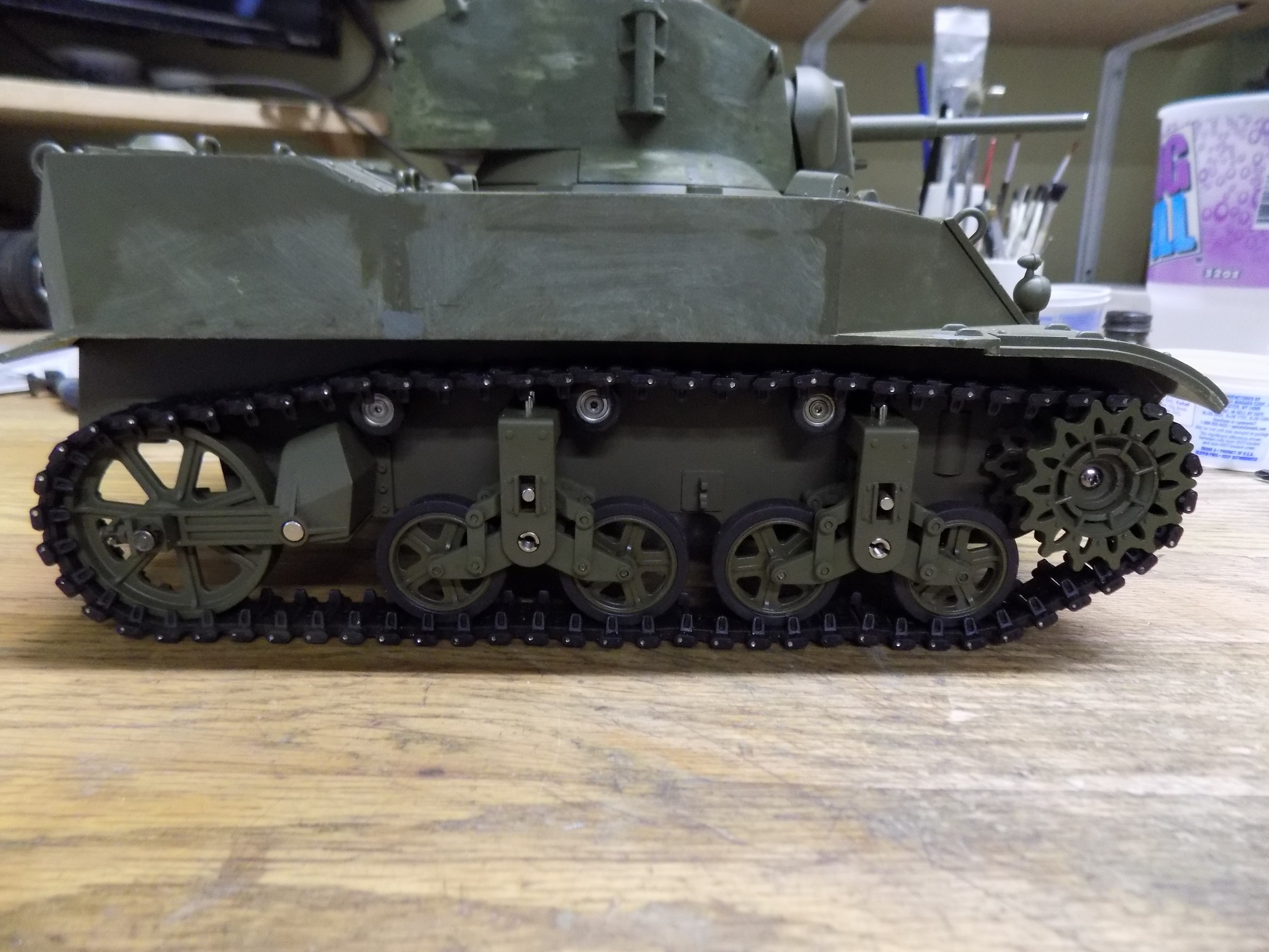

And Goldie said "just right".

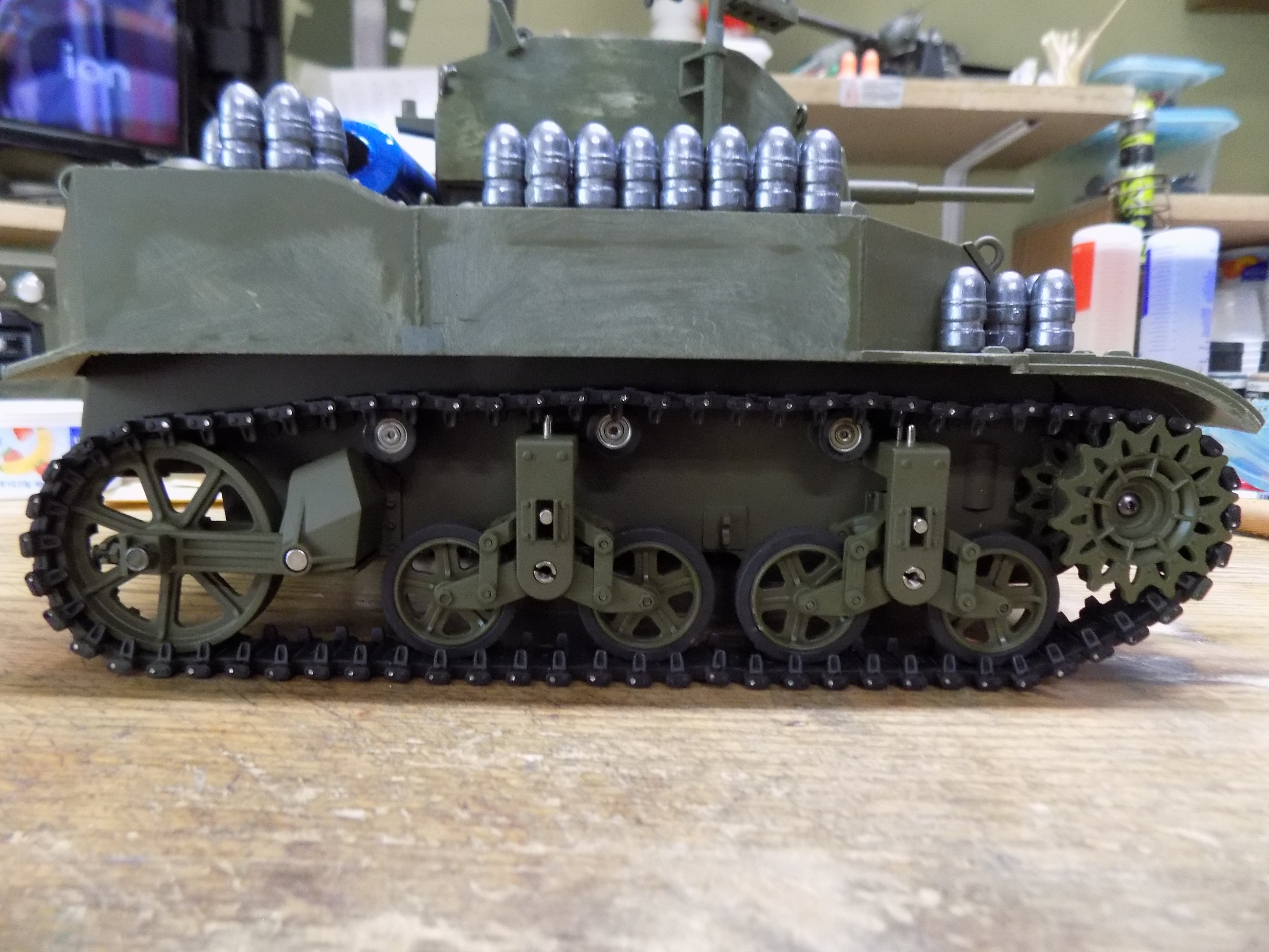

Trimmed down those retractable ball point pen springs. Snuck up on 150 grams and the Stuart sits at the height I was hoping for. Just setting the tank down, idlers and bogies all compress a bit.
