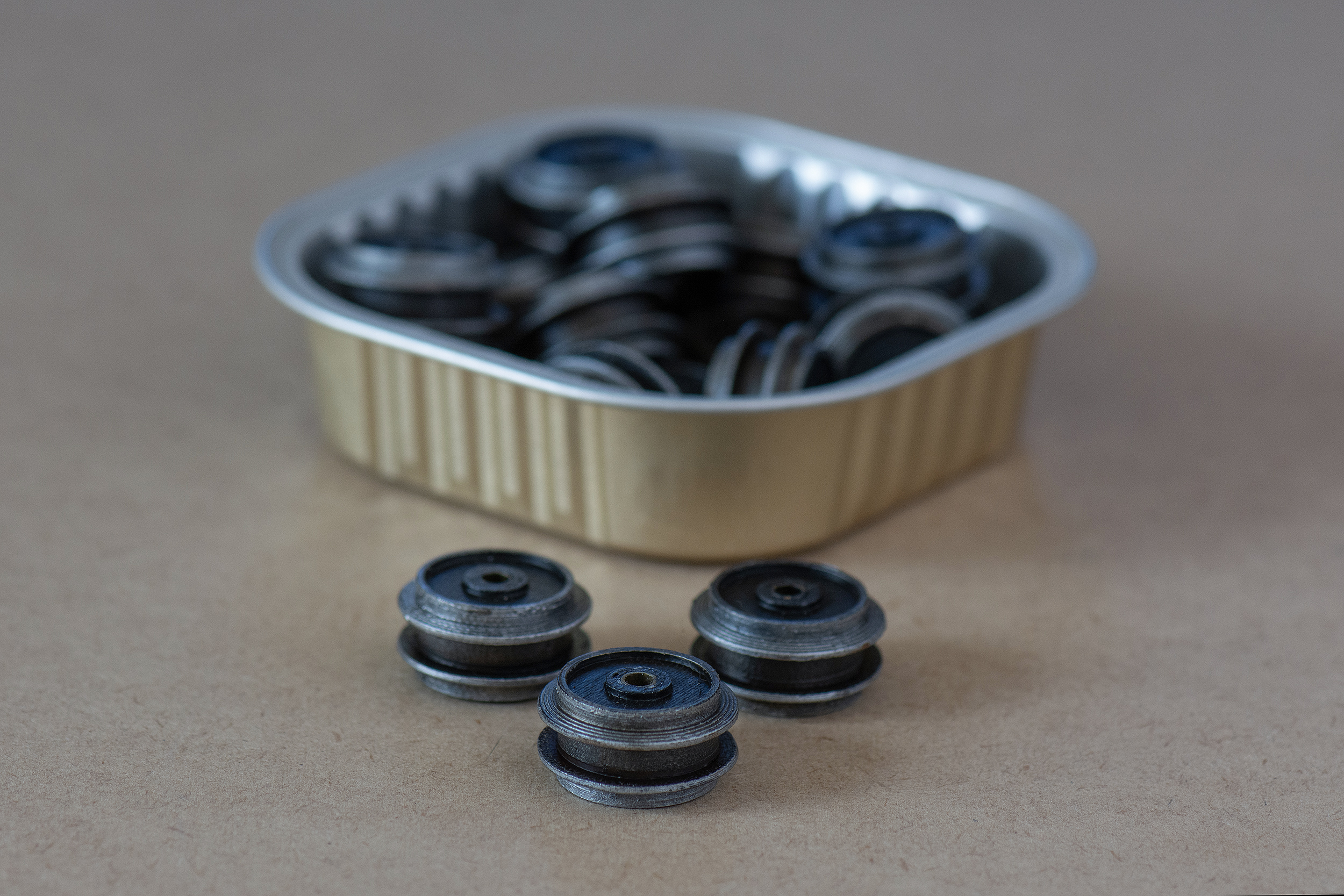

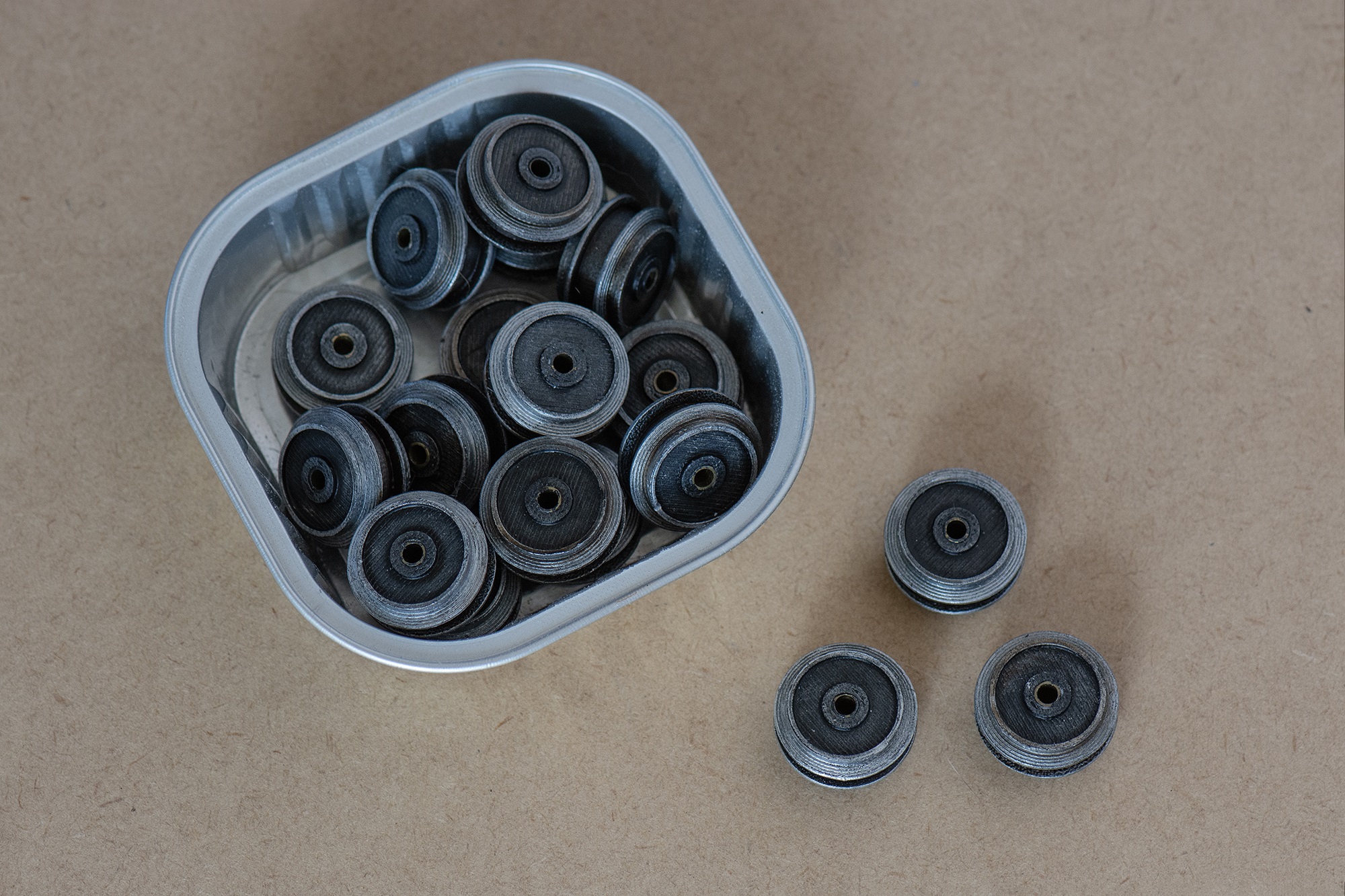

Road weels/rollers painted black, postprocessed with some drybrushed steel colour and oil/rust washes.

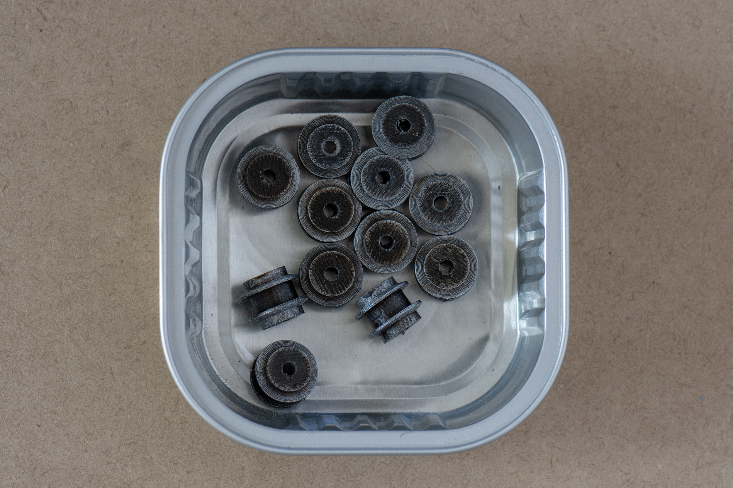

Return rollers

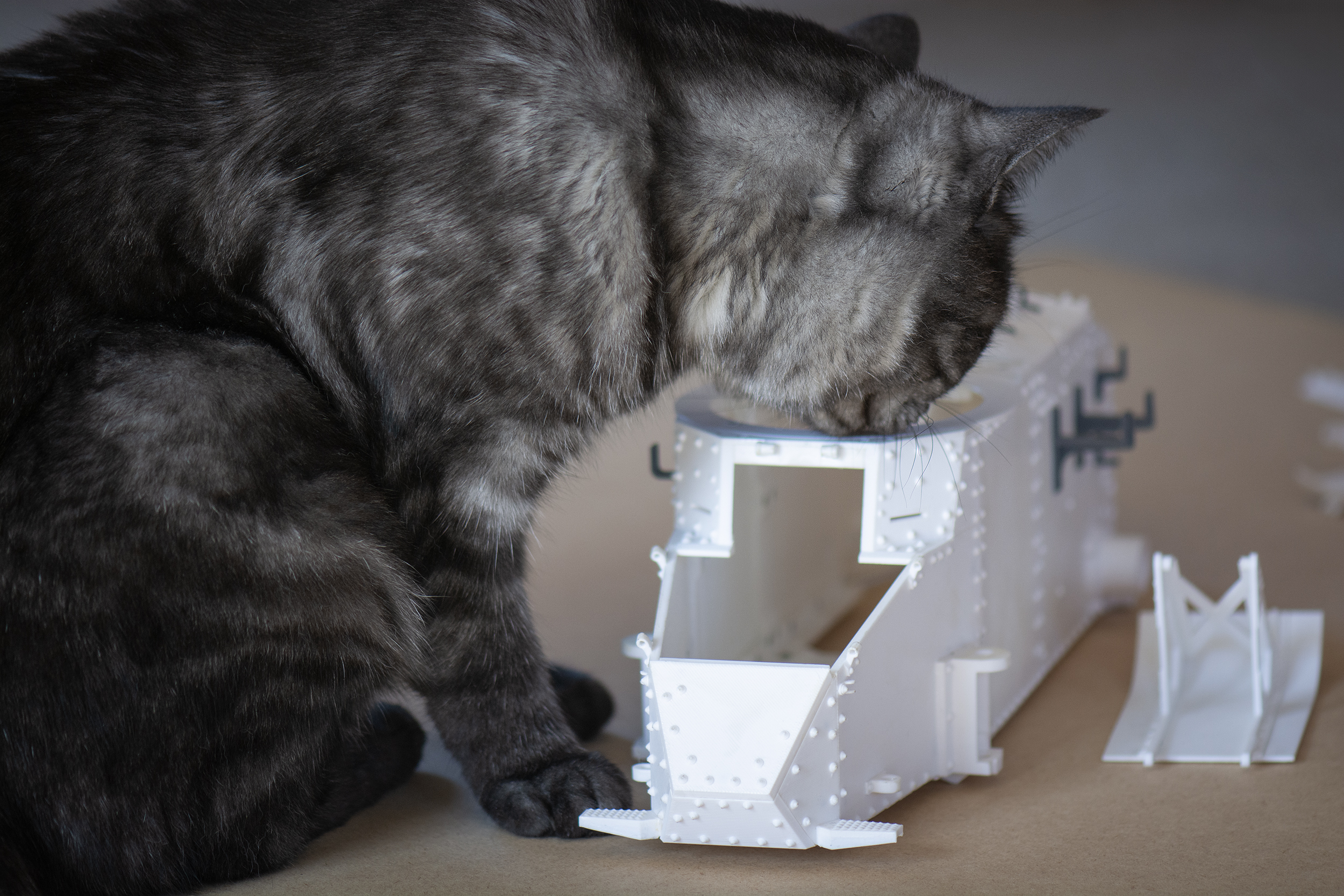

Interior inspection is the next.

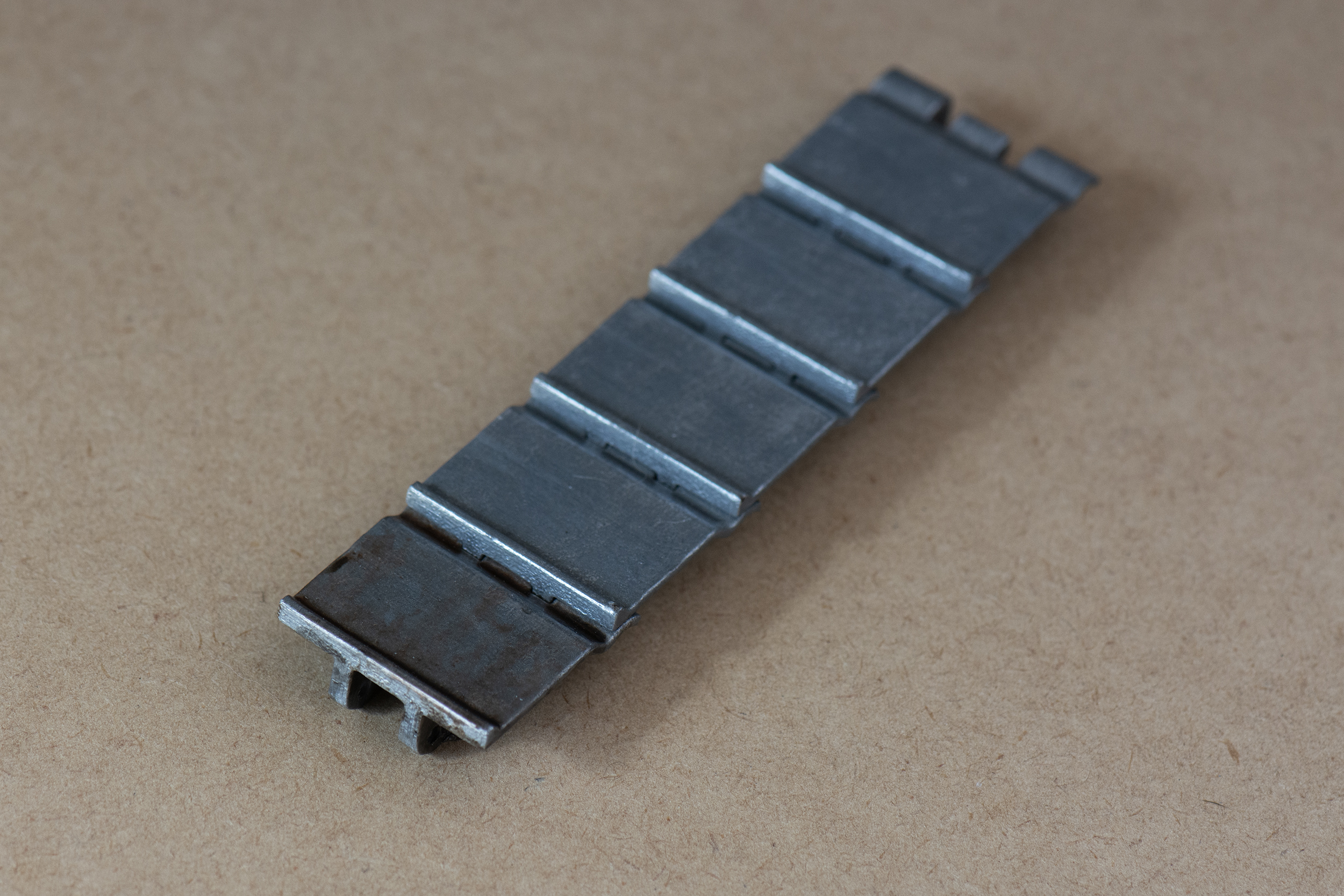

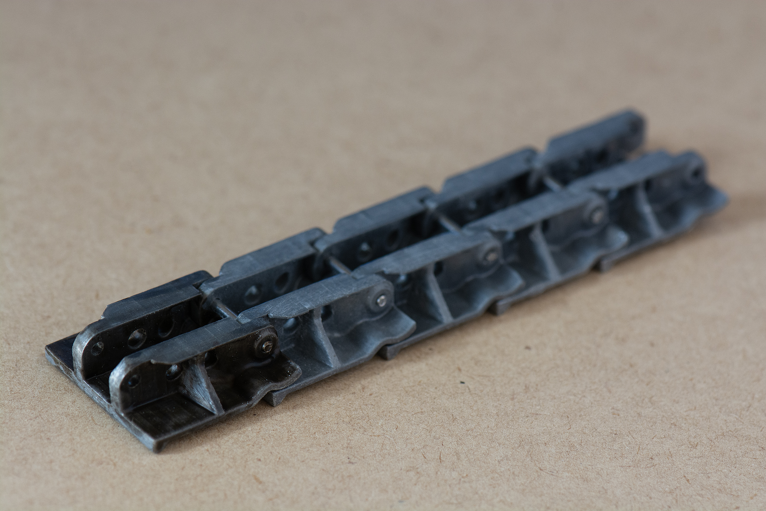

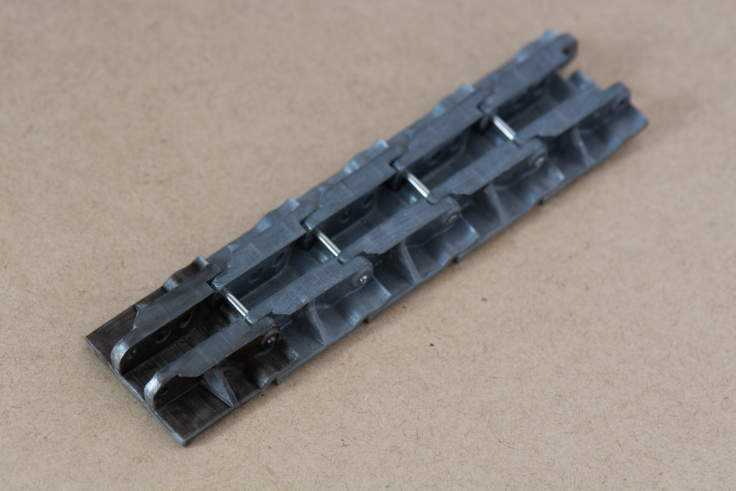

Just linked a few tracks together to test it. It was printed with Bambulab ABS silver filament to have a metallic look.
I gently brushed it with uPVC pipe cement, just enough to get suck in into the plastic without damaging it. This way it reinforces layers adhesion and seals all the gaps.
If you add a bit of Mr.Hobby dissolved putty, it would hide the layers a bit and make the plastic easily sandable.
Tracks were dry-brushed to see the effect, and a bit of oil and rust wash was added to see how it looks.

Did it pass inspection then ?
Those wheels and rollers really look as if made of metal :thumbup:
Braw kitty as well mate
Alan
Let slip the cats of war!!!!

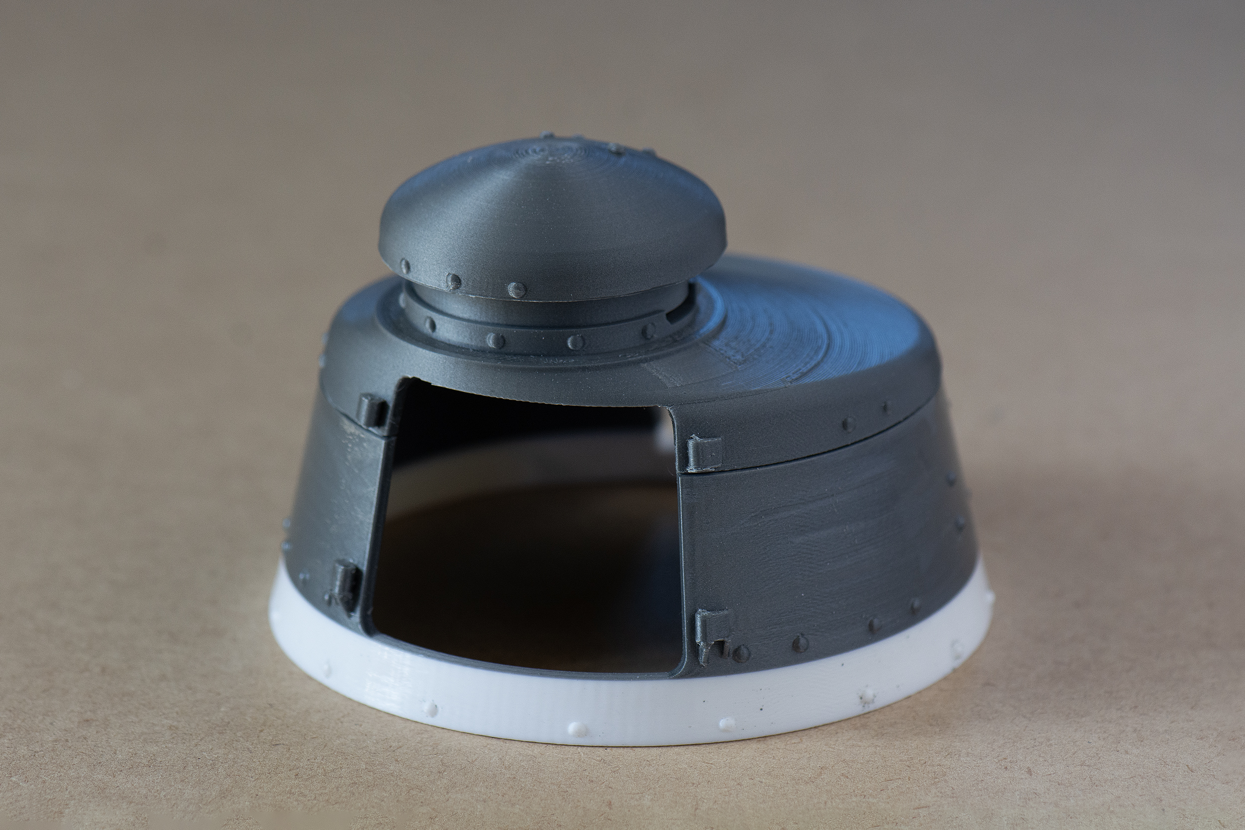

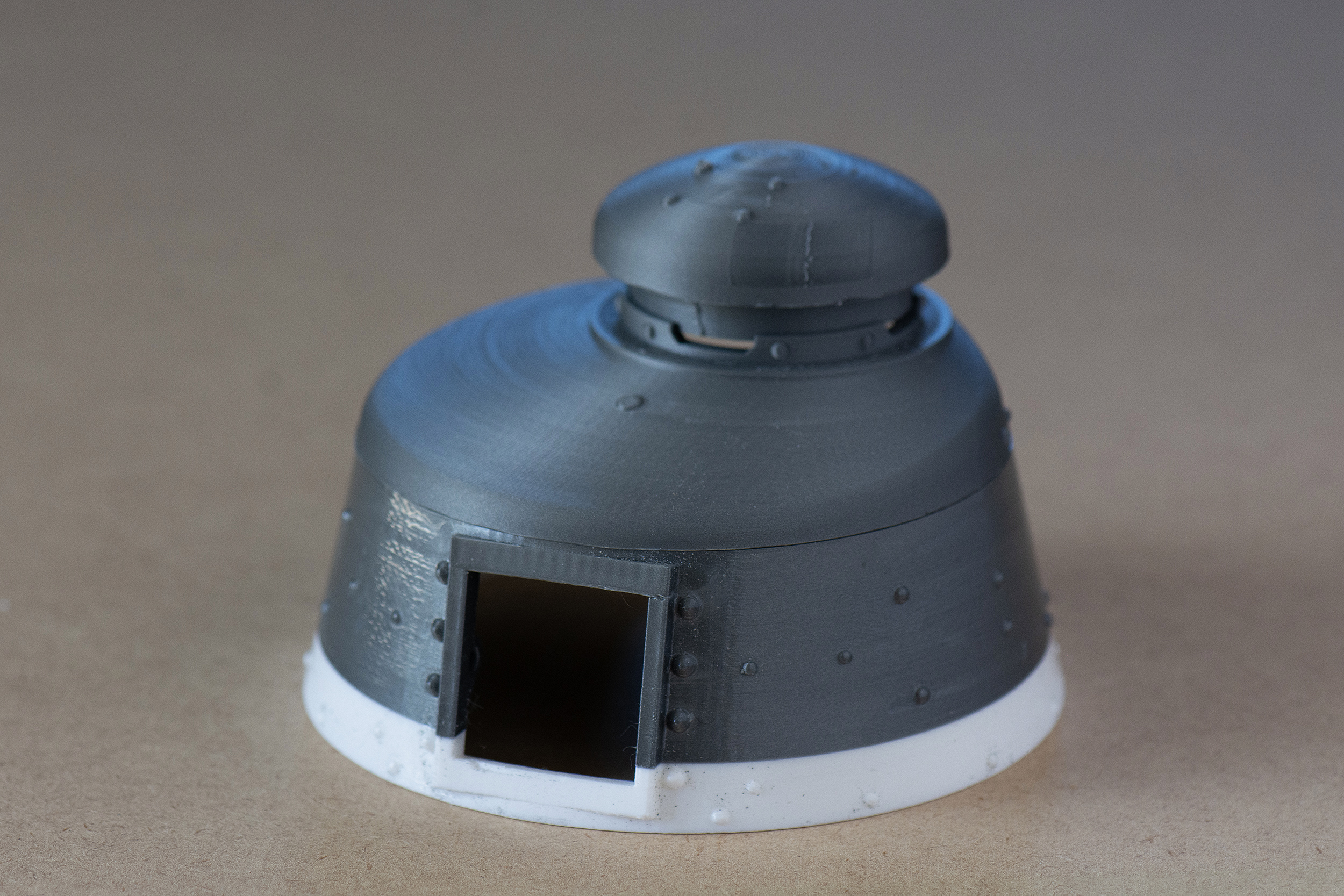

The turret was just printed, but no post-processing except for one coat of uPVC pipe cement. Luboš hasn't designed gun elevation and recoil. So, I need to think about how I want it to be mounted and design it.
