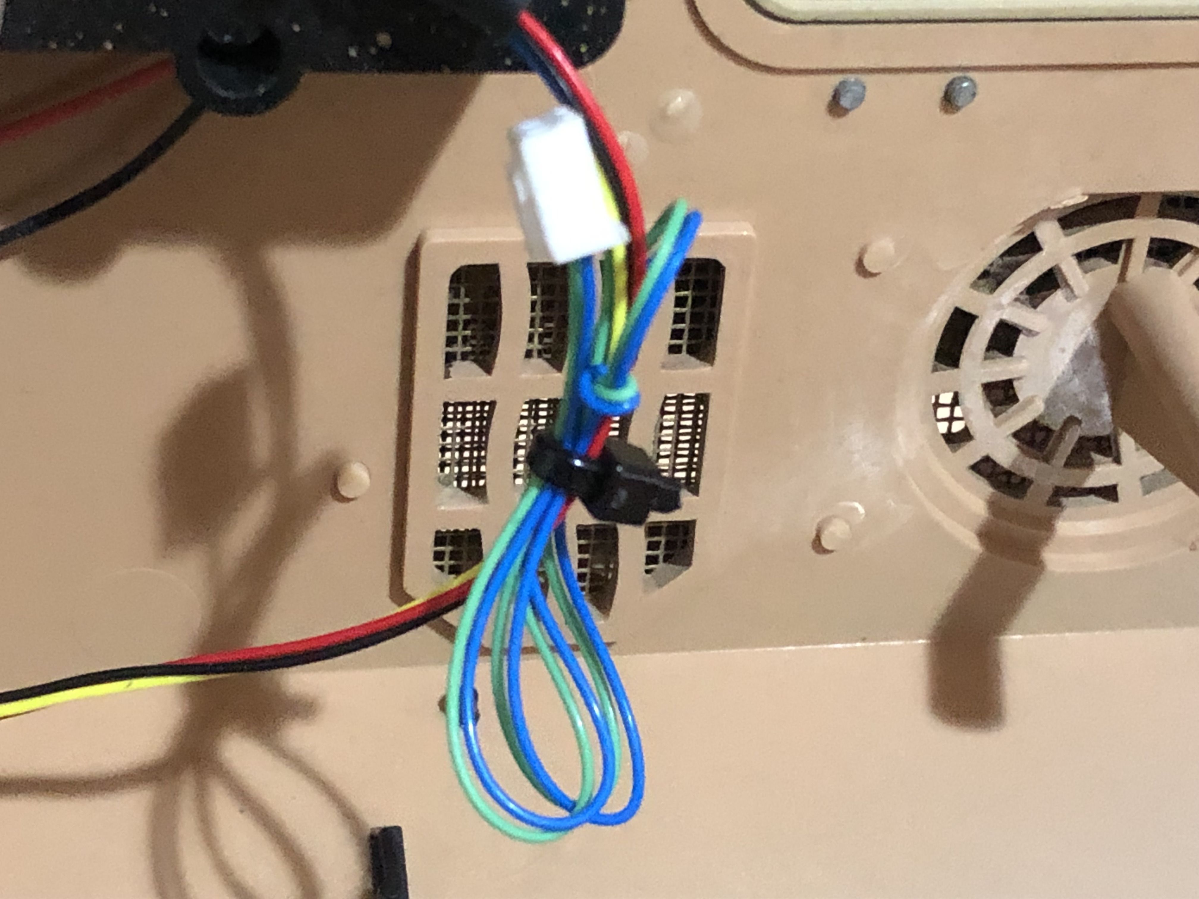

There is a cable which was knotted & unused.
There are ports available that it can go in, but I am loath to just bung it in & see.
This has the 360 degree slip ring in it too.
Any guidance on this most welcome.

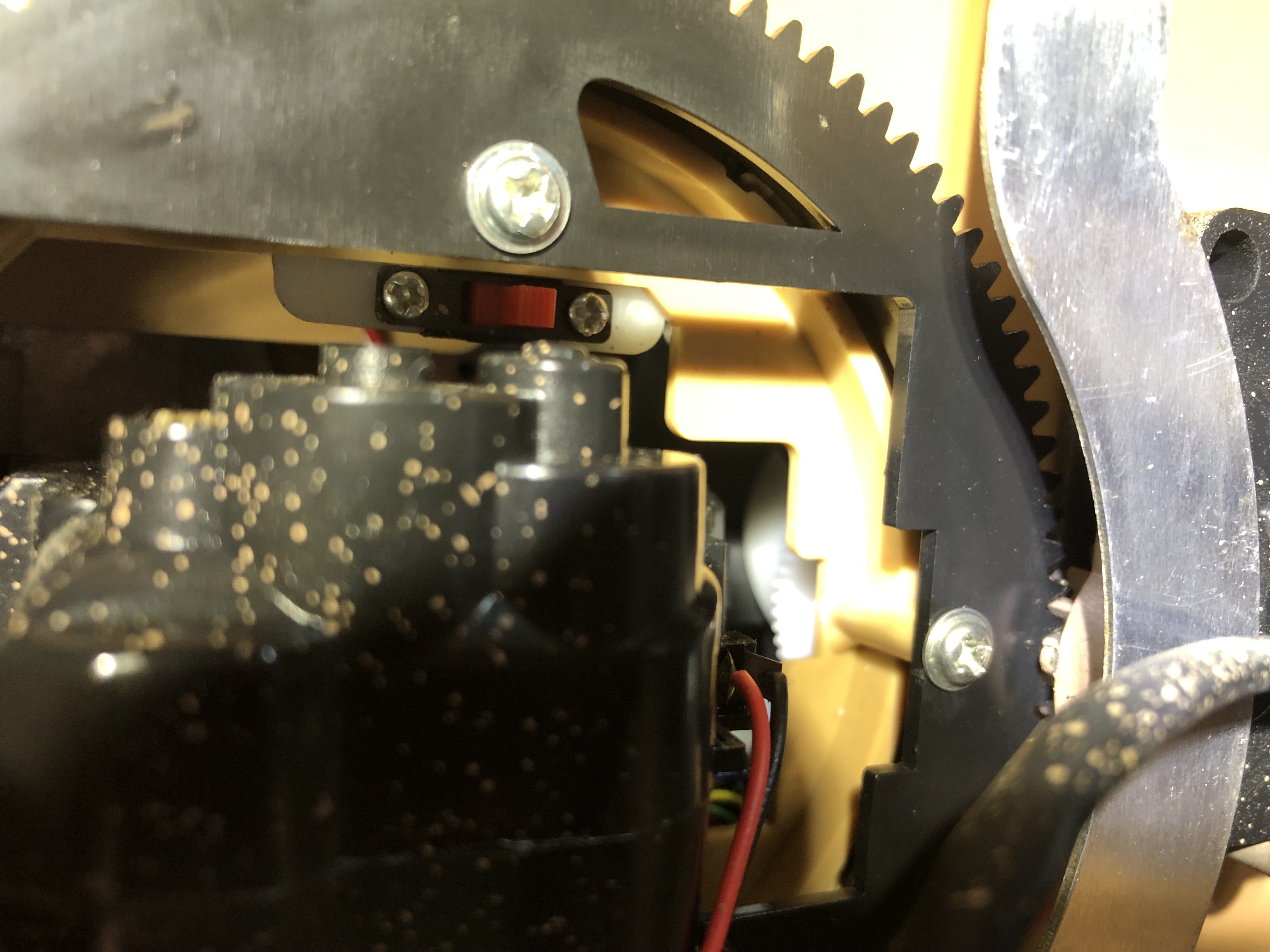

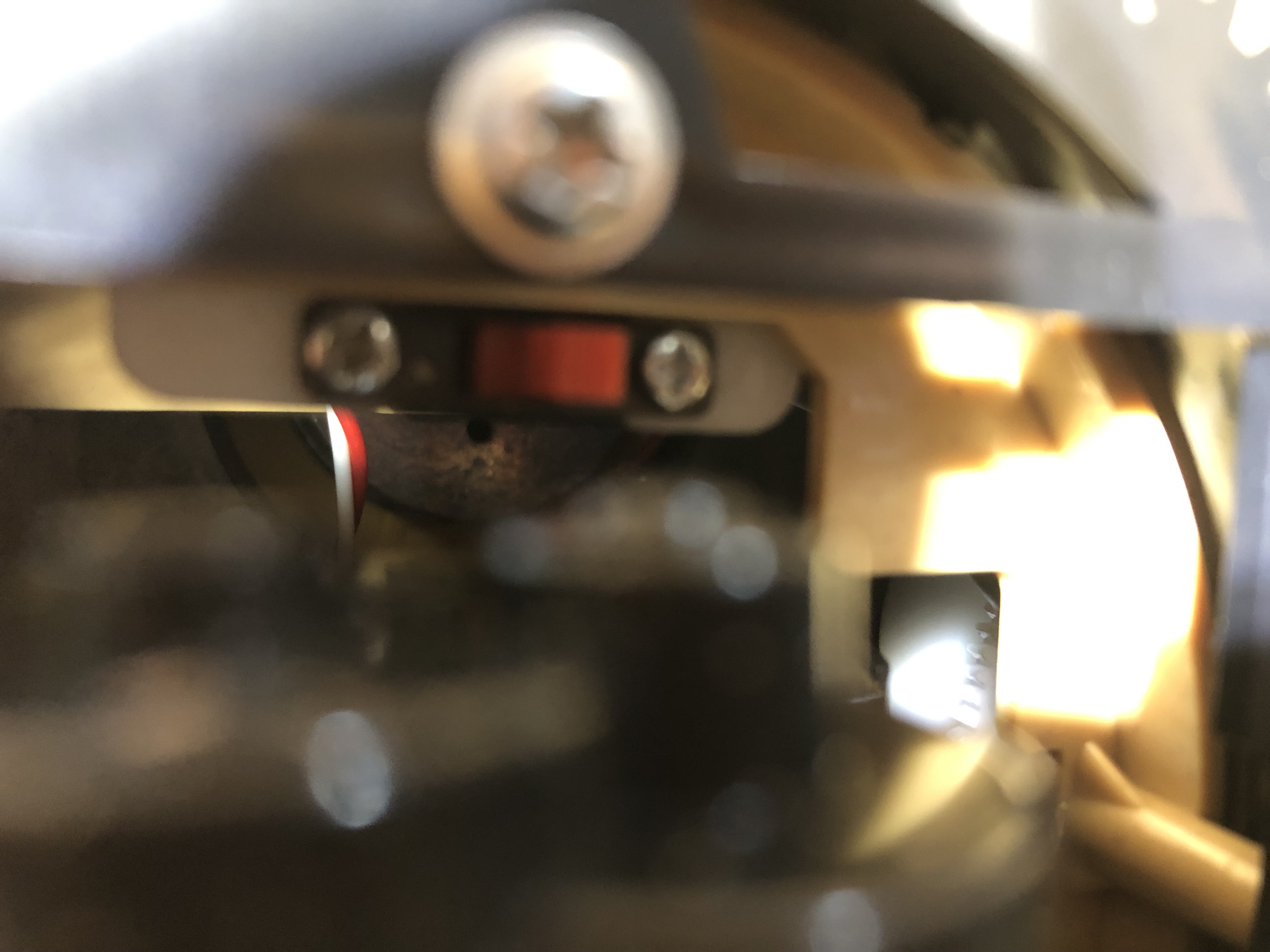

Those last 2 pics show the hidden on/off switch that I assume is the barrel smoke unit.
My guess is that cable bundled under the hull is its power source but unless I completely dismantled the turret I won’t know for sure.
Plus I don’t see how a conventional bb unit would slow smoke to be fed thru it ,
Anyone got a set of instructions for one of these MOT in German

Re: Torro tank being weird
So what’re we trying to figure out now? How the gun smoke system works?
Here is a link to a gunsmoke system I installed on a airsoft unit
https://youtu.be/VpHASKt_4fw?si=ZomDr5slWMkGoAo9
This is all done with HL stuff, but I’m sure the concept is the same with Taigen/Torro. There must be some kind of board that powers the heater and provides power to the air pump when it is triggered. I’m guessing that may be what that wire pair hanging out is for, but it’s going to be difficult to tell without opening up the turret. That color pairing of wires seems familiar to me, but I can find any pictures on my phone showing them in Taigen/Torro models that I have.
Does the V3 have an extra port for powering stuff off the main battery like the TK7.0/7.1? I didn’t think that it did, but I haven’t messed with one in a bit.
