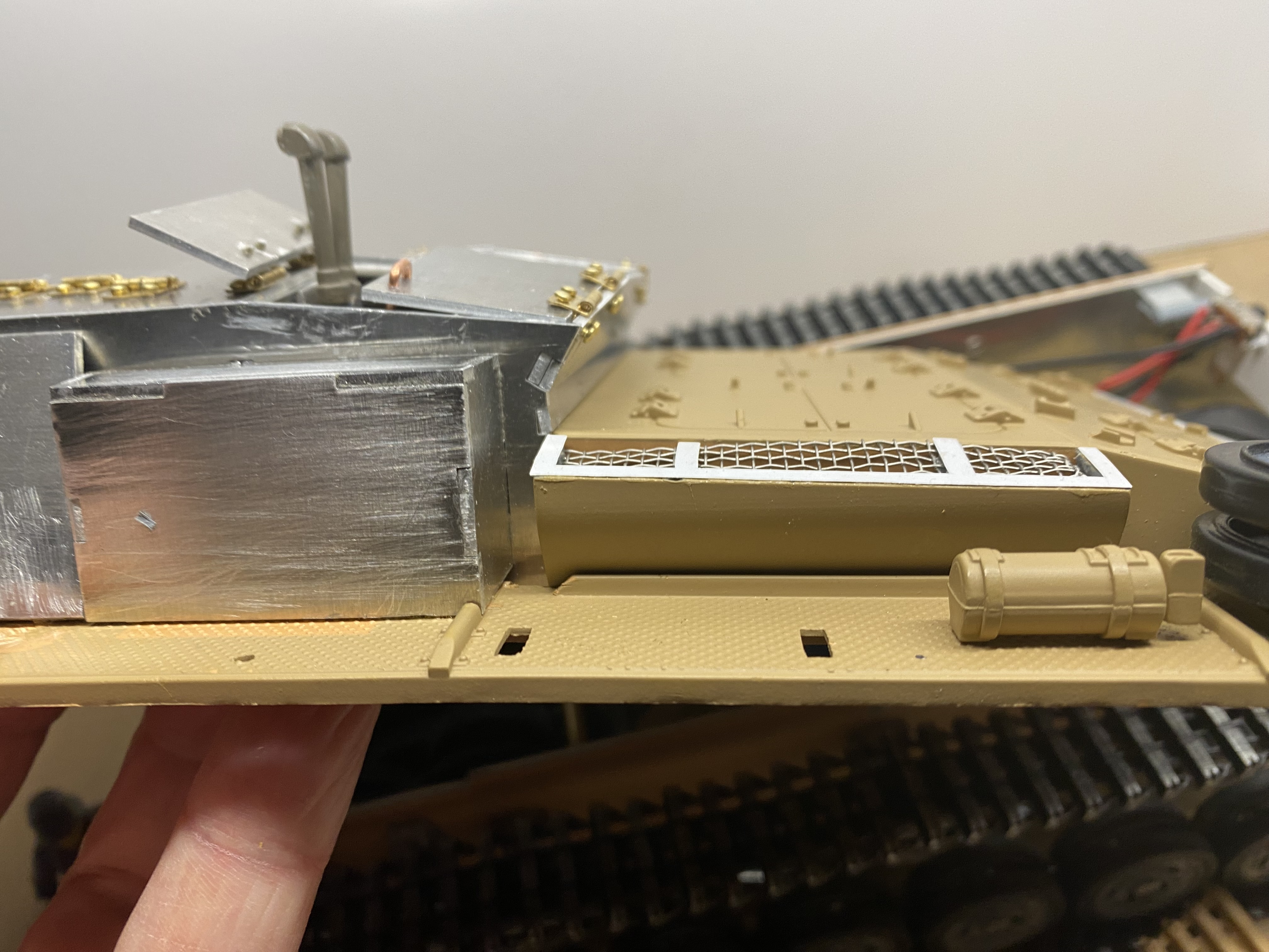

On the left track there was a spot where one tracklink did not go over the teeth of the sprocketwheel.
So the track had to come off and I noticed a burr on the tracklink.
Took it off and everything runs nice and smooth again!
While I had the tracks off I tried the small tracks just to see the difference.
Hmm….I do like both versions to be honest!
I also added the Notek and one small headlight
And I had a Scherenfernrohr for the commander

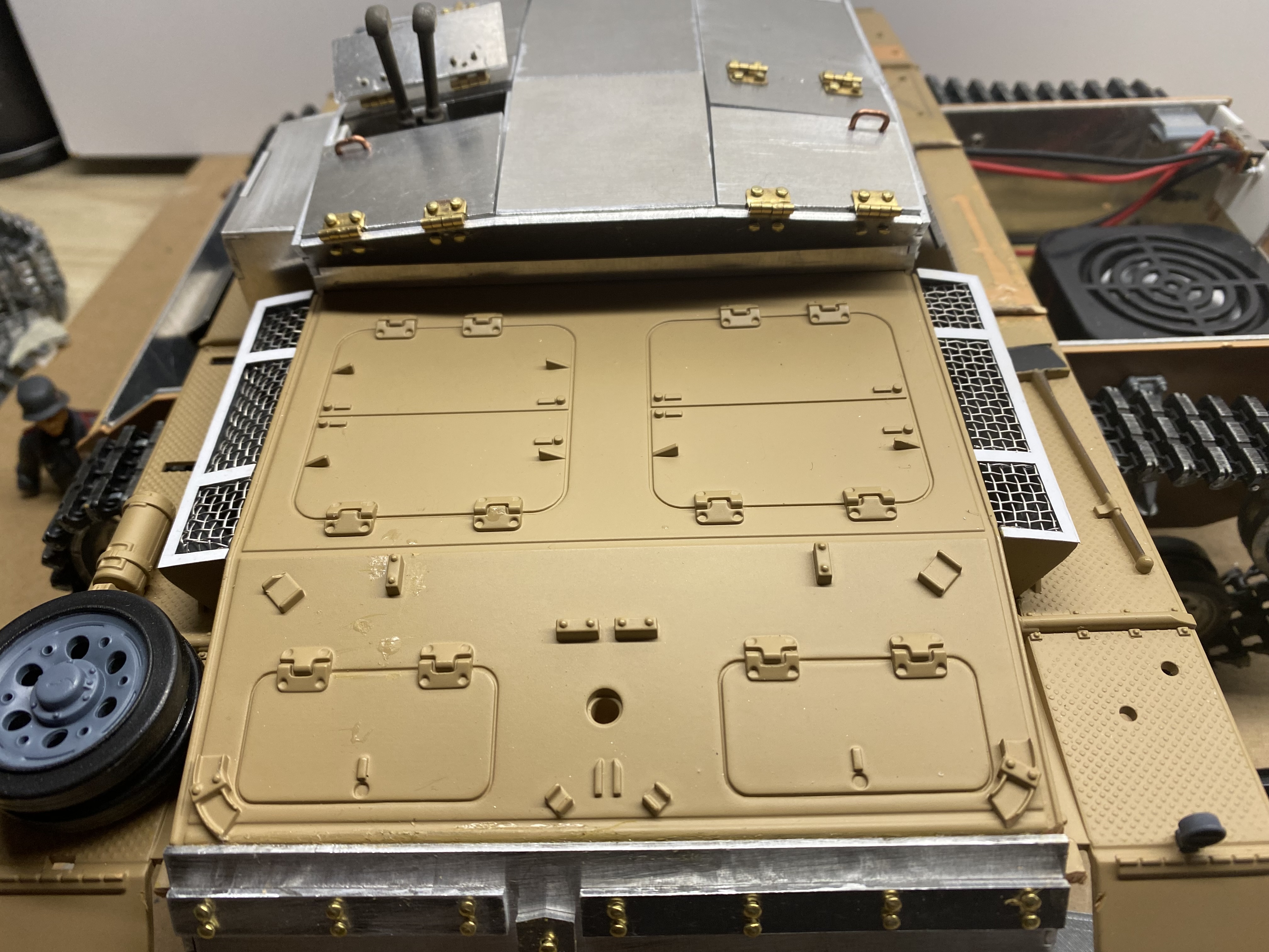

As mentioned before in this thread, made the grills out of a kitchen sieve and covered it with cutouts from a plastic card.
