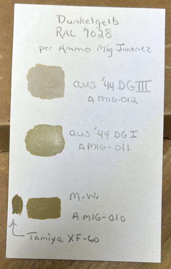

Sometime, somewhere (at an age far-far away) I made two samples of three (there were likely more) of the variants of RAL7028 Dunkelgelb. The paint on my WCP SdKfz. 251 seems to be quite close to the Ammo by Mig 010. That gives me some range of date possibilities.
3 RAL 7028s.jpg (289.56 KiB) Viewed 1796 times
The SdKFz. 251 A-B-C's were early, so many were only Dunkelgrau, but I wanted to do Dunkelgelb with camouflage. I am open to suggestions.

I used Tamiya's newer XF-88 and XF-89 (XF-90 is the brown for tri-color) on my Panzer III build. It only comes in the mini Tamiya bottles and not as a spray. It's much better than XF60.
Link to mine painted with Tamiya XF88 and XF89: viewtopic.php?t=33231&hilit=mato+panzer+III
Not my video, but a good review of the mini colors for German armor.
