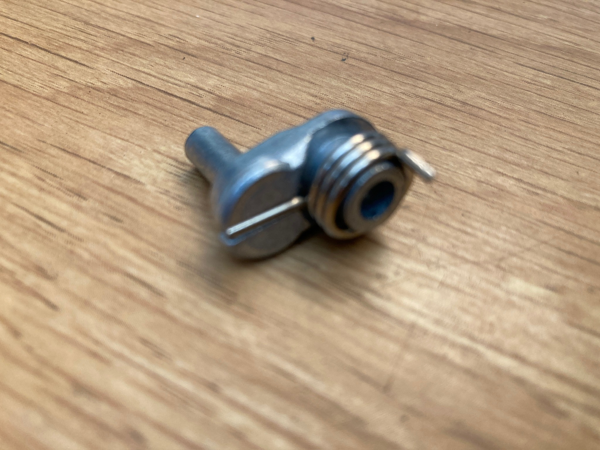

The steel pivot axle for the cast return wheel housing and cast axle assembly is held in place with a 2.6 x 6 machine screw on each end to retain it in the cast housing (inside) and to retain the cast front return wheel on its outside end.
The coil spring has a leg that engages in a slot on the axle casting and a "leg" on the opposite side that engages in a hole in the main casting housing. There are 6 holes to plug the spring "leg" into to allow different levels of tension to be applied to the coil spring. The whole assembly feels a bit "loose" when it is completed . I need to take a look at the RTR Centurion to see if I have made a mistake in the way that have put it together, but I think it can only fit the one way.
When the assembly is completed, one bearing is slid onto the cast axle to act as the inner wheel bearing and this slid on. These cast axles are a good fit with the bearings that just slid-on to them. The other wheel bearing sits into a hole in the outer side of the cast return wheel.......or at least it should do!
The outer wheel bearing will not fit into the deep hole in the outside of the cast return wheel. Firstly the hole has a smaller diameter than the bearing width (!) and secondly, there is a blob of unwanted cast alloy right on the base of the hole (it should be flat to allow the bearing to sit squarely on it) - so even after opening the hole out to be wide enough for the ball bearing to fit into it, the bearing cannot sit flat at the bottom of this hole as the small lump of alloy casting "flash" will be holding it up away from the base.
I will take another look at this in the morning, but I don't really want to have to mill or drill out this hole to make it wide enough, or use an end-cutter (in a milling machine) to machine a flat base for the bearing to sit onto. There must be a simpler way of doing this that I will find.
To date, this has been the only part of the KIT build so far that has caused me any real concern - but any problems will no doubt be resolved after they have been given "a good coat of looking at".
The way I see it I have two options . One is to ask HAYA to replace the front return wheel castings (both are too tight for the bearings to fit into), and the second is to find a way of correcting it myself - preferably in a simple way without the use of machine tools.
Thinking about these wheel castings some more - I had to file away a small lump of hardened metal to get the wheel halves to fit together correctly. The type of alloy used to cast these parts is quite hard and so it was not easy and took some time to file away using the end of a small diamond file to get in-between the raised studs (no access for a flat file).
The small hard lump of metal that need's to be removed from the base of the hole also looks like a little blob of molten metal has dripped onto the casting and set hard......not sure how that could happen, but they need to be removed.
Hole too small for the bearing and not flat at the bottom top left (see lump of casting flash).
The assembly feels a bit sloppy
This is how the coil spring fits onto the cast front axle stub

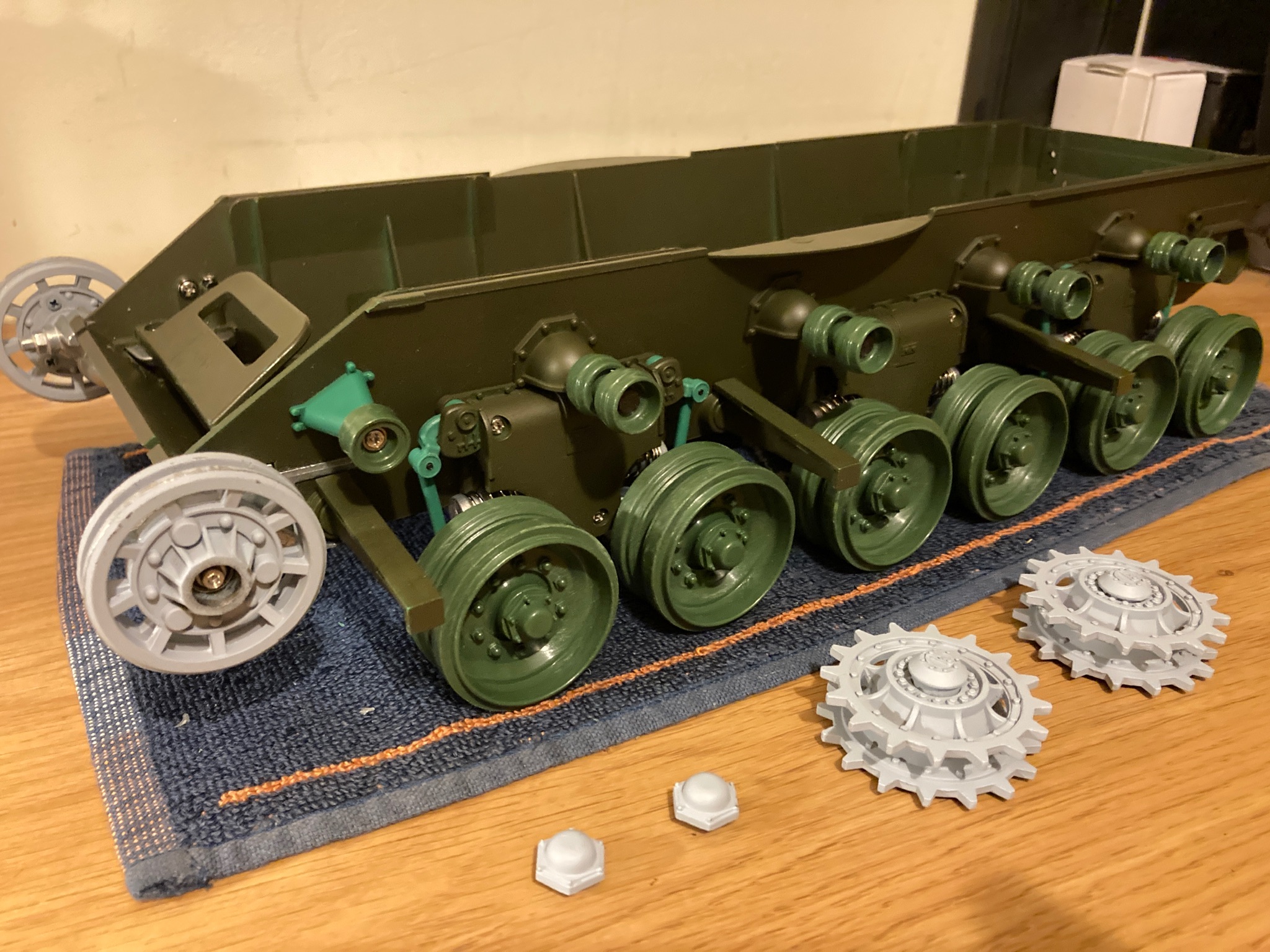

HAYA Centurion KIT. Front Return Wheels Fitted.
Post by zooma »
The alloy front return wheels have now been fitted using m2.5 x 7mm stainless steel cap-head screws with a single 2.5mm stainless steel washer under the head. I ran out of the specified kits 2.5 x 5 machine screws, but these cap head fitted and work well and I actually prefer working with a hex-head screw rather than the cross-head types.
I removed and re-fitted the cast front support assembles from each side of the hull and following some small adjustments they no longer have any 'free-play" but fit nicely together and move freely so now I can move-on to fitting the motors and gearboxes along with the rear sprockets to complete the lower hull mechanics.

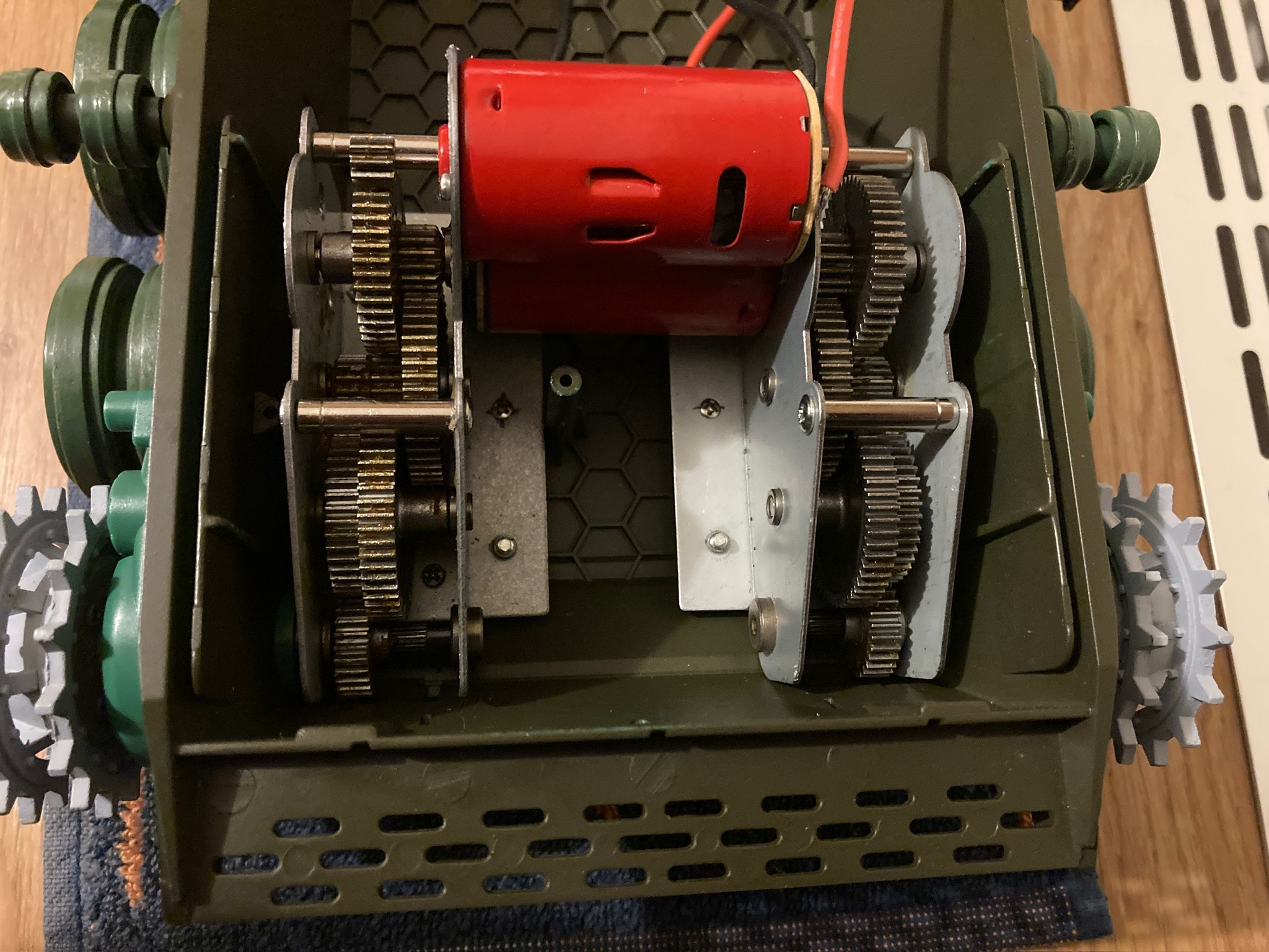

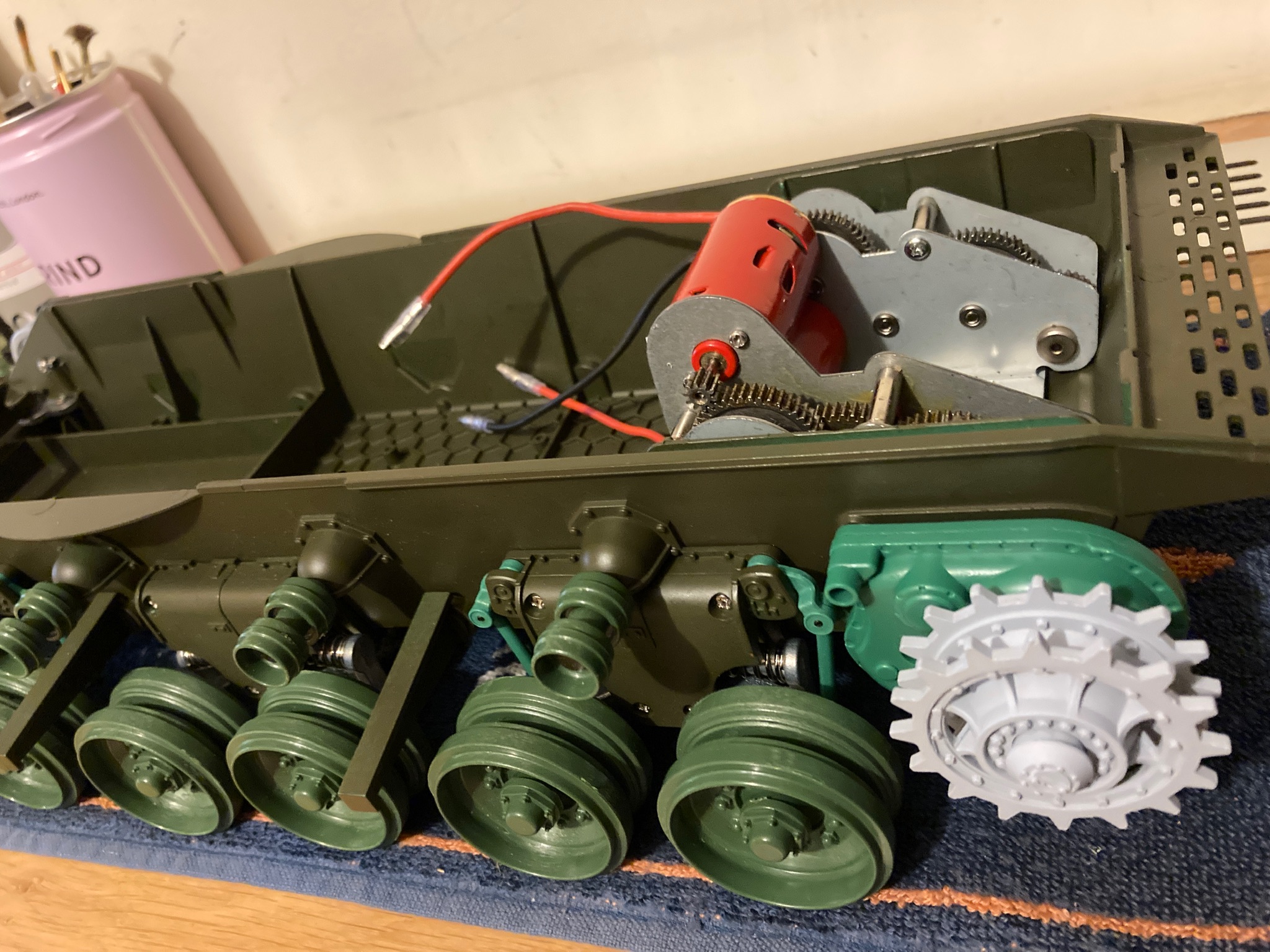

Post by zooma »
I have test fitted the RED motors, and fully screwed them into position ( x3 2.6 x 6 STS screws in each motor mount into the chassis) in the hope that once they are secured a slightly bigger gap would open-up between the lower motor and the gearbox next to it in particular.
This did not happen (!). I was advised that I would have a 1mm gap between the lower motor and the gearbox side closest to it - but I think it is closer than that!
I made sure that the solder joints were as flat as they could be to the rear of the motor and the tabs that they were soldered to were as flat to the end-cap as they could be - but it looks very close.......but maybe not actually touching!
A piece of thin plastic card will be pushed in-between the lower motor and the gearbox side that it (almost) touches and I am hoping that this will provide some insulation in the event that any movement when the tank is moving will be absorbed to stop the motor actually touching the metal gearbox side and shorting out.
Sadly it all has to come out again in any case. When I turned the sprockets the gearbox with the lower motor mounted to it was very tight to turn over, whereas the gearbox with the higher motor mounted to it turned nice and freely so I need to make a look at the tight gearbox to find out what is wrong and correct it.
Close Fit !
Close Fit !
Gearboxes have to come out again.

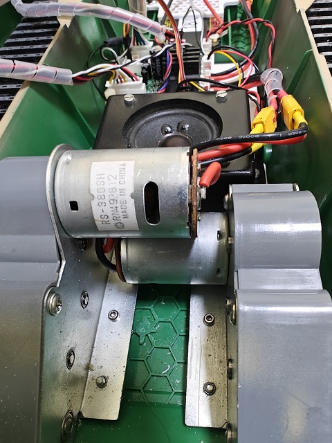

zooma wrote: Wed Sep 11, 2024 10:01 pm This did not happen. I was advised that I would have a 1mm gap between the lower motor and the gearbox side closest to it - but I think it is closer than that!
Yeah, I will suggest don't risk it. it is too tight of a fit.
This is what i had in mine.

Your installation looks "safe" and to be fair I am not looking for a racing Centurion - just one that has enough power to run across my lawn without stalling.
I think when I remove the gearboxes I will try fitting the BLUE motors. My RS-380SH motors don't have the same backplate as the ones you have pictured - but the BLUE motors do, so maybe they are the same (or similar) with a coat of paint? I will fit them anyway and hope they have more power than the standard motors that come fitted to the gearbox.
