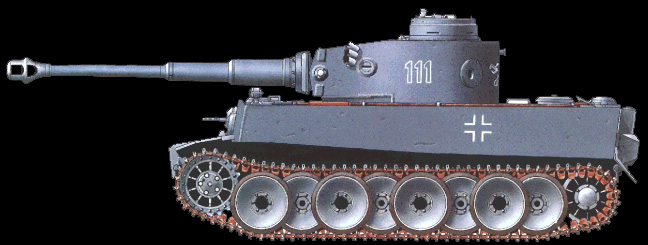

:) Hello,like this one? No turret box, no Feiffel filters, 2 front headlights of the tank, tank commander hatch with vertical opening, and smoke traps at the upper chassis angles

Jofaur86 wrote: Sat Aug 17, 2024 10:23 am :) Hello,like this one? No turret box, no Feiffel filters, 2 front headlights of the tank, tank commander hatch with vertical opening, and smoke traps at the upper chassis angles
Yep. I like it!
