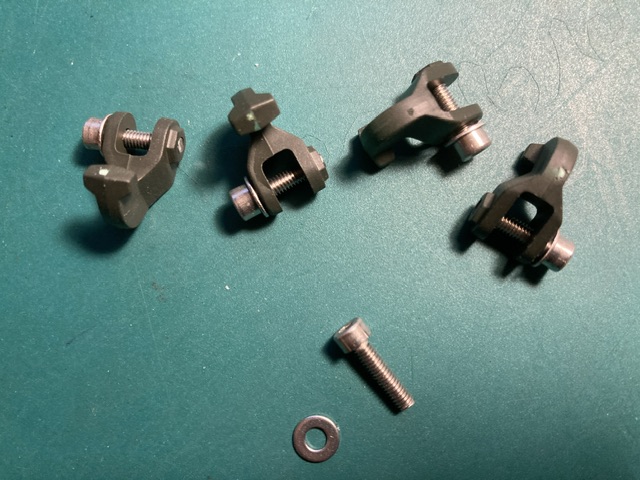

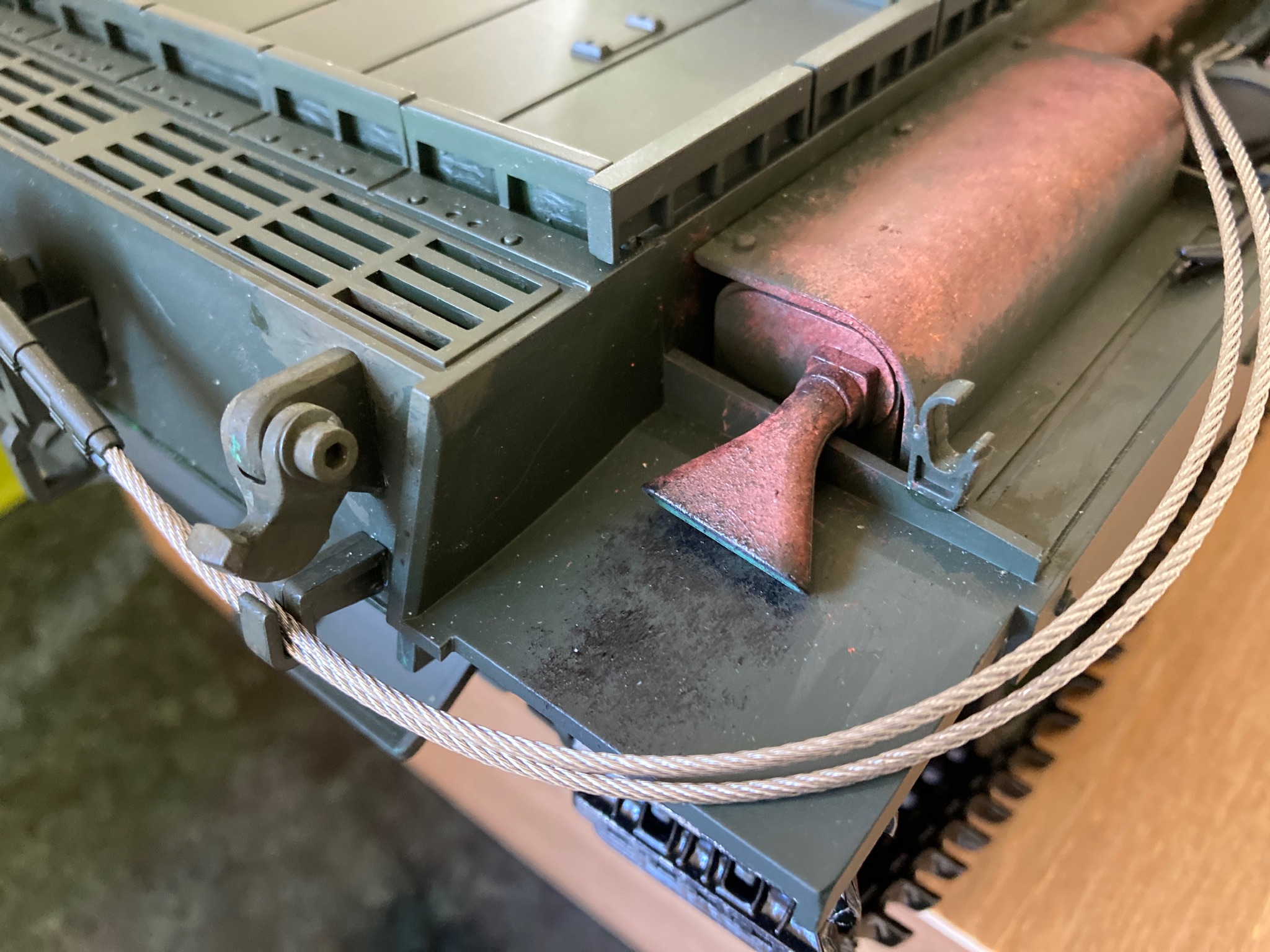

I am just finishing adding the small parts from the various sprues to my HAYA Centurion.
This has taken a lot longer than it should as there are no references to some of the parts or any diagrams to show where they all should fit.
There are no axles to fit the 4 parts D1 - D4 (heavy duty hooks).
One pair of these heavy duty hooks swings on the two front brackets (no part number as these come already fitted) and the other pair fits on the two back brackets (part K1 and K2) of the tank - one on each side. There are no axle moulding in my kit but the drawing of the sprue TK-16103 shows parts R1 - R4. These are missing from my sprue, but they look very much like they could be the 4 axles that I am looking for?
I have dug-out some 2.5mm x 10mm stainless steels cap-head screws from my model engineering stock and with a 2.5mm stainless steel washer they will do the job, but they do not look especially scale-like so I have ordered some button head replacements as they will be a lot less visible.
The cap head screws hold the heavy duty hooks on OK, but they are only being used as nothing was supplied with the tank to do the job. The button head screws have not arrived yet, but they will look a lot neater, but probably not be as good as the correct moulded parts - although never having seen them, I don't know how much better they would be.
My next job will be to get some paint on the tank to cover all the "lumo green" plastic that the plastic parts have been moulded in. I am experimenting with a base coat to try to imitate the rust on the top areas of the exhaust. Painting has never been something that I am any good at, so I will try out some ideas and see if I can get any better at it,

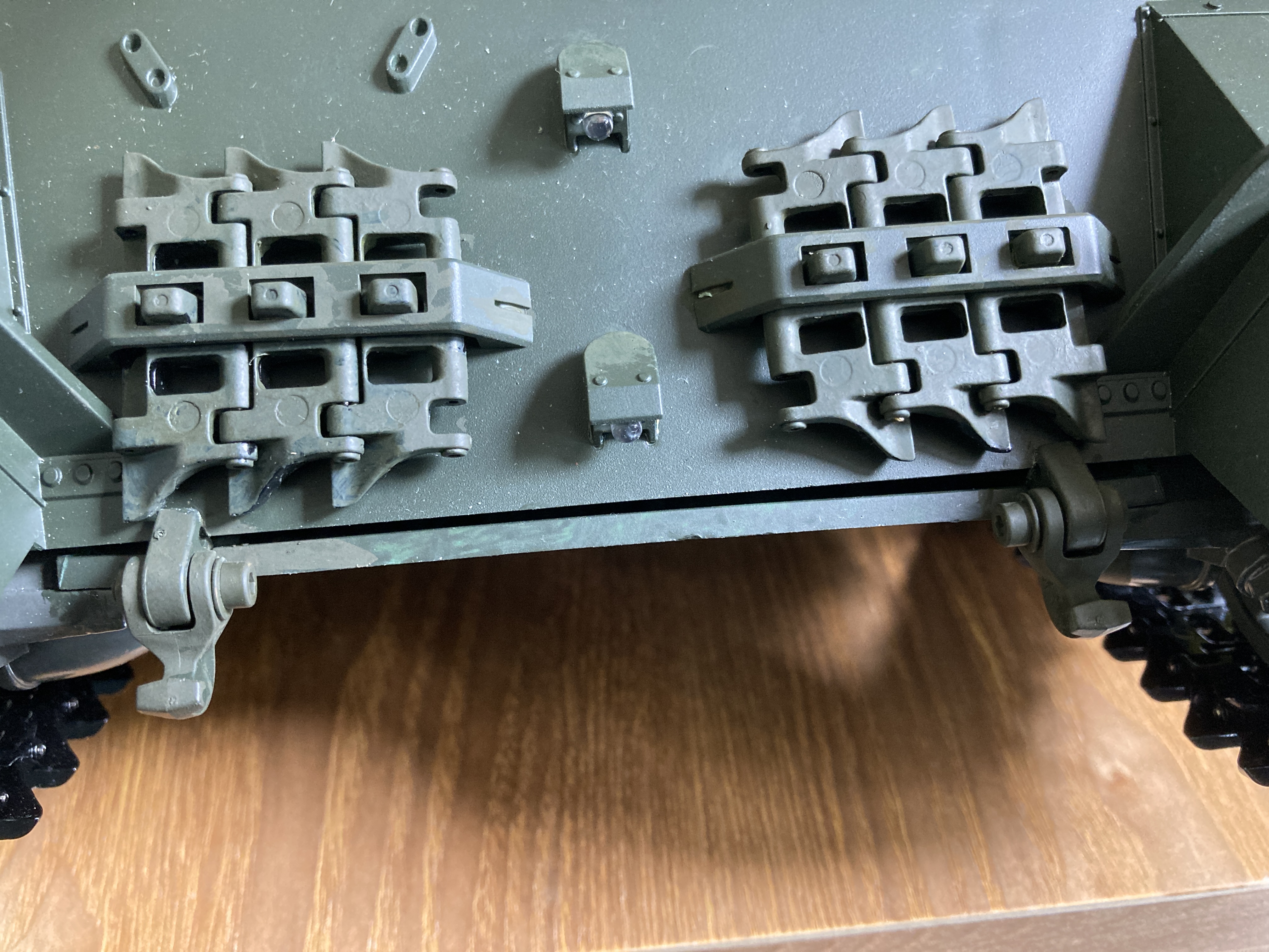

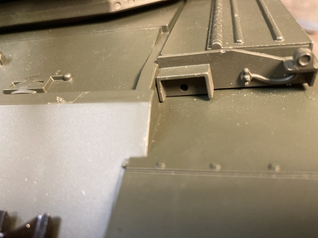

HAYA Centurion Mk3. Square Shroud ?
There is a small square armoured (?) shroud on either side of the glacis plate and each one has a hole in it that suggests that something should fit in this hole.
Nothing is shown on the drawings that are in the instruction manual, but the line drawings of the tank shows that something should be sticking out of them (small light/sensor maybe?).
The factory built fit of this part to the front mudguard is not very good and has gaps showing (as can be seen). I will check and find out how this part is fixed to see if I can remove it and fit it properly with no gaps showing - and if not, I will revert to a tube of GreenStuff or other suitable plastic filler. I hate to see gaps like this that shouldn't be there!

ongbenghui
- Private
- Posts: 99
- Joined: Sun Jun 18, 2023 6:43 pm
Re: HAYA Centurion Mk3. Square Shroud ?
It is a handle bar, check out on your kit.zooma wrote: ↑Mon Aug 12, 2024 11:23 pm IMG_4250.jpegThere is a small square armoured (?) shroud on either side of the glacis plate and each one has a hole in it that suggests that something should fit in this hole.
Re: HAYA Centurion Mk3. Pull Handles.
Thanks ongbenghui - I see these two "T handles" on a sprue will get them fitted now.
They are not shown in the building manual that comes with the ARTR HAYA Centurion, but (I now know!) that HAYA put their assembly instruction videos "online" for the kit version of their Centurion tank and (I guess) is why they don't offer too much detail about where any of the parts that are on the included sprue's should fit.
Reference to the two online building videos has helped to find a home for the small parts that come with the assembled ARTR HAYA Centurion.........and now that I have found the videos I have most of the answers.
Bob.
Bob.

Re: HAYA Centurion Mk3.Pictures of Pull Handles.
Thanks Guido - that's a very informative picture - nice close details.Guido Henn wrote: ↑Tue Aug 13, 2024 8:22 am Hello,
please have a look here: http://data3.primeportal.net/tanks/mark ... of_71.jpg
with regards,Guido![]()
It's the handle for the Fire Extinguisher!
Bob.

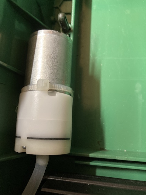

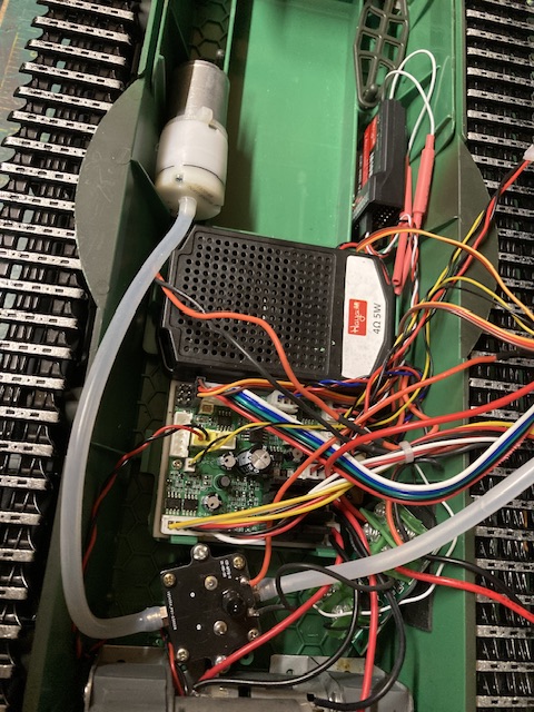

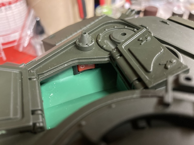

HAYA Centurion Mk3. Smoking Barrel
The smoking barrel combined with the muzzle flash is a feature that I really like on my HAYA Chieftain and Centurion tanks, however this has stopped working on my Centurion - even though I have not really had a chance to enjoy using it yet.
It did work the first time I switched it on - but it is not working now.
On the HAYA Centurion, there is a small red on/off switch (hidden under a hatch on the turret) that has to be switched on to activate the barrel smoke, and it is important to turn this off after each run as the heater will overheat if it is not switched off. (I also always disconnect the battery and remove it from the tank when I have finished running it) so I am fully aware of this and made sure that after my first run I made sure that it was switched off.
During my short test run today I switched on the barrel smoker but it did not work, but I noticed smoke was coming from inside the tank!
When I checked inside, the filler cover had been blown-off. When I picked it up it was very hot and limp and is now a loose fit and the reason for this failure is that the blower has stopped working so the heater is making the smoke and hot smoke was forcing the (limp) filler cap off of the filler pipe allowing the smoke to fill the inside of the hull, but the blower was not pushing the smoke out of the tube that runs inside the barrel.
The barrel tube was checked to make sure that it had no blockages but I noticed that the fan/blower did not work when the gun was fired.
I need a new filler cap as the original one became too hot and has stretched so it is no longer a tight fit and just falls off, and it looks like I may need a new fan/blower as well as the one in the tank has stopped working.
The barrel flash and gun sound is still working perfectly.
I will contact Andrew to see if he will send me a replacement filler cap and to ask if there s anything else that I can check before requesting a replacement fan/blower motor.
UPDATE:- The right hand dial on the TX controls the main gun barrel smoke - turning this dial switched the smoke back on again!
