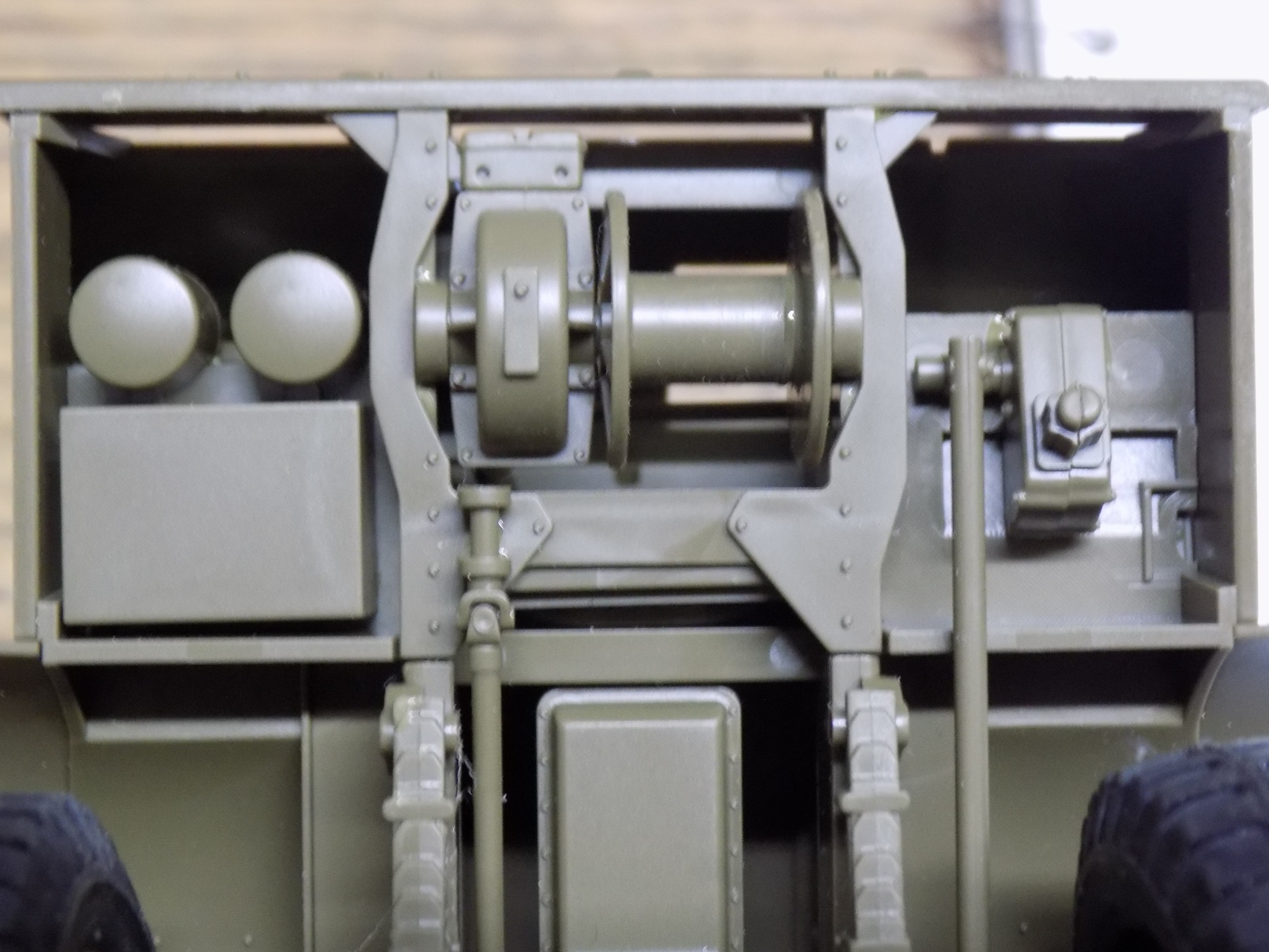

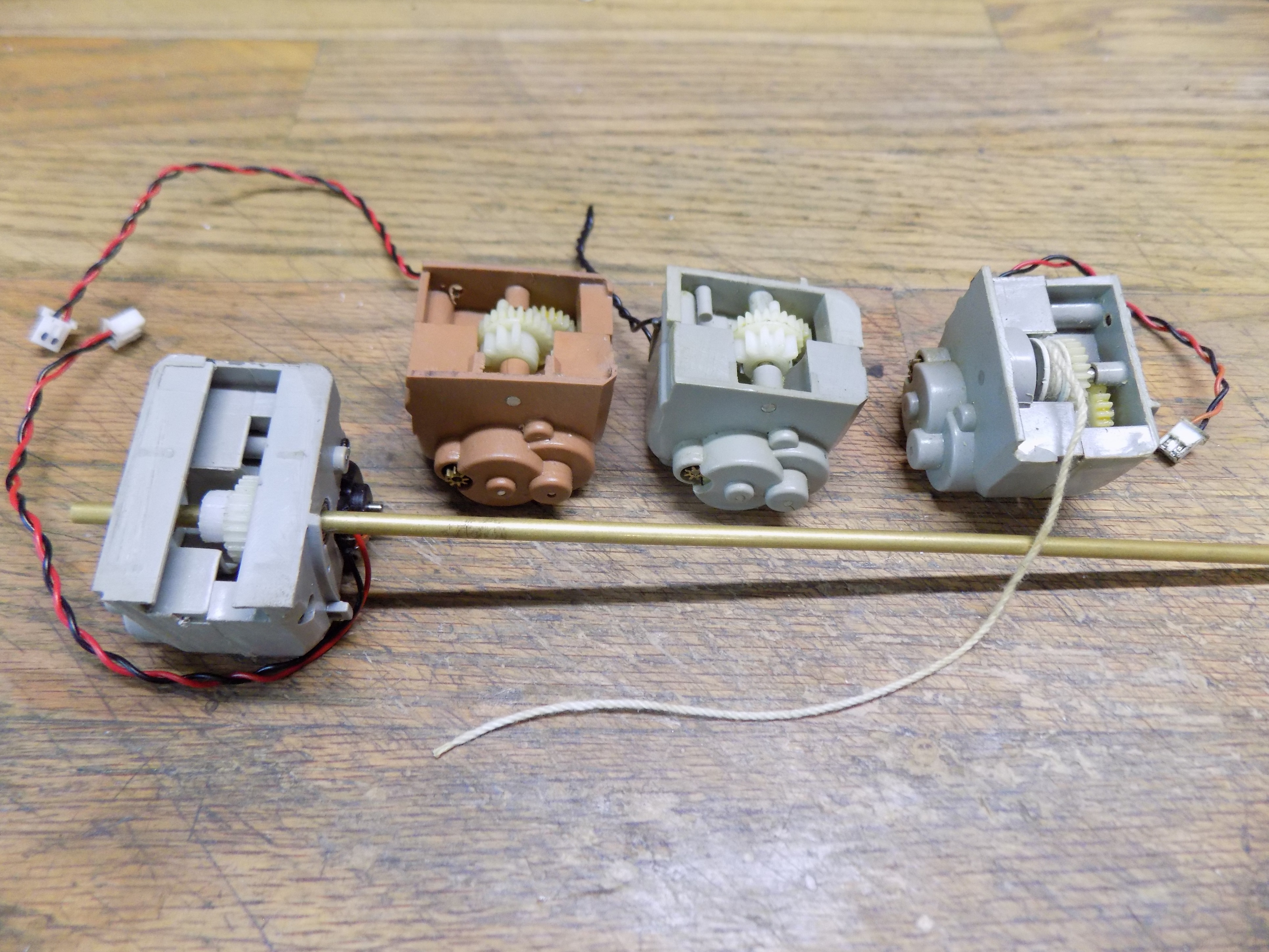

Some here might have figured out that I enjoy the mechanical aspect of this hobby. Since these M26/M26A1 recovery vehicles have three winches...
Scaling up the 35th kit it looks like there will be plenty of room to hide an airsoft motor as a drive motor for the front mounted winch (where the steering box is located and covered with a curved guard). The soft bodied M26A1 has a bit more room in this area over the armored cab. The armored cab's armor was tapered in toward the bottom of the cab (the soft cab was vertical). Those two round things on the other side are the bottom of the air cleaners.
I should be able to build a scale looking winch and use a drive link (drive shaft/dog bone) to power it through the frame.
I am bound and determined to make the other two operate, but will have to wait and see until later in the build to see where and how the motors will be (based on room left over).

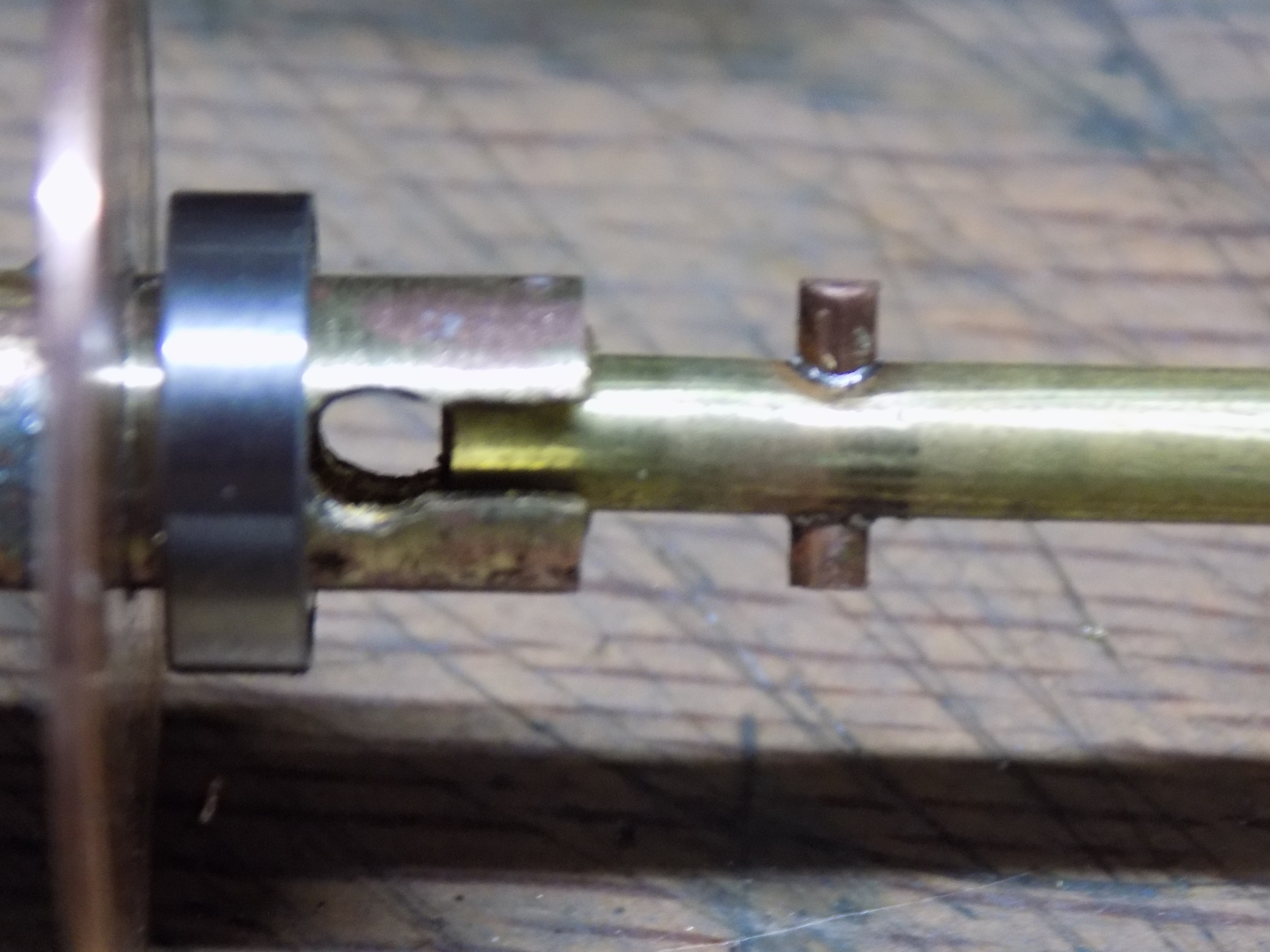

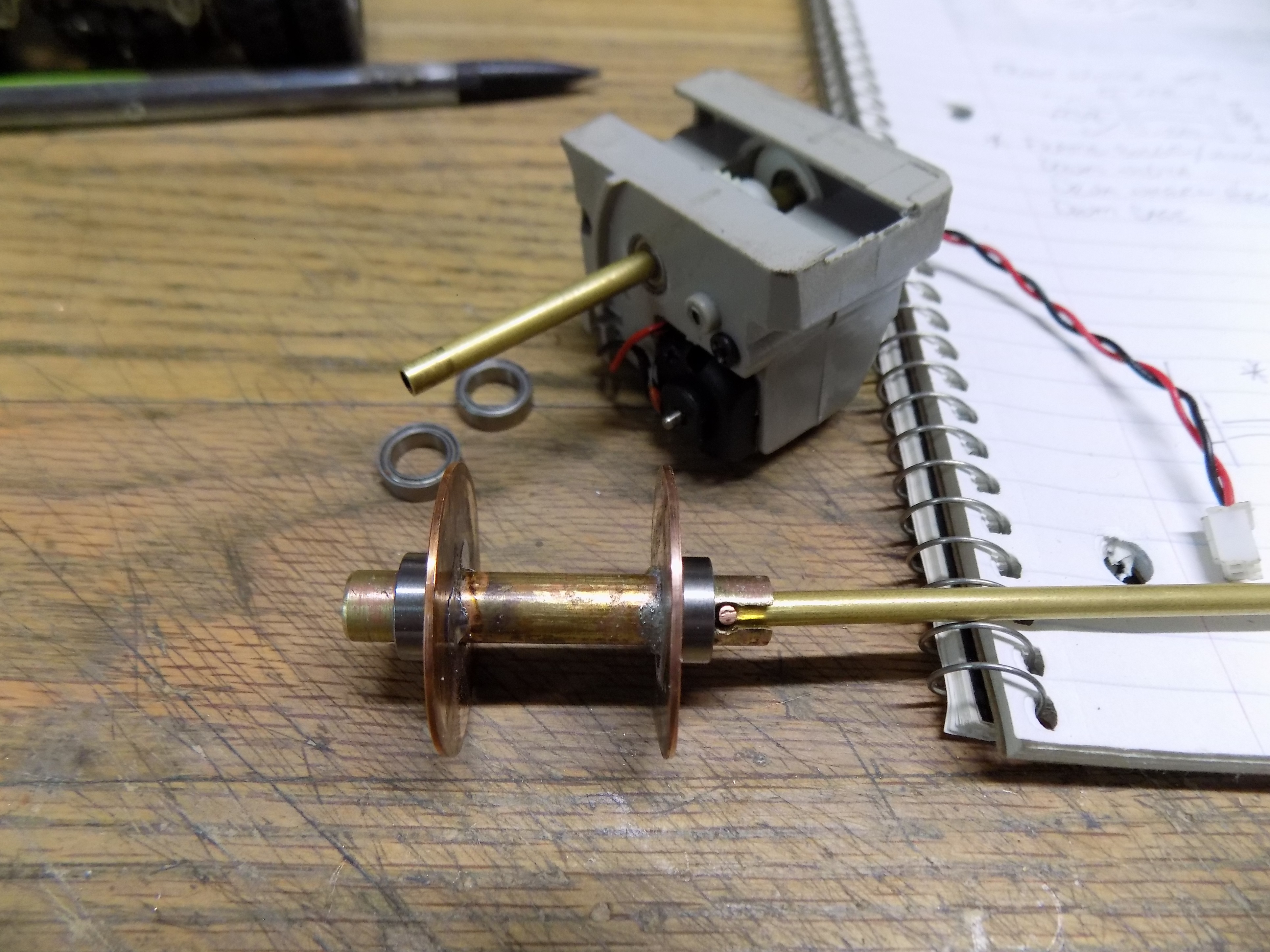

All metal winch drum this time. The brass rod is from an out door water faucet I replaced years ago. The dog bone provides a few degrees of angle and it will eventually get cut down and installed on the air soft motor. The drum ends are copper pipe that is cut open and flattened.
