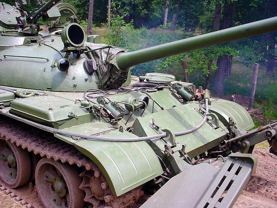

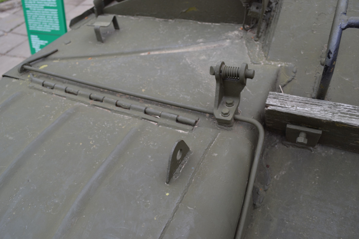

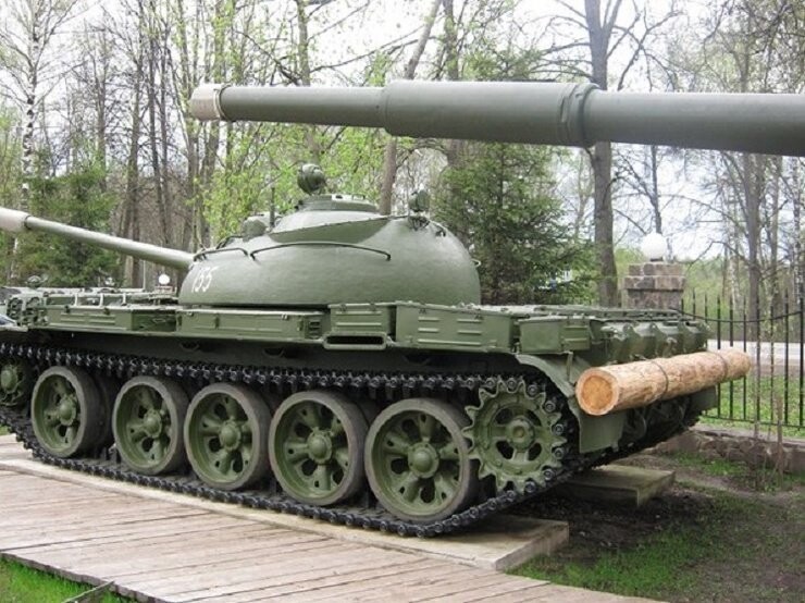

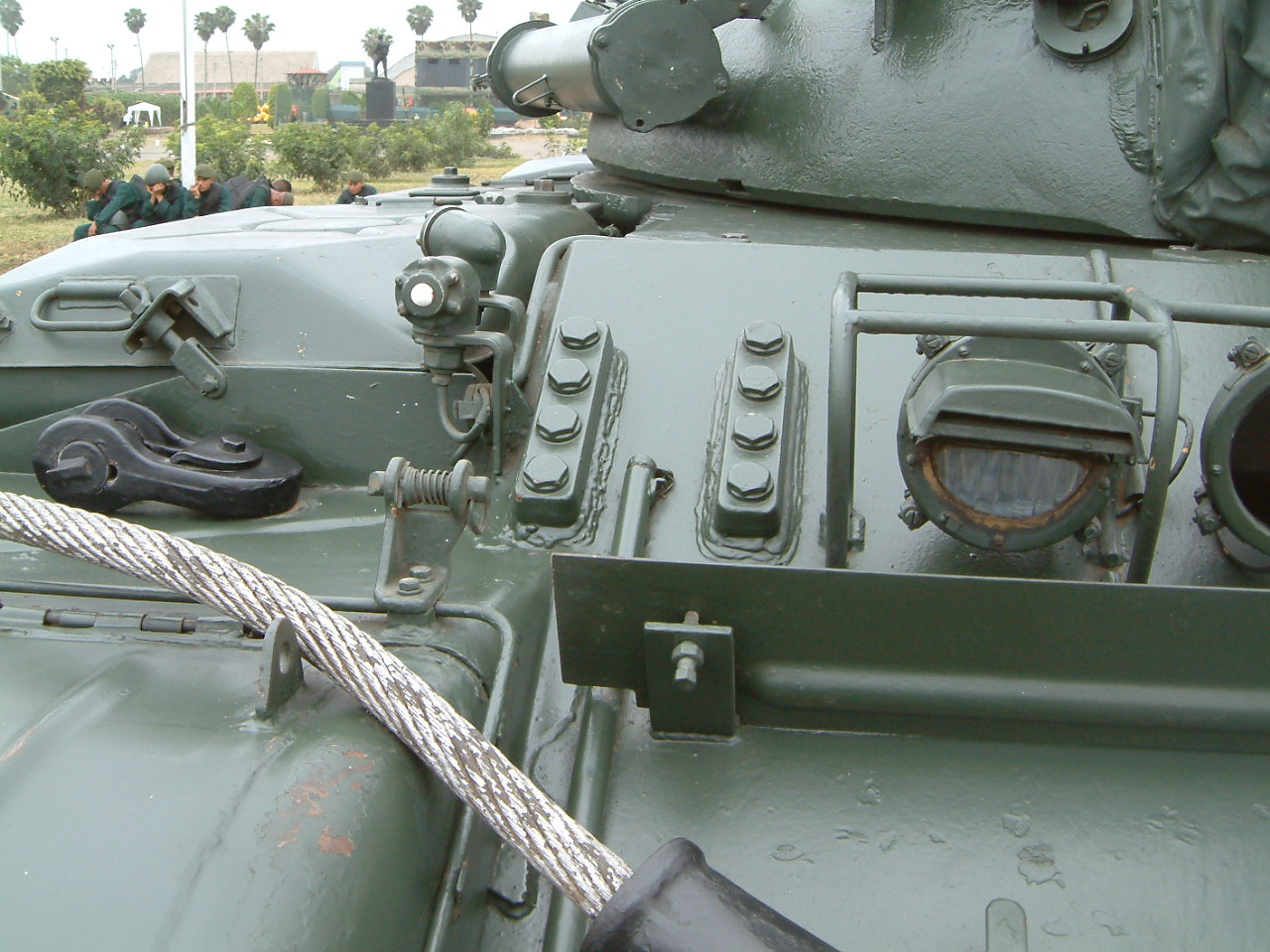

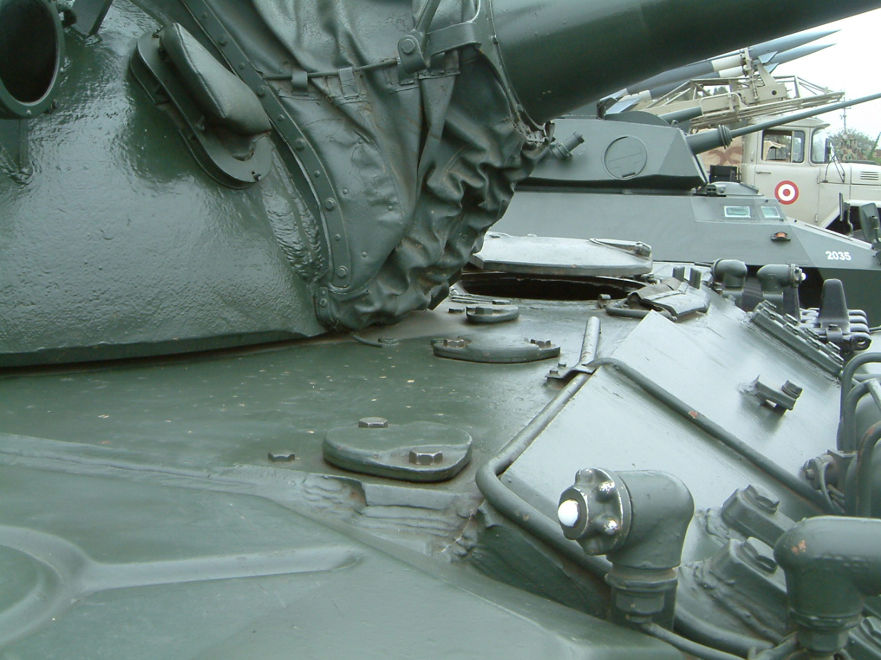

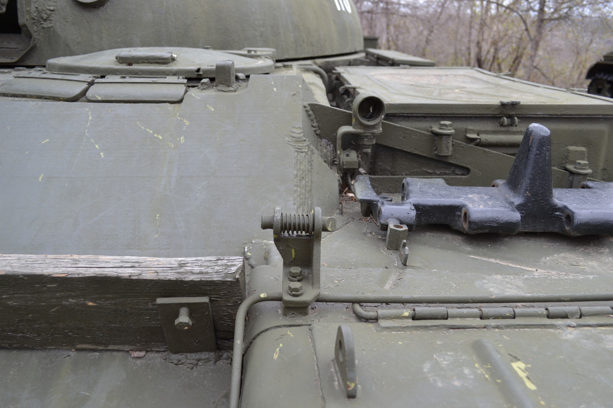

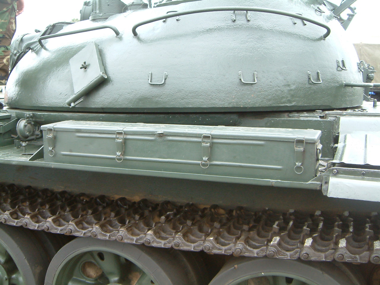

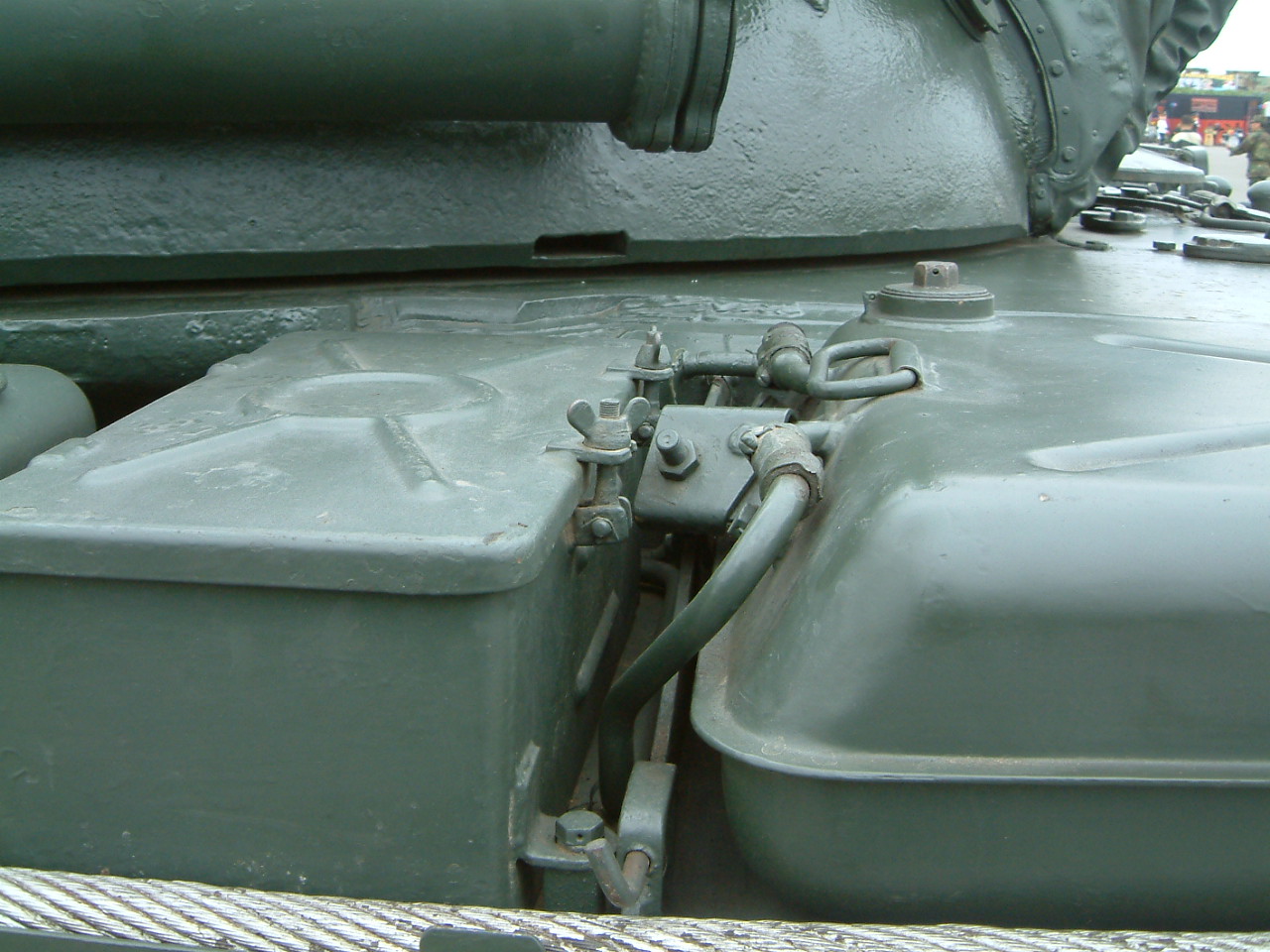

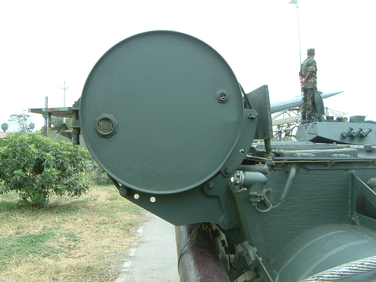

Those sticks that lie on the frontal armor are tubes, they are designed to carry an electrical cable inside in the mine trawl version.
Those strips with bolts on the armor, for fastening the trawl itself
I have a lot of photos of the T-55, maybe you are interested in something specifically, otherwise I can overload with information......
The log is supposed to be painted, it is supplied to combat units from factories - clean cylindrical.
The used log is not put back in its place, then they get a new one...

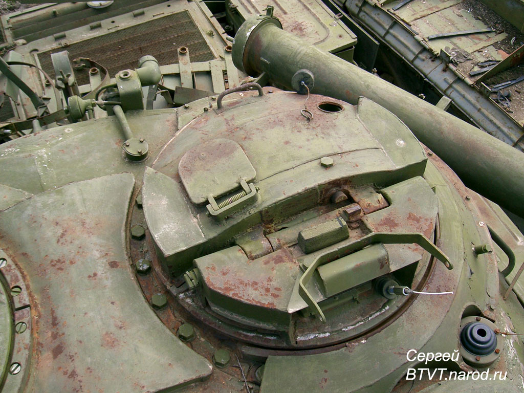

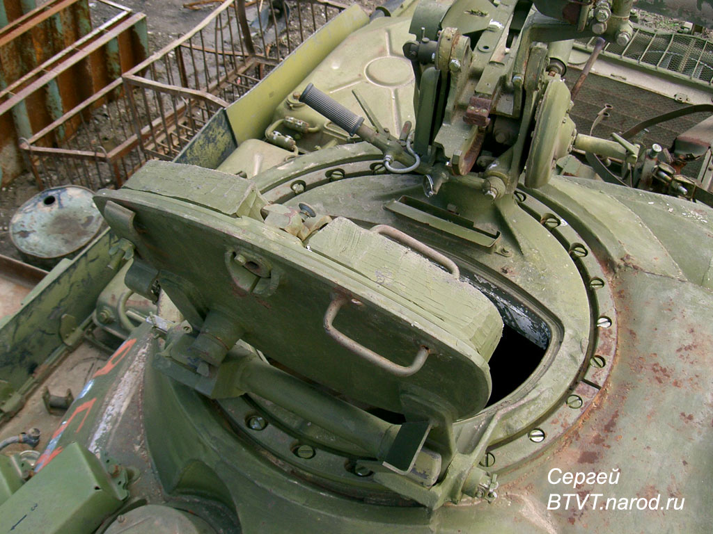

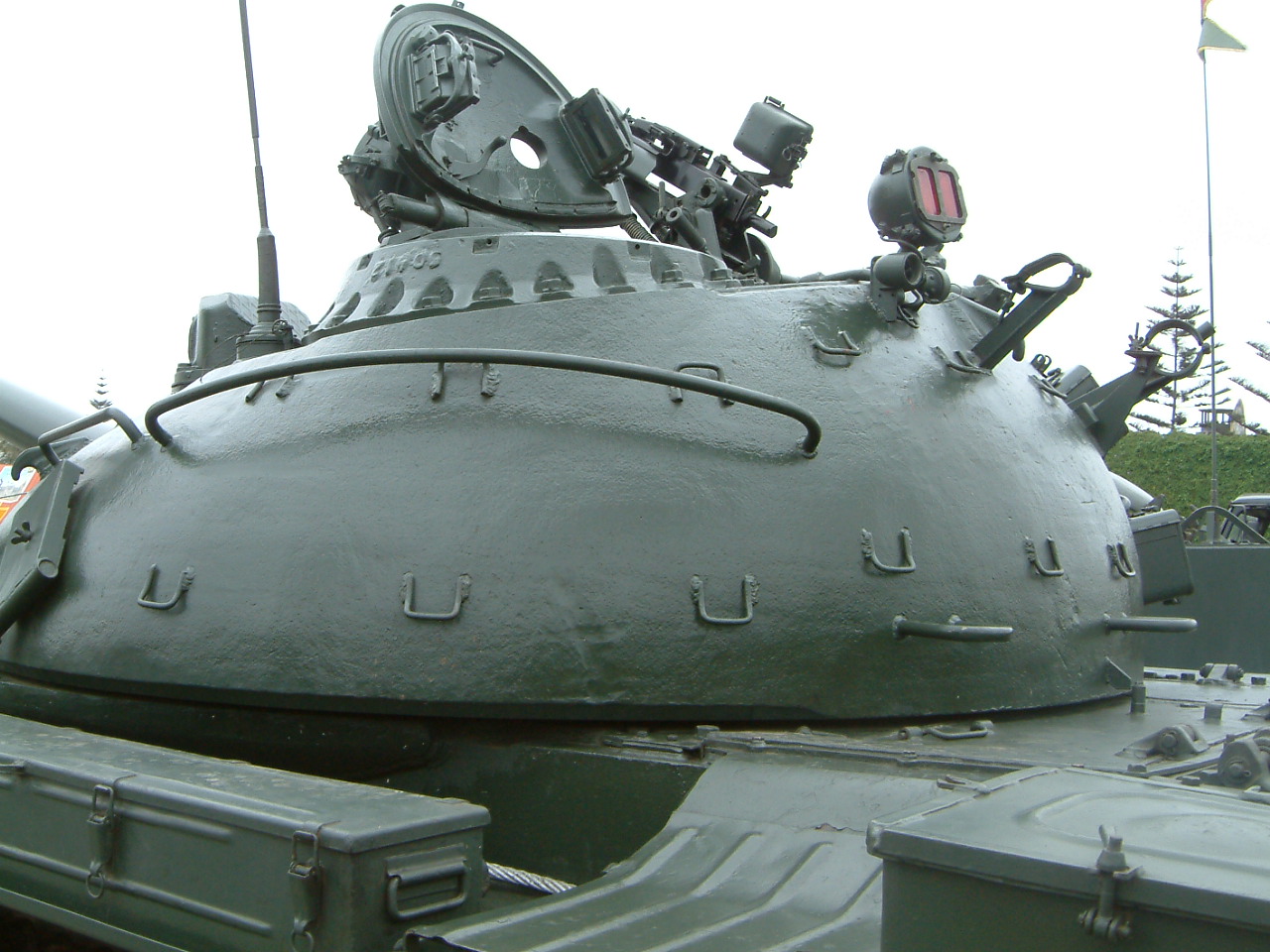

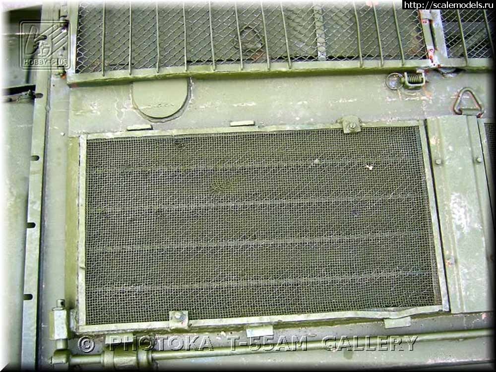

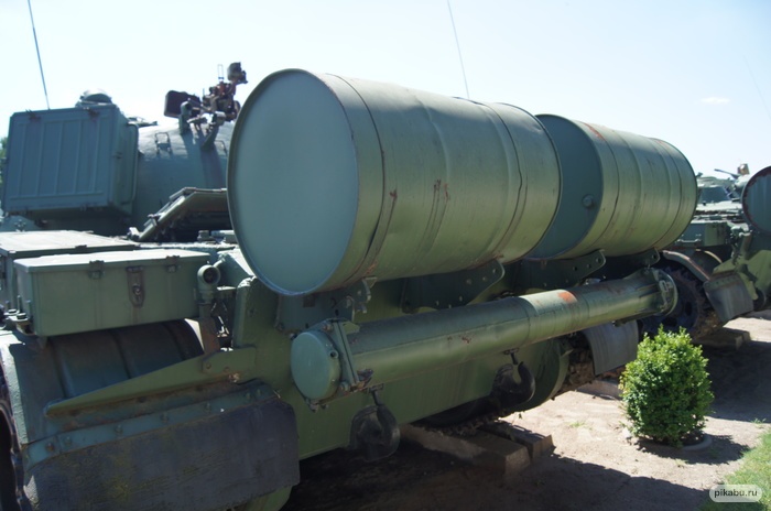

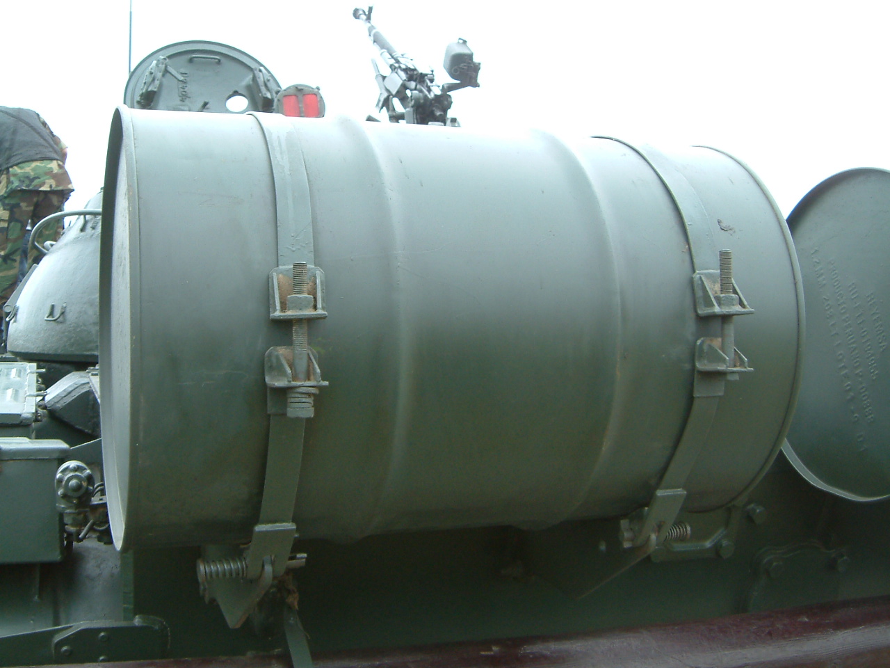

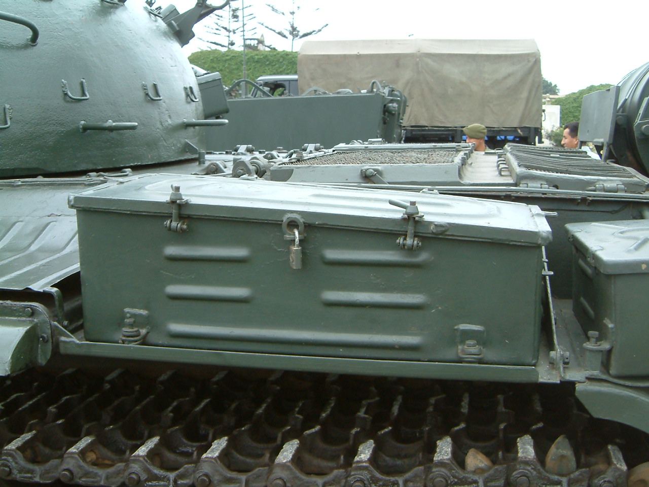

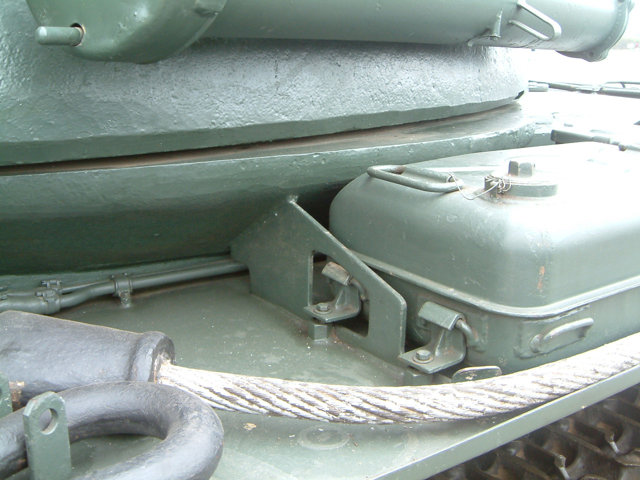

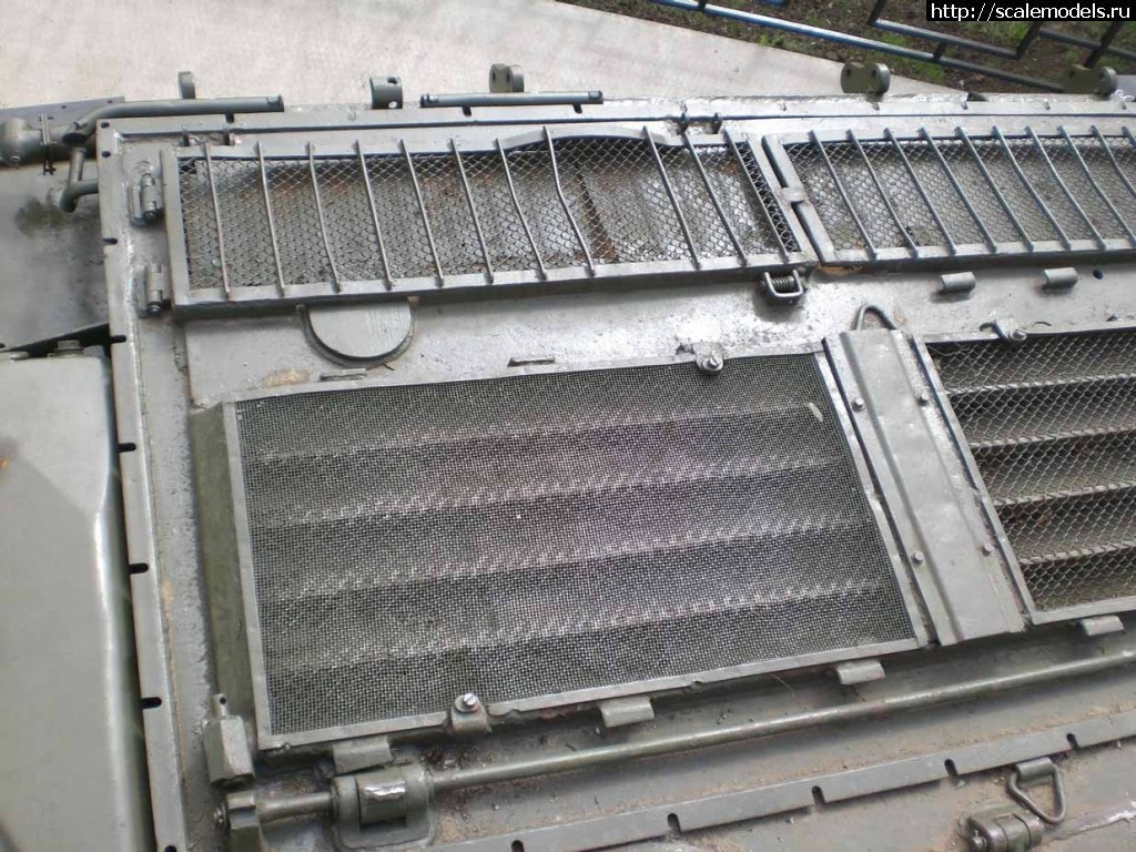

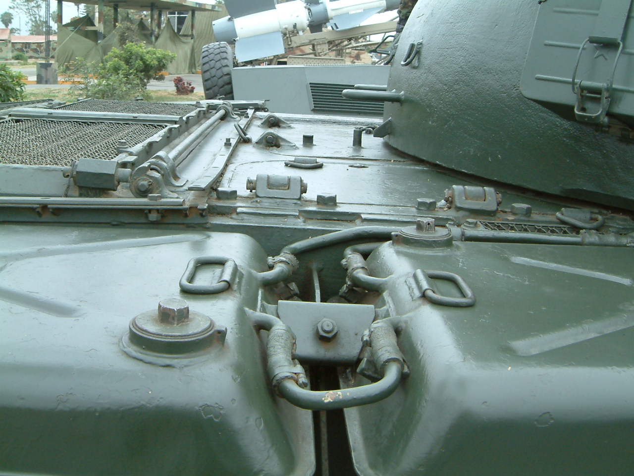

This one has been “slightly” restored.....
Yes, secret information...
The tank is painted at the factory, the optical elements are covered or sealed or covered with thick transmission lubricant, the machine gun is removed from the machine.
And I repeat, EVERYTHING is painted with paint.
if it is repainted in the combat unit, then even the spare tracks are painted over, everyone is too lazy to remove the cables too.
I saw lazy people who poured a bucket of paint and smeared it all over the tank......
t-55_20_of_45 (1).jpg (288.76 KiB) Viewed 1283 times
