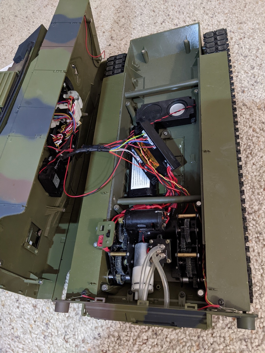

As for now, the bottom of the Abrams is mostly done to our satisfaction:
USMC HL Abrams internals.jpg (527.1 KiB) Viewed 2395 times
Glued in two aluminum support panels
Add two aluminum rigidity rods (tapped them so that small bolts secure them from outside the hull)
Added two higher-end ($60) steel gear sets + 390 motors
Added bearings for the two back drive sprockets
Upgraded the smoker to a $22 AliExpress model (will upgrade further here shortly)
Kept the stock speaker since more than loud enough for our needs
Removed the battery box and now have a flat space to lay the battery and Heng Long MFU
Completed our battery charging mod so that we can charge without removing the top hull
Keeping the 7.0 MFU for now, will be requiring new electronics here shortly for our A.I. needs
Placed magnets in the top and bottom hulls
Wired up the 360 rotation mod with zip ties
Still more to do .... And if veteran tankers here have suggestions for improving our rig further, by all means, let em' rip!

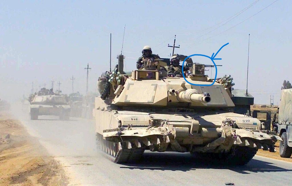

I don't think the Marines ever got an M1A2 with the CITV. There was a an HA version of the Abrams which the Marines had a different viewer system as seen in the pic. As far as I know, they never got the A2 CITV.
Marine abrams.jpg (133.95 KiB) Viewed 2365 times
With a resin 3D printer you could print your own Marine smoke dischargers:
https://cults3d.com/en/3d-model/various ... ischargers
You can see more pics of the box mounted where the CITV goes here:
https://picryl.com/media/us-marine-corp ... ove-6d0036
Re: Marine Corps specific Abrams build with A.I. plus Cannon Smoke + BB Firing + Barrel Recoil + 360 Degree Rotation
Posted: Sat Feb 10, 2024 9:49 am
by Aurelius
Wow, ... thanks Tankme! 3D printing it is! And digging a bit more, I suspect you are right about the CITV. I can't find any evidence that Marine Abrams ever got any of the SEP or TUSK upgrades, which is surprising given battles like Fallujah I and II. I will probably keep the CITV as is because I need the height of it to hide the crappy Wifi camera, although a funny idea is building in my mind about MEP3. :D More this weekend!
