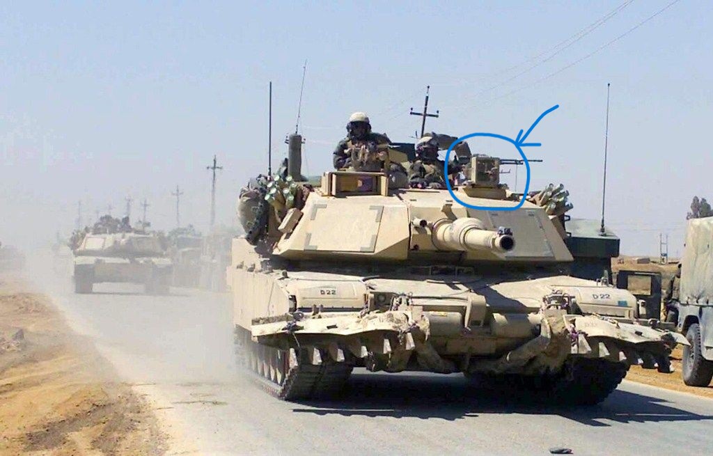

I don't think the Marines ever got an M1A2 with the CITV. There was a an HA version of the Abrams which the Marines had a different viewer system as seen in the pic. As far as I know, they never got the A2 CITV.
Marine abrams.jpg (133.95 KiB) Viewed 2359 times
With a resin 3D printer you could print your own Marine smoke dischargers:
https://cults3d.com/en/3d-model/various ... ischargers
You can see more pics of the box mounted where the CITV goes here:
https://picryl.com/media/us-marine-corp ... ove-6d0036

Wow, ... thanks Tankme! 3D printing it is! And digging a bit more, I suspect you are right about the CITV. I can't find any evidence that Marine Abrams ever got any of the SEP or TUSK upgrades, which is surprising given battles like Fallujah I and II. I will probably keep the CITV as is because I need the height of it to hide the crappy Wifi camera, although a funny idea is building in my mind about MEP3. :D More this weekend!
