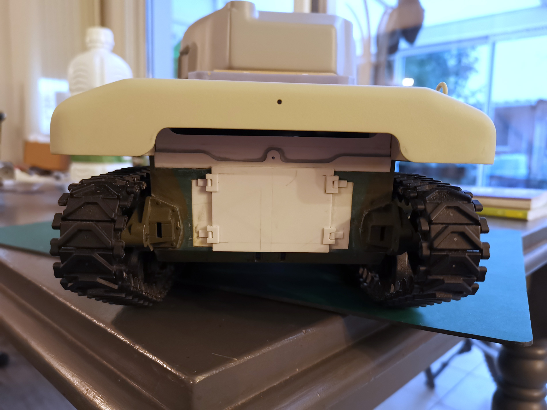

Here are some progress. I've started the rear engine doors, the hinges were meant to be movable but I changed my mind, I did not want to cut a large opening in the back of the hull to keep strength.
You can notice I made a new portion of the hull above the doors, it's a casting on the real sherman (like the angled portion of the hull btw), I will add texture later.

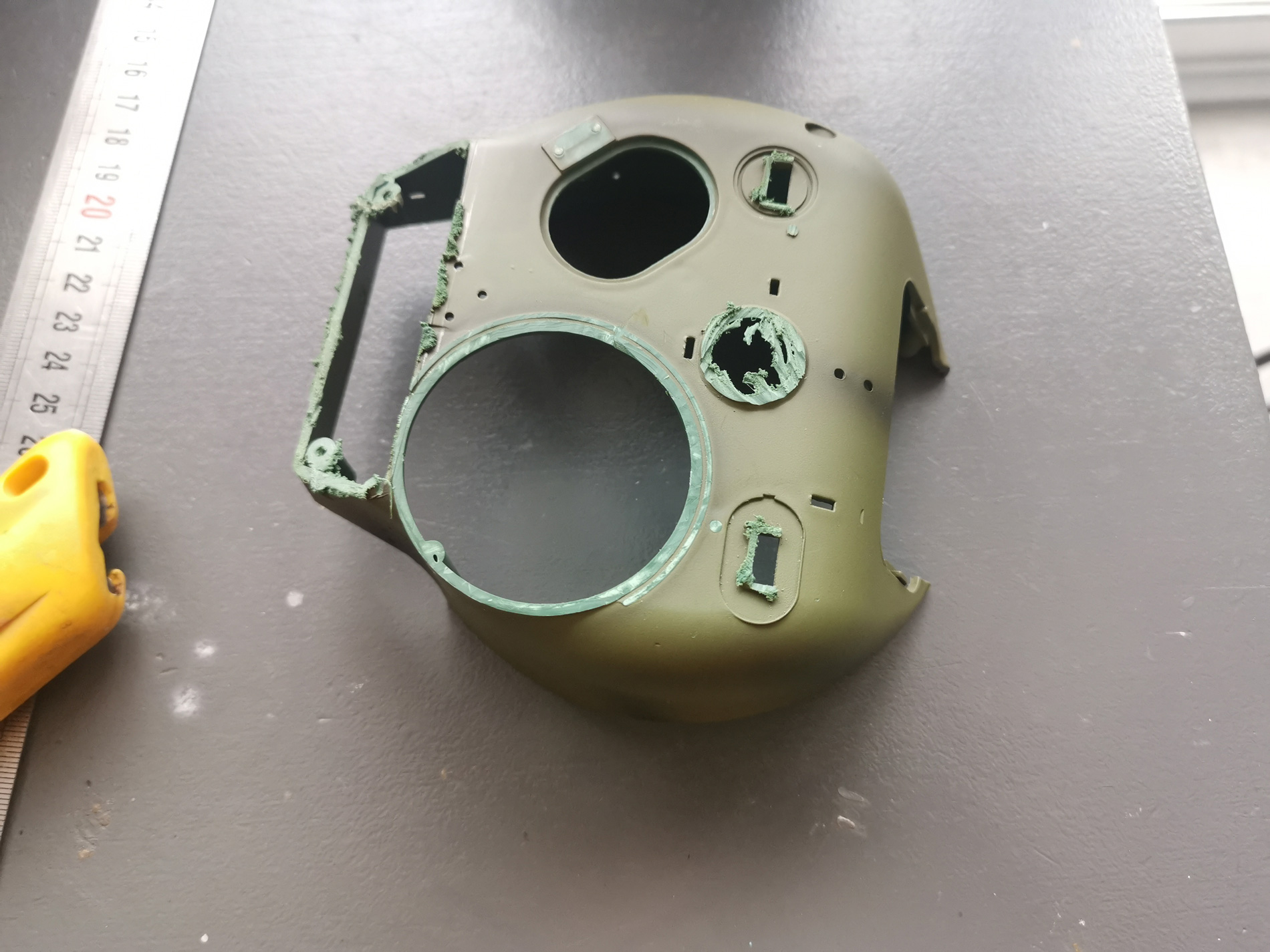

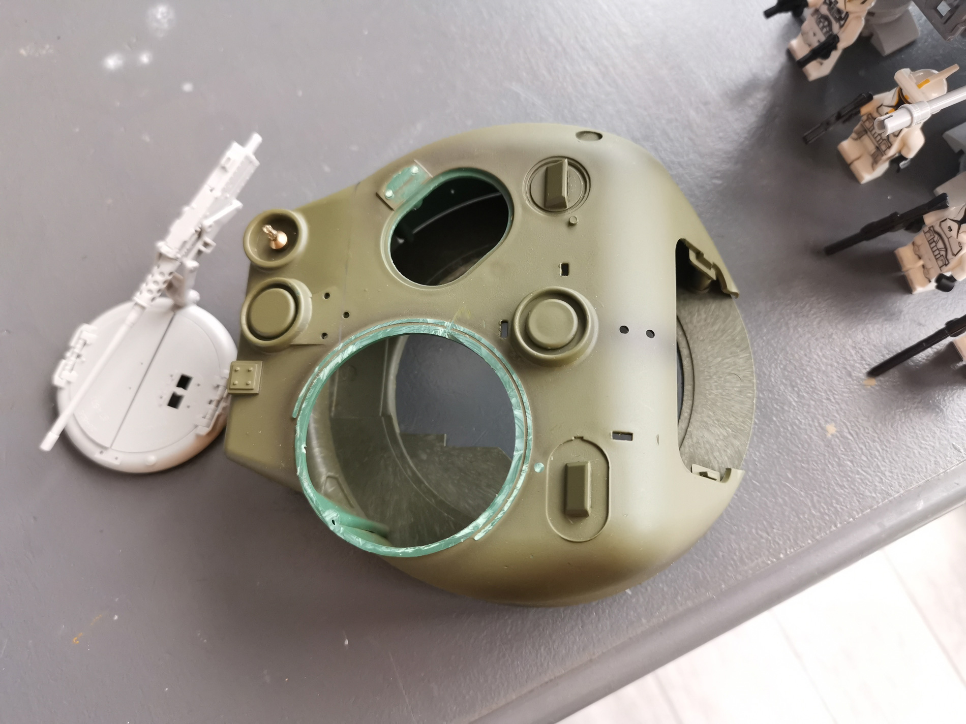

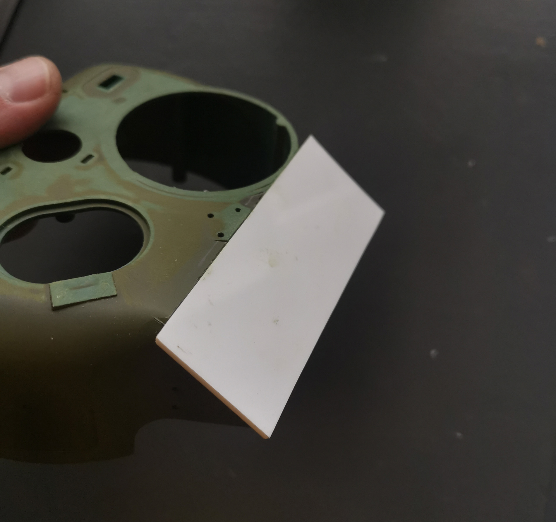

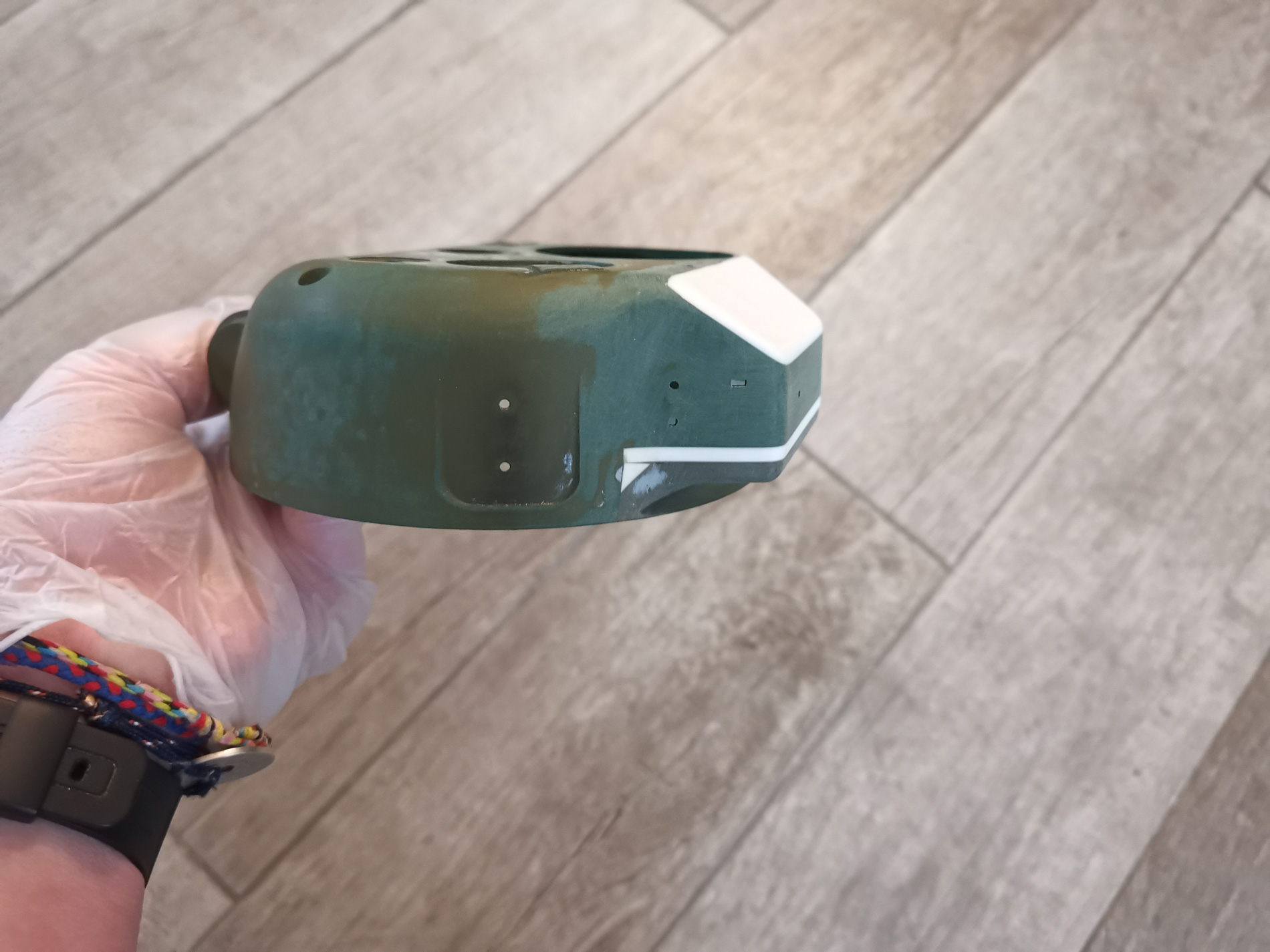

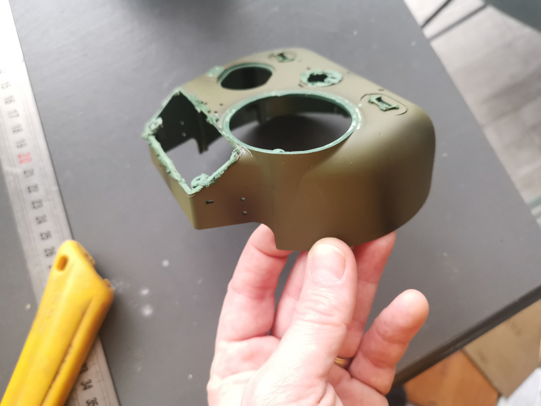

First, lots of things to cut off, grind etc :
Cutting the high bustle to convert it into a low bustle ;)
Capping the top with styrene :
The lower ring is also cut in two parts. The bottom of the bustle will be reused and lowered
My parts for 3D printing :

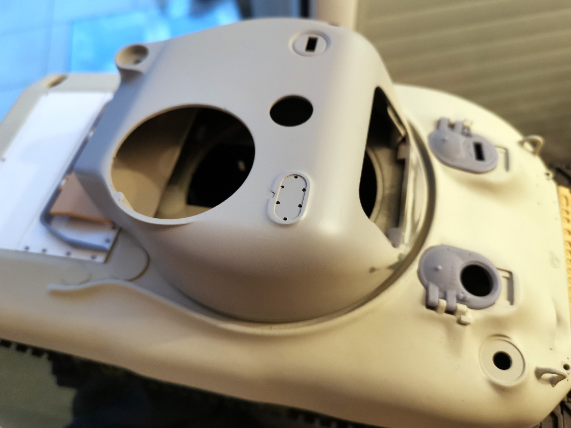

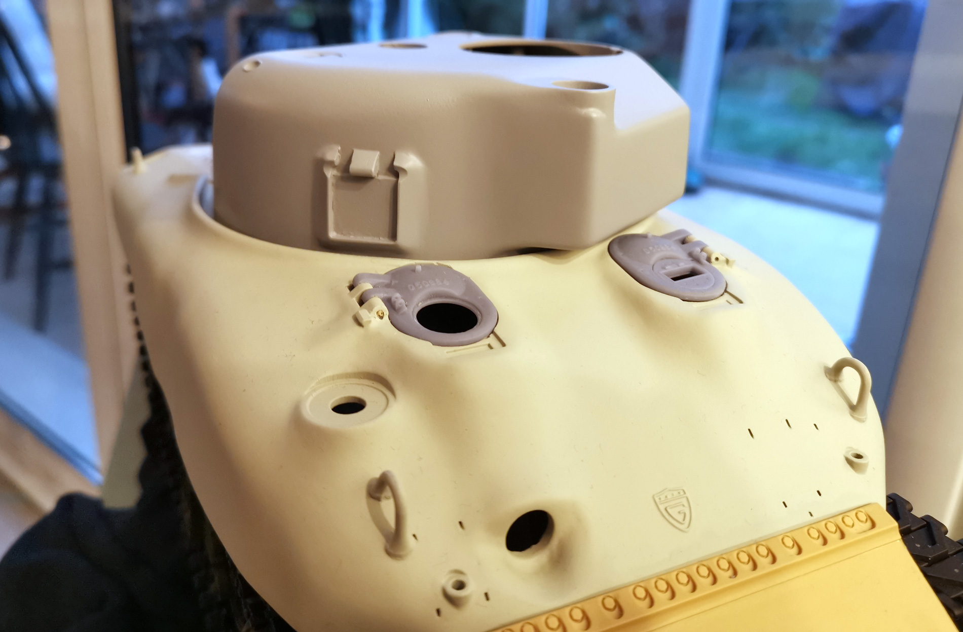

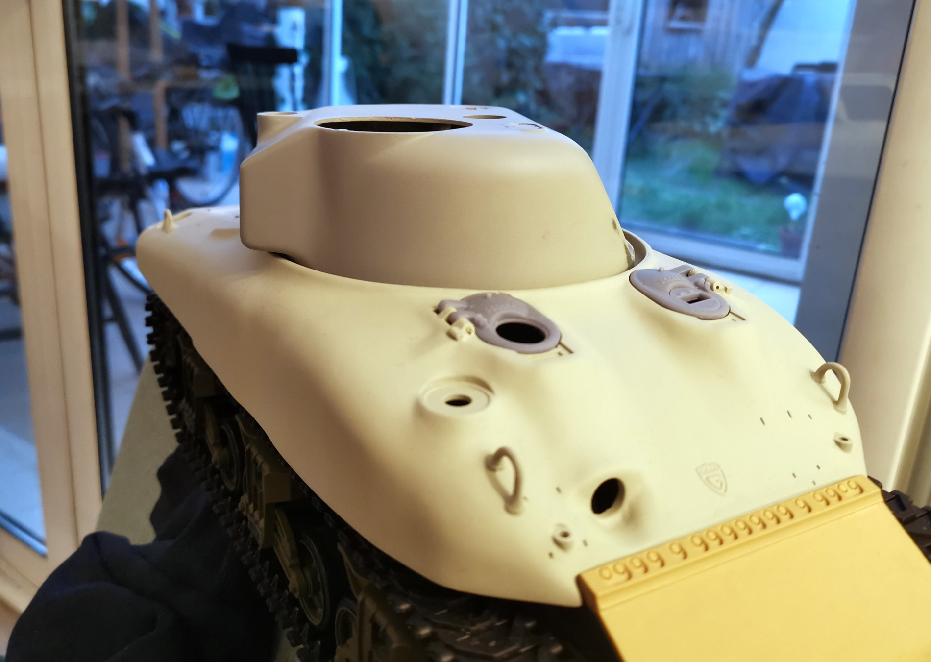

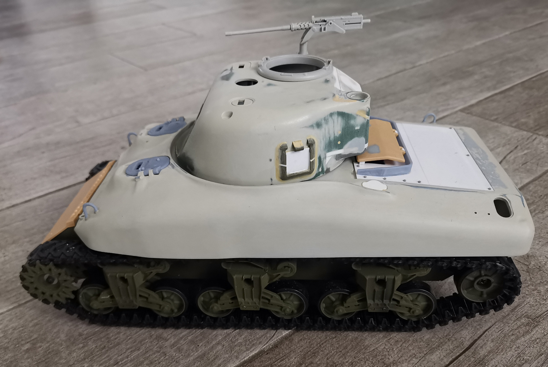

Here are some pics once everything is reattached together and sanded :
On the hull :

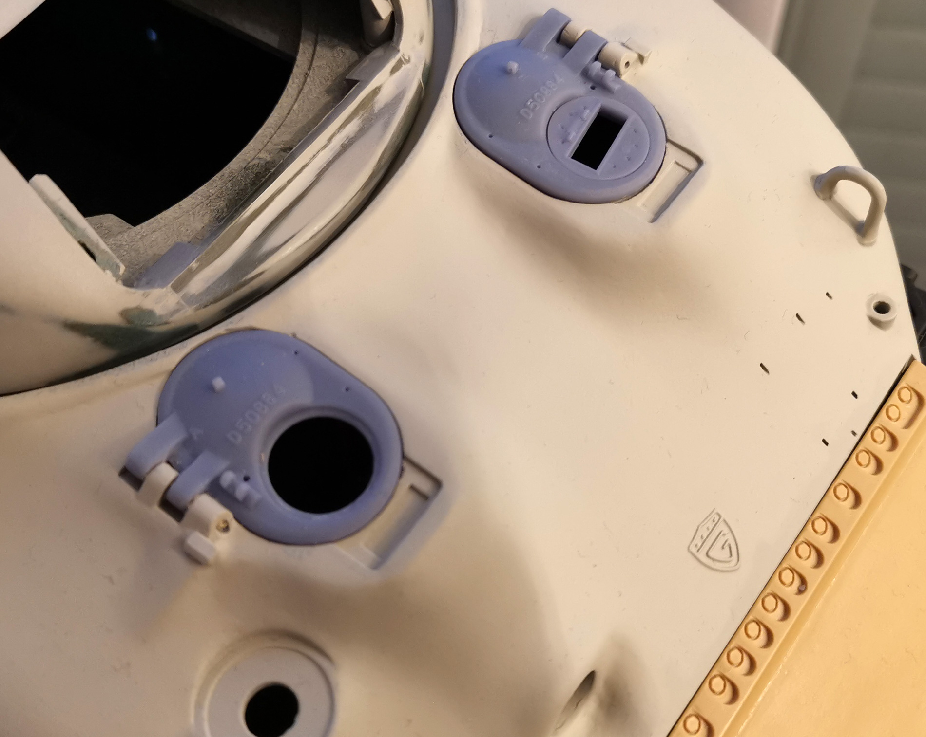

I glued the loader hatch in place, puttied it and sanded it smooth.
I'll had the foundry mark (part number, steel quality etc) later :

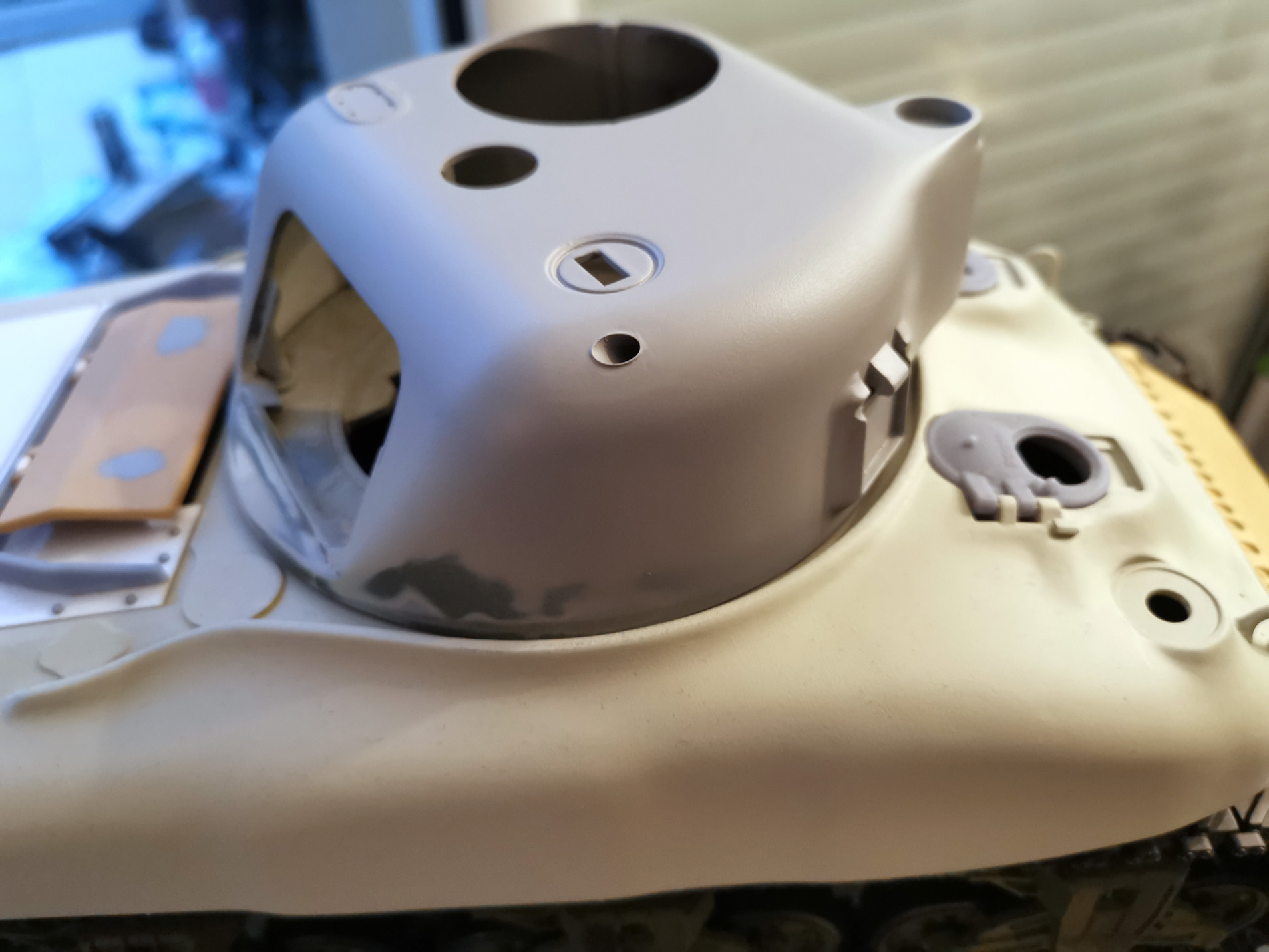

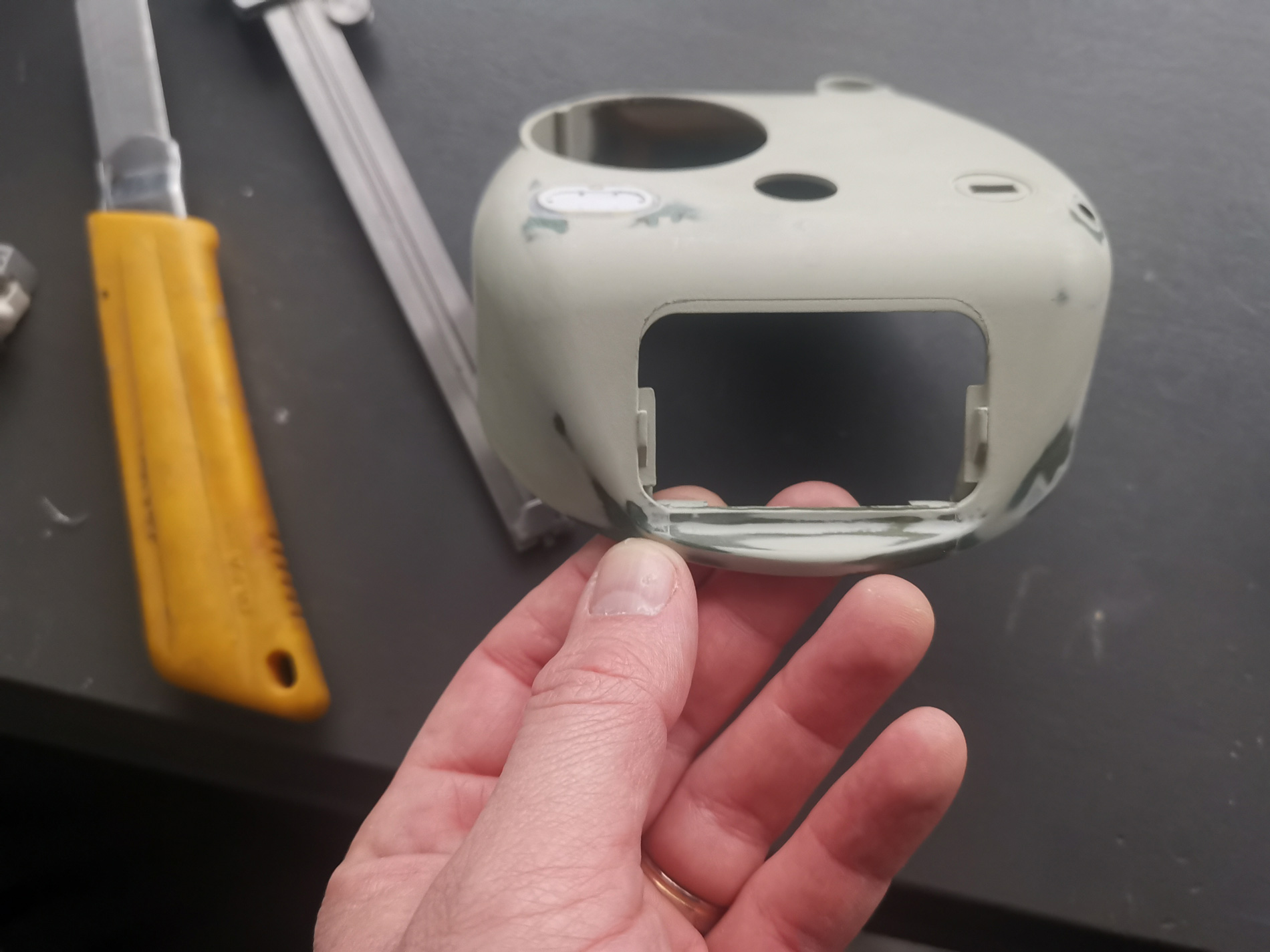

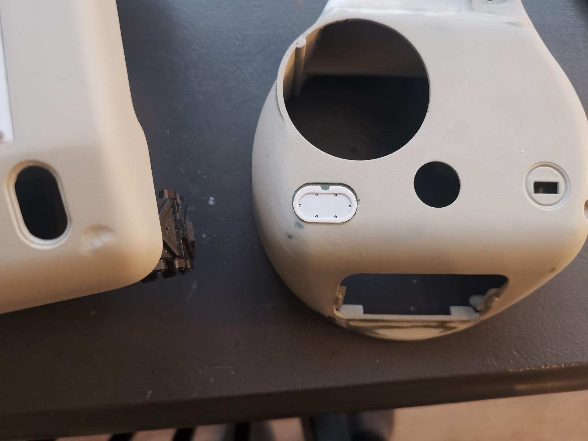

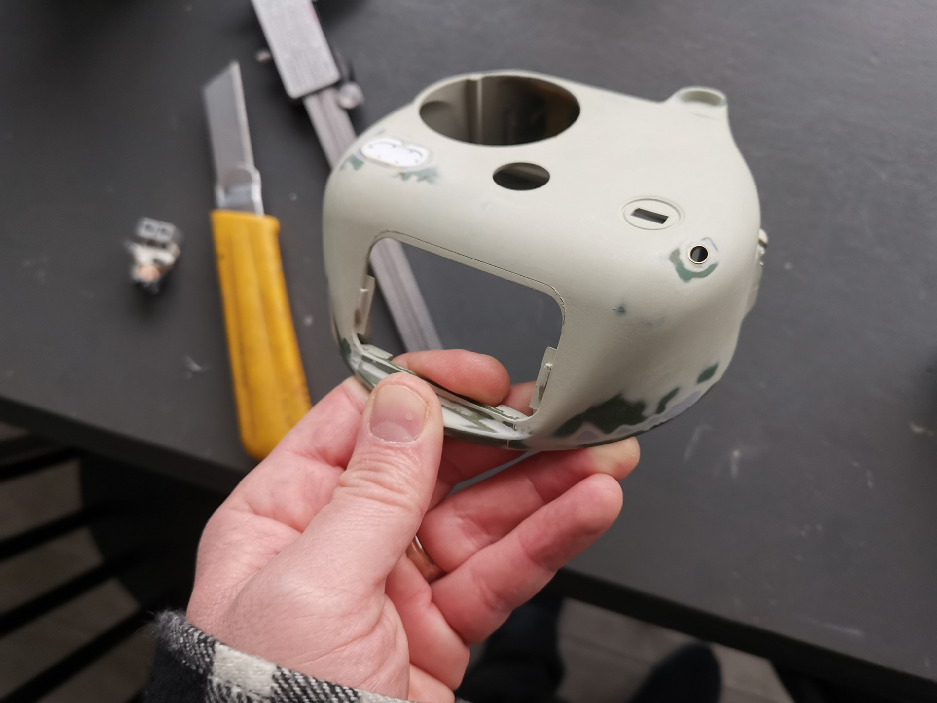

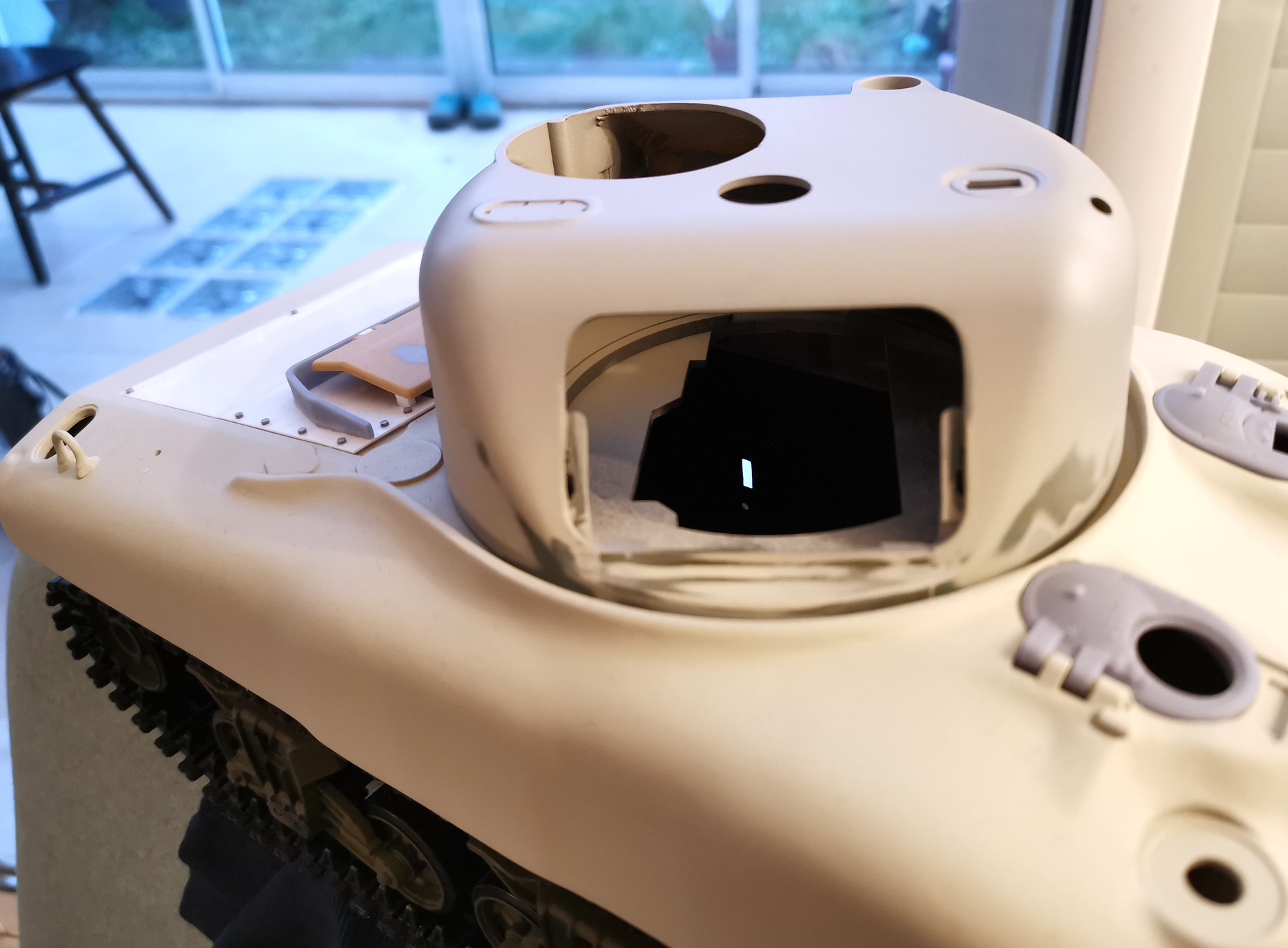

The surrounding area of the non rotating periscope is the wrong proportion and too large on the HL turret. Plus it's not flush with the top of the turret in real life.
In place, you can see the size difference :headbang:
I used milliput to make a smooth transition. (you can see it finished in the last pics).
Another thing Heng Long got wrong : The front opening for the rotor shield ! Width is about right, height is not by 2 mm or so !! It should be bigger. The opening on the real turret is 38" by 23" which is about 60.3215mm by 36,5mm in 1/16 scale.
Heng Long opening need to be enlarged on the top.
Another issue is that the corner radius of the opening are too tight. They have a radius of about 6mm on the Heng Long turret while the radius should be 9,525mm. (6" radius on the real turret). The corner radius will be adressed later.

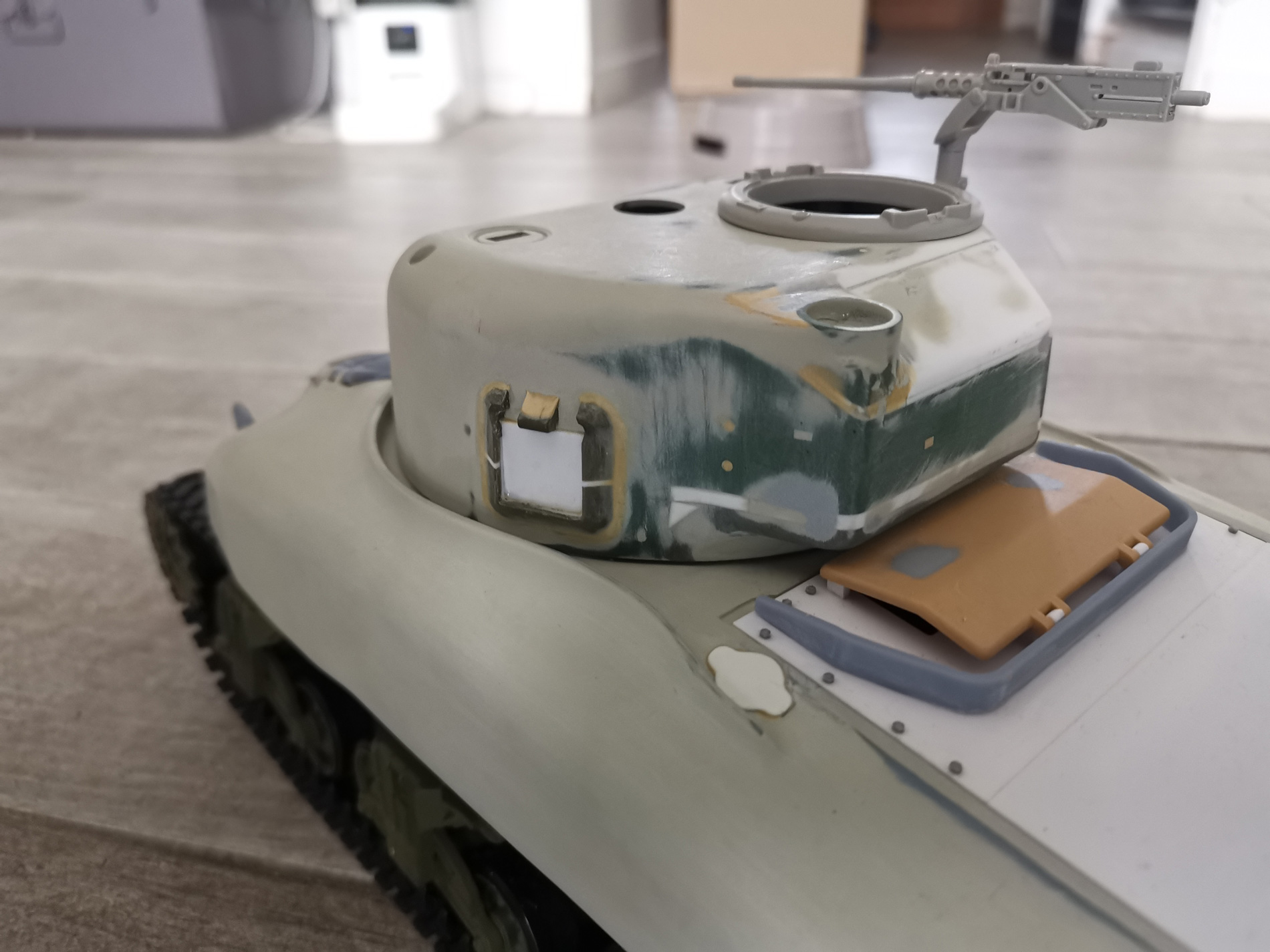

Some pics of the turret at the moment, I have a lot more to do !

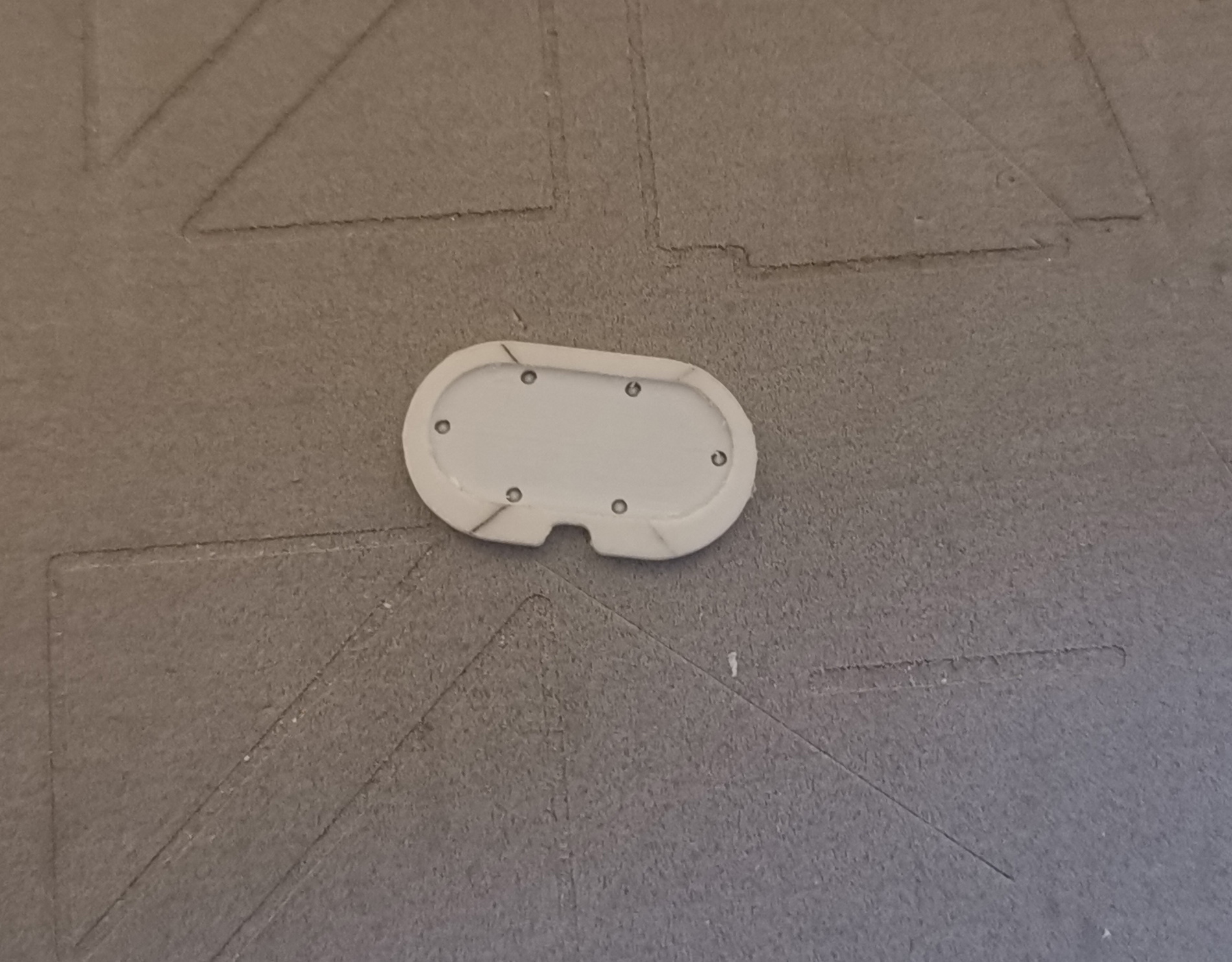

And a pic of the small hatches I designed and 3D printed ;) They can be in the open position. :)
