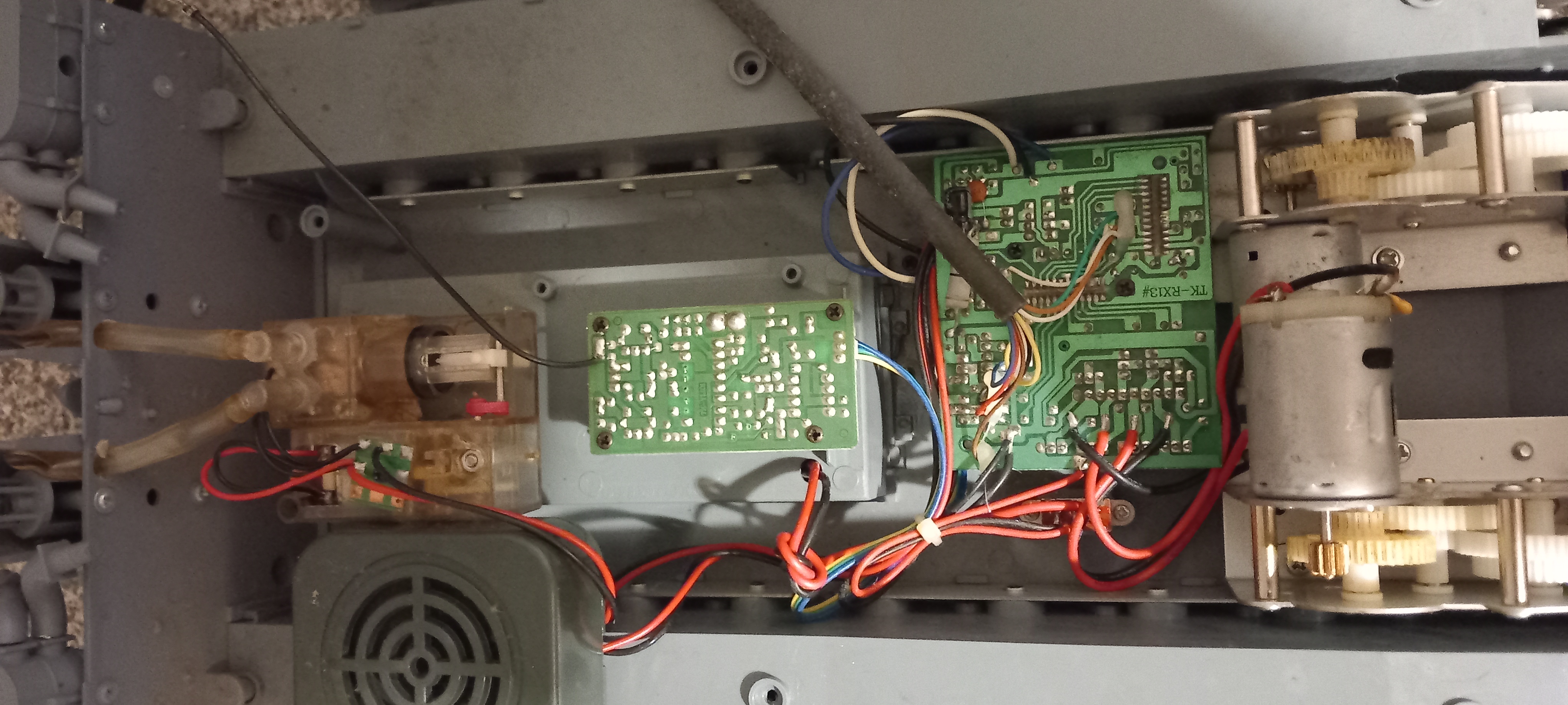

Hi. The red light is on the transmitter. I've double checked the pins are lined up on the crystals, fully charged battery, antenna fully extended, pressing the key button, asking very nicely to start but still nothing but the flashing headlight

Like you, Wardaddysdaddy, I cannot see anything visibly wrong with the boards in the excellent lower hull photo you have provided. john1970 and Sunjamagunner
have given you good advice.
If you decide to update the Tiger a bit (not a bad idea at all), I wonder if your best bet would be to go to one of the earlier HengLong 2.4 Ghz systems, maybe not the latest, but still a big improvement over the old crystal set innards. Many here on RCTW can suggest an inexpensive 2.4 Ghz conversion for HengLong, lead you through it (easy to do and not expensive).
A side note: Just a week or so ago, I opened up one of my older HengLong tanks, a Tauchpanzer I had not looked at for years. I found the RX13 system, crystals and all, but it had metal gears (surprise). I am just going to convert it to more recent electronics. but with a wrinkle: I may want the latest and greatest HengLong electronic. However, because I have mostly Taigen/Torro tanks, I am not as familiar with the newest HengLong electronics, so I am waiting for some tips on changing out to the latest which has some great features, but somewhat different wiring and connectors.
