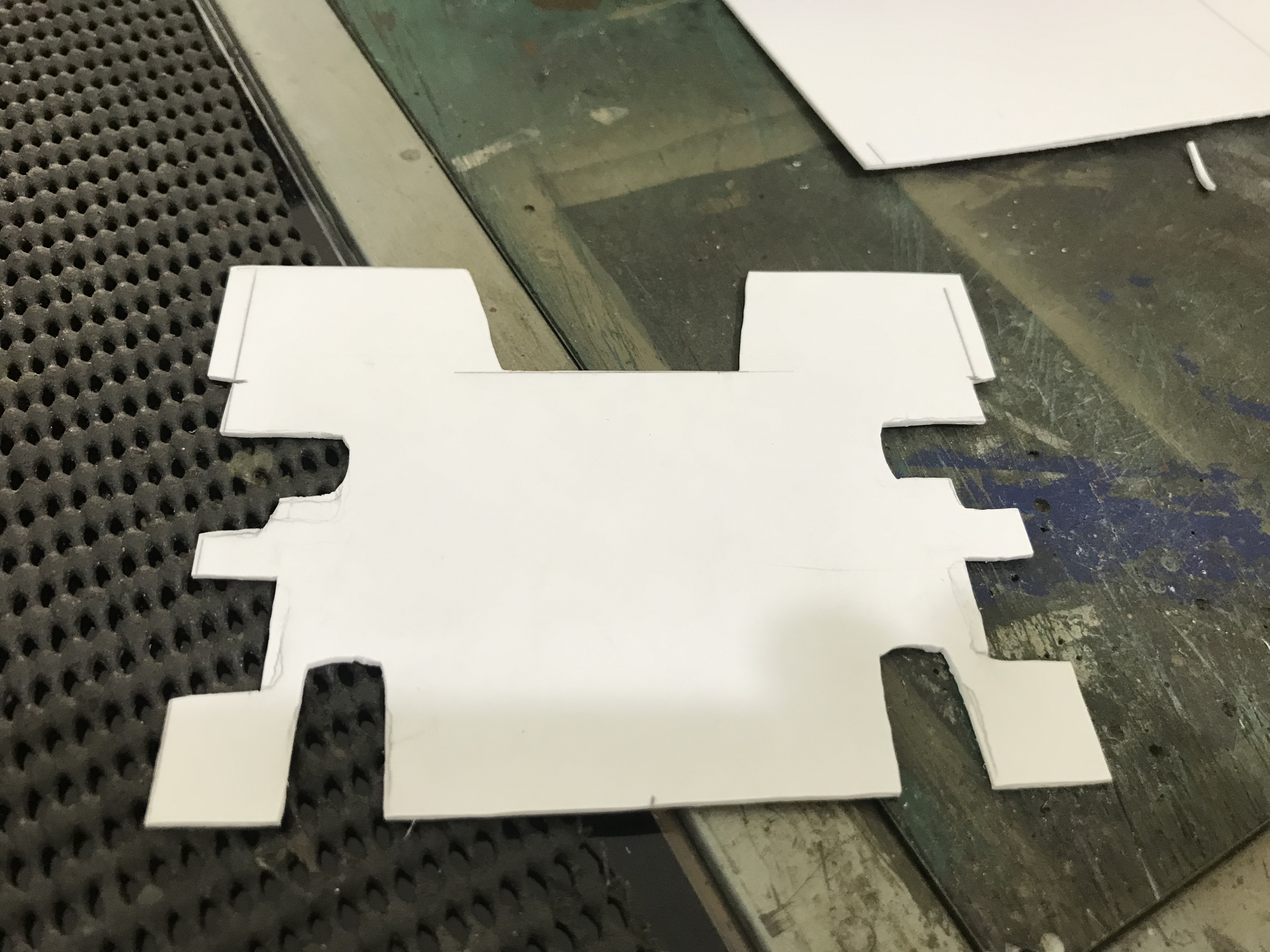

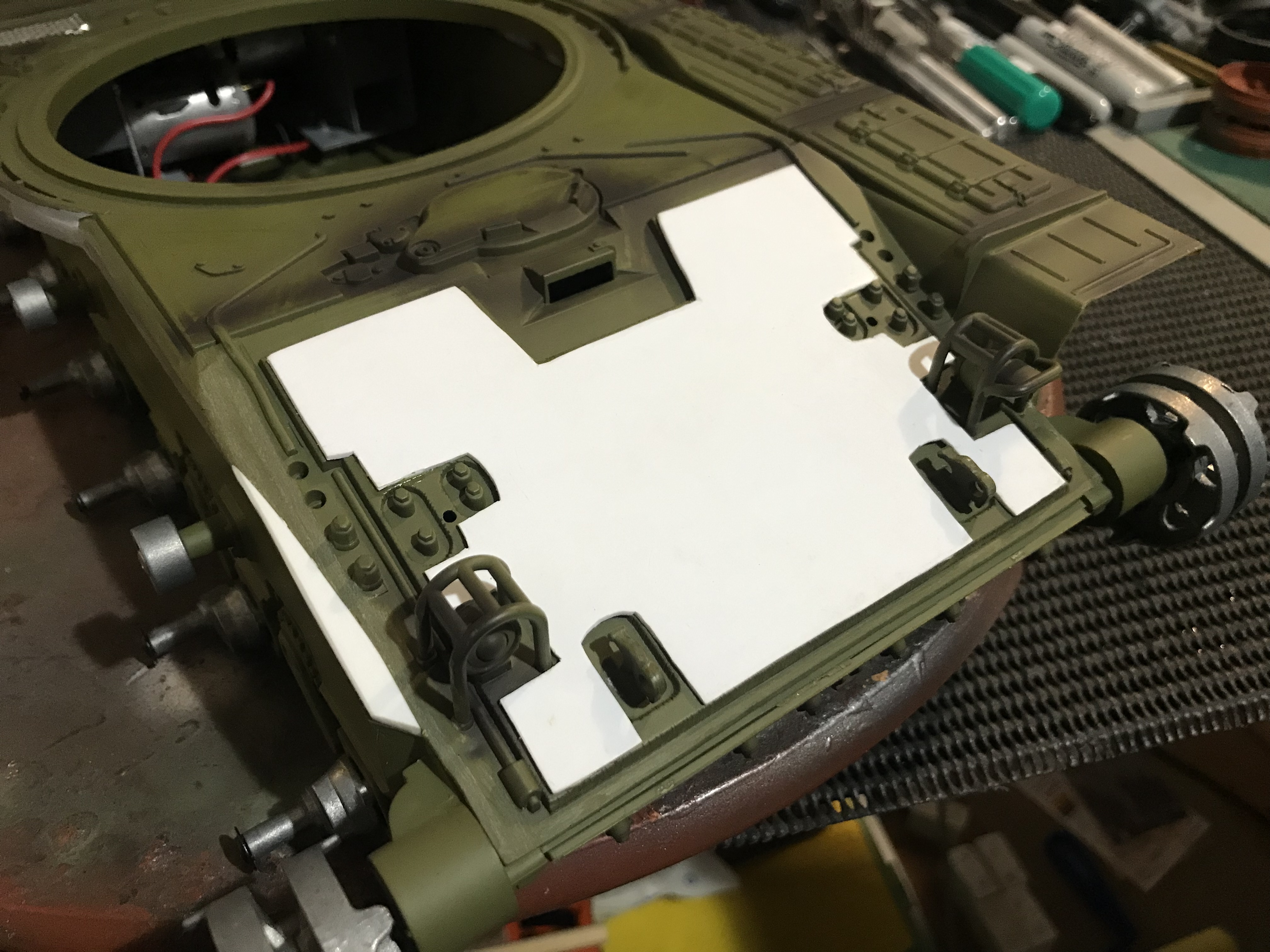

I made a plate to cover the unwanted ERA mounting points on the glacis .
Hindsight being what it is I should have split the thing in half, but as it is I can always add segments onto it, or not, as necessary to get the right look.
It looks like an old style Space Invaders ship ...............
I might add some faux welded loops onto it to look like how the plate might have been lifted into position in the basement of a building in Aleppo or Daraya...........

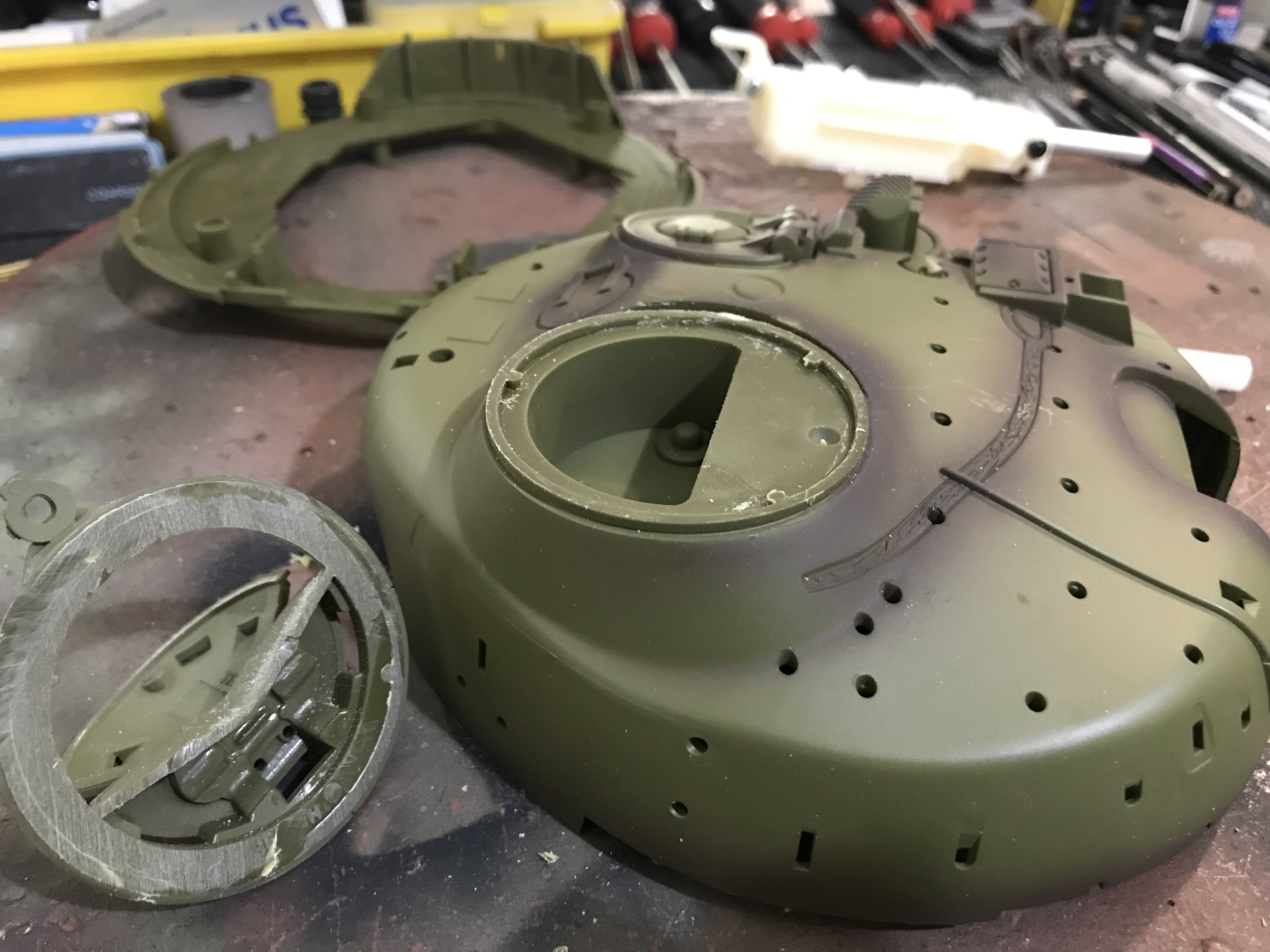

Im onto the turret now. There's loads of bits to go on it like the T90, but no where near as much as if I was using the ERA kit 8O
Opening the losenge-shaped turret was typically H/L easy, but getting the cupola off was also typical H/L bloody impossible :crazy:
The ole glue monkey has stuck the commanders cupola in place something ferocious :/
I need to rotate the thing so that the M.G is facing forward, so out with the razor saw.
Got it off in one piece, and without losing any profile.
I also had to open up the void under the cupola so that now the thing is rotated around, I can still squeeze a T.C. in the gap.
The elevation unit is mounted directly to this, so it will need to be repaired to a degree.
All this to get the outer shape right so I can get the barrel smoke unit in place.

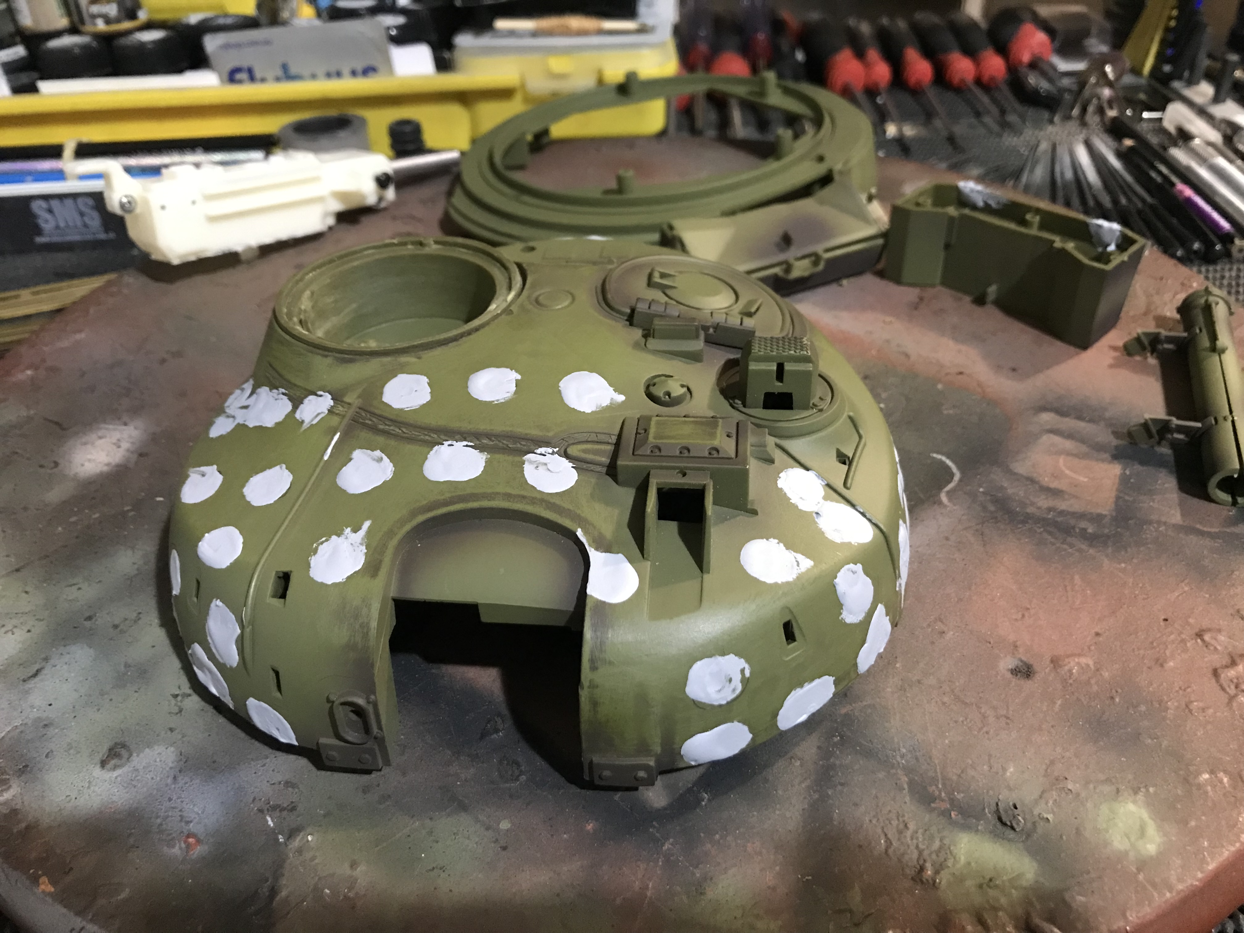

And now like a bad case of acne, the unwanted turret gets filled with putty to close the mounting penetrations for the superfluous ERA.
Wont be too bad once the over all cast texture is put over it.
There is much to be said for leaving things well enough alone.......................but not by me !!
I might still load up with wooden planks & concrete blocks & junk yet!!

Bix, it looks as if you have sawed the cupola off 90 degrees to the mounting, perhaps using a razor saw. That must have taken a steady hand and squinting eyes. 8O
Re: UNLOVED BUT EFFECTIVE- SYRIAN 'FURY'
Posted: Sat Feb 25, 2023 12:00 am
by HERMAN BIX
Herr Dr. Professor wrote: Fri Feb 24, 2023 7:48 pm Bix, it looks as if you have sawed the cupola off 90 degrees to the mounting, perhaps using a razor saw. That must have taken a steady hand and squinting eyes. 8O
yes Sir, it took a bit of steady perseverance to avoid a stray blade and keep a straight cut.
A minor detail, but cutting it for reorientation also means I can access the periscope blocks from under/inside rather than pissing around trying to get something in from the front.
