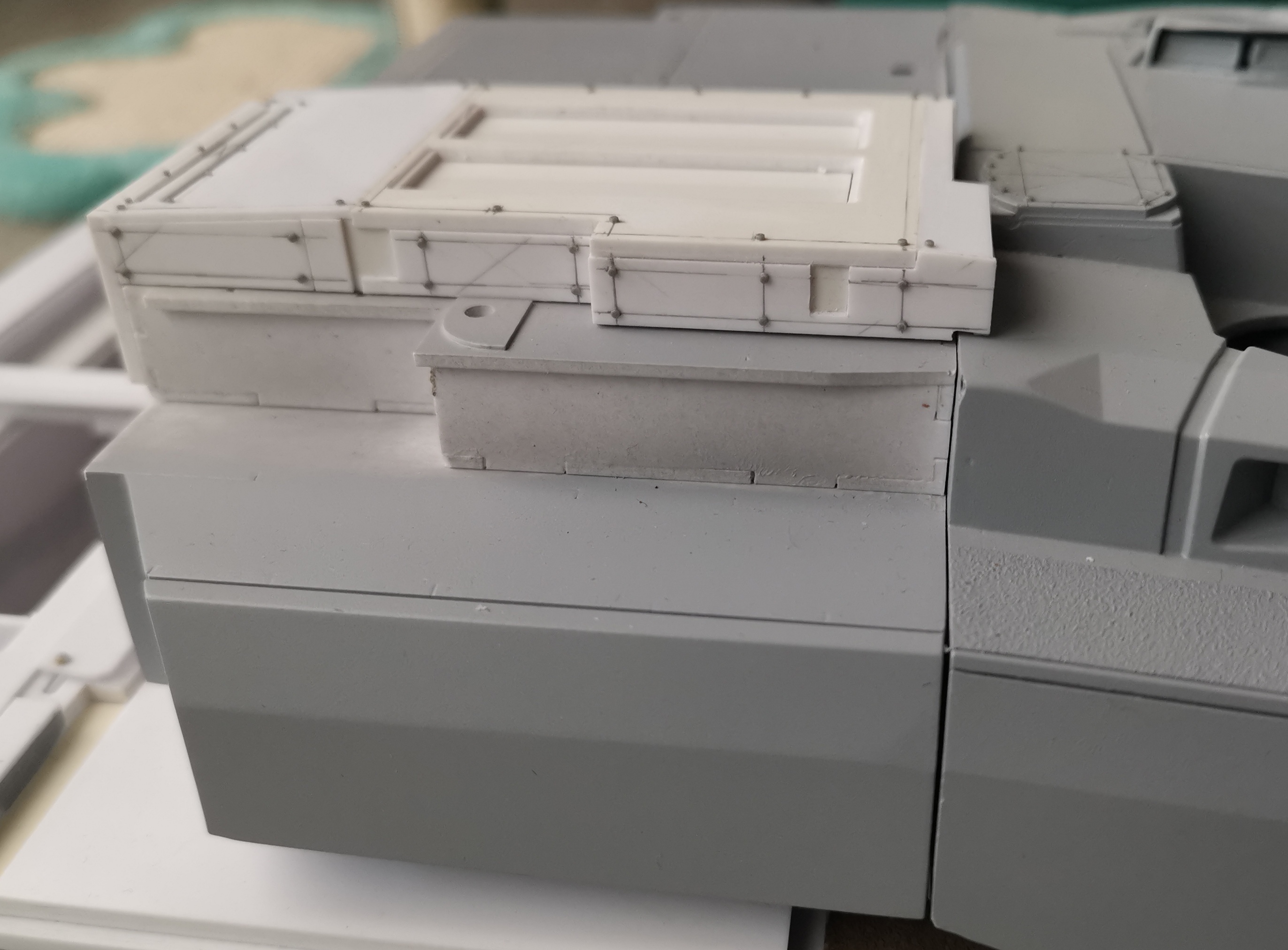

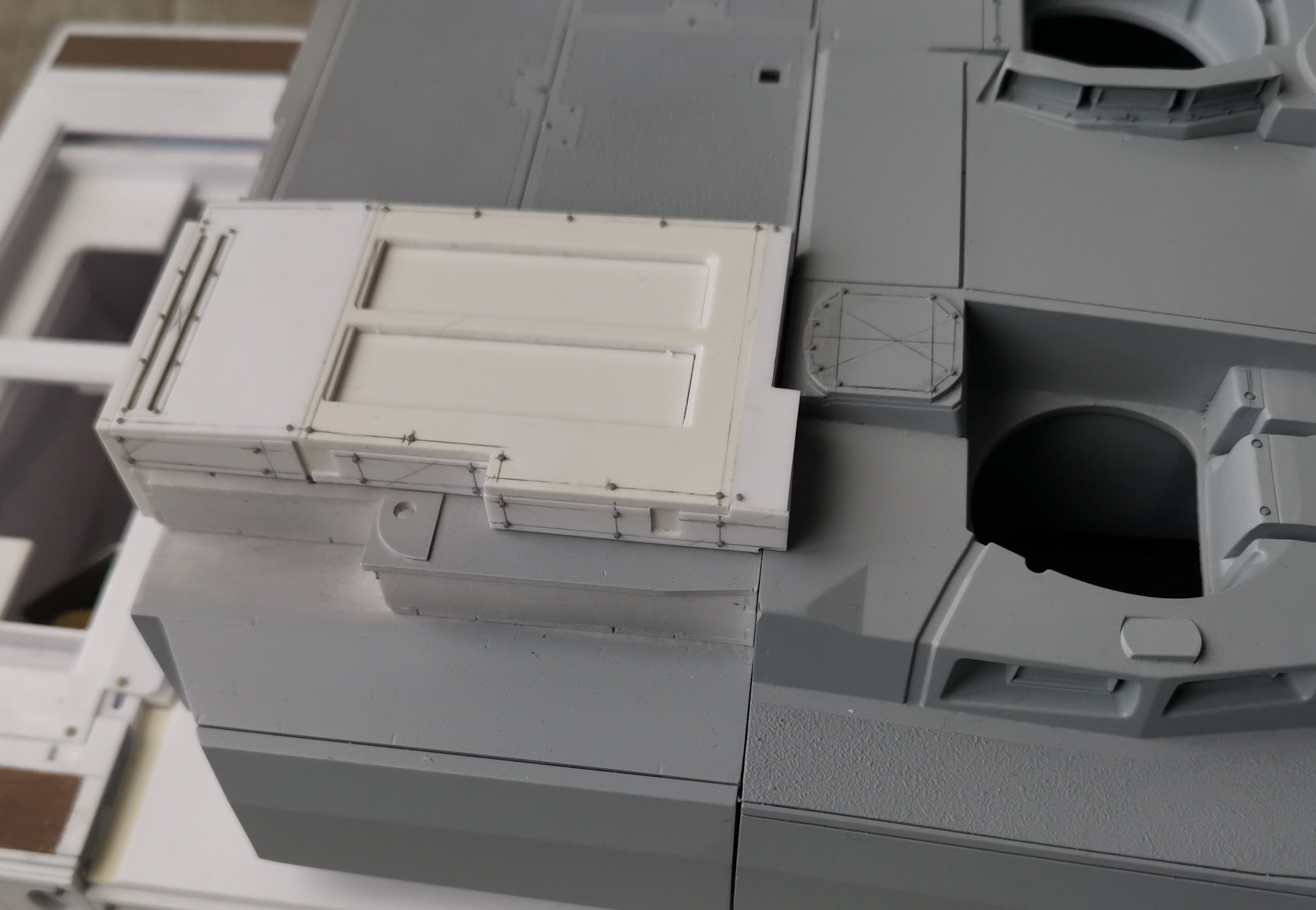

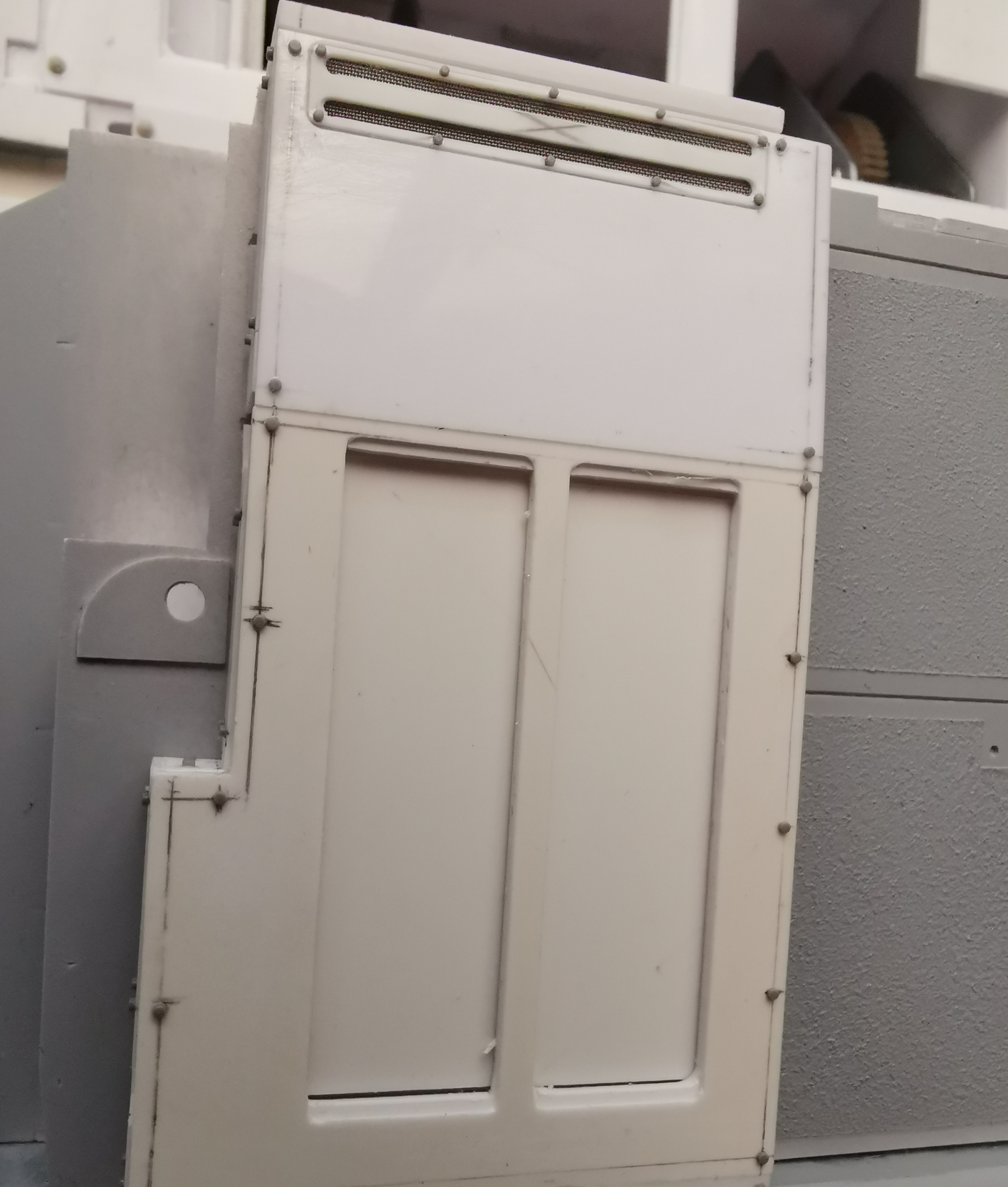

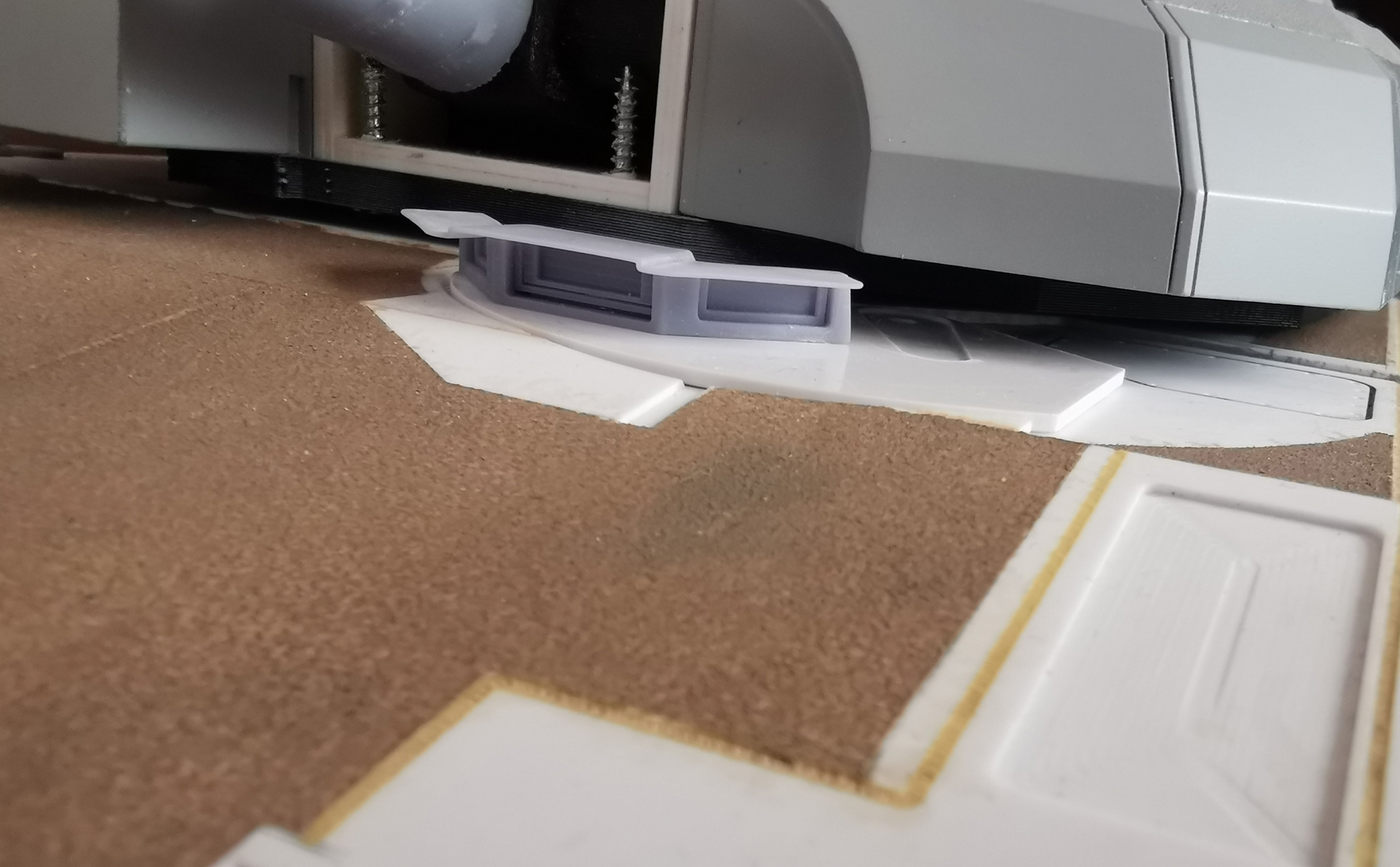

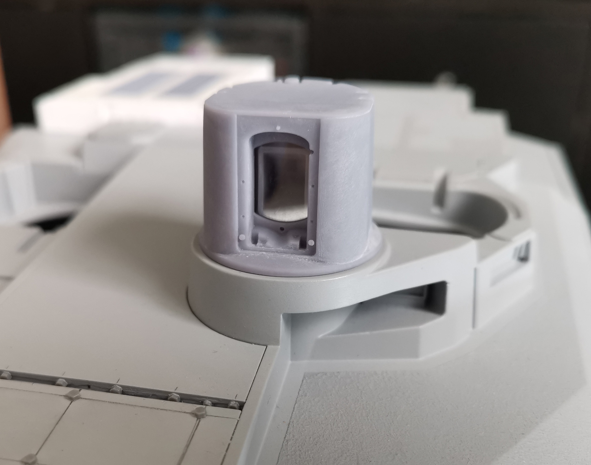

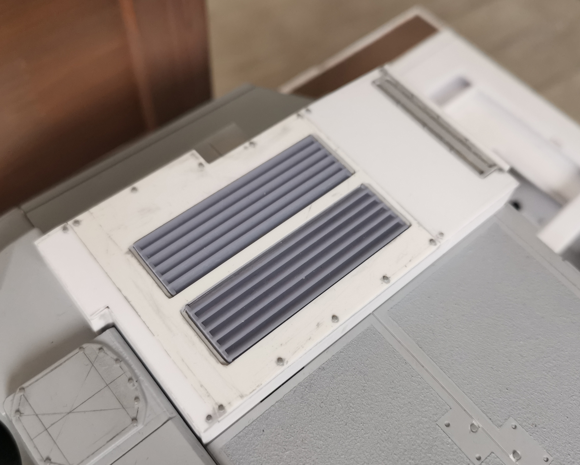

I built the AC box on top of the turret.
I luckily had fine metal mesh from a past project (was going to use to build the catwalk of a 1/200 aicraft carrier but ended using PE). It's the perfect size and I have enough to do all the mesh screen of the Leclerc.
The vents are not made yet, I'm going to 3d print them and will go in the recessed areas on top.
My parts for 3D printing :

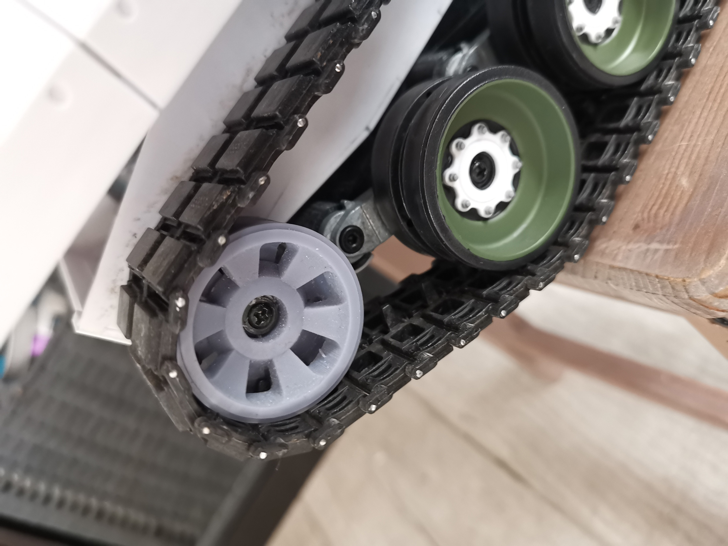

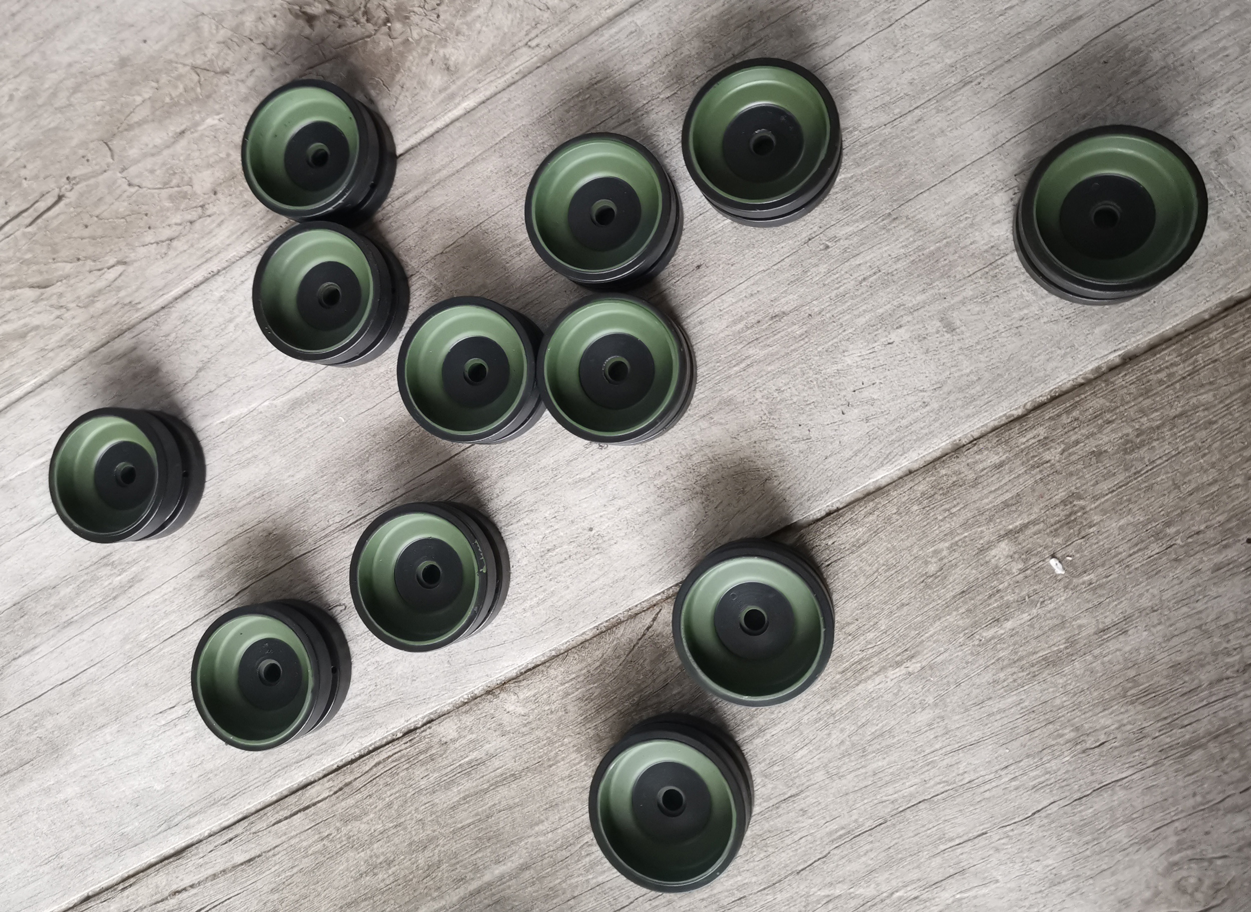

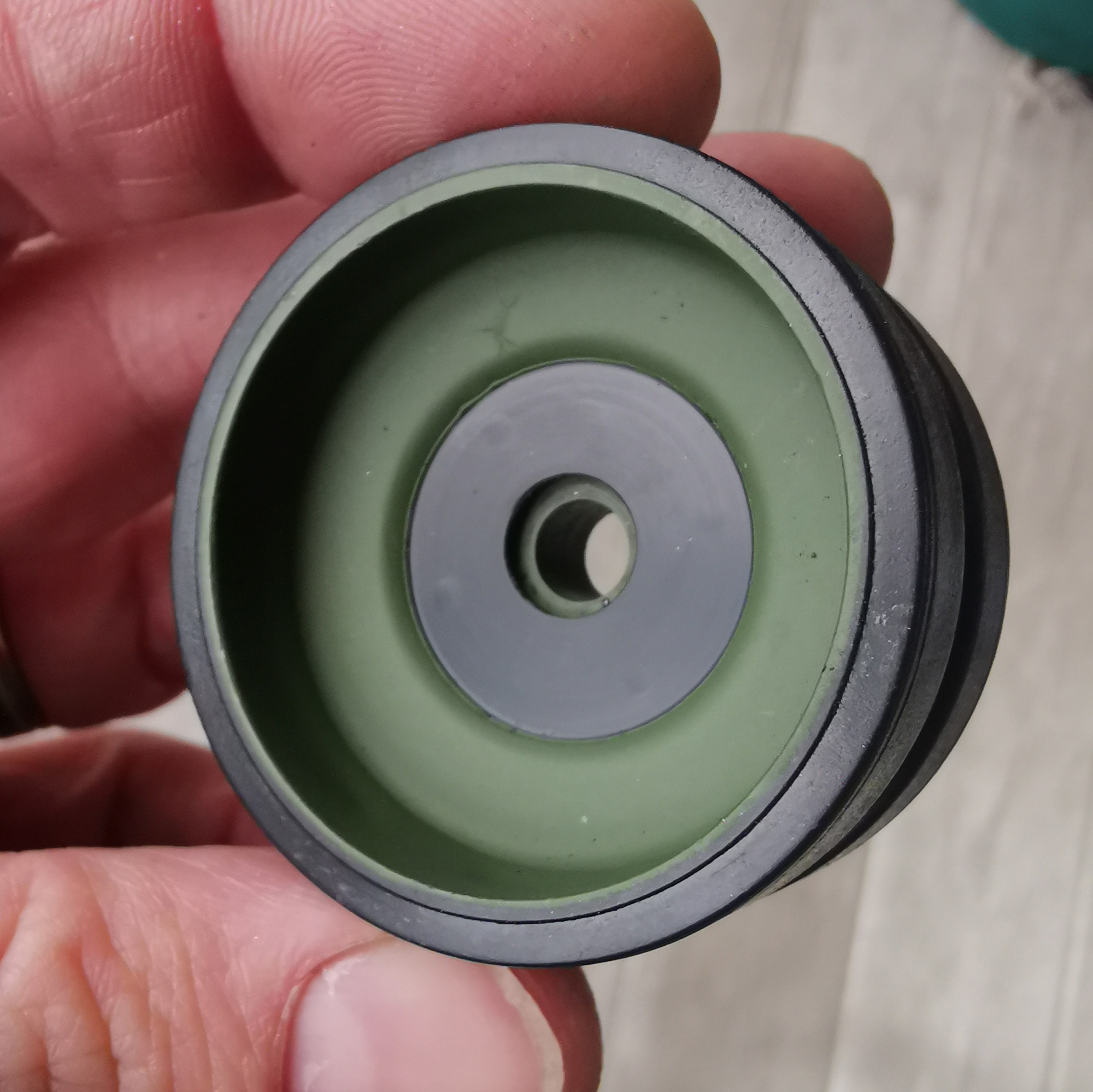

Initially I was going to use the Leopard wheels as they were since they'll be mostly hidden by the side skirts. However I'm no longer sure to put the rubber lower skirts so they will be shown much more.
I'm not intenting to make 100% accurate Leclerc wheels (it would have been easier to 3D print them for that), but I had some fun trying to get them more accurate.

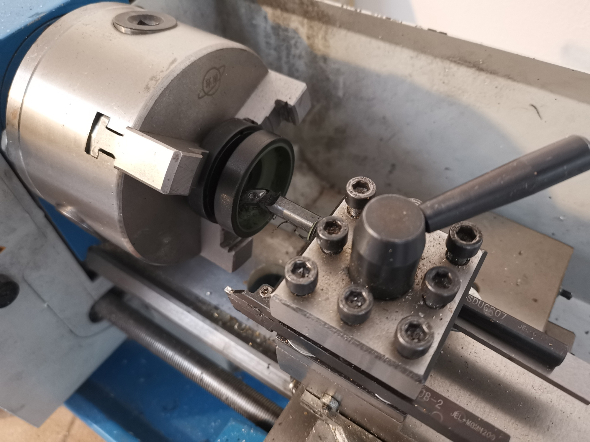

First I had to remove on the lathe the inner details :
The result :
All 12 wheels done :

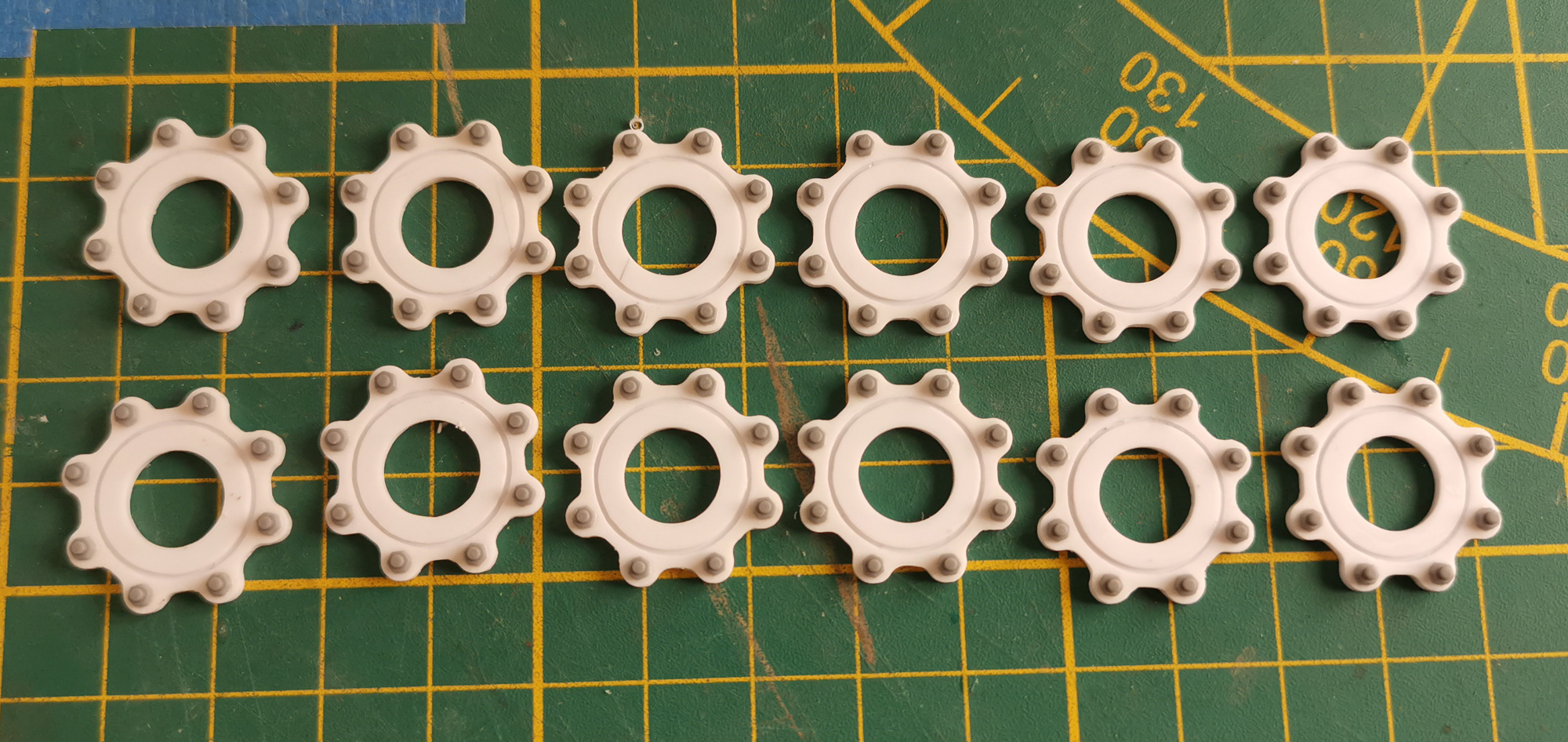

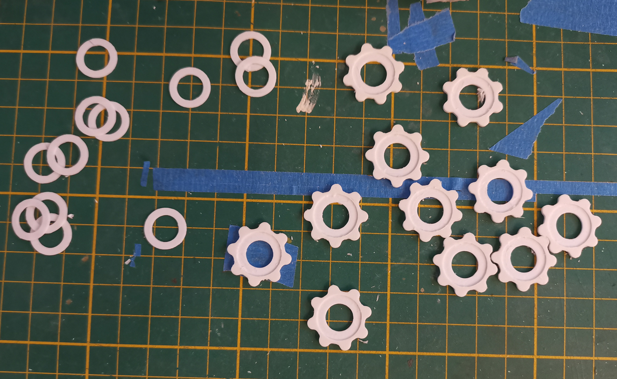

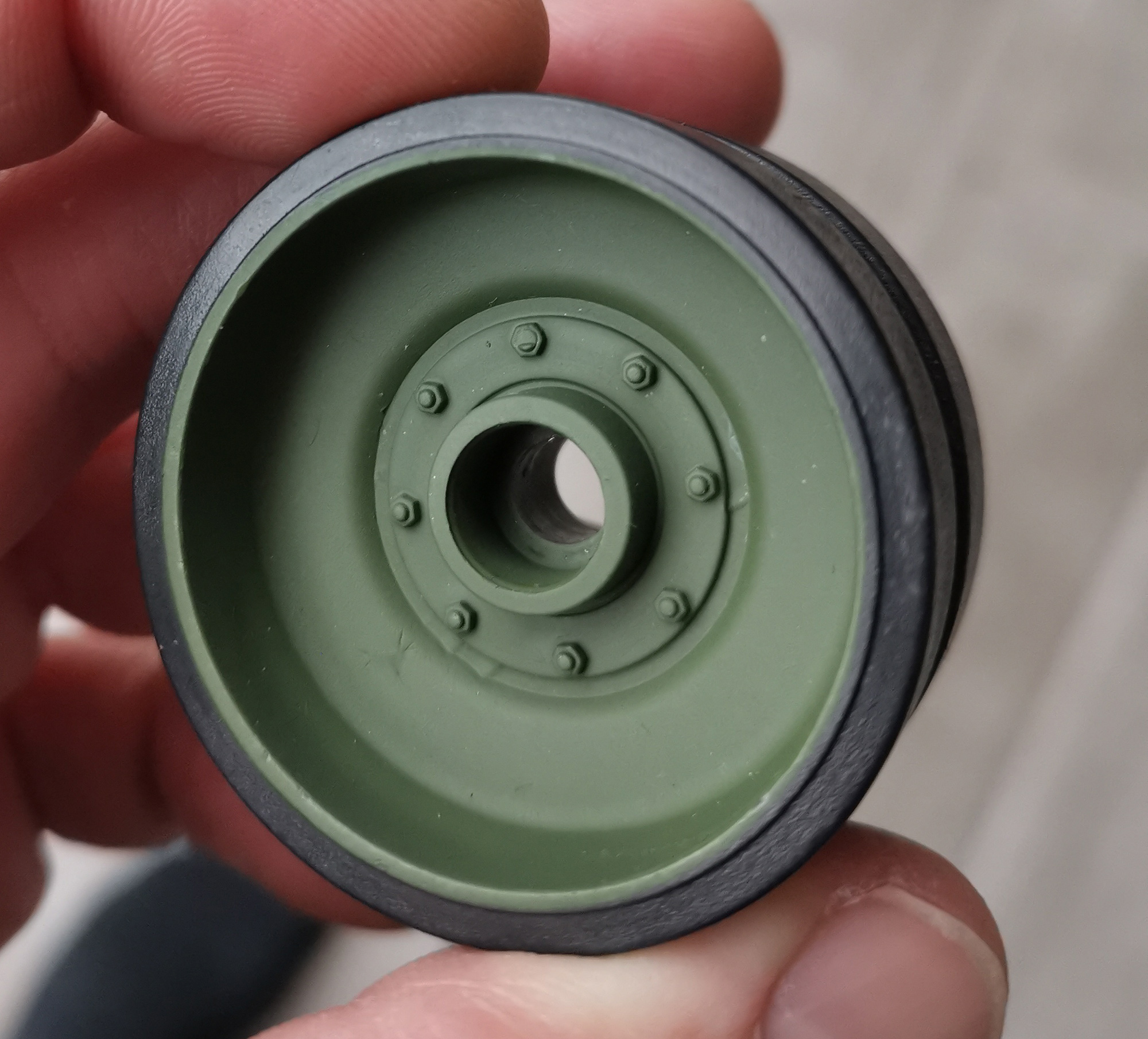

Then I had to make the kind of star like washer :
Adding the nuts :
In place :
The hub covers will be 3D printed, I wanted to use the Leopard one, shortening them, but I found the diameter was wrong.

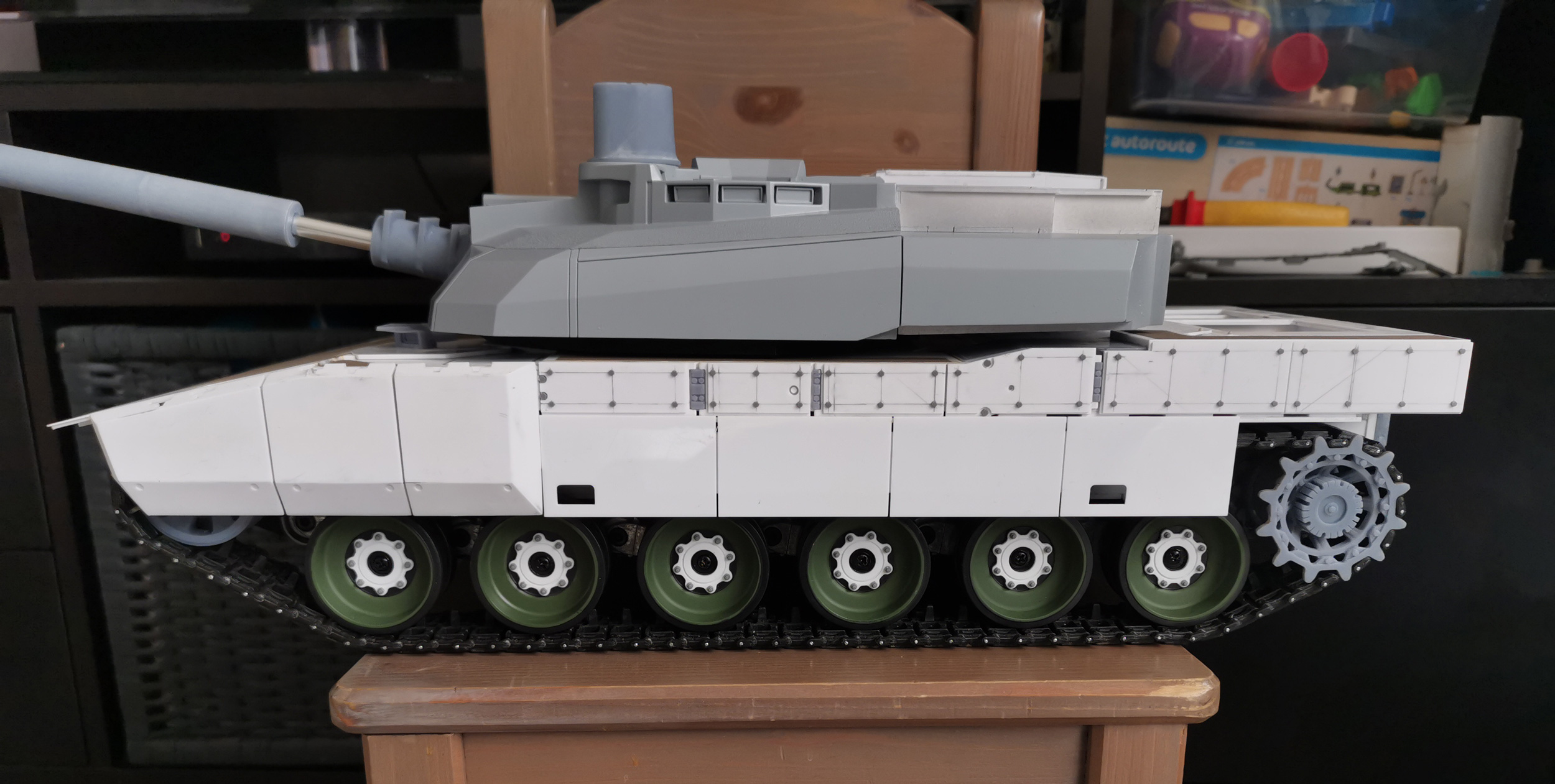

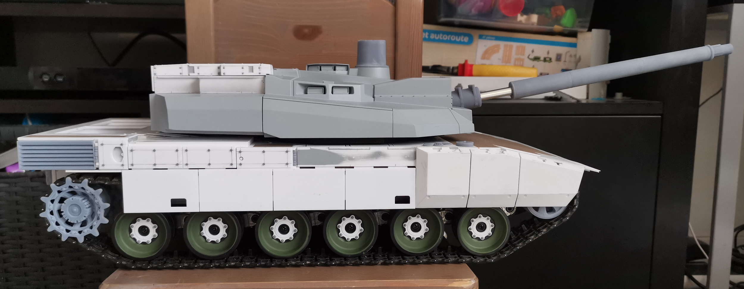

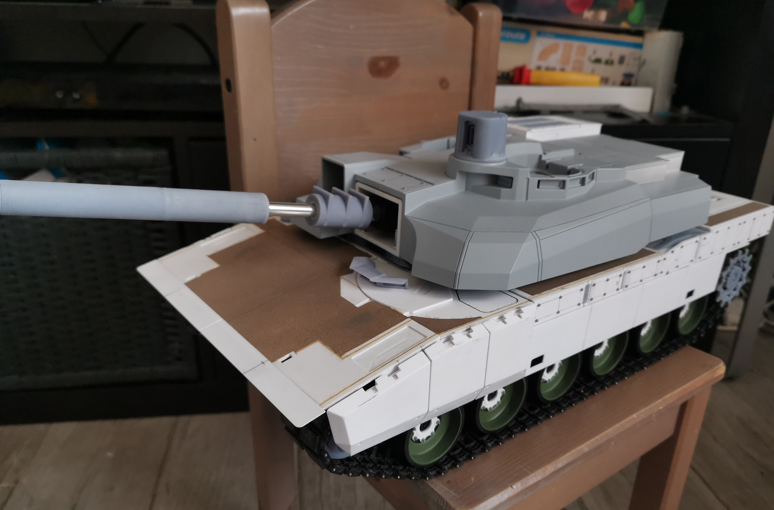

Ive also worked on the hull.
Masking for the anti-slip stuff :
Driver's episcope :
Panoramic sight view :
Vents on the AC compartment :
Brake heatsinks :

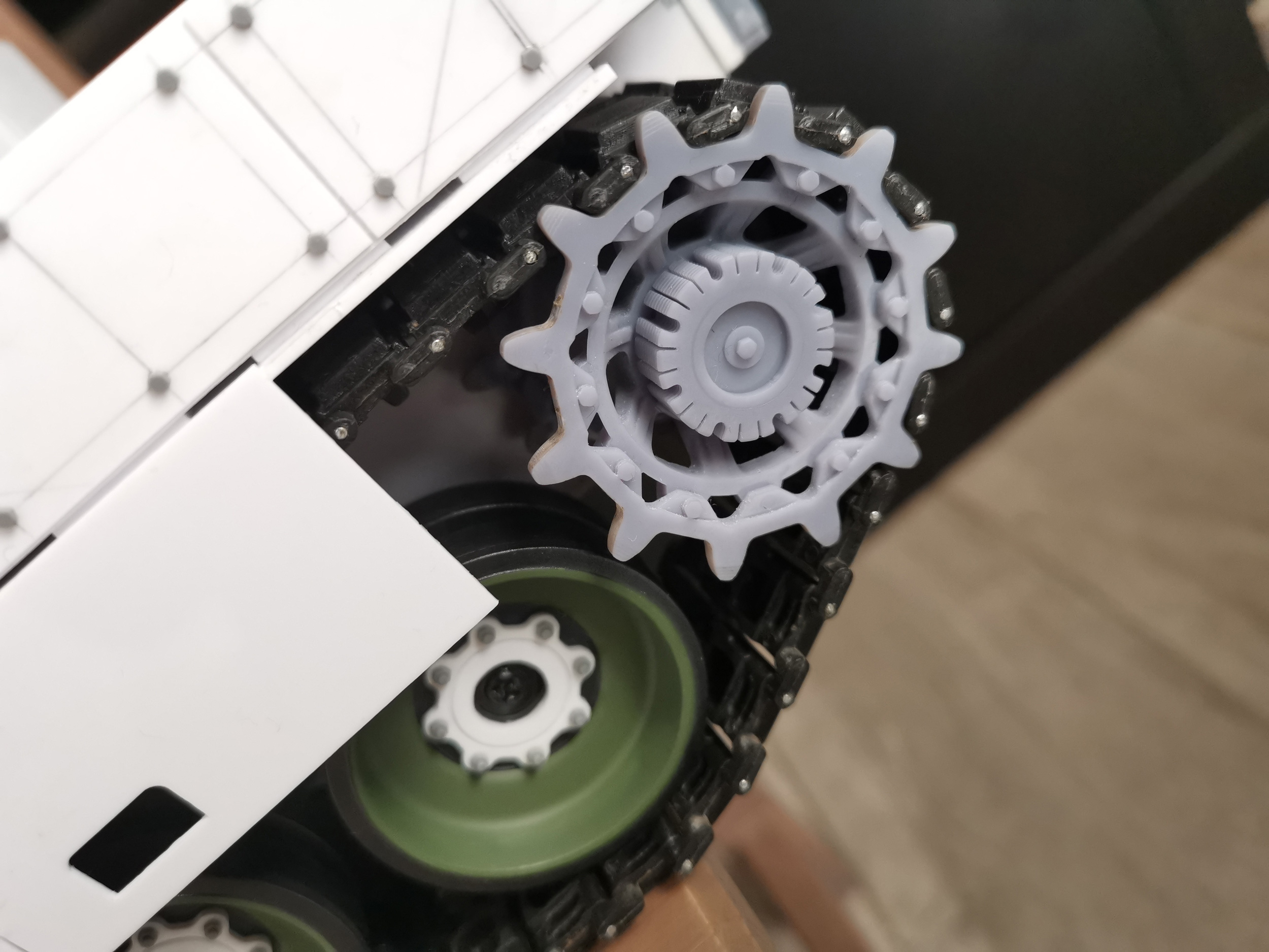

New idler :
General views :
120mm smooth bore :

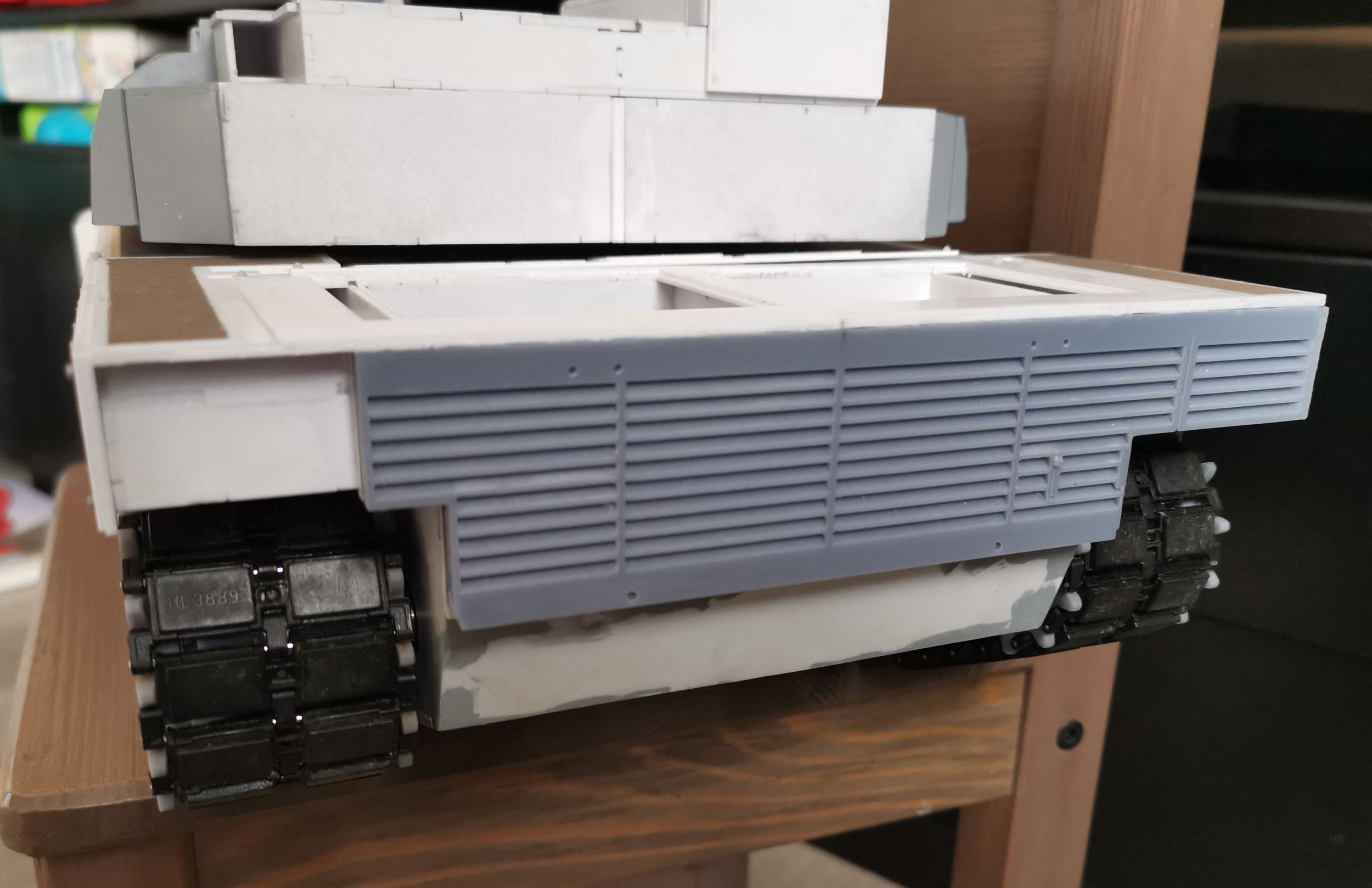

Rear engine vents :
Thanks for watching.

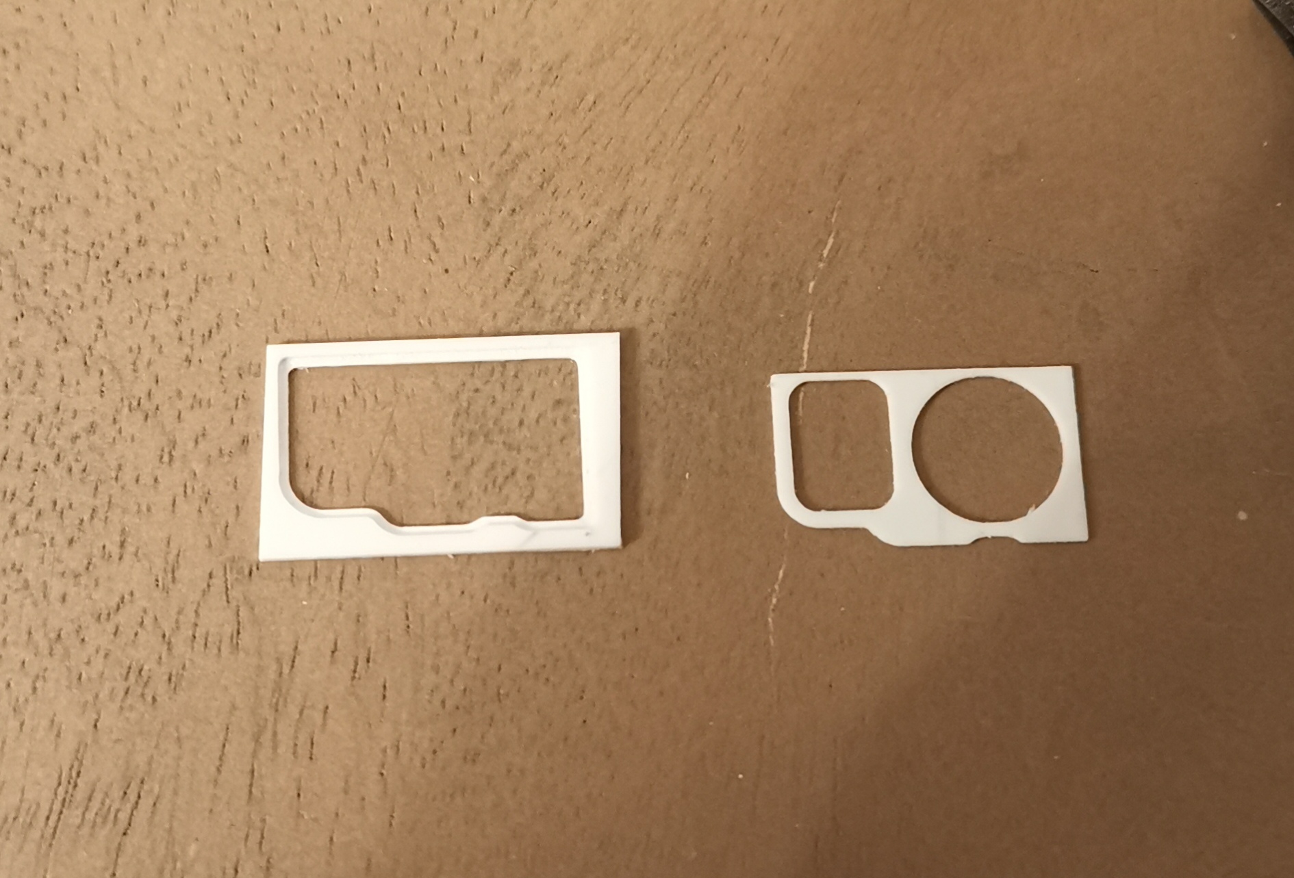

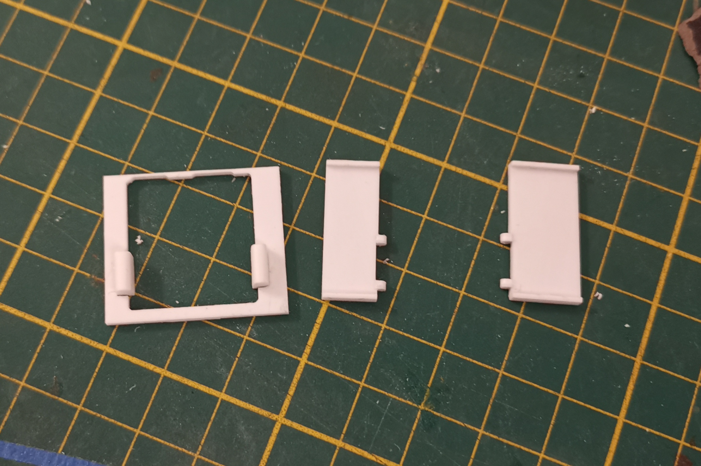

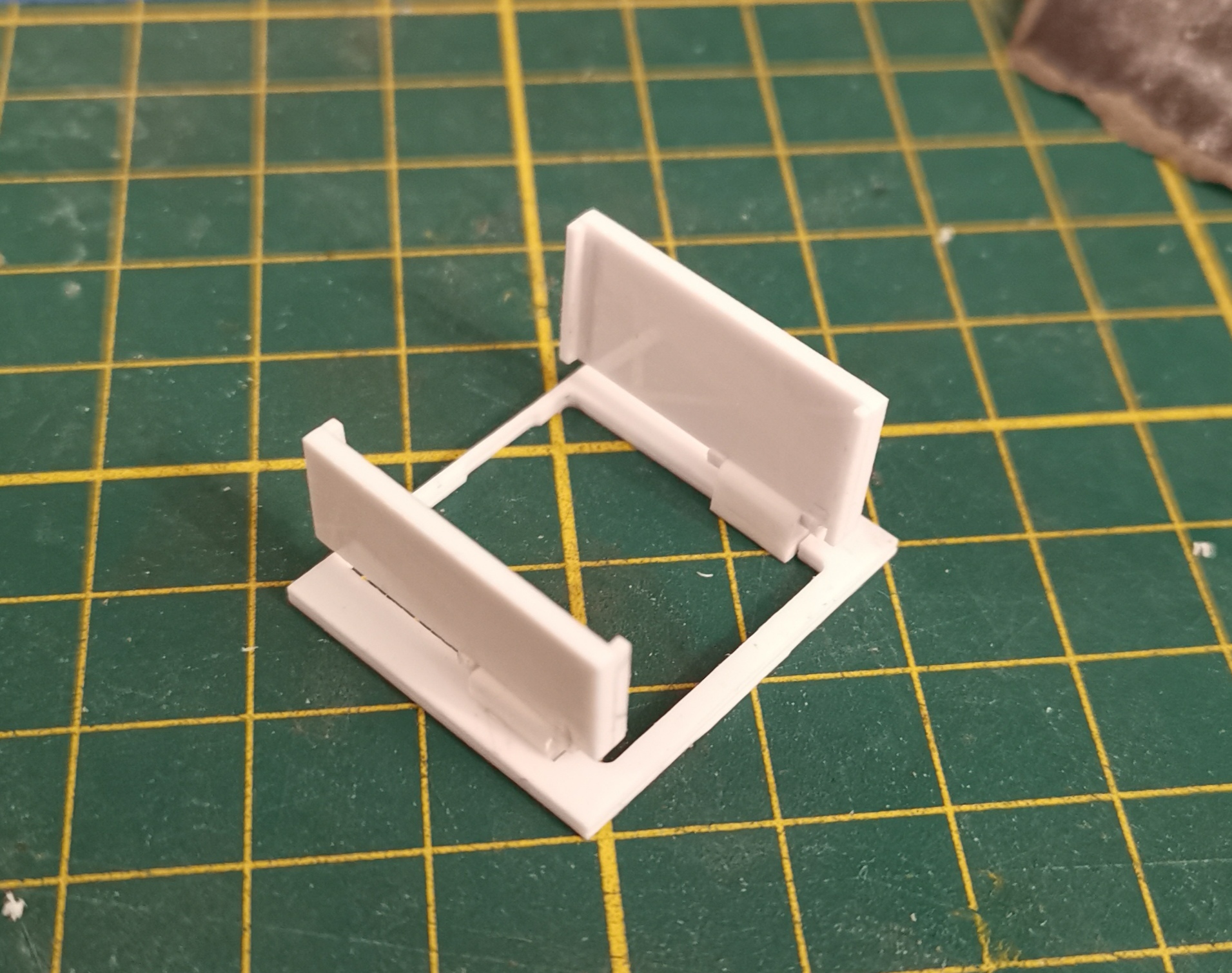

Hello guys, I'm now working on details, this is the visor doors and the the frame for the optics.

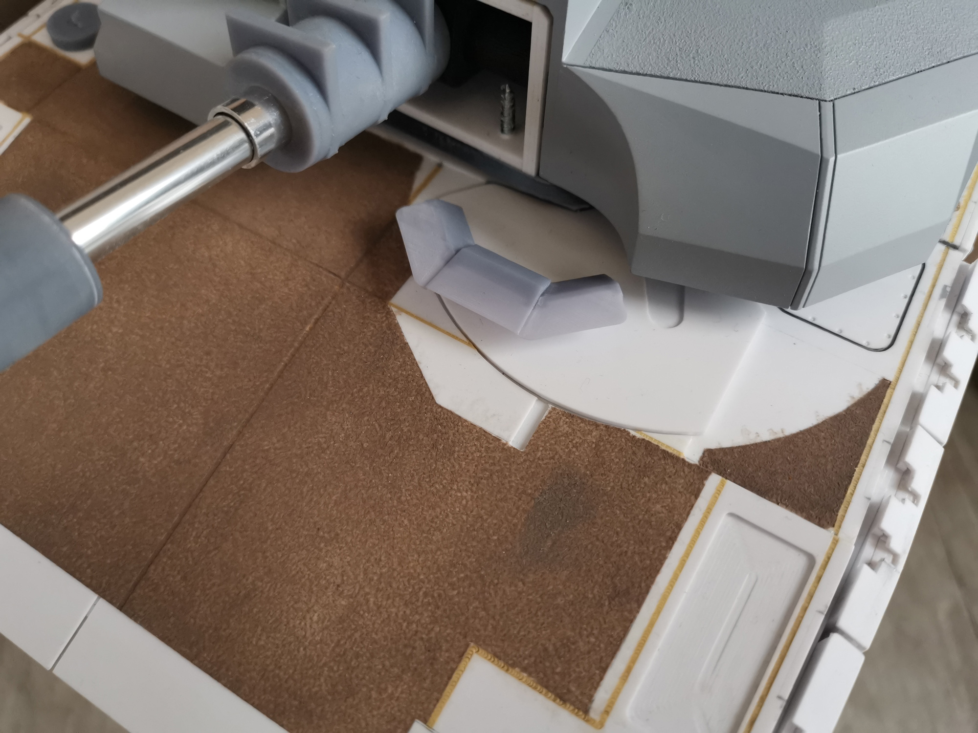

If I may ask, what did you use for the Non-Slip?
Barry

BarryC wrote: Sun Nov 27, 2022 5:15 pm
Barry
Great question, looks like a cork material.
Eric

BarryC wrote: Sun Nov 27, 2022 5:15 pm Awesome work!!
Barry
Hello Barry, I used the same stuff that the one I used for the turret, it's from MIG. They don't do this paste for 1/16 so I used the one for 1/35 models which works just fine for our scale. May be overscaled for 1/35 (I bought the one for 1/48-1/72 too but I haven't tried yet as I was satisfied by the 1/35 version of it).
It takes a few tries to get use to how how to apply it but once you understood how to do, it's pretty easy and in case of any mistakes you can wipe the paste and clean the surface with water (it's an acrylic product).
