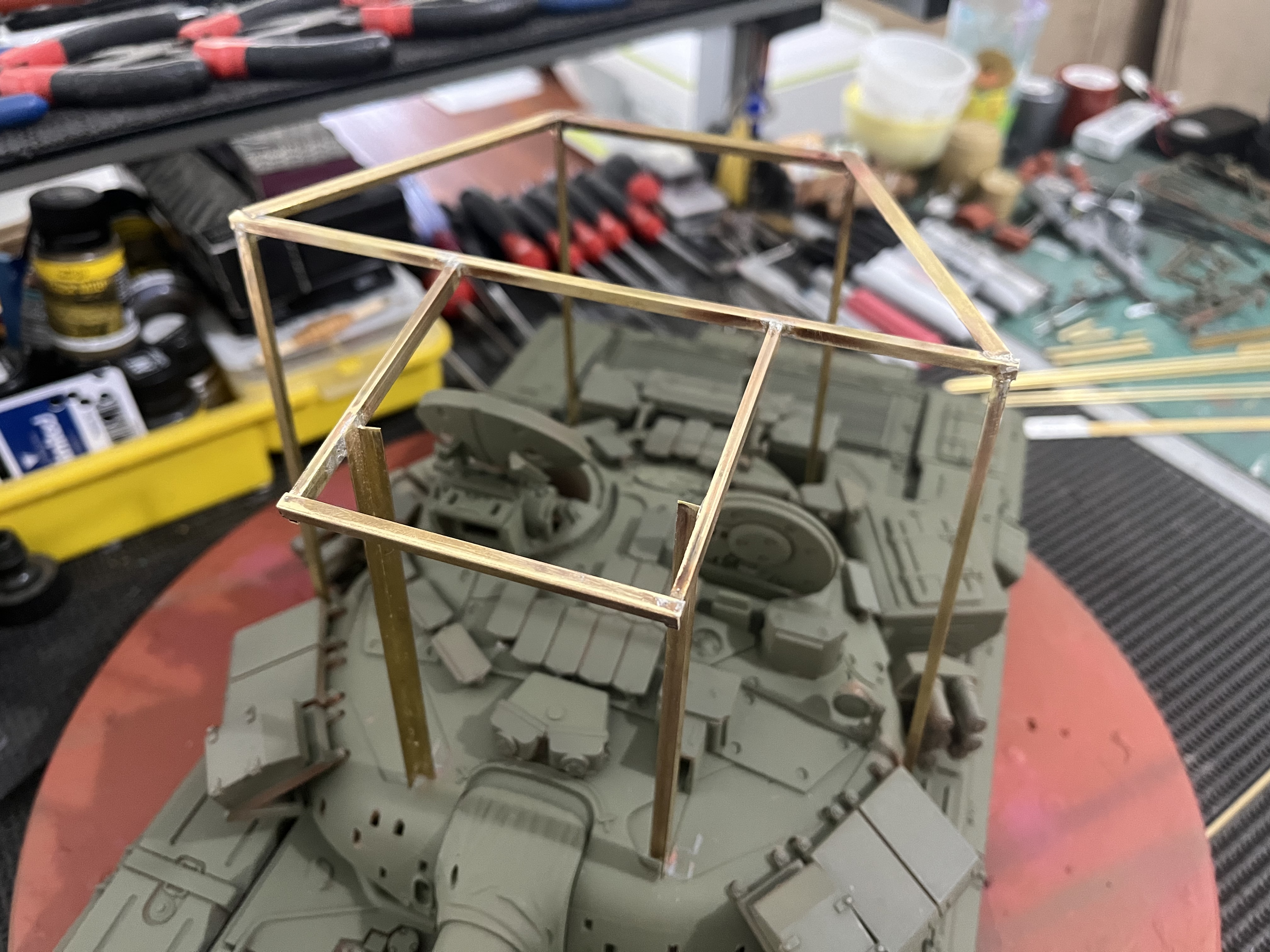

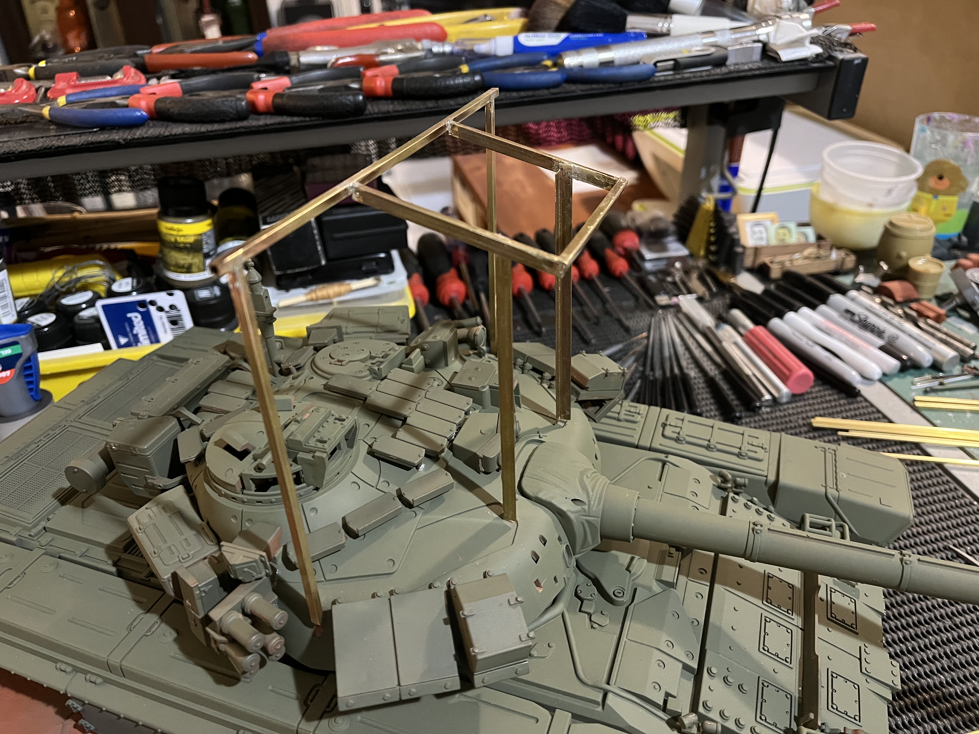

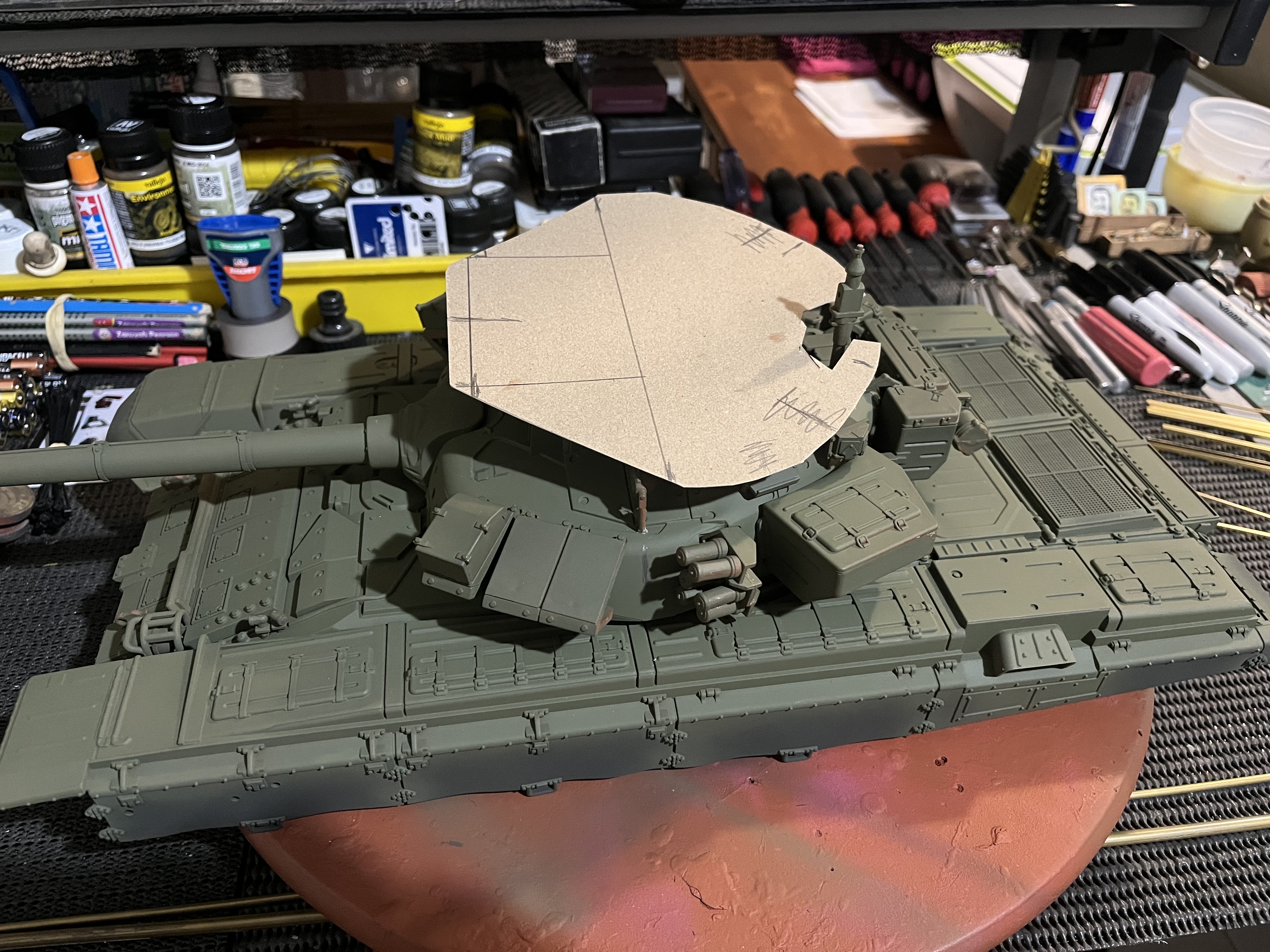

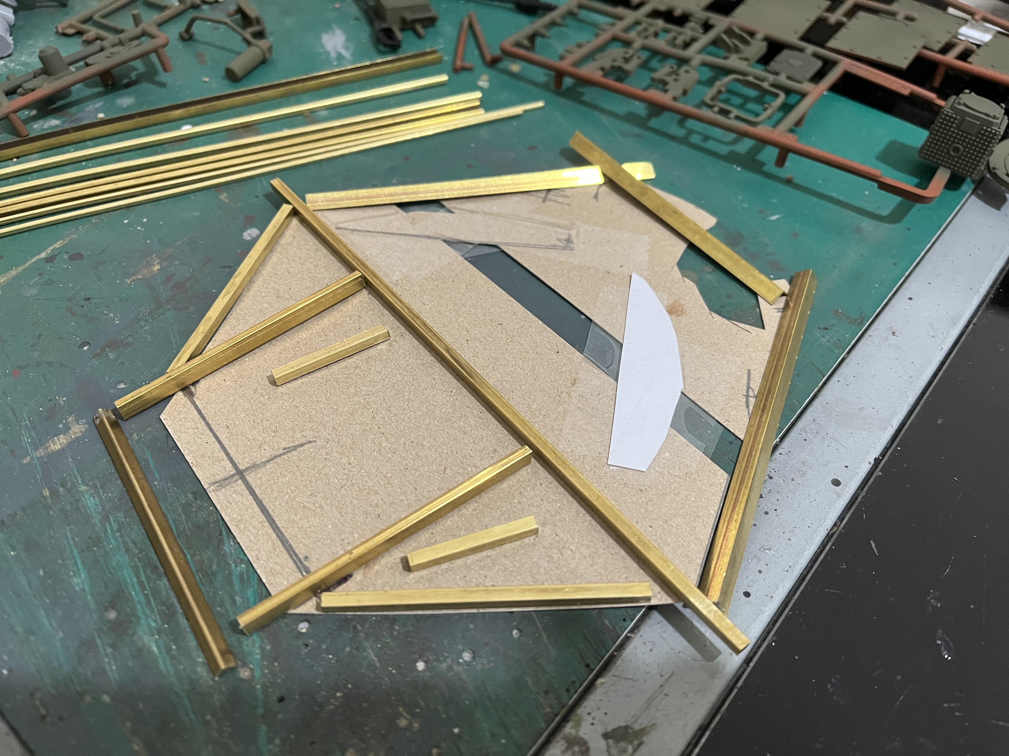

Re: T90 'Z' TWEETY-BIRD
Why do i do it to myself ??
Choosing models that require a lot more piss-farting around than normal
The tank itself is an out of the box with a few bits removed, but the Cope cage !!
its a mission alone.
Im determined to use stuff I have to hand, and the cage armour can be rough & inconsistent as Im sure the majority of them are/were.
Soldering the lot together will be a challenge for sure.
Making sure its also robust enough to withstand the usual handling issues associated with a sticky-outy add on like this.
A cardboard template is to at least give me a loose guide on placement but the actual methodology required to make the damn thing is er, still in development
Lots more brass to cut ready to begin the saga

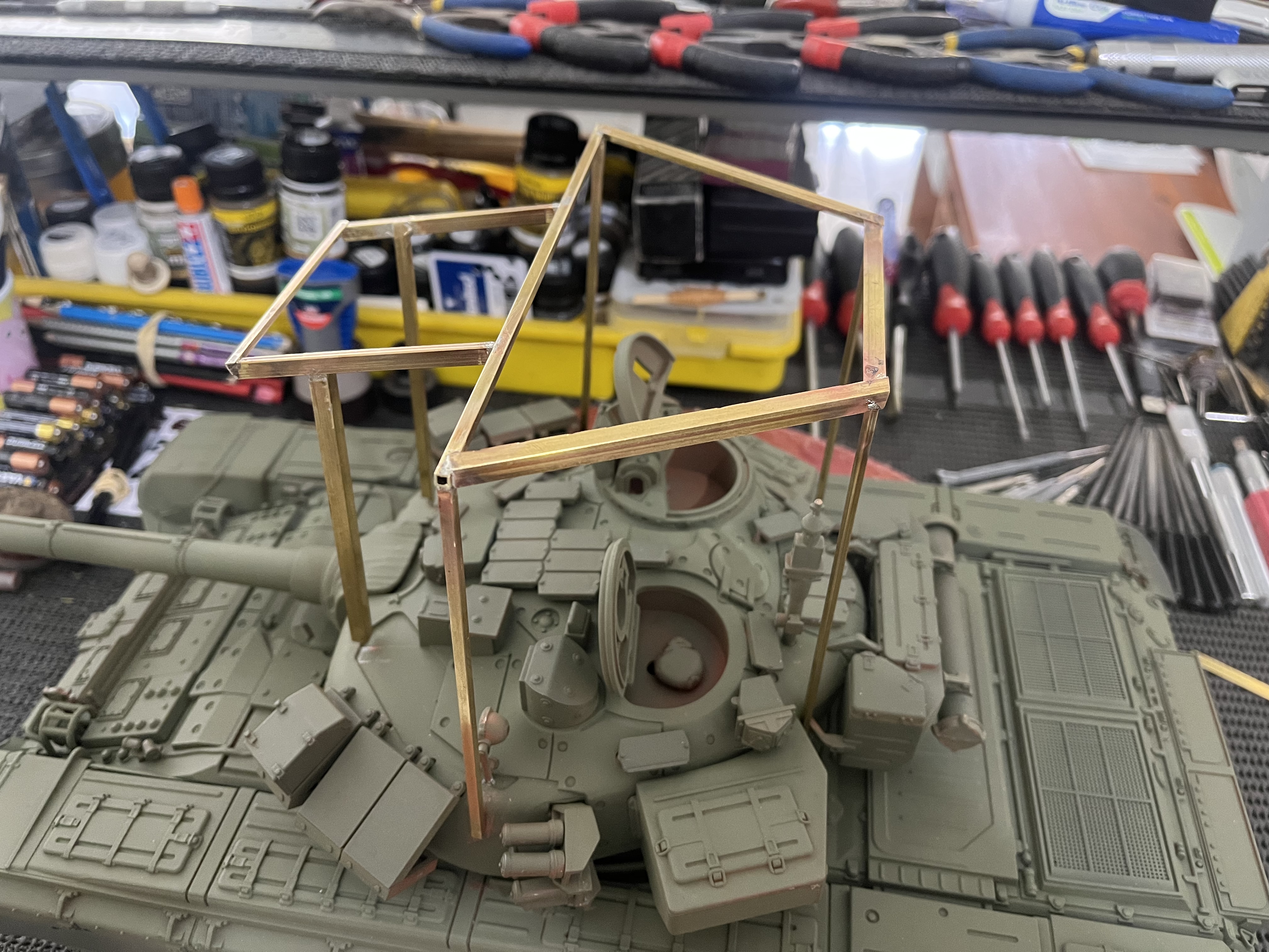

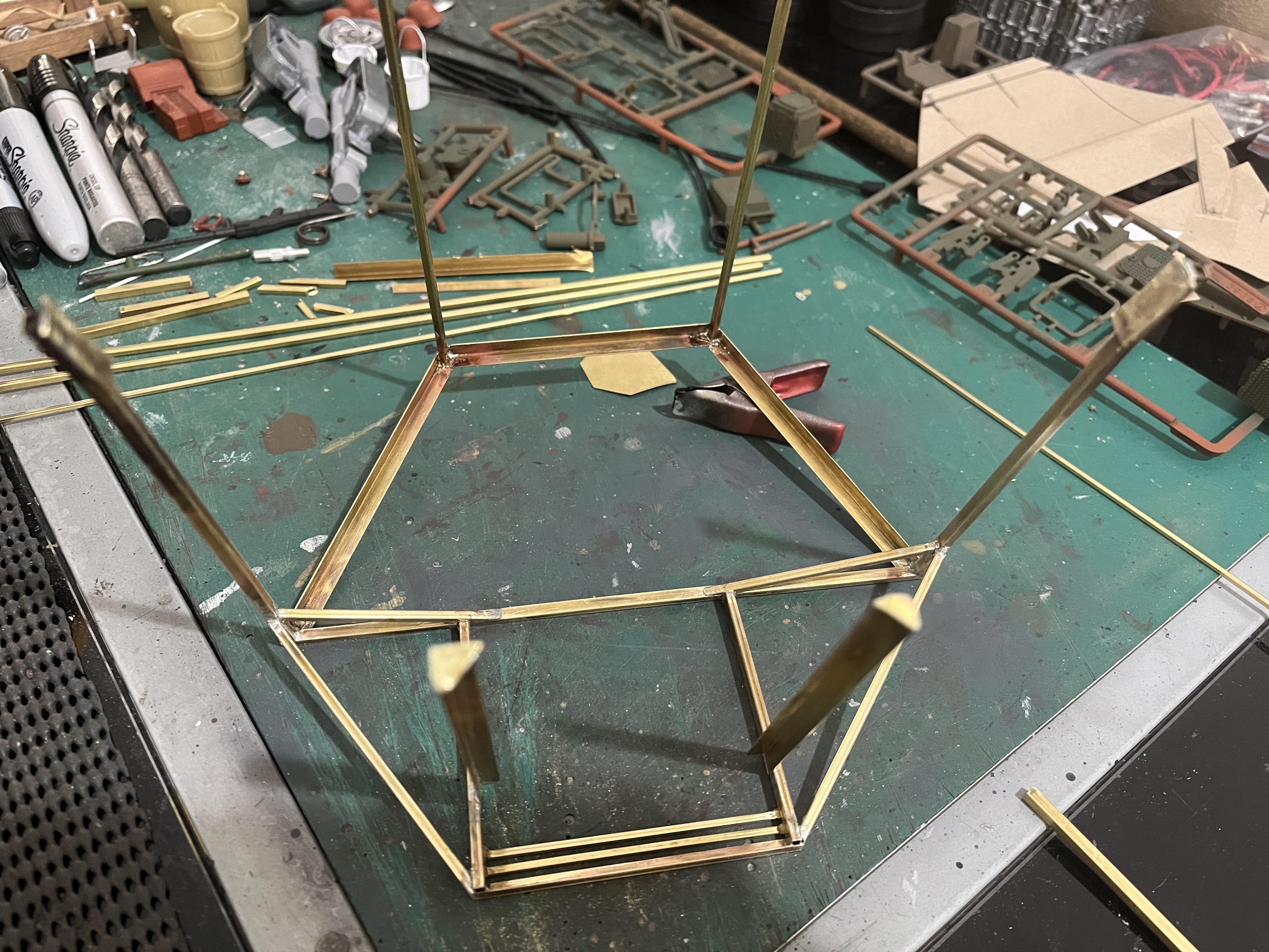

- Lieutenant-General
- Posts: 12058
Solder paste is the best invention for us tank builders since the invention of Rc tanks !!
Not easy to get the right amount of heat V's stopping heat soak to other bits, but its worked.
The base frame is almost done.
A couple of braces to add then the bars.
It will need to be lowered a bit once I decide the final look of it over the MG and hatches etc.
A quick add up of lengths compared to my available material means another trip to the hobby shop I'm afraid
Haha!! Unfortunately it’s seems so!
The bars are going in now, have to use super glue as heat transfer is too great.
I also won’t have enough brass stock by a long shot, so will be a delay until I get to the hobby shop
Long way to go yet
Long way to go yet
