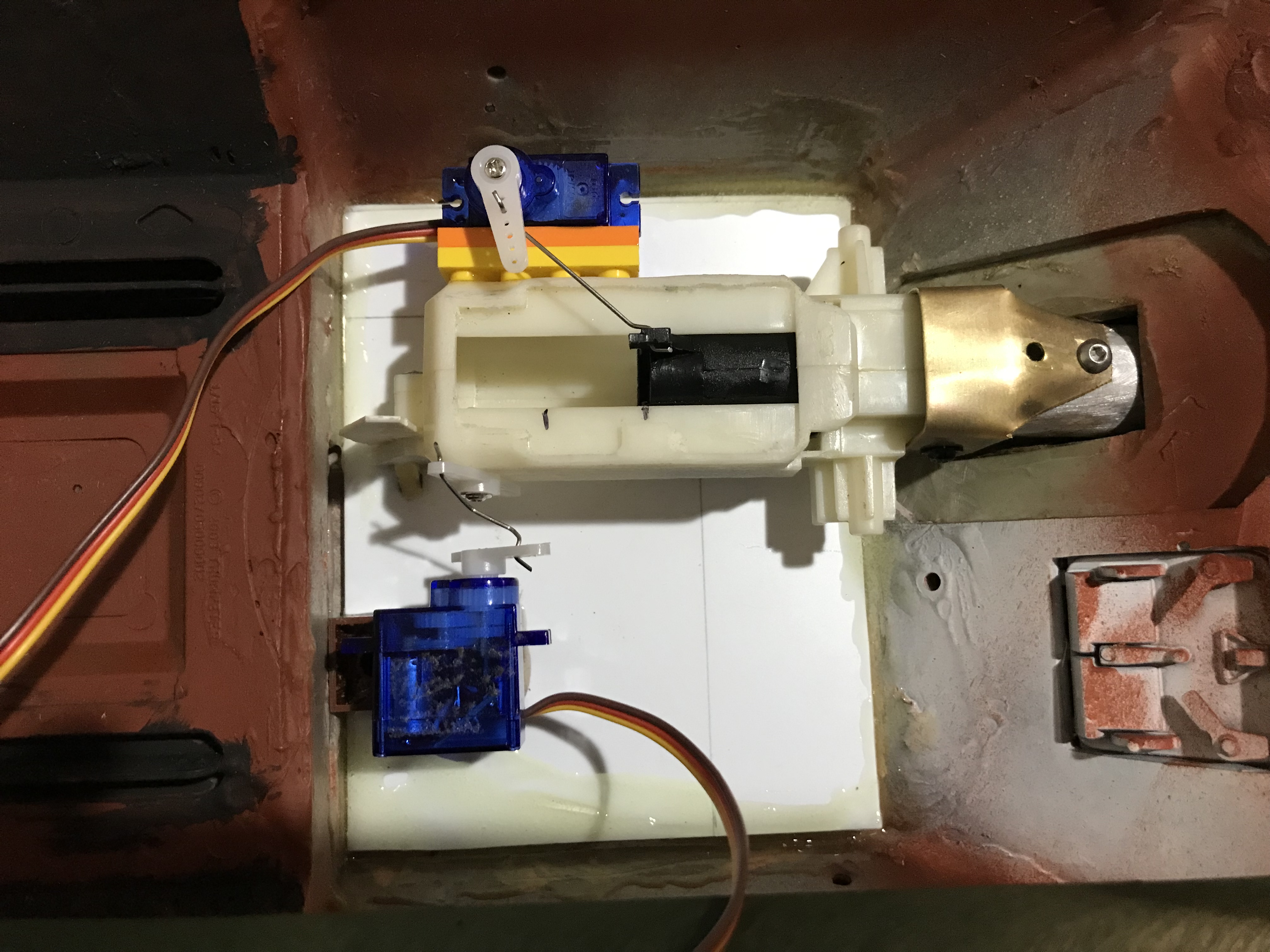

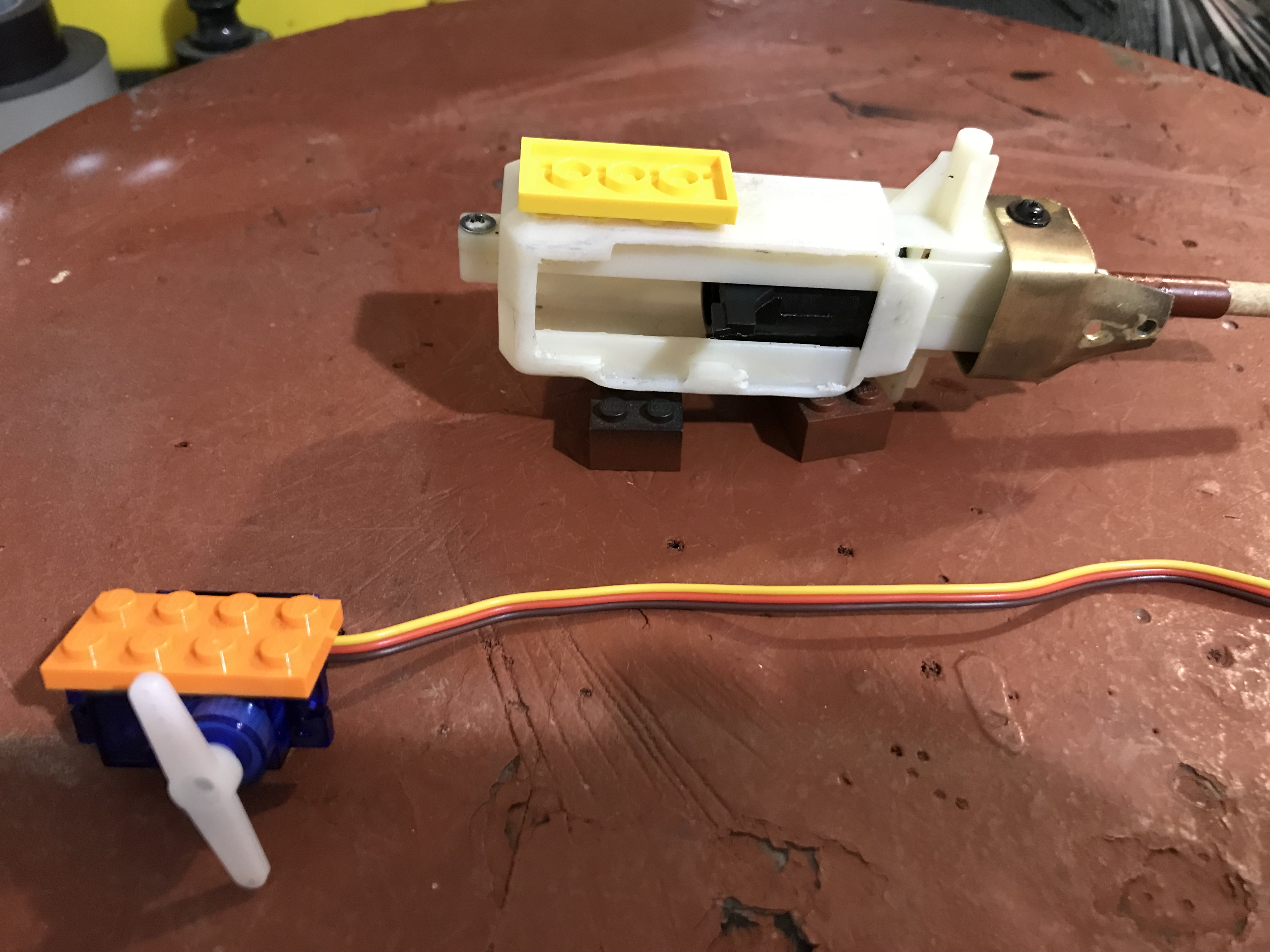

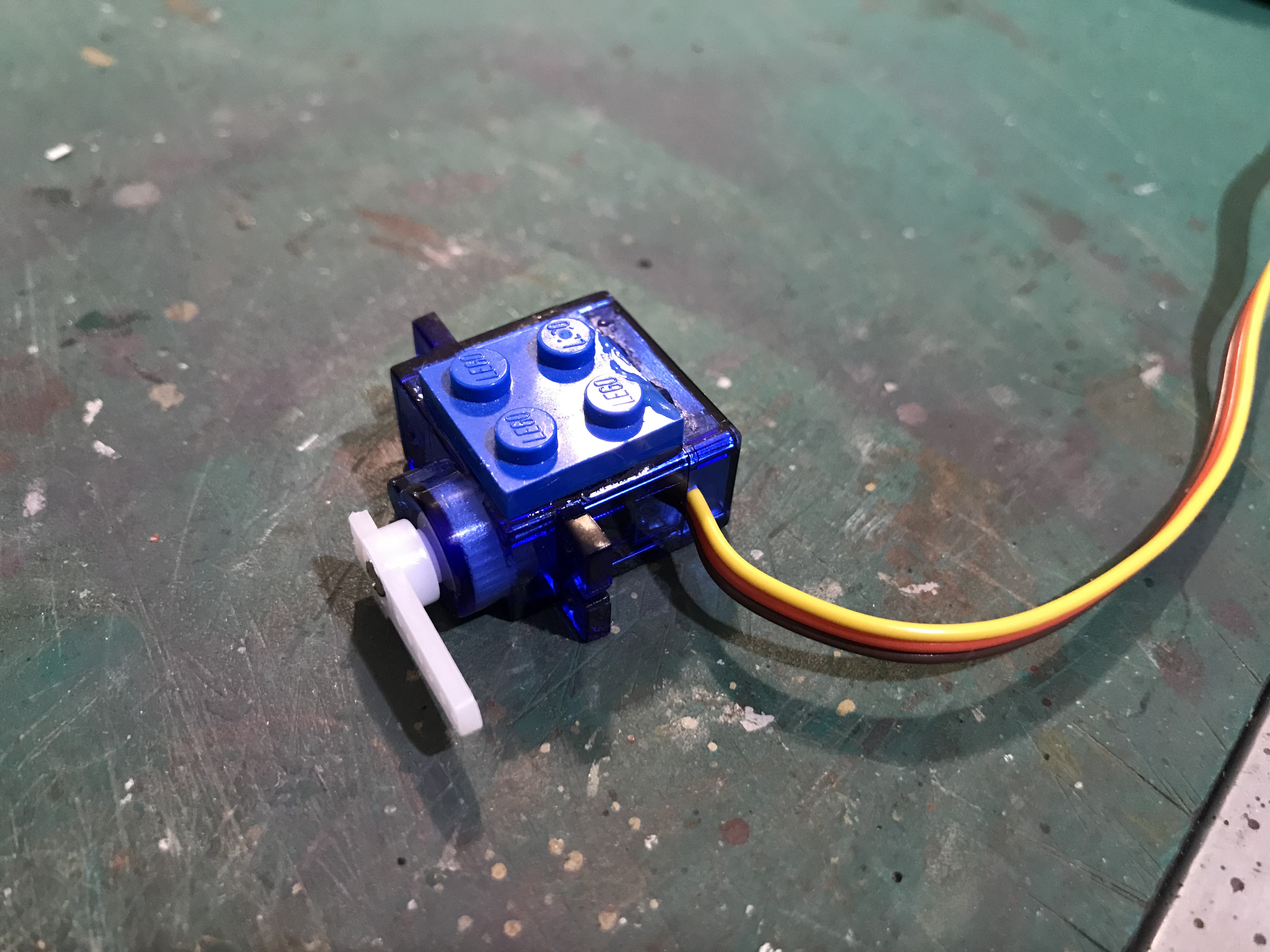

Have been doing a bit on this, kind of subtle forward motion rather than revolutionary landmark creation :think:

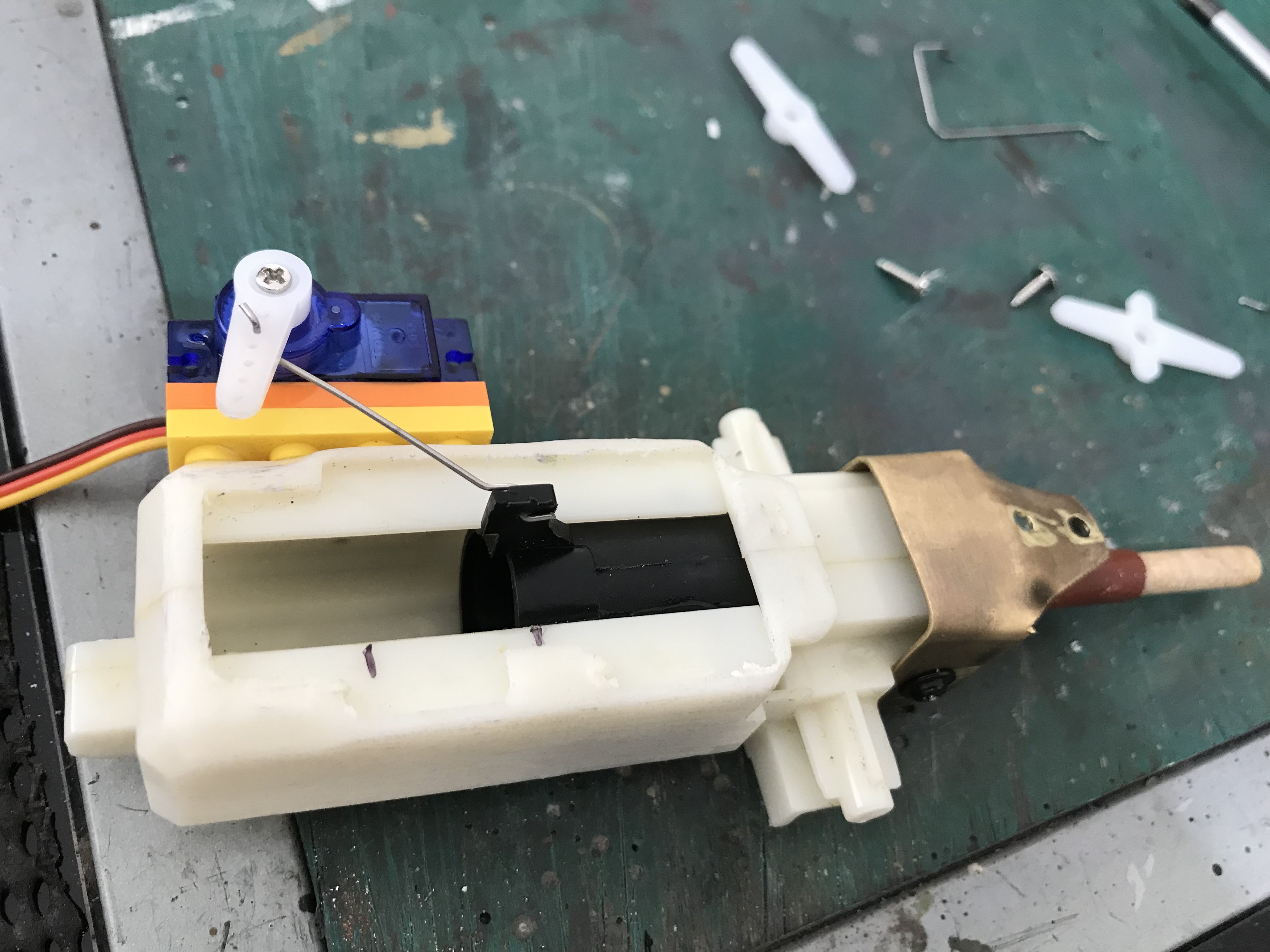

The figuring out of the recoil mechanism, and mounting method has taken a bit of time to get sorted without over stroking the servo & burning it out.
It took a few goes to get the linkage from the servo to the recoil slide right, but its solid and still allows a bit of flexible forgiveness in case of accidents.
Lego and 2-part epoxy was the method of attachment of the servo to the recoil unit.
Same approach with the elevation servo. Lego block on the casemate roof, and one on the servo body.
Way I think it is that if the servo burns out, I can rip the Lego block off it & glue it to the next one ;)

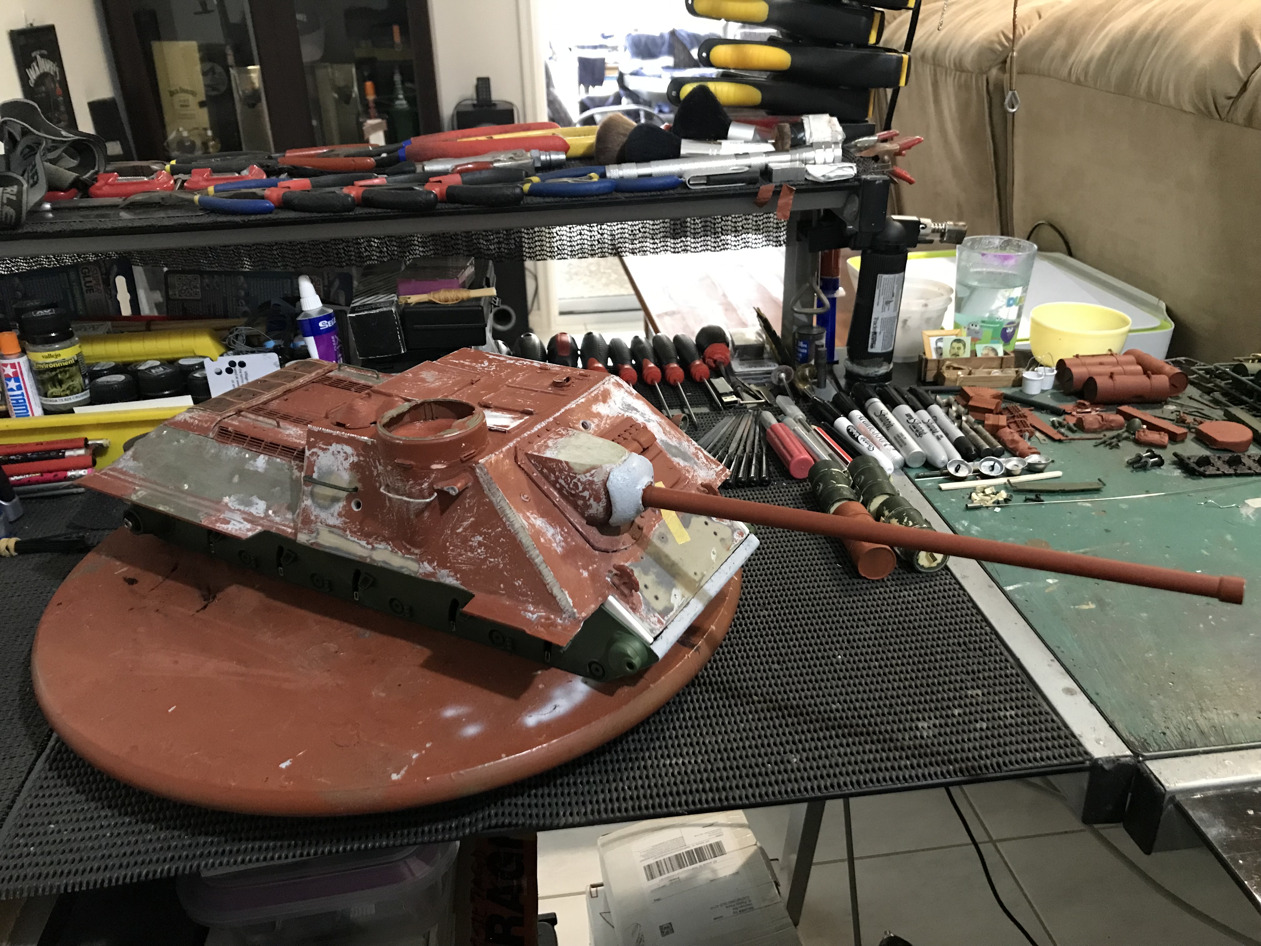

I have taken a bit of time to get the barrel retaining and alignment right, while working with what I have.
She's near enough for this kid.
Looking like it now
Looking like it now

A couple of simple servo links made out of left over H/L aerials , and another lego block attachment for the elevation & its near enough for this kid.
I did make an elevation guide for the recoil unit to minimise the slop in the trunnions that was allowing the long barrel to look like it almost had rotation !! :problem:
Once the outside is done, this should look the part and fit in the line with the other Soviet machines I have.

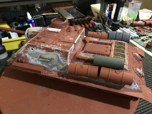

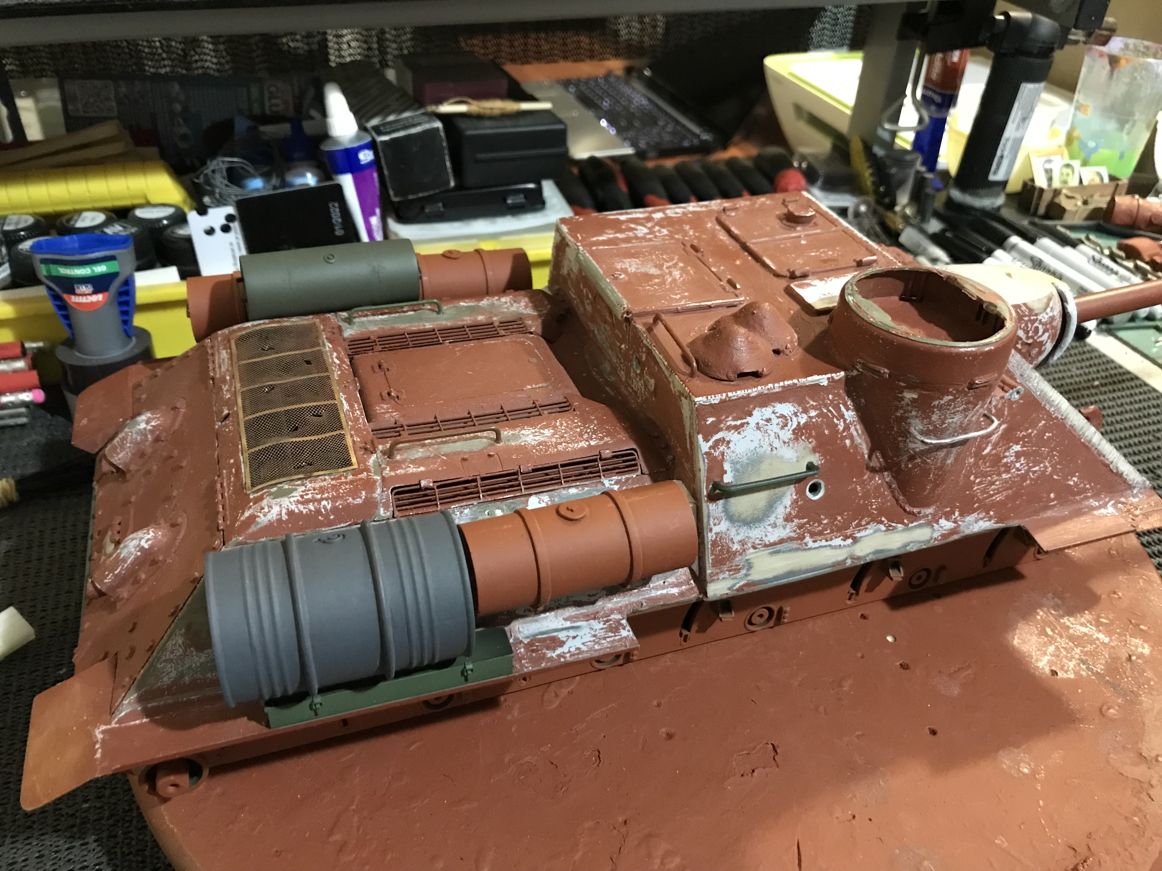

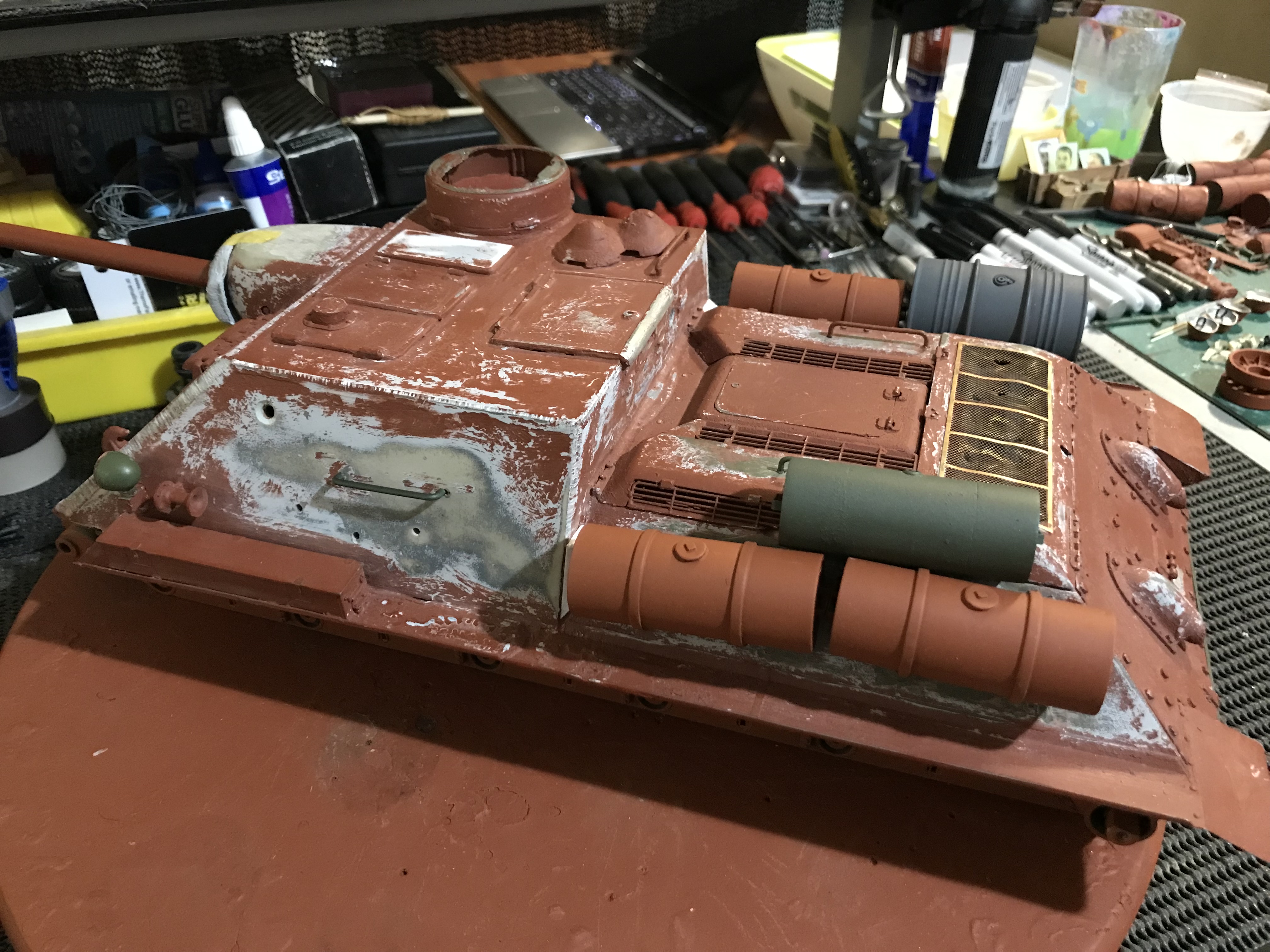

Got the internals sorted so the electronics function as well as they can, plus I went to the lego box again to secure the upper hull to the lower.
A strategically placed '8-block' that mates to another in the lower hull between the gearboxes ,stood off the lower plate by a spacer made of styrene and 2 part epoxy to keep it all in palce on the respective sections.

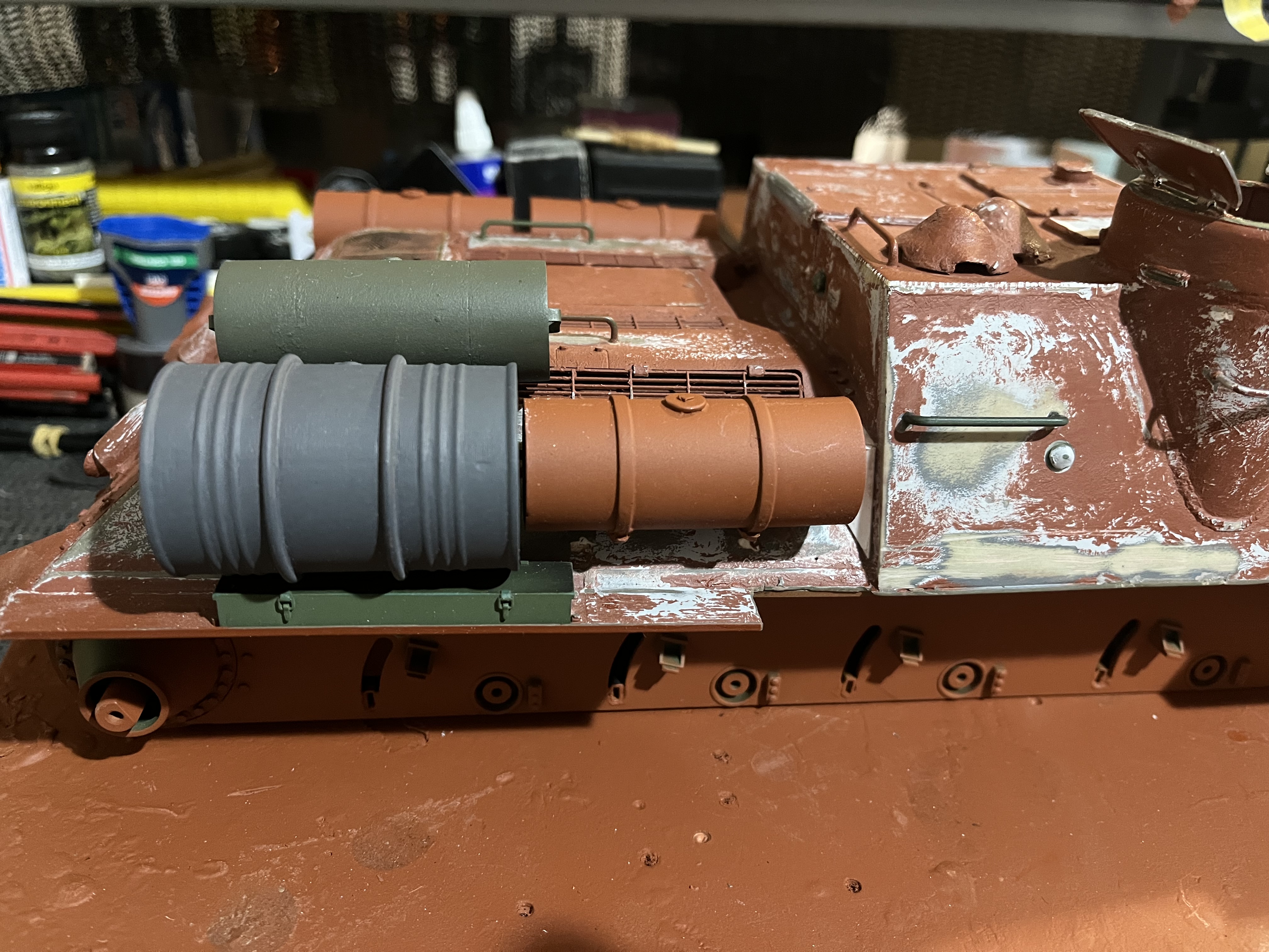

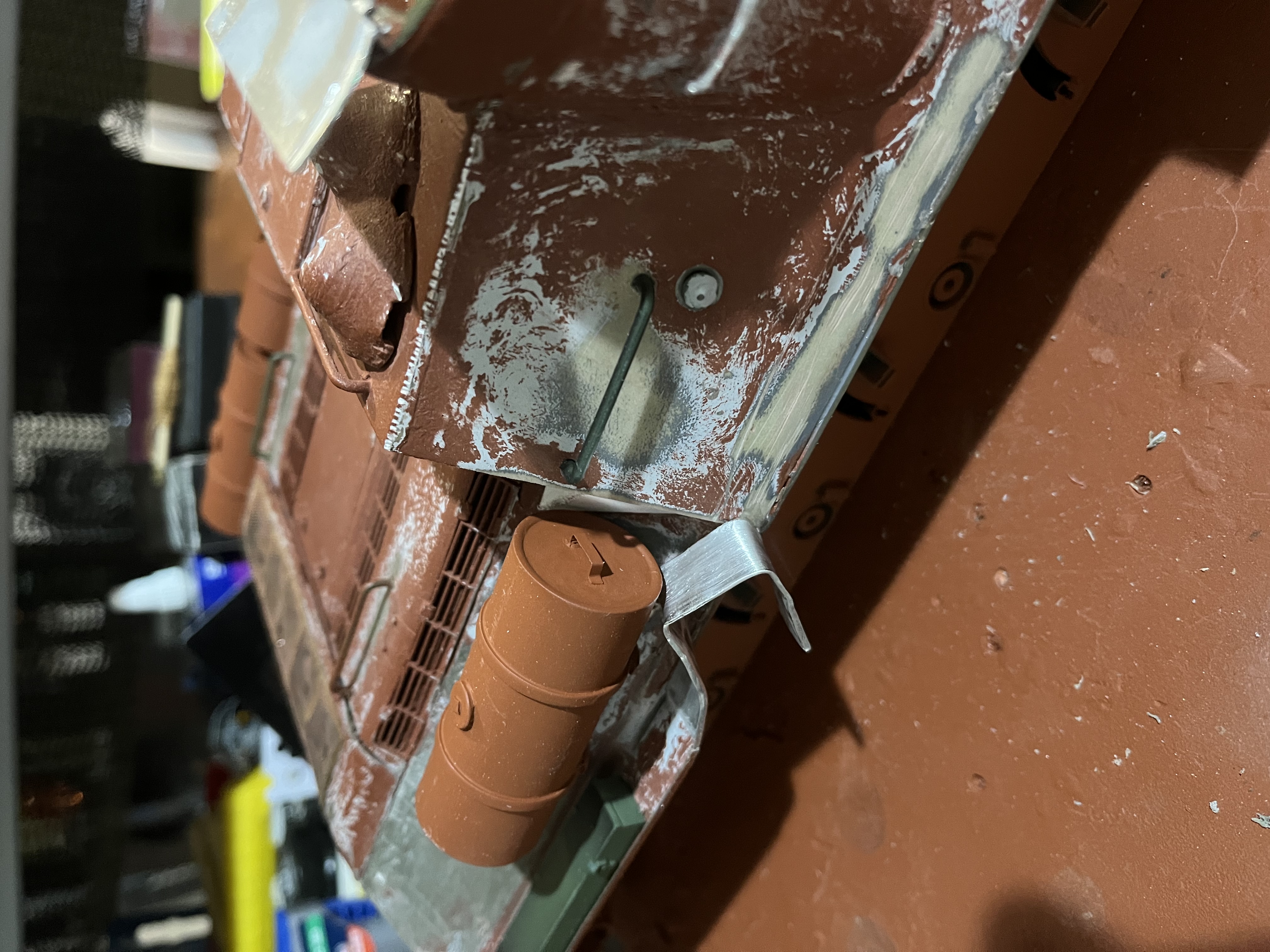

Fuel tanks are also on. They were left over from the SU project, resin, and only 3 good ones.
Although they dont sit perfectly, they are ok, and more robust than the Trumpeter ones which were munted off the thing thanks to international post :/
The last station will need to be made up of an improvised clutter of a 205L drum and a T34 fuel tank roped into place above the tool box.
No I get that this is not the specific look of the vehicle in the period picture I've gone off, but there was more than one SU 100 in the unit marked for the anniversary of the Uzbek State. I will adjust the numbering accordingly.

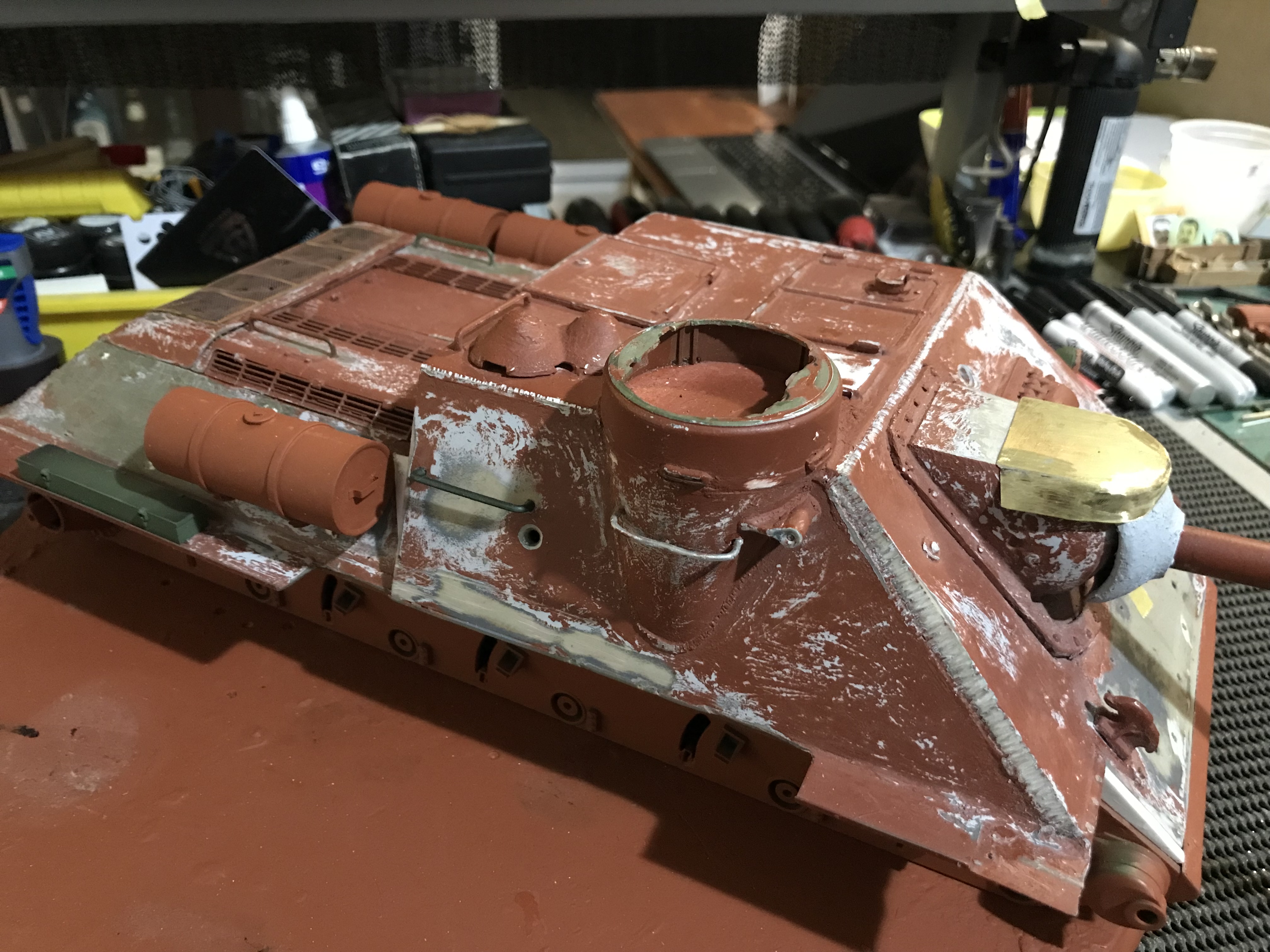

last of all is the rain/debris cover over the mantlet. I did that out of brass, as the resin item was just awful :problem:
Mines a bit better while still not trumpeter-perfect.

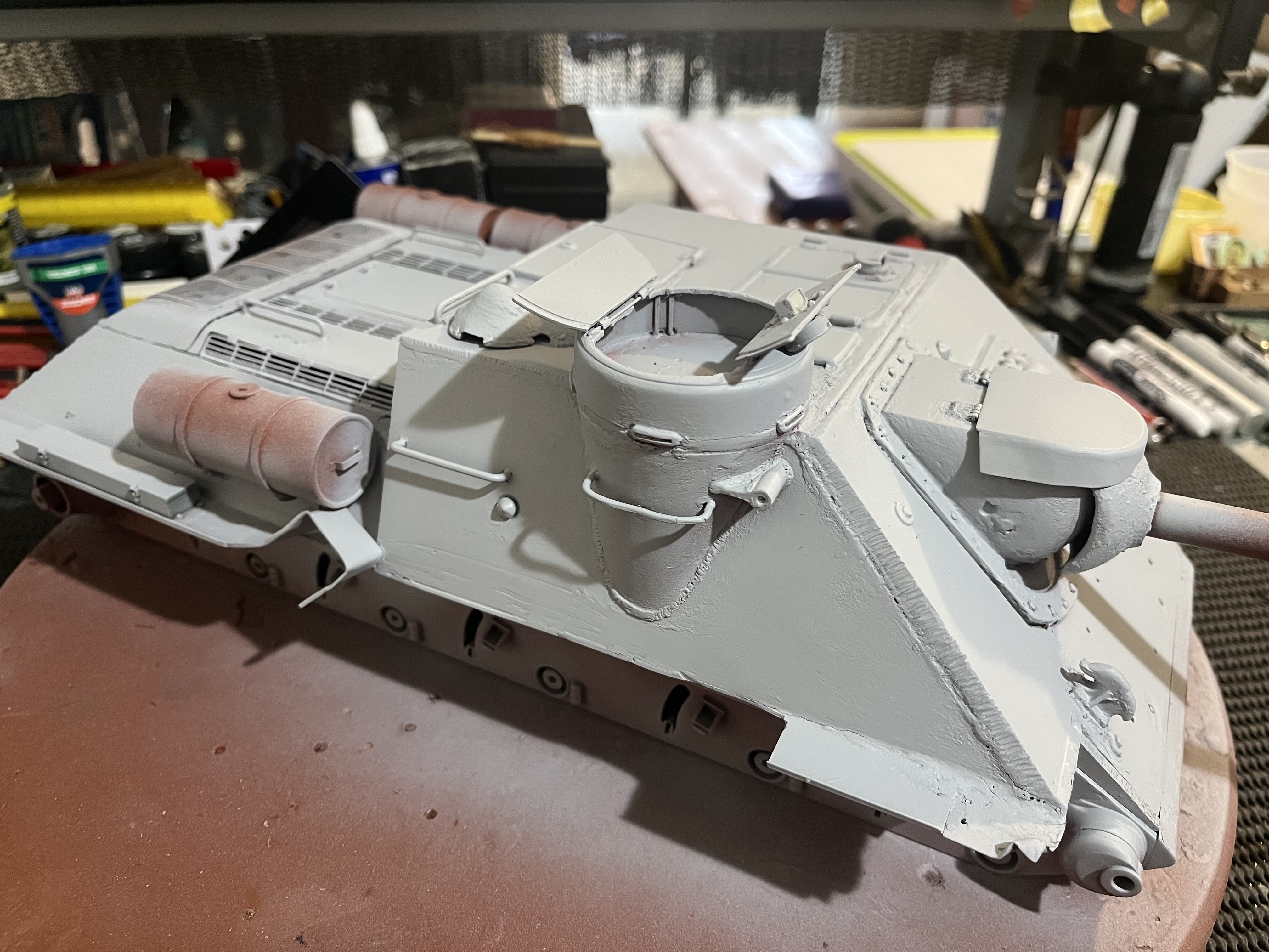

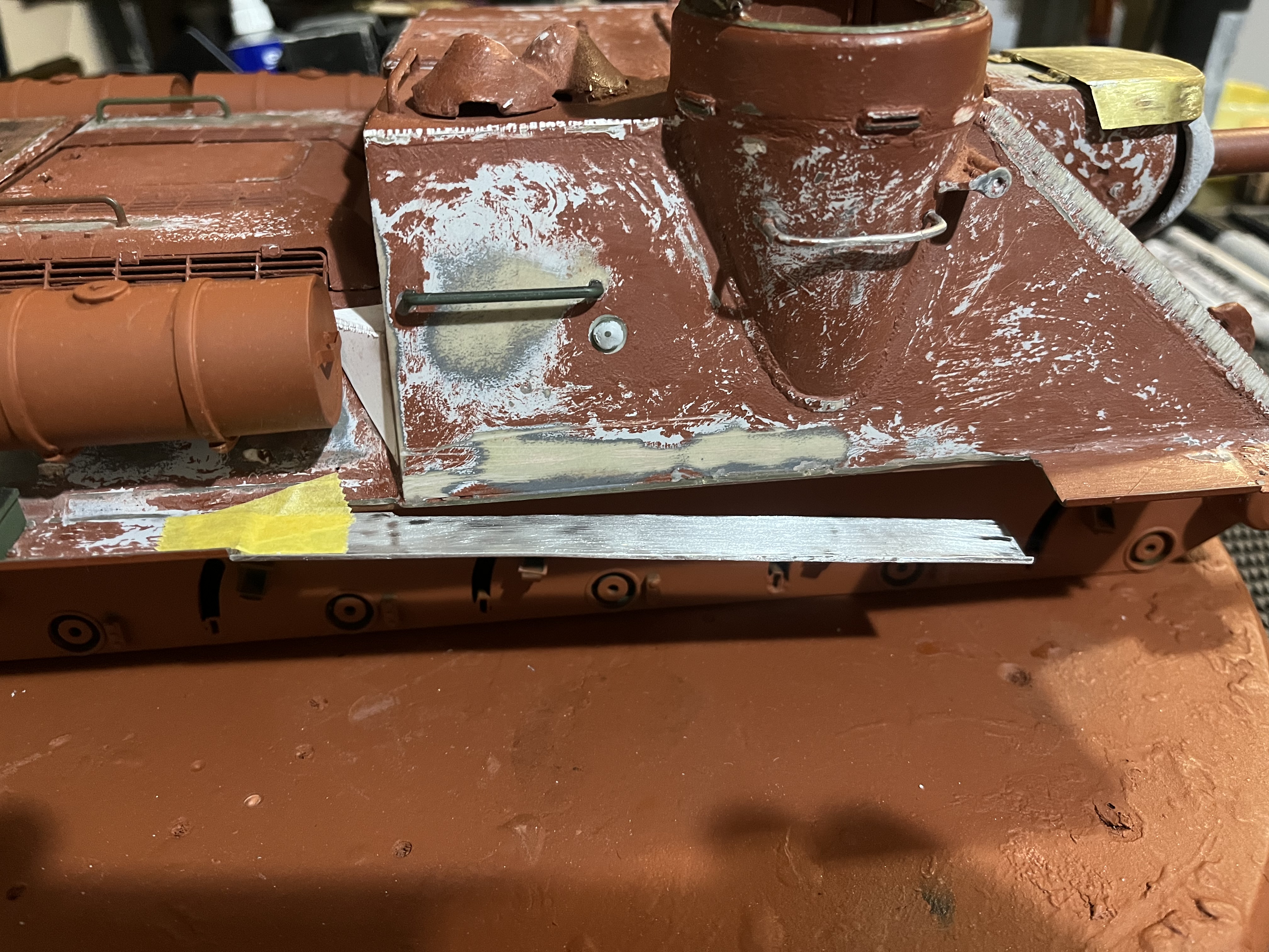

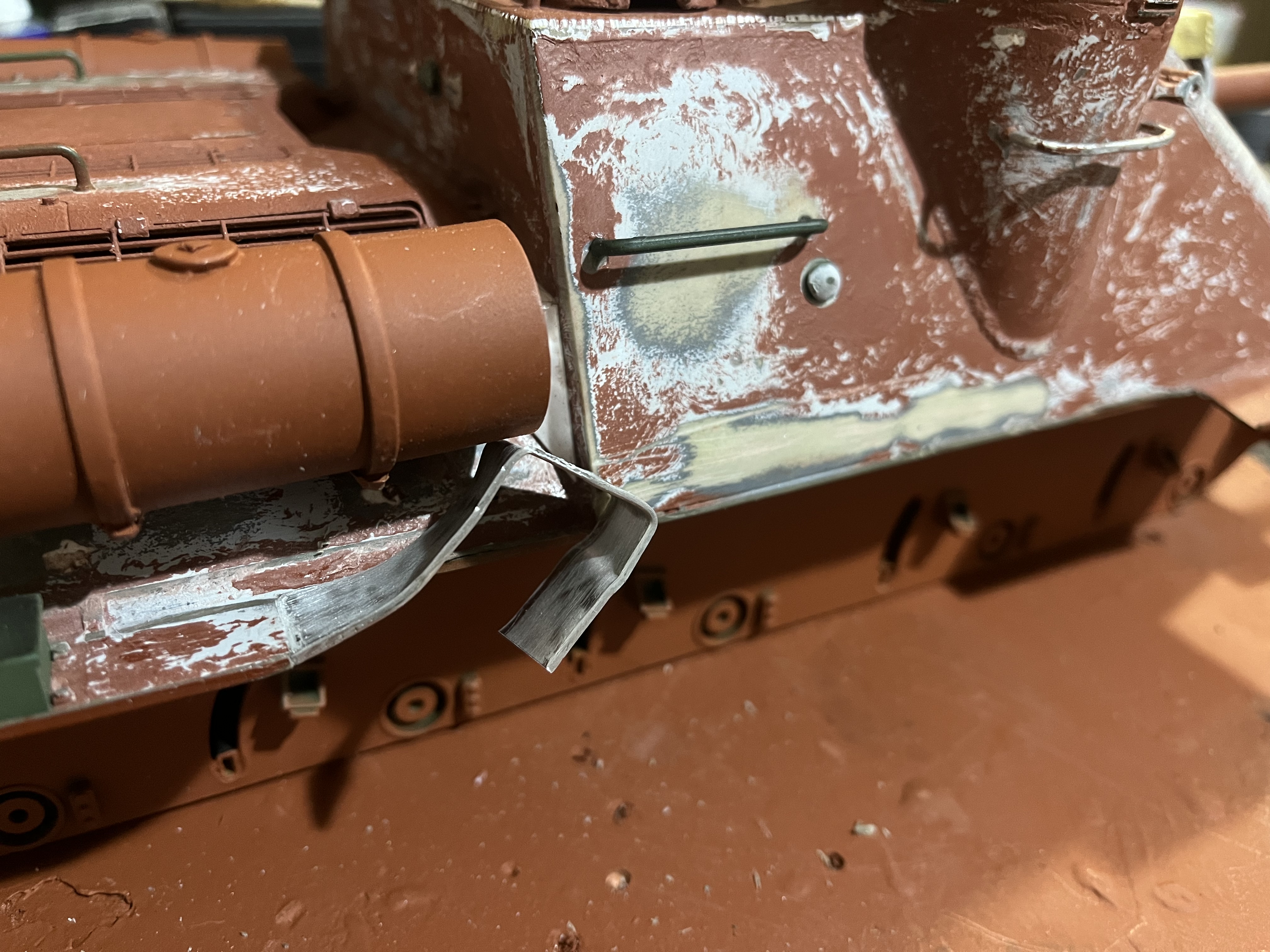

The deflected guard section on the right side as pictured in the subject image is on.
Used thin alloy sheet(rather than brass)so I could manipulate it a bit easier.
The shape looks about right, as does the twist !
Once the tracks are on I can trim the lower edge to just miss the top of the track run.
Hope to get the last weld texture on and into primer this weekend.

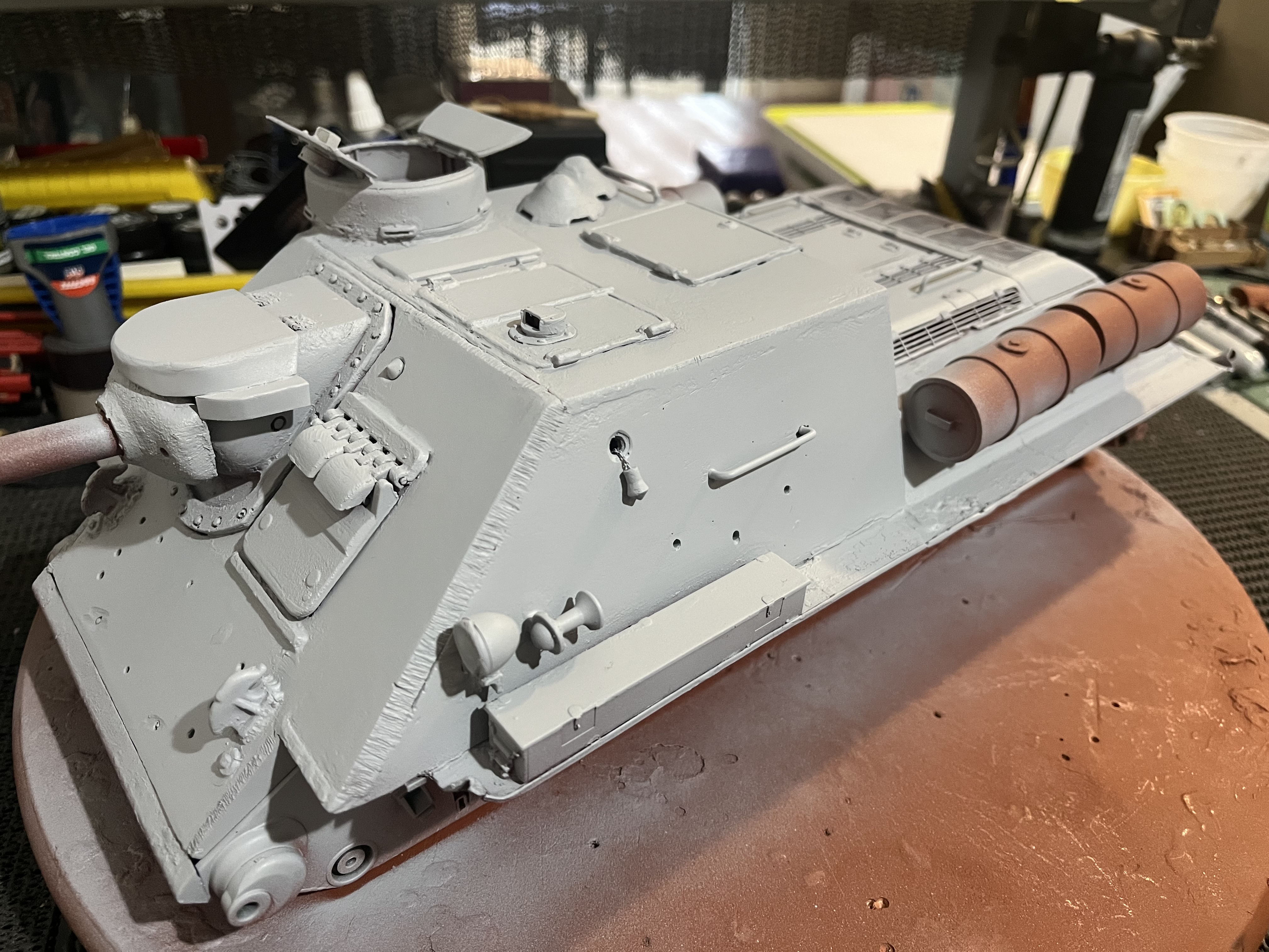

Well, its at least one shade now!
I just could not cope with the patchwork appearance any longer.
Used a light coat of Mr Surfacer 500 spray can to blend the lot together.
Tomorrow is a light coat of actual paint primer, and perhaps a dust of TS-42 light gun metal as I have used before to get the ultra light undercoat before shading and 4BO goes on.
While its not going to end up as a full on mm perfect version, its close enough and I'm certainly grateful to Mr Markocaster for the opportunity to finish it off.
