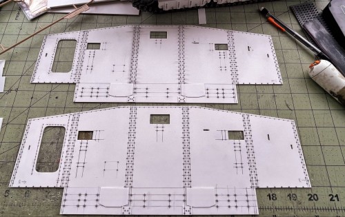

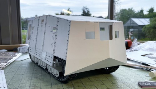

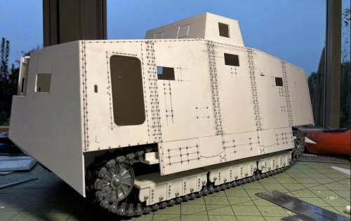

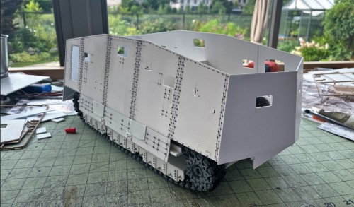

Hi everyone, here i am, back at the front after a beautiful summer of travelling and relaxation. I think it was the first time in my life that i did not do any modelling for 3 months strait. Now, let's finish this A7V monster.
I had earlier finished the two sides armor plates with their rivets, enough to make you sick.

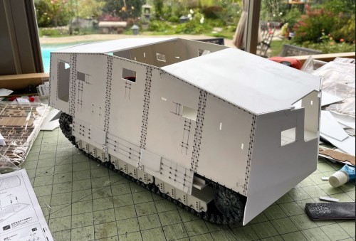

- A7V German WW1 tank 1/16 RC - Build

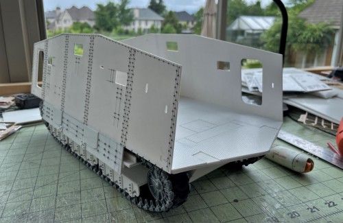

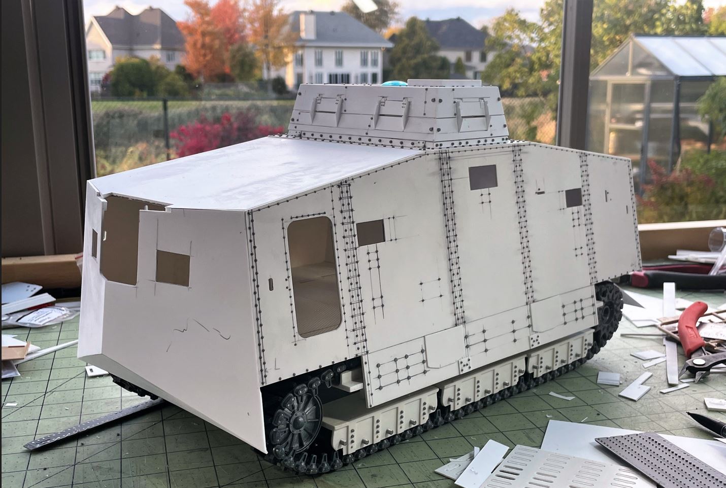

Side armor are installed on the chassis.
The front and rear armored plates were redone to better meet the joints, get rid of all the pre-drilled holes and position the gun and visors at the right location. Rivets for all remaining parts will be added later.

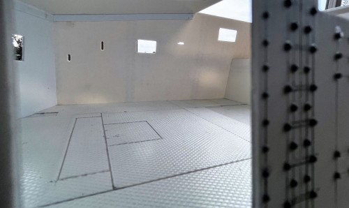

The interior is quite spacious. It remains to be determined if i will take the time to complete the interior at the front. A detailed interior will complicate the electronics for the gun rotation, elevation and recoil, and take a lot more time. I'll see because i have more exciting builds awaiting.

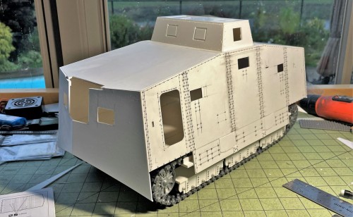

The main structure of the drivers compartment was assembled. Because of the new shape of the side armor, i needed to extend the back at the front and back to meet the angles of the side armor. The whole compartment will be given an overlay to hide all the holes and position the visors at the right place and dimensions.

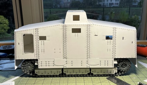

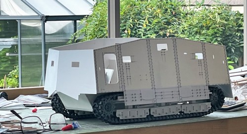

It is starting to look like an A7V

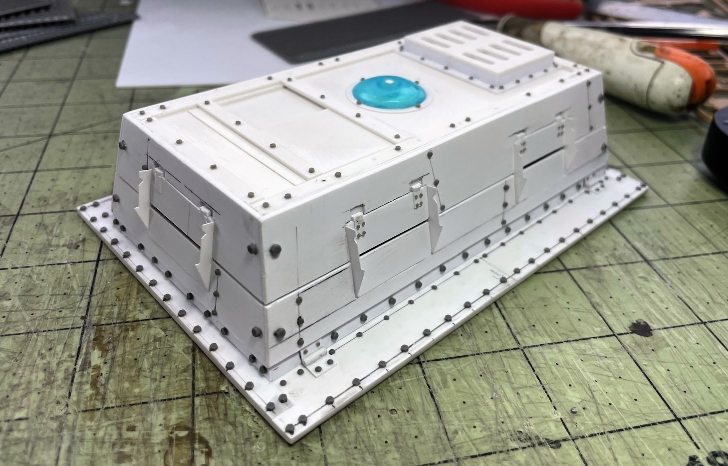

This post is for the top driver and commander's castle.

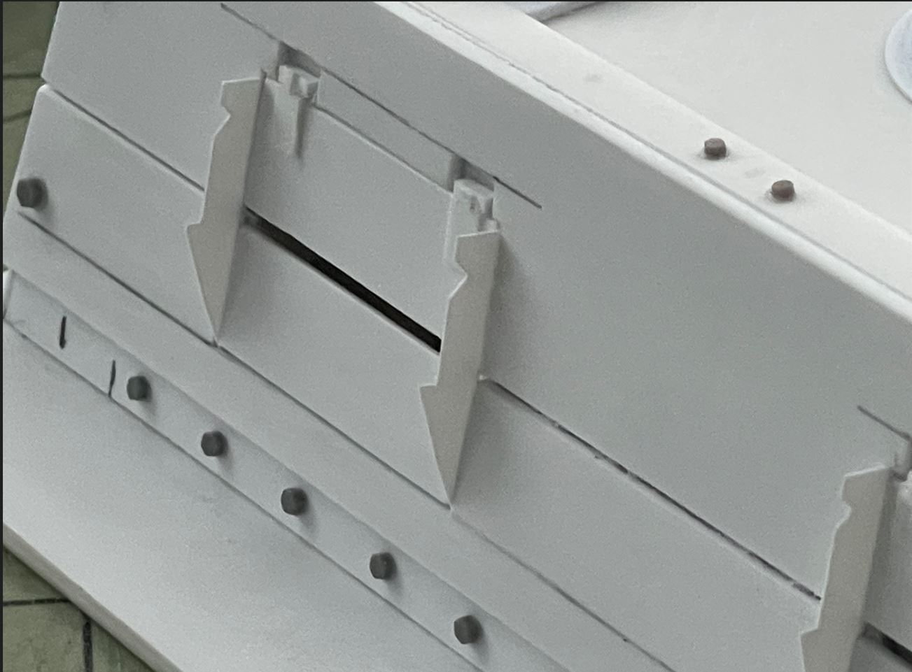

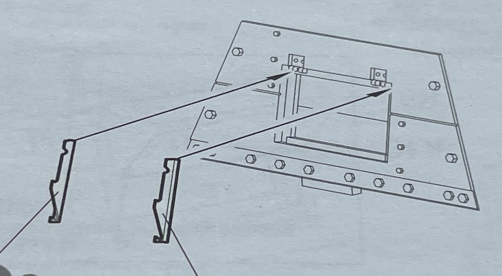

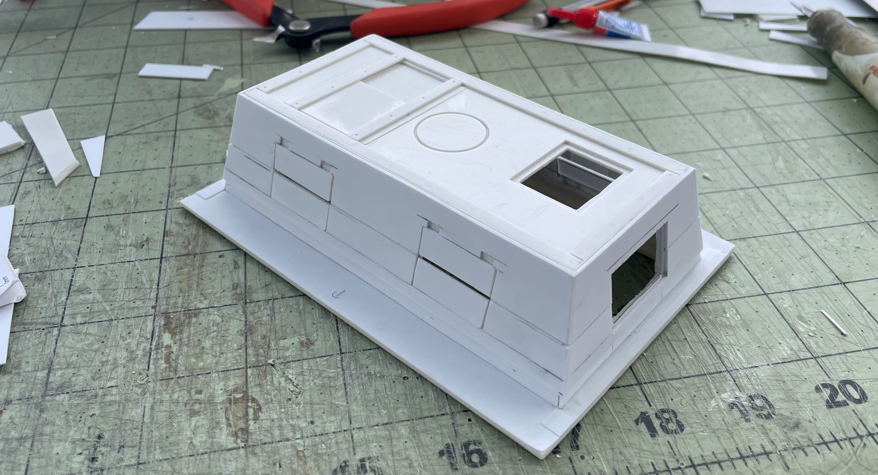

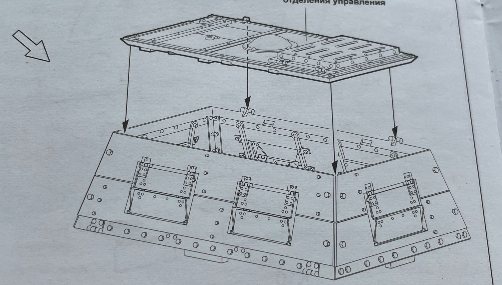

The Ludwig kit parts only provide a basic shape for the castle, mostly inaccurate. Using the 1/35 Meng kit and instructions, i had to completely redo the exterior which is composed of bolted on additional armor. Here are details of the side panels, with the mechanism for opening the visors.
- Capture1.JPG (150.35 KiB) Viewed 3692 times
Overall view of the castle.
- Capture2.JPG (217.43 KiB) Viewed 3692 times

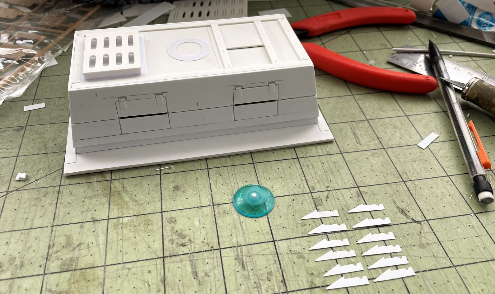

The two section extra armor is added on top of each sides. New visors are created too. This is time consuming due to all the various angles. To simplify the construction, all the visors have been glued in closed position.
- Capture3.JPG (234.02 KiB) Viewed 3692 times

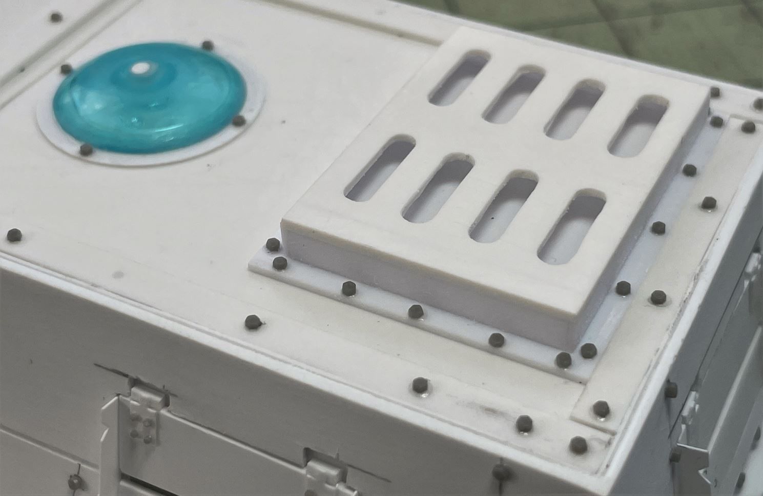

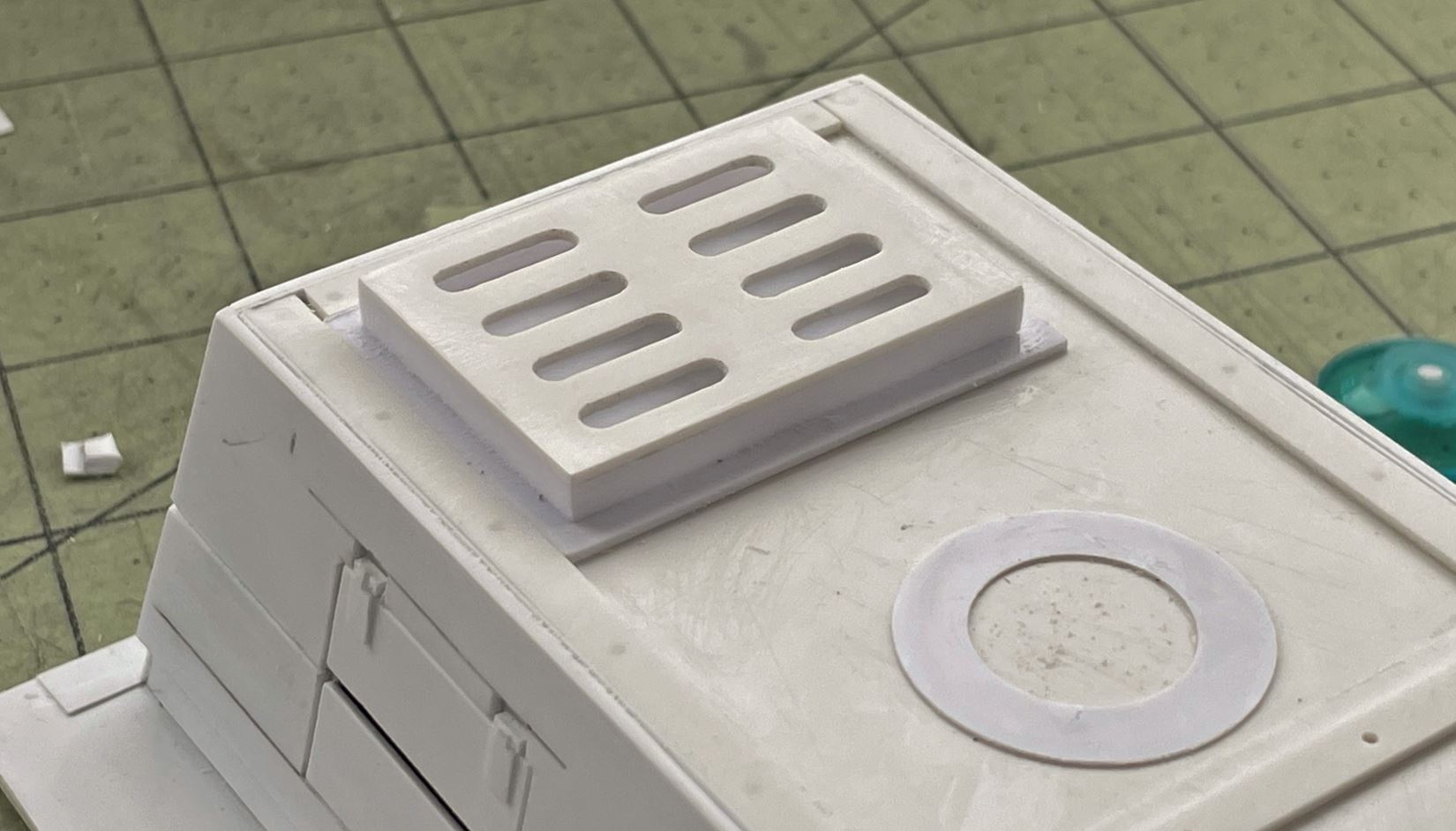

The sliding top commander's hatch reuses some of the Ludwig parts. The more accurate grill on the other side was built from scratch but i was able to reuse a section of the Ludwig top grills provided for the glacis. For some reason, i was given an extra sheet of these parts. Parts for the visors have been created in very thin plasticard. The dome on the middle top of the castle is created from a Lego part.
- Capture4.JPG (241.42 KiB) Viewed 3692 times

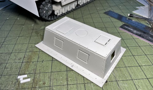

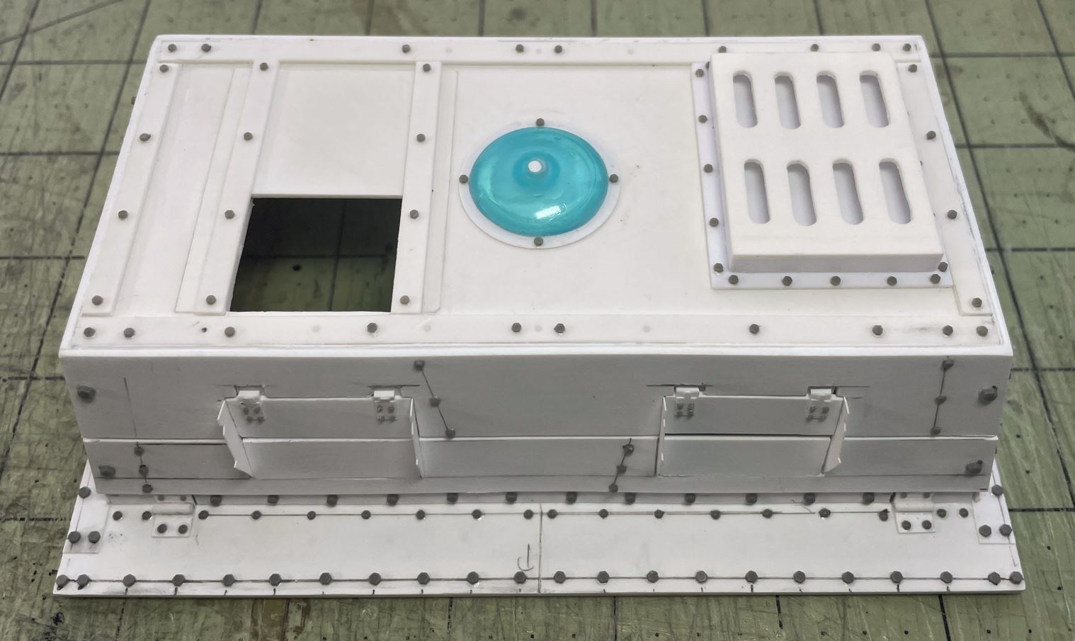

The finished castle with about 400 rivets and bolt heads.
- Capture7.JPG (142.65 KiB) Viewed 3692 times
- Capture8.JPG (114.21 KiB) Viewed 3692 times

The finished castle as it looks on top of the model. I found a few more tiny rivets to put on but that will do for now.
