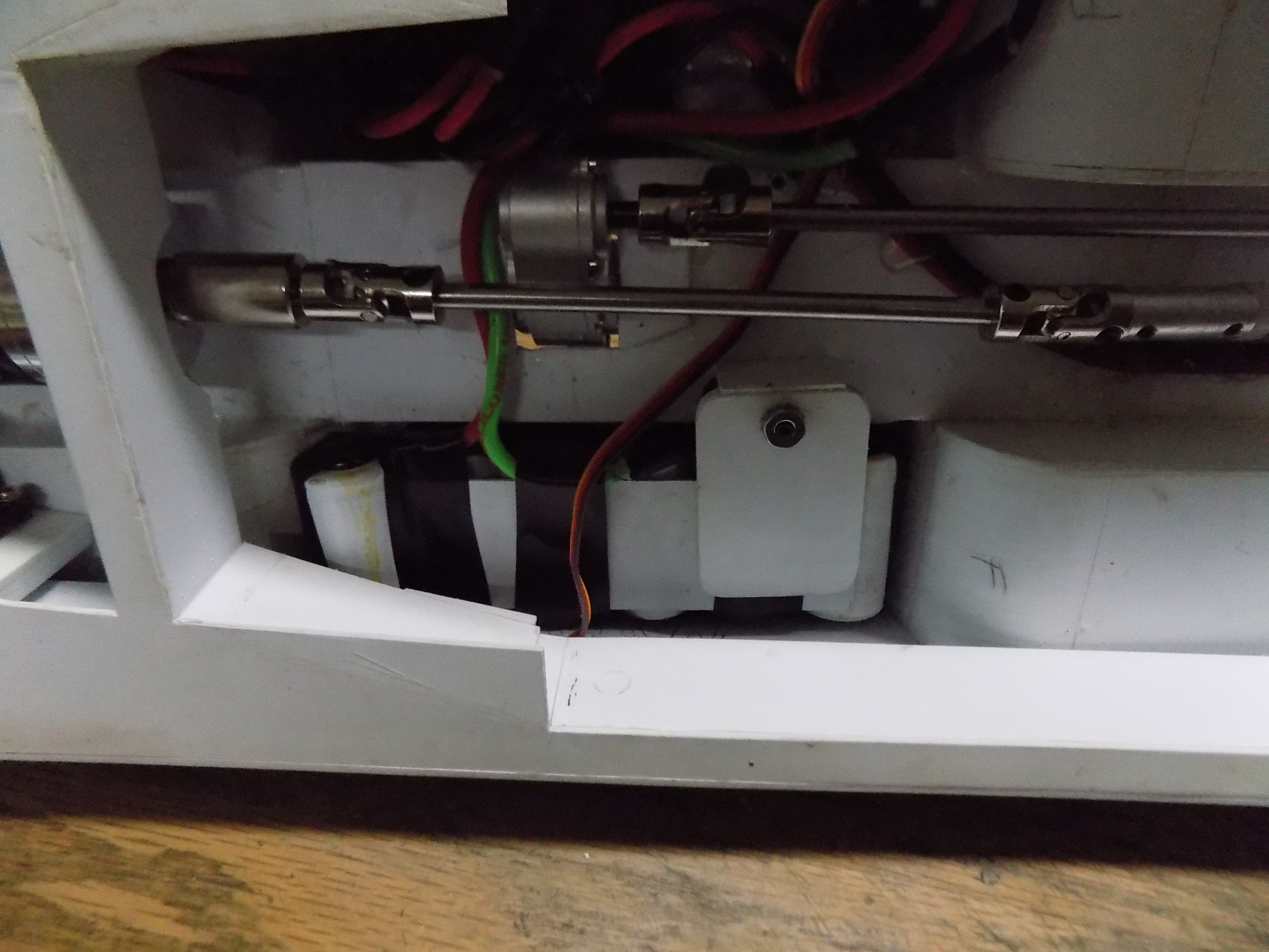

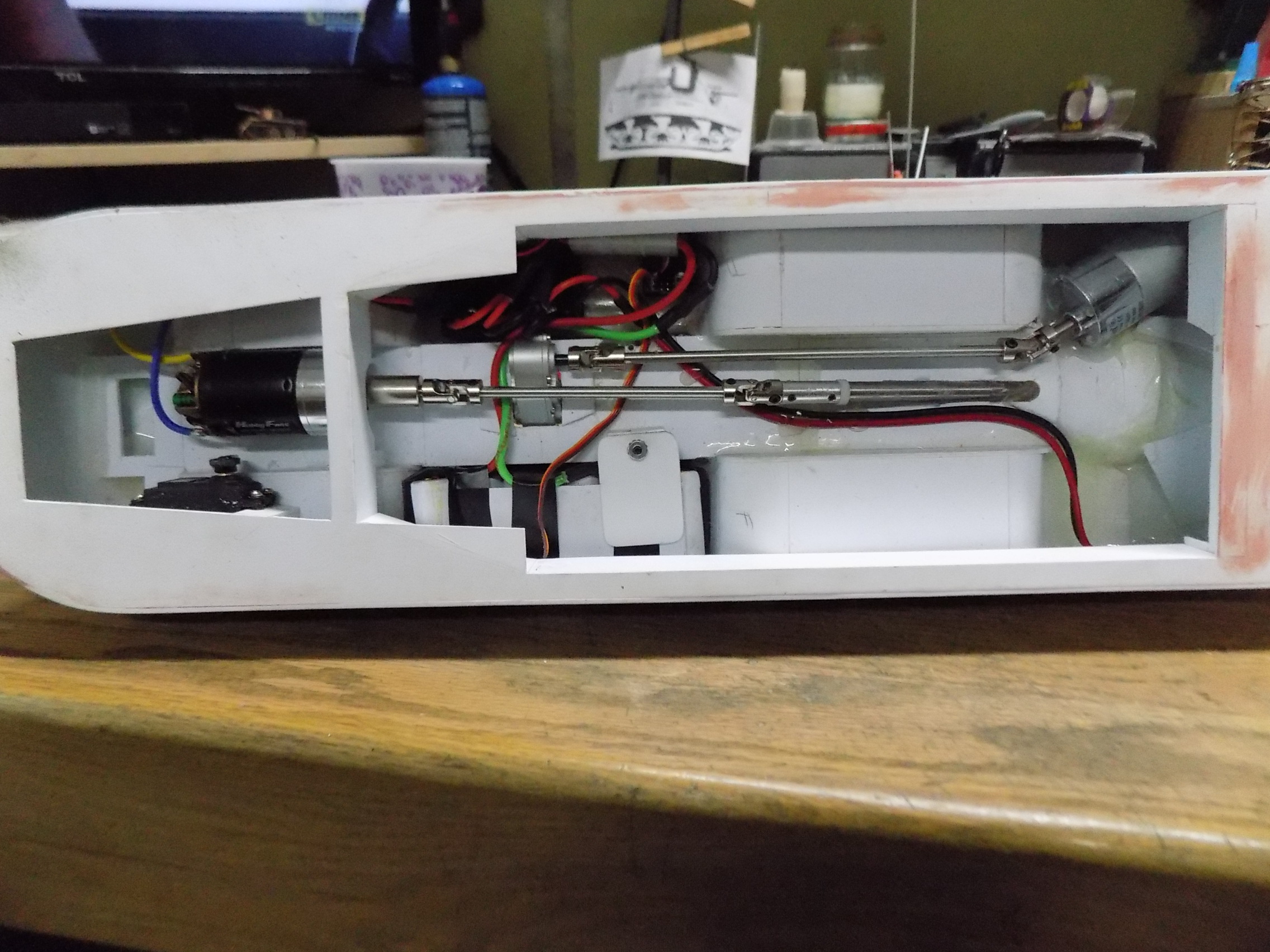

Update, sorry this has been so long coming. Parts delivery in rural areas takes time. Amazon's two day delivery is more like five or six where I am. Some of the parts have been sent from out of the U.S. and the take even longer.

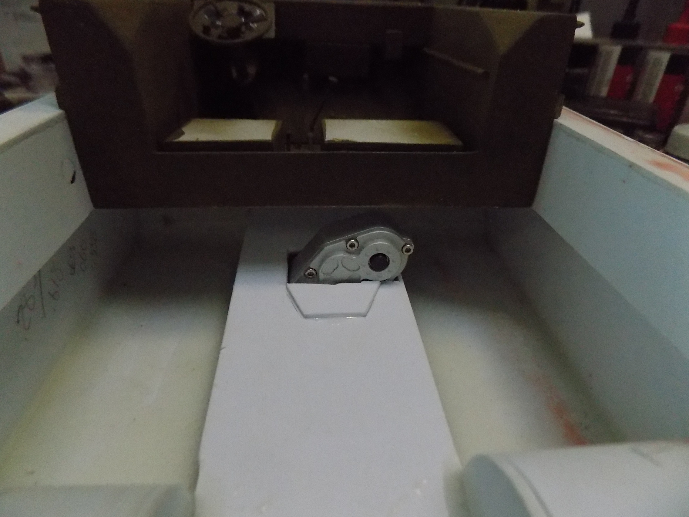

The transfer case I chose to work with. It is for a tenth scale crawler and it is a bit over size for this project. I've packed it with grease and plan to seal it to the hull with silicone, so it will be able to be serviced when needed.
Packaging has been a bit of work. I want to keep it all below decks and it needs to be balanced. Reversed the input shaft to the T-case and put its motor in the rear. It is a 380 motor with gear reduction unit with an max output speed of 1000 RPM. The t-case has a minor gear reduction and the axles are about 3 to 1. That speed is too slow for the prop, I went with what was on hand, a 540 with a 4 to1 reduction. I built two modified stick packs but was running out of room and balance. I'm going to go with only one and have cells on the way with a relatively high (4200) amp value.
Have some cleaning up to do, but alas, this is testing phase. Rudder, steering and drive shafts have not arrived. Once installed, it will be float (sink) testing.

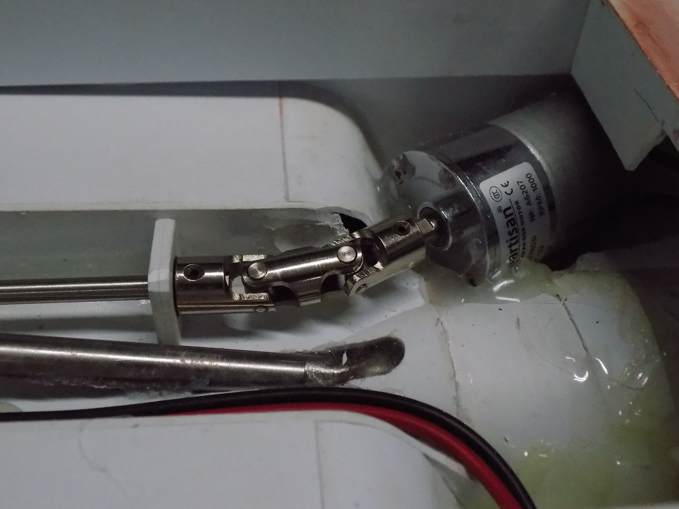

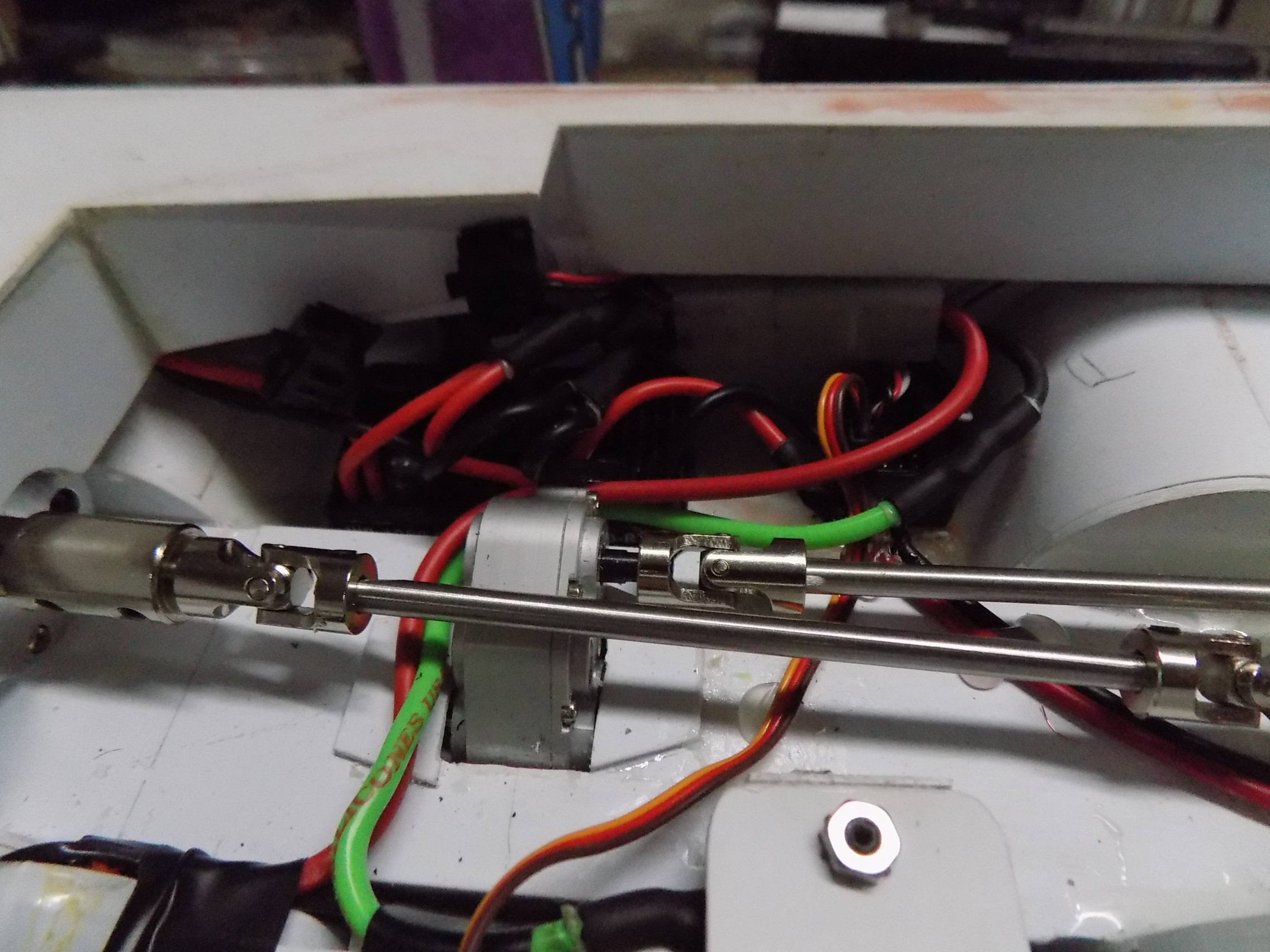

Changed the U-joint that drives the wheels to a CV joint with a pillow block. The shaft runs much smoother now.
And yes, that is hot glue holding my motor in place. I may make a bracket at some point.......

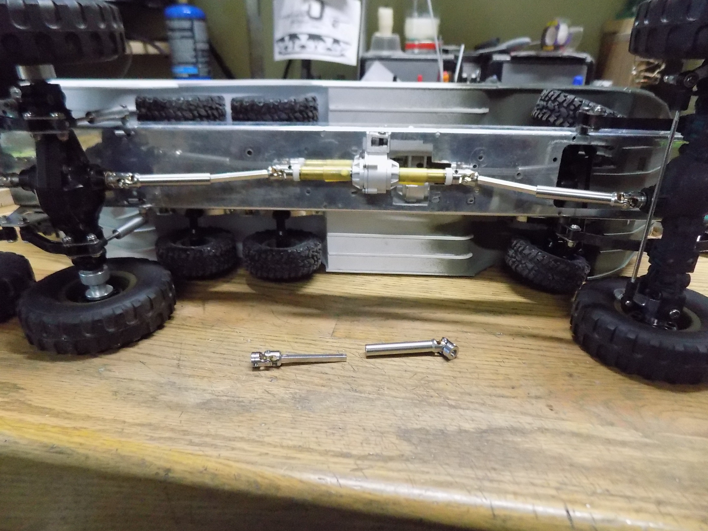

Post by Ecam »

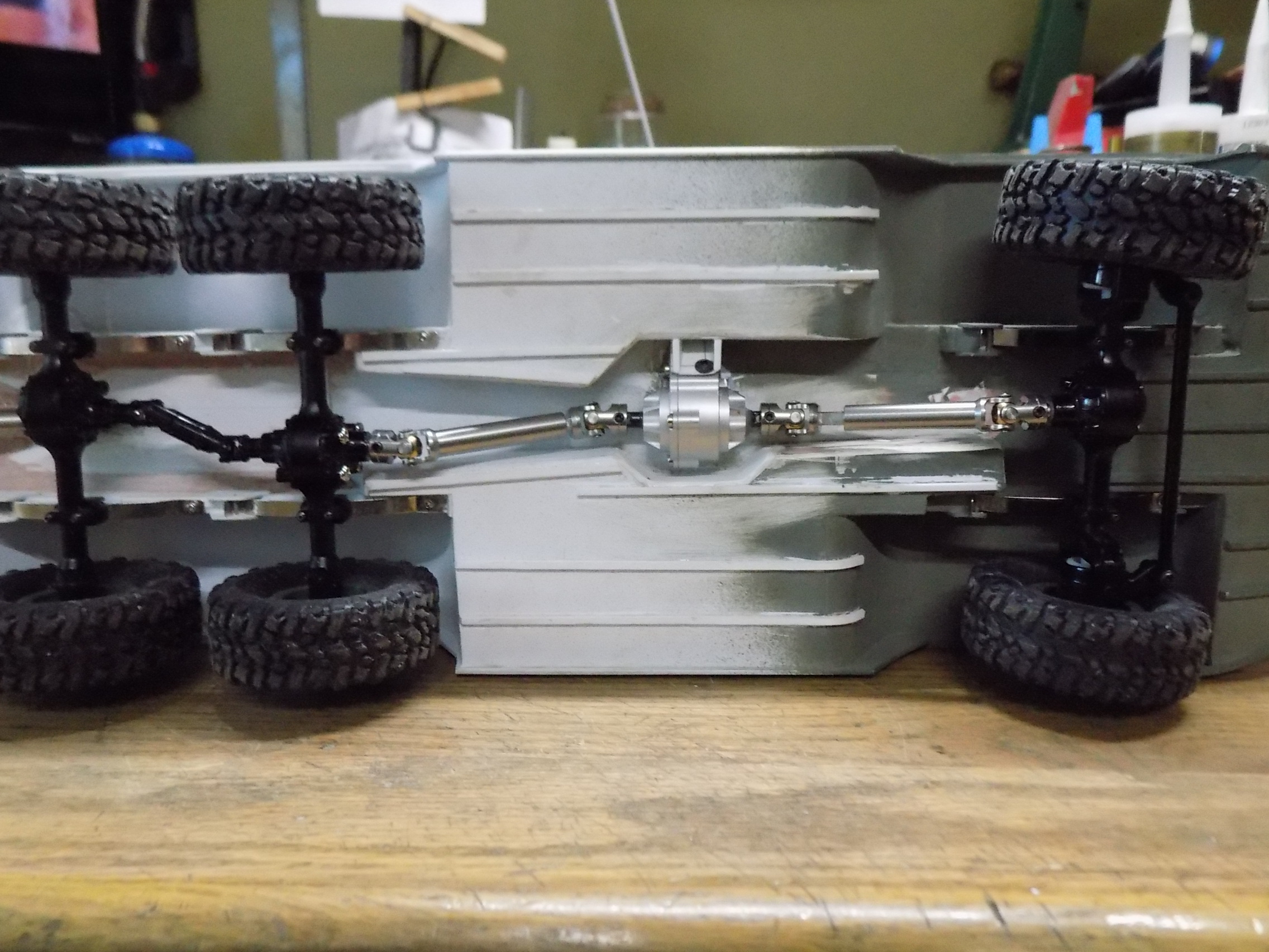

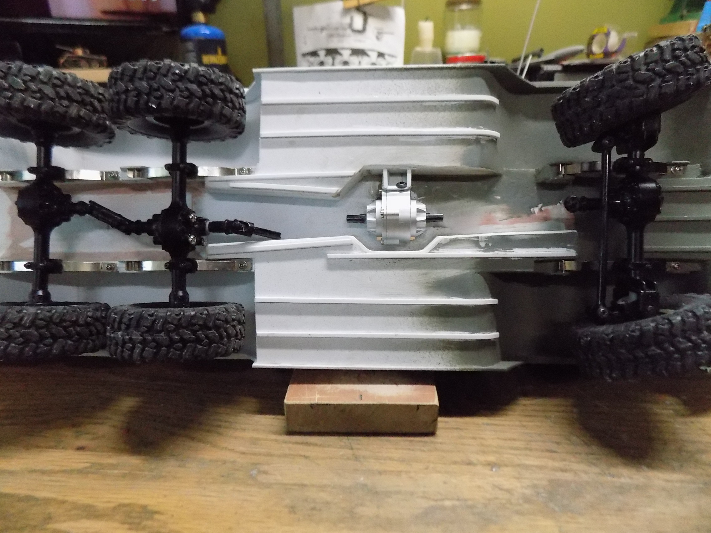

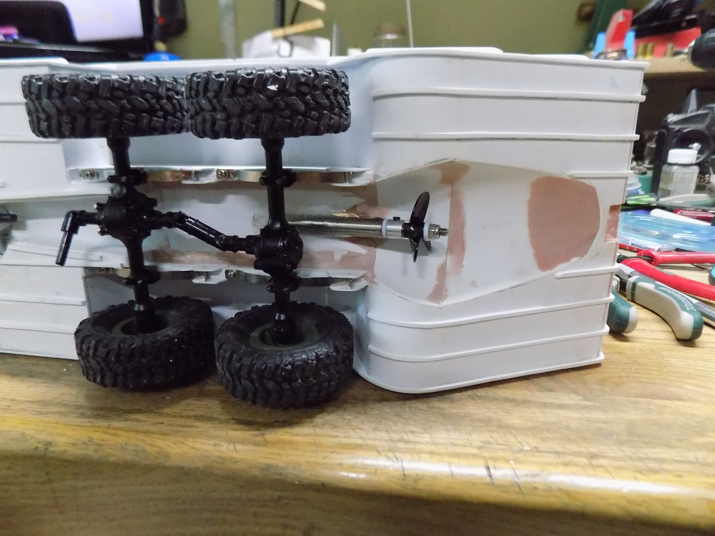

These are driveshafts that are intended for the Tamiya Semis.
I've found some adaptors that change the 3mm to 5mm and was able to fit these oversize driveshafts to the the HL axles.
These were the longest they offered and were cut down to fit the 16th scale duck.
On the flip side, they were a bit too short for the 1/9th (ish) duck. I have some tubing inbound 8mm ID that matches the OD of the drive shafts. I will extend them to fit,

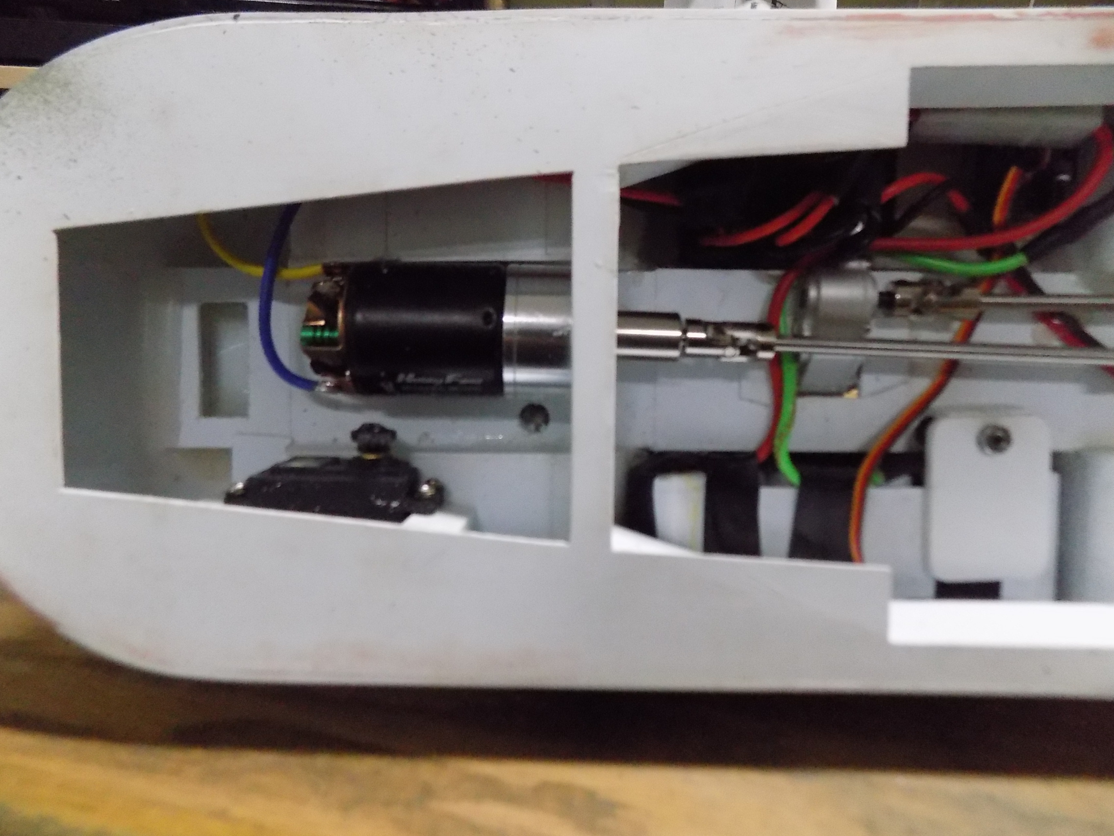

Post by Ecam »

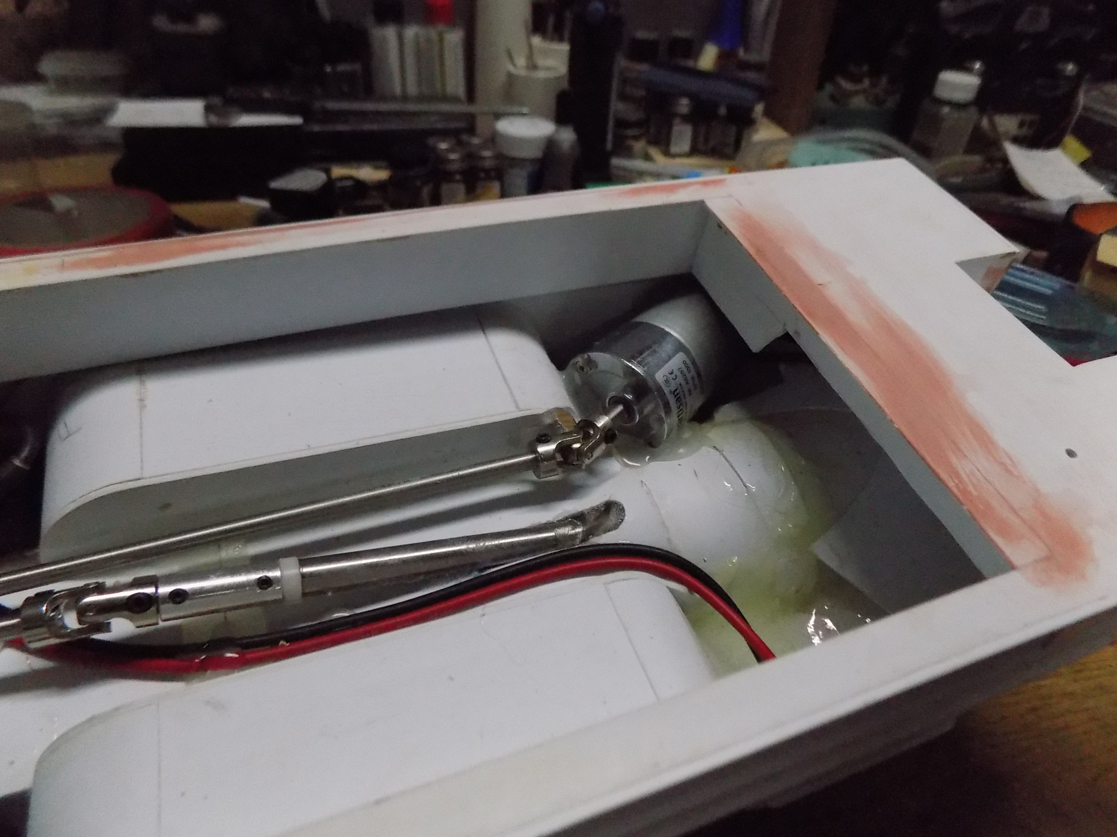

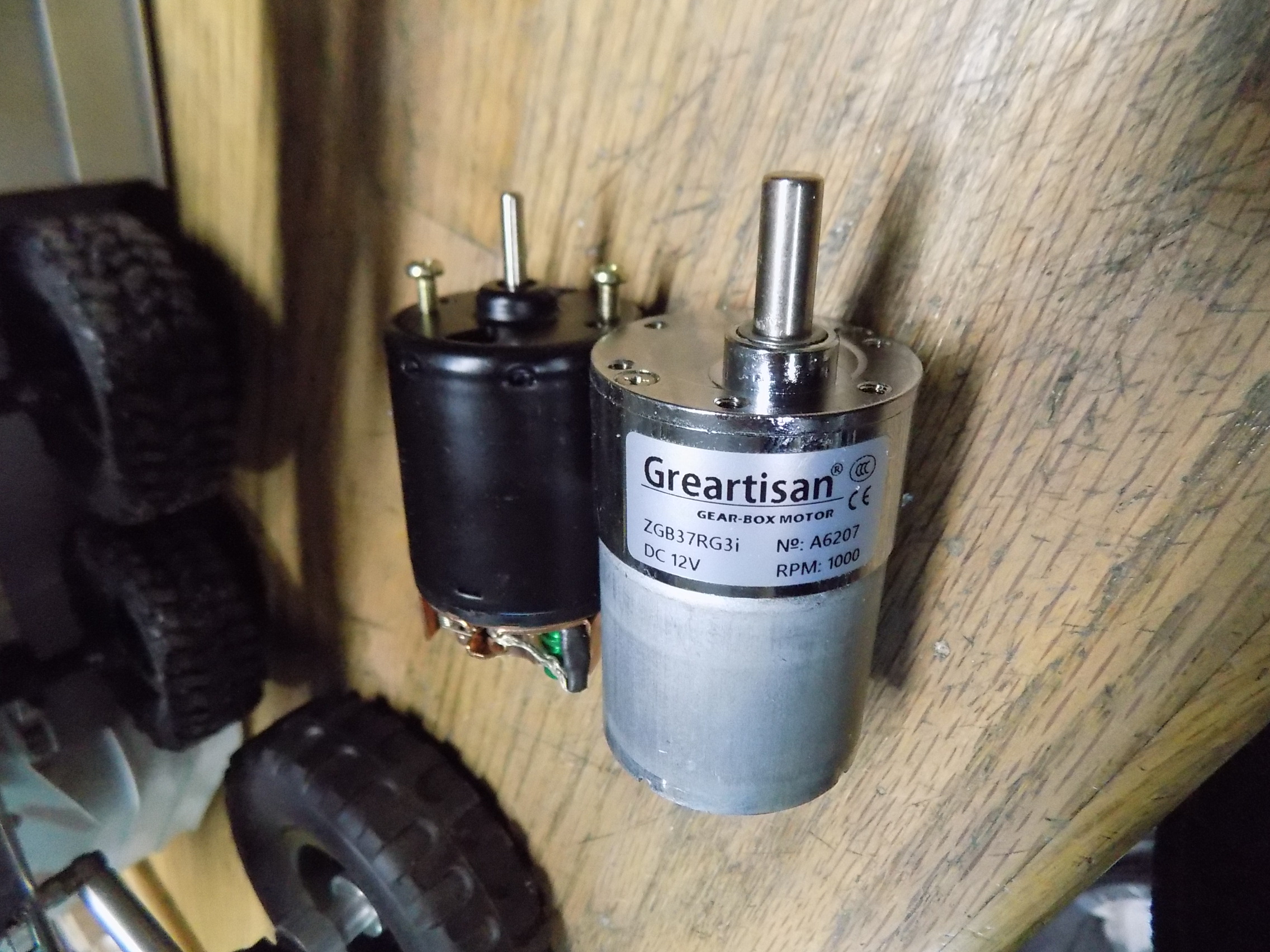

I did a run test with the 380 w/gear reduction and have been really put off by the lack of power. Speed is great as long as the model is not on the ground. It is a 12v motor and maybe a couple extra cells would help things. Space is a concern, pictured is the 380 with gear reduction vs a 540 with out gear reduction (back ground).
