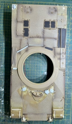

Dr.Professor, thanks! That’s too kind!, just a quick pick of the hull top anti slip, doing the turret today, and I’ll put a vid up of what I used and how, might help someone else.

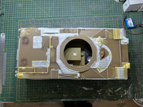

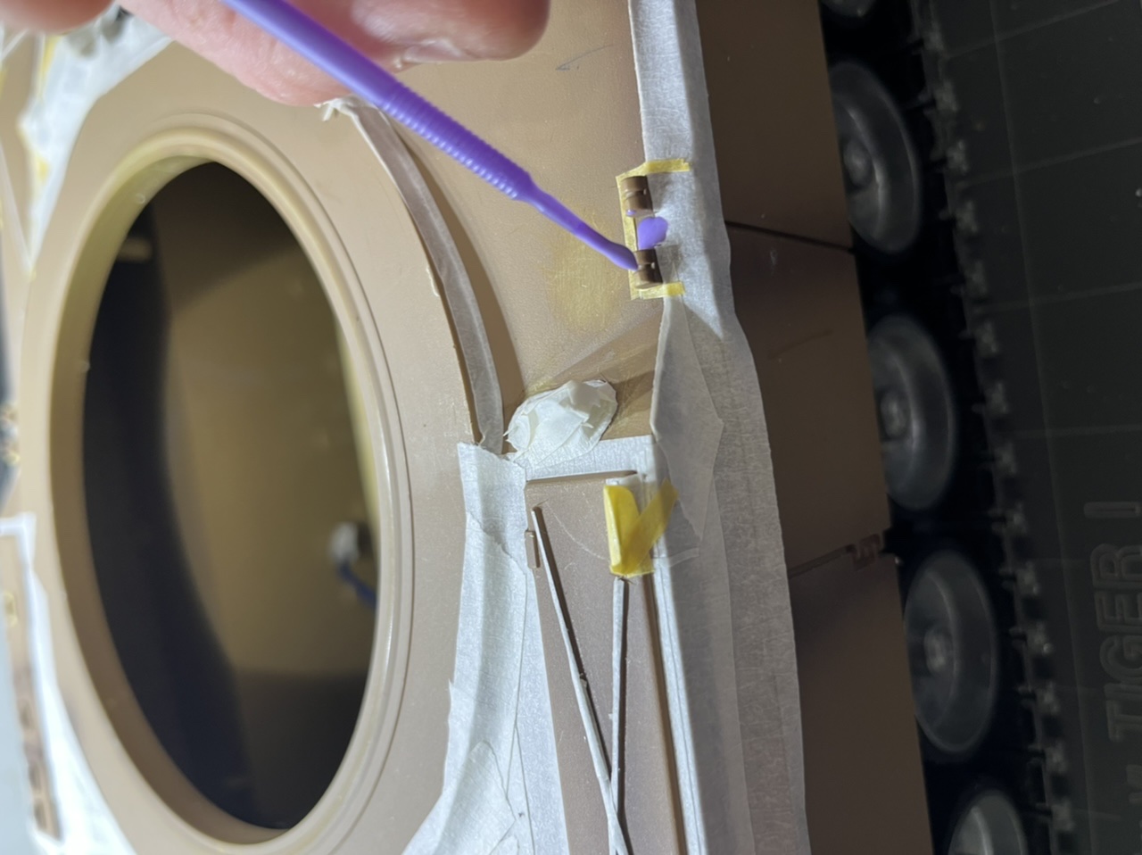

And here’s how I did the anti slip using rustolium, and extremely useful humbrol masking liquid.
Anti slip application for 1/16th modern tanks, (also 1/35) heng long Abrams madness 8 and 3/4
https://youtu.be/hn8j-CJtzzw

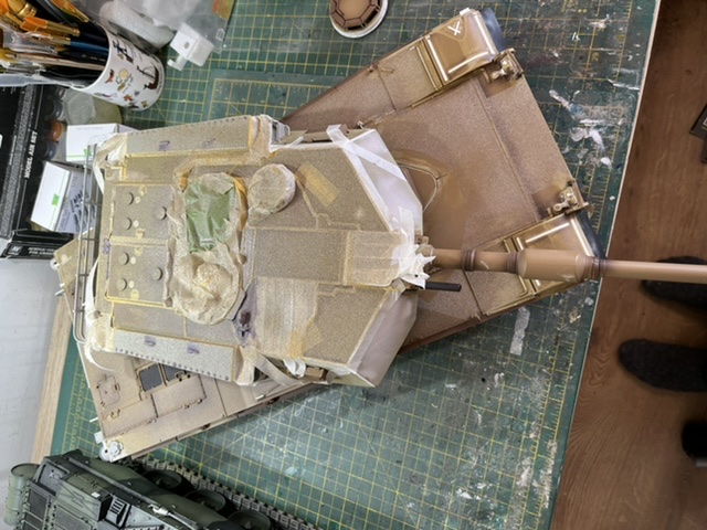

Looks good. I was too lazy to mask it. Mine was done freehand with a brush and some Tamiya Concrete Texture Paint. I like the randomness of the brush. The hull has been primed in the pic, but the turret hasn't so you can see what it looks like painted.

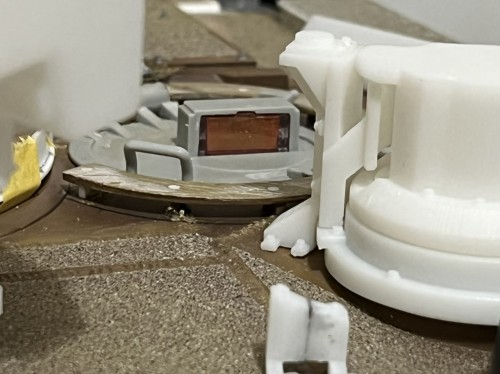

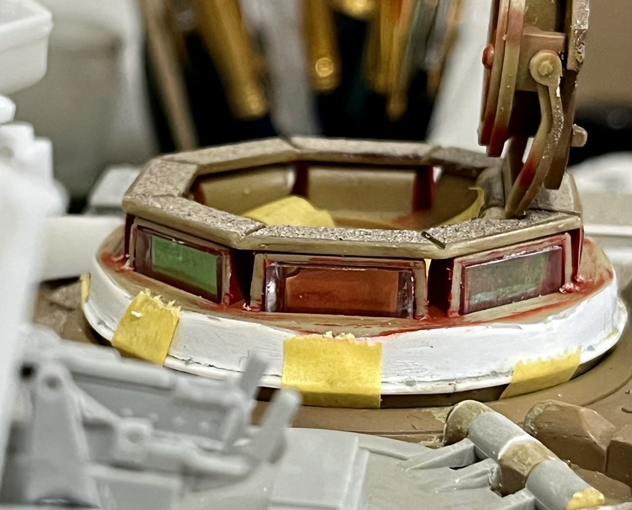

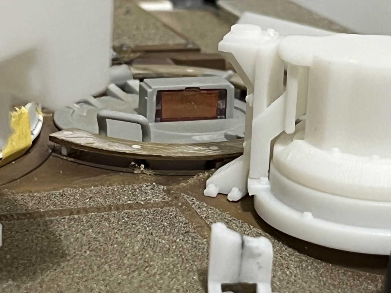

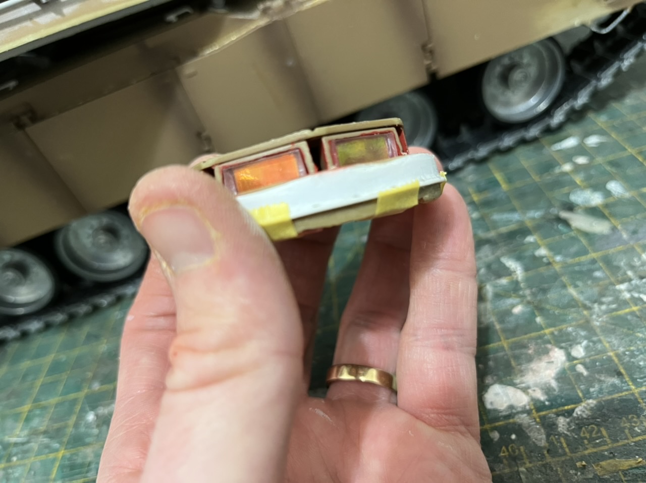

I’ve just done the vision blocks, I’ve transferred the trumpeter ones to the heng long coupla, you just have to hike them a lot! And this is my way of doing the anti laser on the blocks, I think it works okay???
Anti laser coating using nail films for 1/16th Heng long Abrams M1A2, trumpeter vision block fitting
https://youtu.be/sblvfDFa6CI

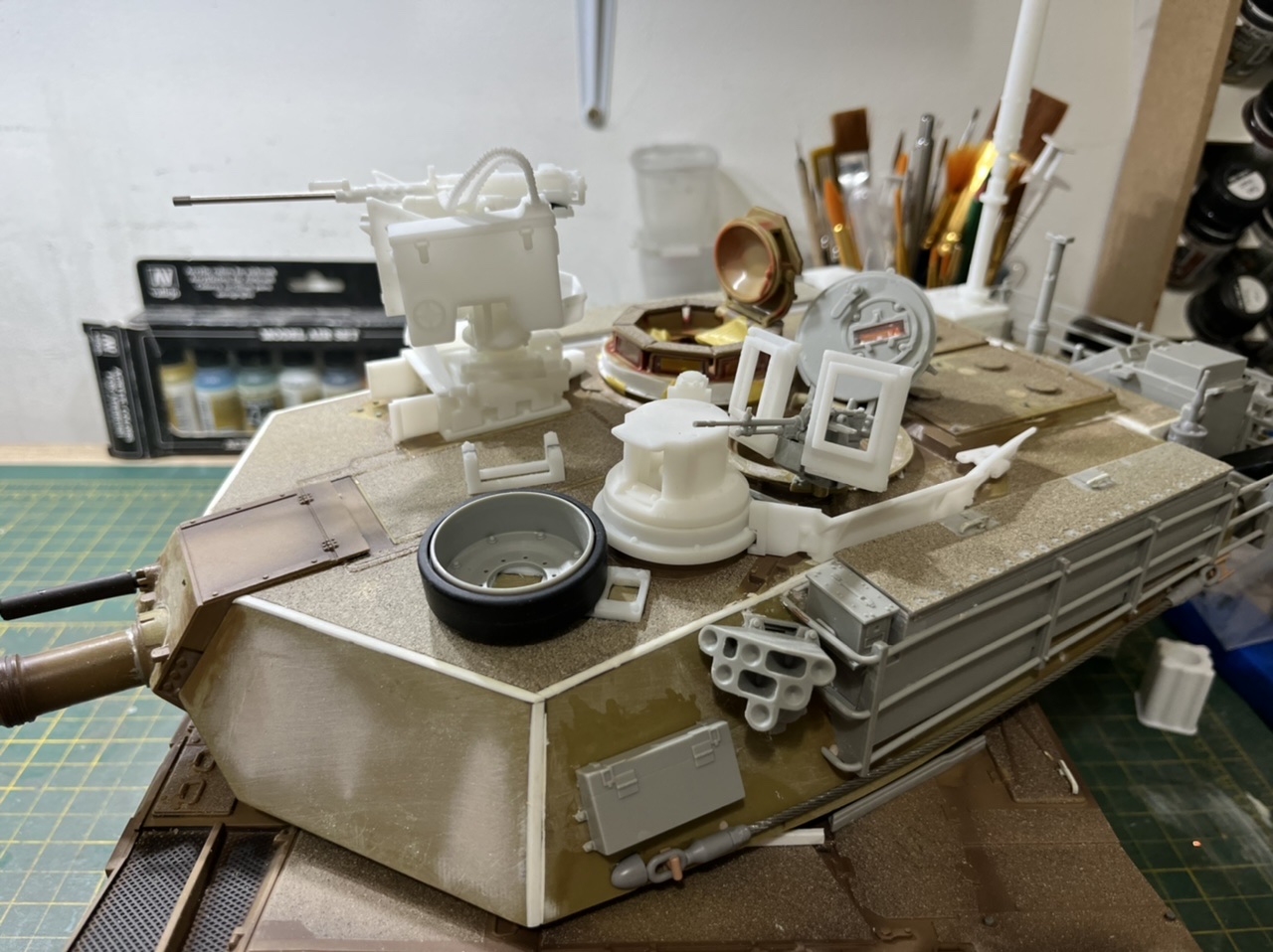

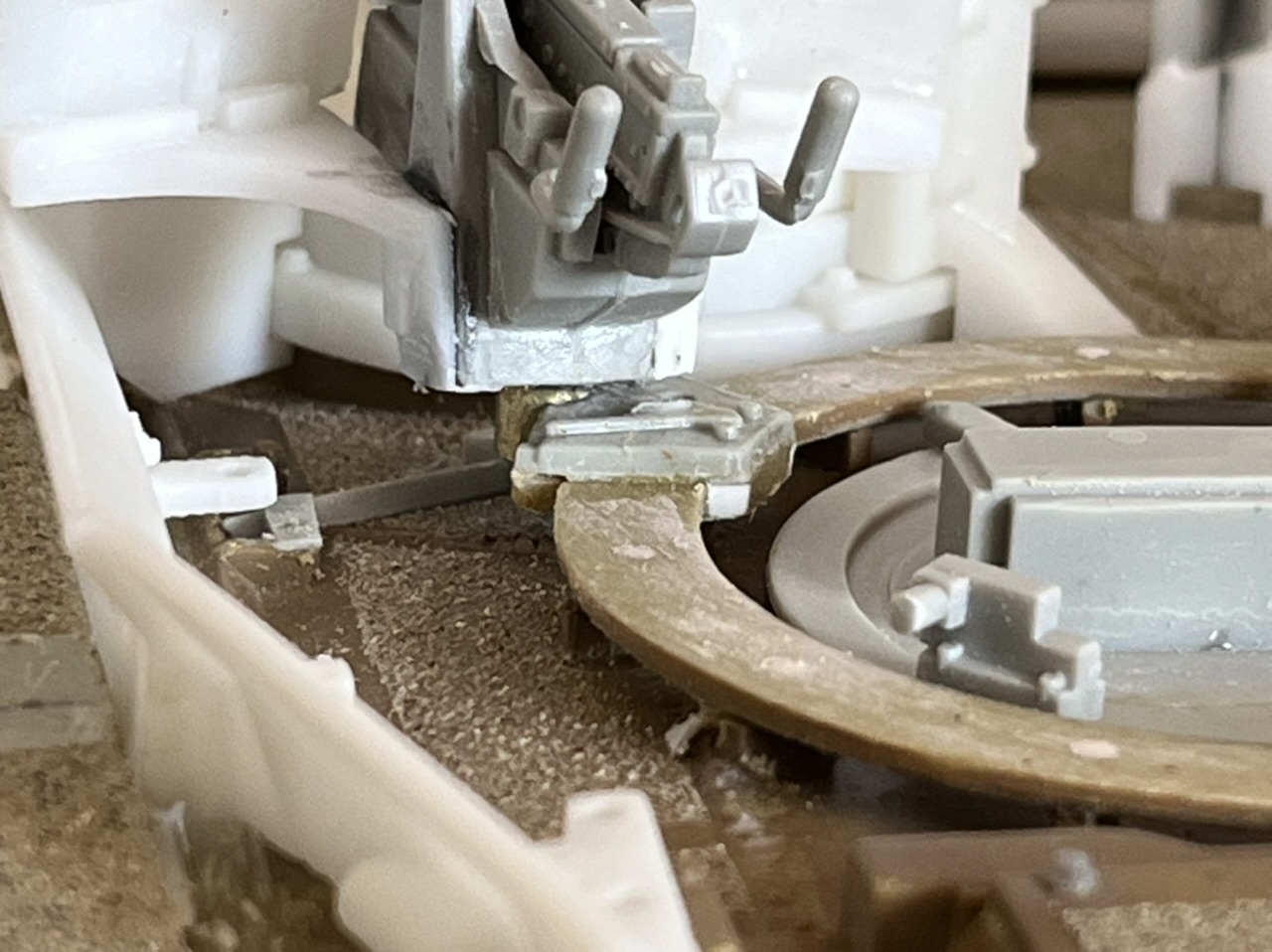

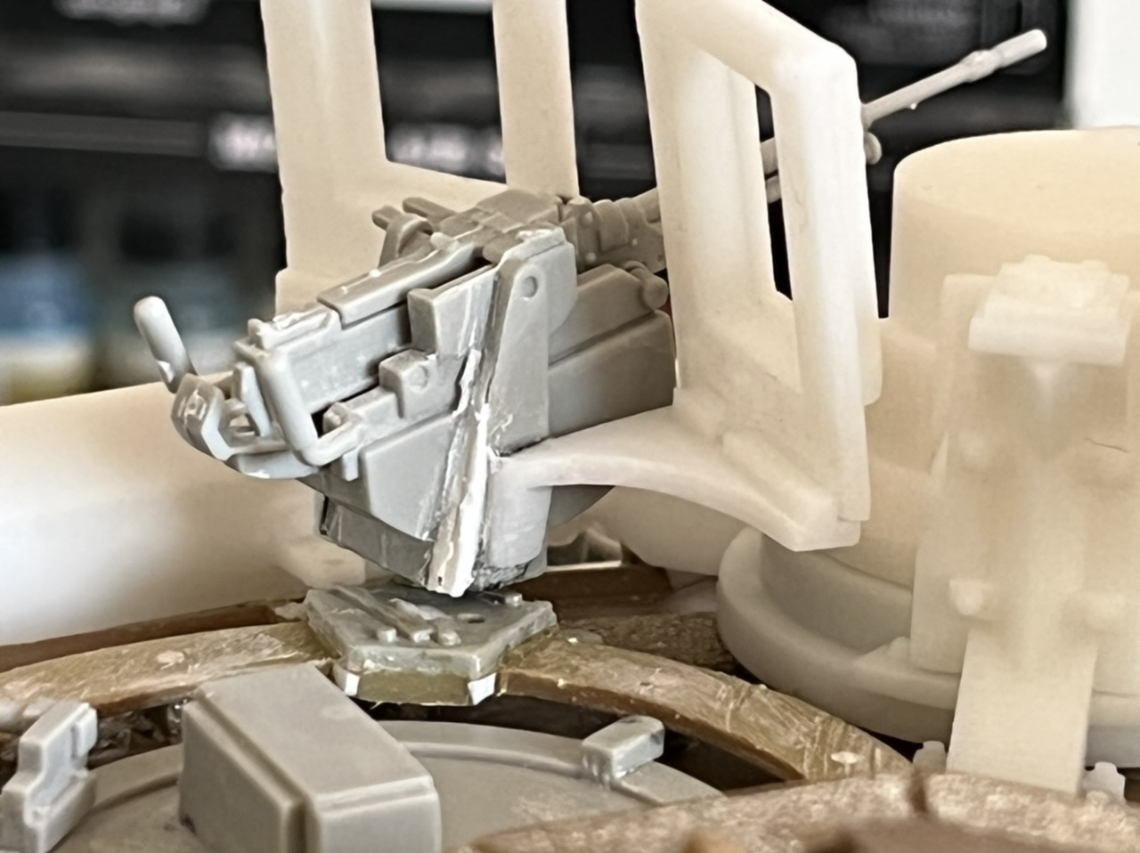

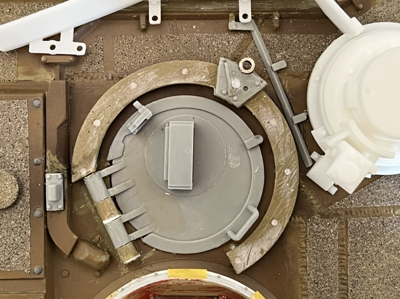

And I mangled the trumpeter loaders machine gun mated to the DKLMRC gun shield l, and a correction to the mounting point on the mg mount horse shoe, if you hatch doesn’t open I think it’s because of this.
Heng long M1A2 Abrams 7.0 fitting the DKLMRC gun shield to the trumpeter gun, and mounting point
https://youtu.be/wq7BXDArkvU

Thank you for the URL on the anti-laser coating! Some years ago, I had used some very thin blue/greenish paper I got somewhere online. (Me..? Remember where..? You gotta be kidding!) I gave that Abrams away to a pal. So if I get back to comtemporary AFVs, I have your idea to try.
