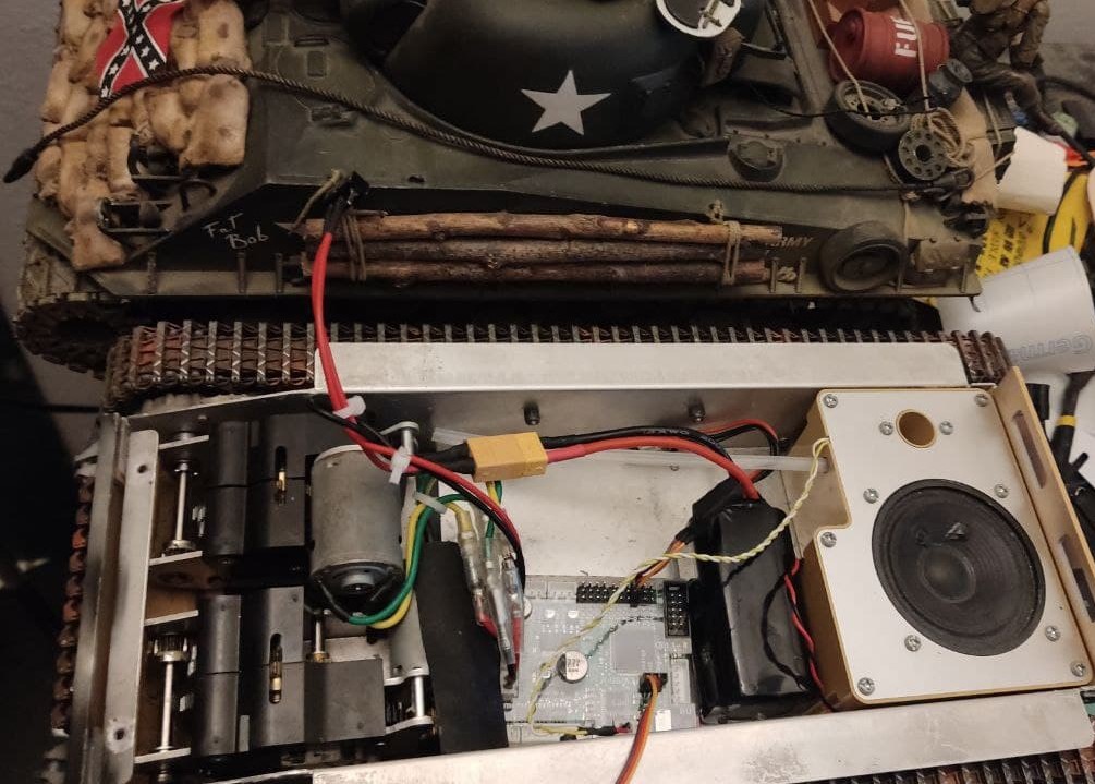

My new Beier arrived today! Weekend ahead for installing it in my Panzer IV!

Jimster wrote:Congratulations!! It’s a good time for Beier. I’m sitting here at work printing off the 110 page English manual right now. :shh:
I applaud your effort reading it. My experience says most people won't read not even two lines, lol.
Anyway, even when such a thick manual might scare people away, I must say most things are really easy to config. Also a big chunk of the manual can be ignored if you are not using Graupner equipment, nautic switches and all of those other gadgets.
My installation is going very fast. I copied the Sherman radio model, changed the name to Panzer IV, asigned another number to the receiver, and the radio part was done.
Wiring, besides lights, is done too. All config in lights and do on is done as well. It seems I only have to make a nice motor sound set for it and refresh my user sounds. I am transfering files to it right now.
This thing is so small that my tank seems empty now. It has a smoke machine too (not pictured) but still, feels empty!
