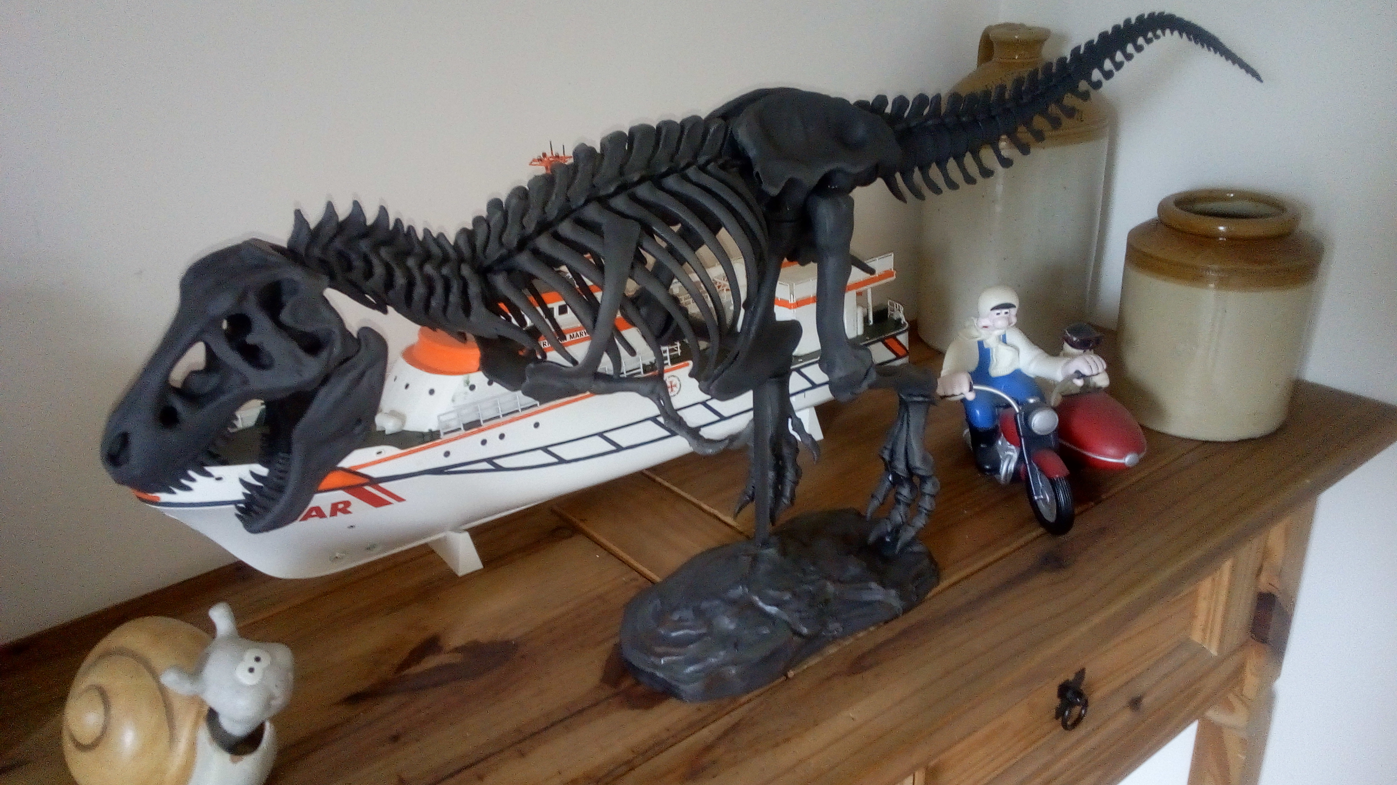

I found that spreading it on card made it dry faster too. I kept it in the pot, and used a little less hardener. It stayed fluid that way.I have some of that Smooth On XTC-3D I did try it once on the wheels of the IS7. Even with me spreading it out in a tray like they recommend, the cure time was really fast. One coat on the wheels of the IS7 definitely wasn't enough and it dried before I could even get it put on all the wheels. That was just on the outer wheels and just on the center area I can't sand. I may need to do it again, but I didn't want to put it on too thick or it would kill all the detail.
The trick was to only use small amounts on a small brush, or use a foam pad. It would tend to pool in recesses, so I just kept brushing it out until only a thin film was left. This isn't a tank, but the prints were incredibly fragile, and quite rough. I couldn't sand them without breaking ribs etc. The resin made them stronger, and covered some pretty rough areas.
