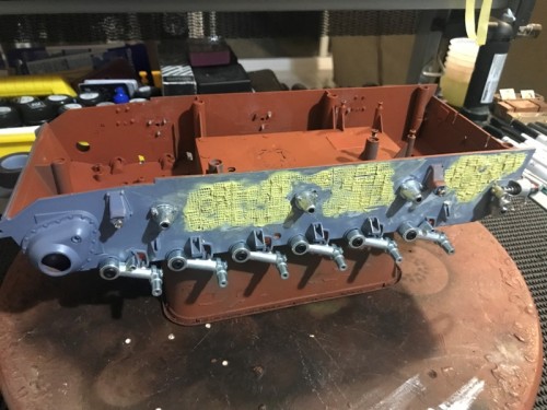

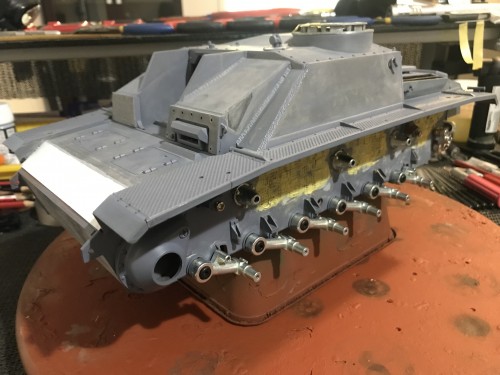

Studying the subject pictures again like an intelligence officer thru stereoscopic glasses(not really but you get the idea) the Zimmerit actually looks to be a mix of traditional Alket waffle pattern AND areas of plain waves as seen on a Tiger :crazy:
There’s not a whole lot visible in the pics I have but what is visible creates an interesting conundrum.
I may take the route of putty and stamp for the waffle and hot screwdriver for the wave but use the licence of broken off compound to reduce the amount of effect I need to apply .
Cheating you say ??
Yip!
But there has to be a sensible balance of effort and booze intake Vs outcome :haha:

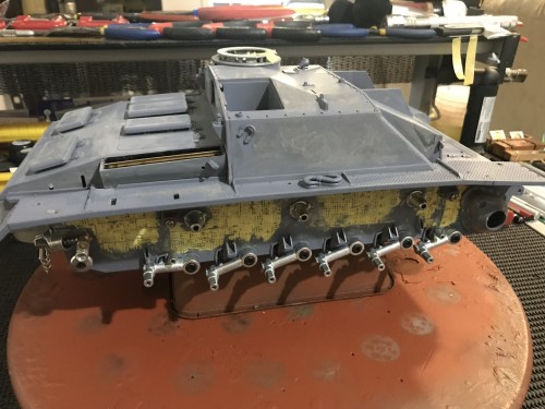

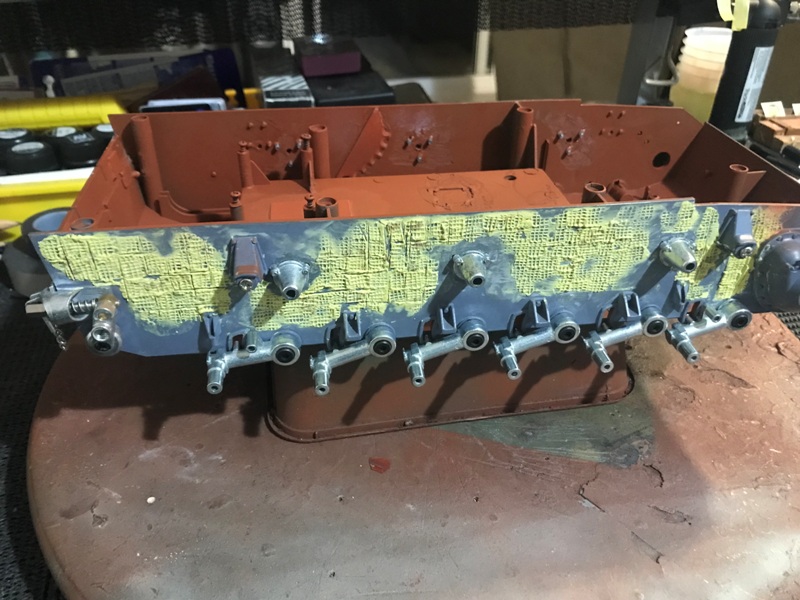

I do have a question for all of you that are experts in the use & application of Miliput...............
I get how it works, its a 2-part chemical product that allows working time and cures a certain way,Ive used similar stuff in an engineering application ,but, why has mine got bits in it when kneaded that looks like a broken biscuit has gone into the shit & wrecked it :-< :-<
I have just done the lower hull thats hidden behind the Schurzen as a test and had much better results from Revell Putty.
Could it be old product? Is there a protective skin that needs to be removed prior to being mixed ?

it goes off after a couple of years, so best to get some fresh stuff. You can mix in the old stuff if you need to bulk up for internal filler or large sculpted parts.
Best way to apply zimmerit is to keep the marking tool wet and clean, and not try to do too much in one sitting as once it starts to harden you will not get the same results (I made that mistake with a Brumbaer, its easy to tell what was done when fresh vs the areas that had set a bit before I got to them!)

"I have just done the lower hull thats hidden behind the Schurzen as a test and had much better results from Revell Putty." I never was fond of Milliput; the stuff I had aged very fast. However, I know many who use it with great results.
How about doing all the Zimmerit with Revell putty? Revell is a venerated model kit name here in the US, but Revell paints (and such) are just now becoming available around here. Some other modelers are urging me to try the paints, saying that Revell paints spray like the now defunct, superb, Floquil paints.

Good advice folks, thanks. I will get new stuff asap.
I will do the rest using an acrylic filler that has worked for me before. Its for gaps in houses, and I know how it performs.
Should be a lot more controlled than the unfamiliar Miliput for me anyway.

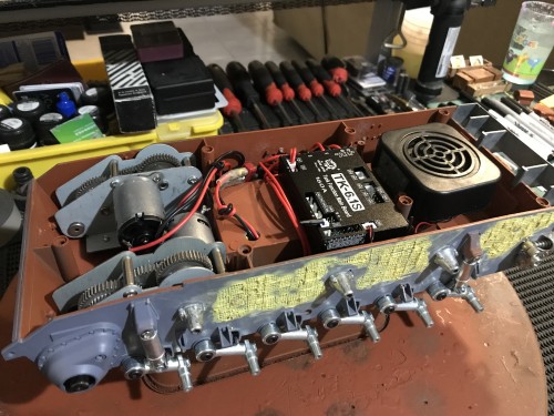

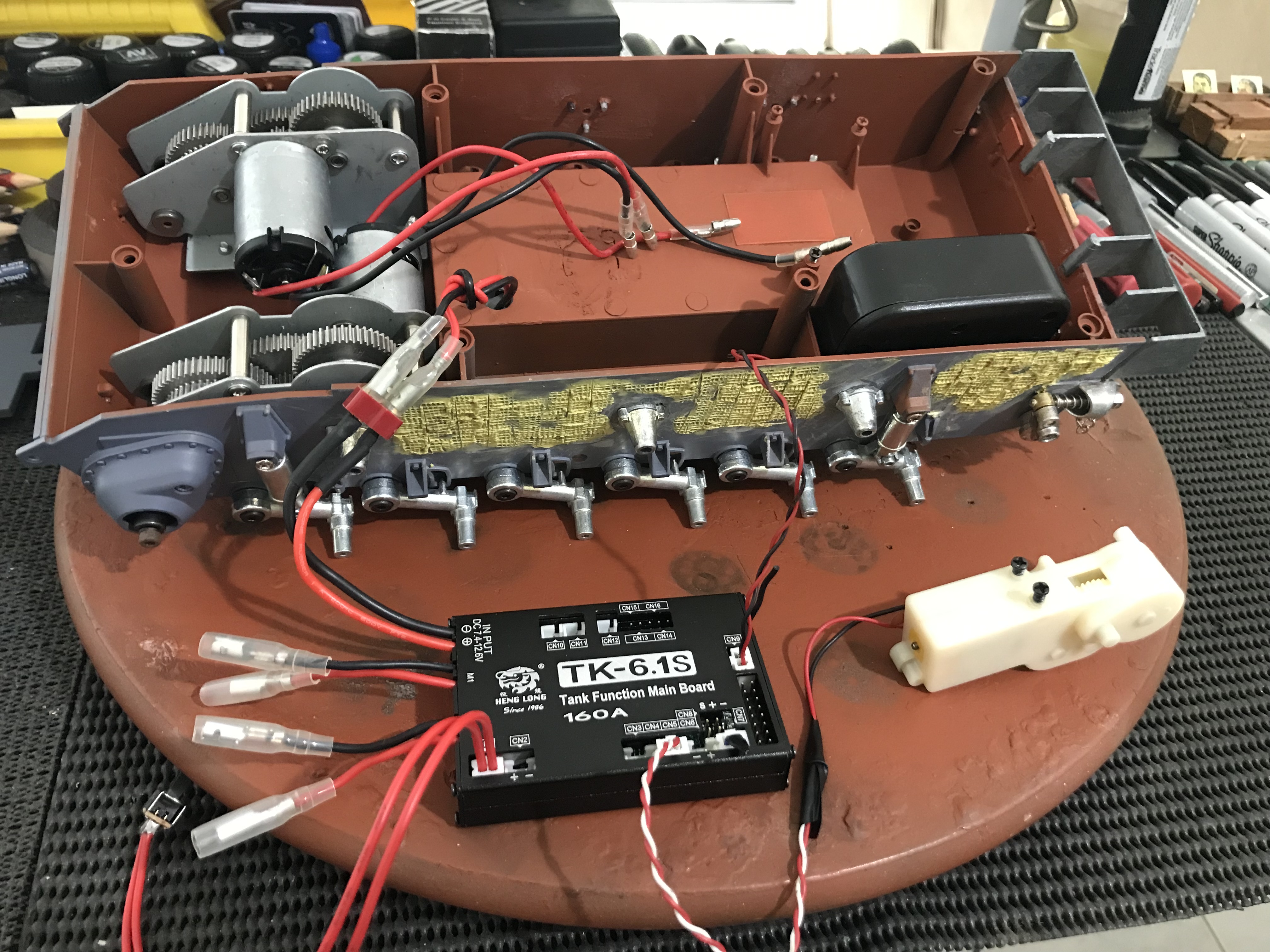

Installed & tested the 6.1s today.
Had to search through instructions as this one was set to the option 2 stick control which threw me a bit !
Thanks to Mr Abramsky for making it very easy to understand & fix.
I also got a Notek fitted & tested, which with my new understanding of the control methods of the 6.1s it can turn on & off easily from the transmitter.
My servos still have not arrived, so Im going to use the OEM H/L elevation unit(which is ok) and just do servo recoil.
Its getting there, but compared to the recent progress, seems very pedestrian :think:
