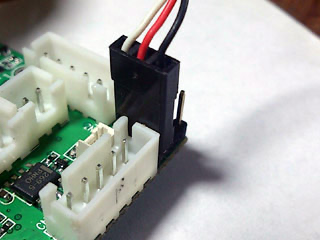

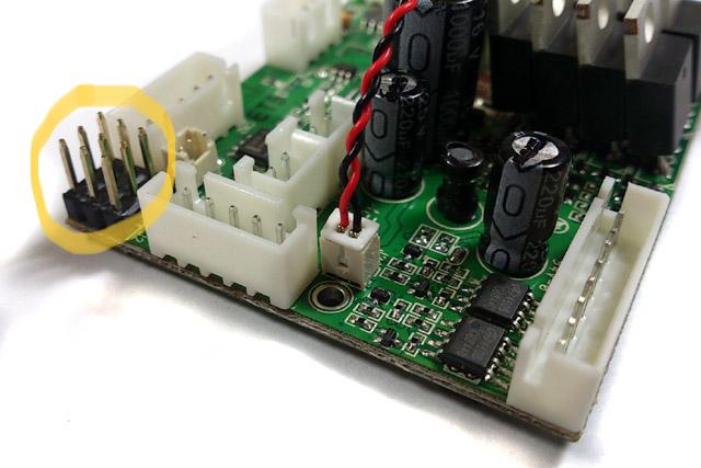

see manual TK 40
the Esc only play on propulsion and turret rotation motors White = signal
Red= plus 5 volts
Black= minus 5 volts
Red= plus 5 volts

I don't understand the phenomenon either, but the real recoil on the J3 was not working with any servos I had except the tower pro. The Clark board must have a very different neutral band width than what the servos can tolerate. And yes the ESC1 is active by default on the other two servo outputs unless you deactivate them. They are not PWM unless it is. The deactivating part is difficult as the sony controller doesn't really let you know you have scrolled to page 2. I should probably test the recoil servo on the elevation now because I only own one Tower pro servo that seems to work. The recoil works good with the Tower pro servo. Any other servo in my inventory and I get either nothing, spinning, or erratic behavior.
