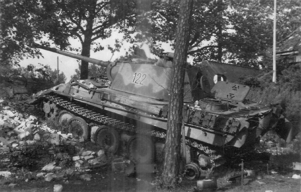

So, a further little update this time as researching 'nr.122' led me to ponder (probably obsessively

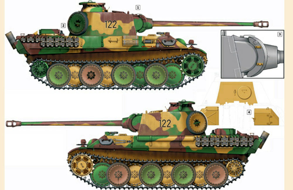

) further on the issue of paint and camouflage. On this occasion there is some clear pictorial evidence, at least regarding the pattern if not so much the colours themselves. As previously suggested, I intended to follow the scheme presented by the 'Star Decals' schematic but have discovered yet another reference to nr.122 specifically in a book on late '45 Berlin Panthers authored by Dennis Oliver. The colours and camouflage pattern in particular are clearly drawn from and consistent with the available pictures, which is very useful;
Comparing with the previous existing images I posted earlier and the only other I have found (beneath) the camo pattern similarity is striking;
However, a couple of things I am not sure about is the left side sprocket colour, which I think looks darker and is probably rotbrun/red oxide or olivegrun (like the right side). Also, i tend to agree with the 'Star' depiction of either rotbrun or (more likely) factory painted red oxide on the lower hull (behind the wheels). I realise this all still rather speculative as, in the end, colours in particular are really quite indeterminate as regards to these old images. Anyway, I intend to follow Oliver's schematic for the most part but probably incorporating what I think is more correct regarding the lower hull and sprockets.
A further issue I raised earlier is also highlighted by Oliver's book and camo scheme, which is the idler wheel. As mentioned previously, as a Daimler-Benz factory product (if this is correct) the idler wheel would have been of the older, non-self-cleaning, type (which have a kind of single spoke). As far as I understand only the MAN and MHN factories upgraded to the new improved idler. Oliver's picture above shows the idler wheel of this later, self-cleaning, type that in appearance has a sort of double spoke.
Looking closer at the earlier picture (as below) I am now fairly convinced that nr.122 was no different to other Daimler-Benz Panthers and is sporting the older style idler wheel. This is fine as I have in my possession already the older type A Taigen idler to swap over;

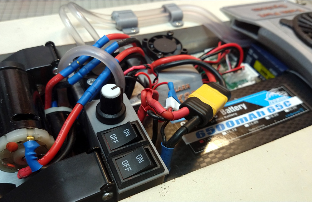

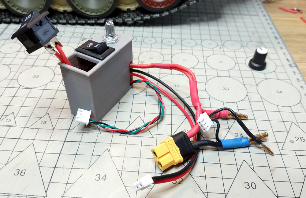

Returning to the bat cave, and slowly emerging Panther build itself, the next step was to create a switch box with a small wiring loom for both the main and smoker switches and a place to locate the volume control (although not strictly necessary as the Clark TK80 can be easily set to control audio volume with the transmitter it is useful to have a physical master control on the machine so as to be able set maximum demand on the on board audio amp);

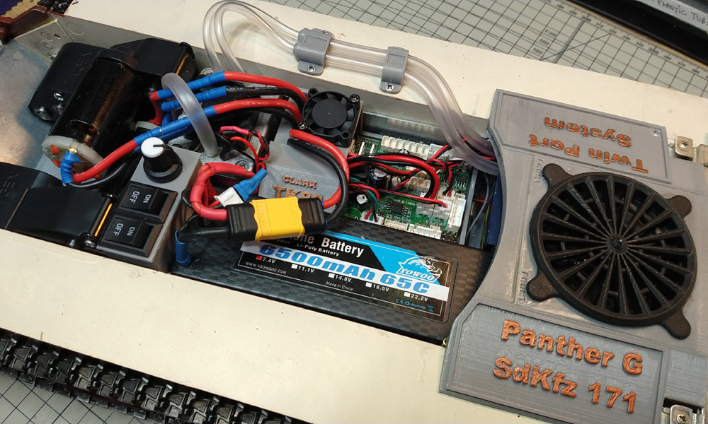

And here it is installed along with the battery, etc.

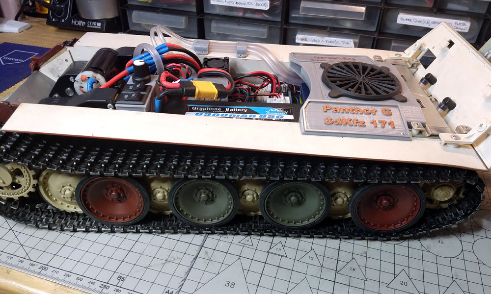

All in it is a pretty tight fit but I'm quite pleased with it. What I like is that it almost a modular installation and can be very easily removed for tweaking the suspension and running gear generally. Having also set up the TK80 and run it around a bit it seems, so far at least, rock solid;
Apart from changing the idler wheels and the colour of the sprockets I'm about finished with the lower hull, for now at least. As I say, just a little update this time around
