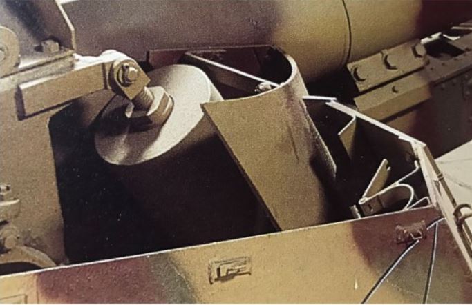

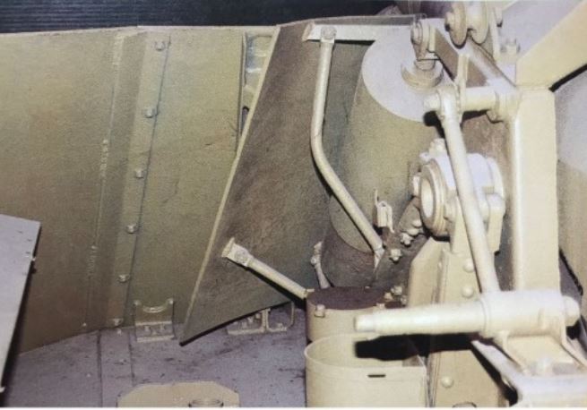

Yeah, quite a few challenges;
- getting the thin shield angles and curves right, keep them that way, and do it twice for both sides
- if you want rotation, its very difficult to find the angle that make the shield rotate while ensuring the shield is flush with the side armor as it rotates, with consistent spacing.
- those thin and curved attachment brackets, some deep inside
- how to anchor the gun and keep the shield together with the force of the heavy recoil
Hummel gun shield
Hummel gun shield
Hummel gun shield
Hummel gun shield
Good luck

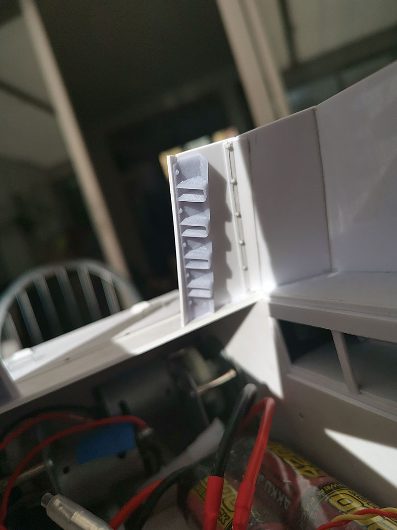

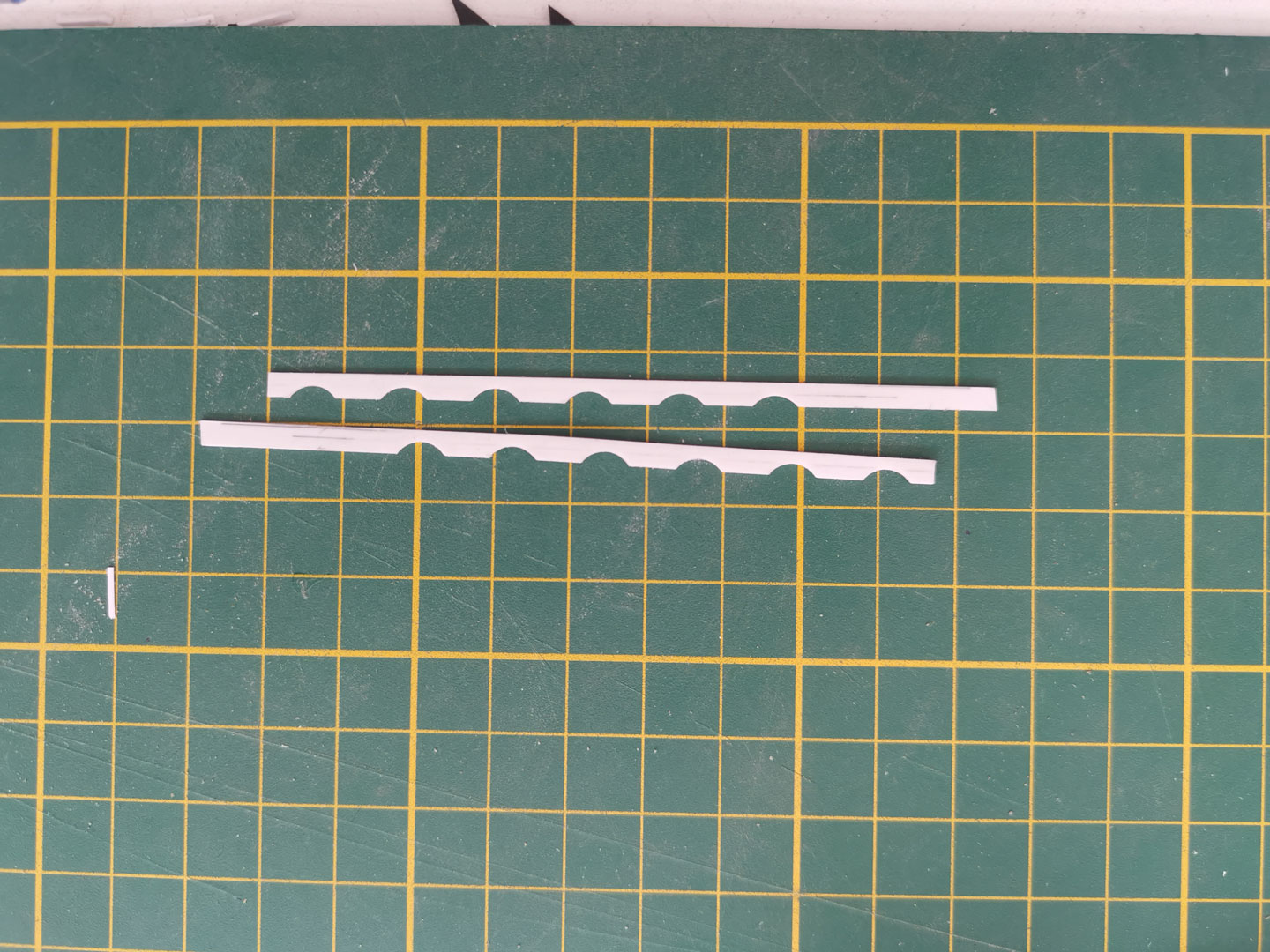

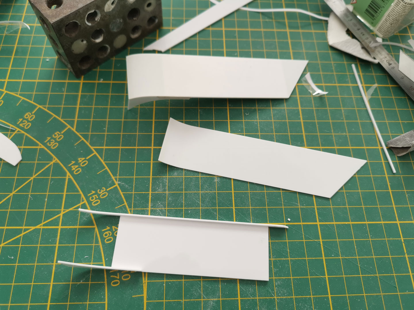

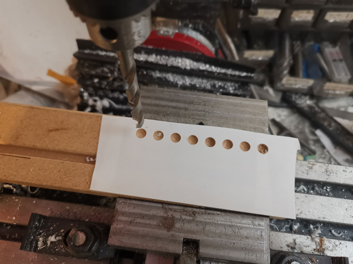

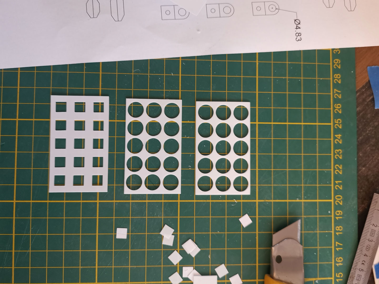

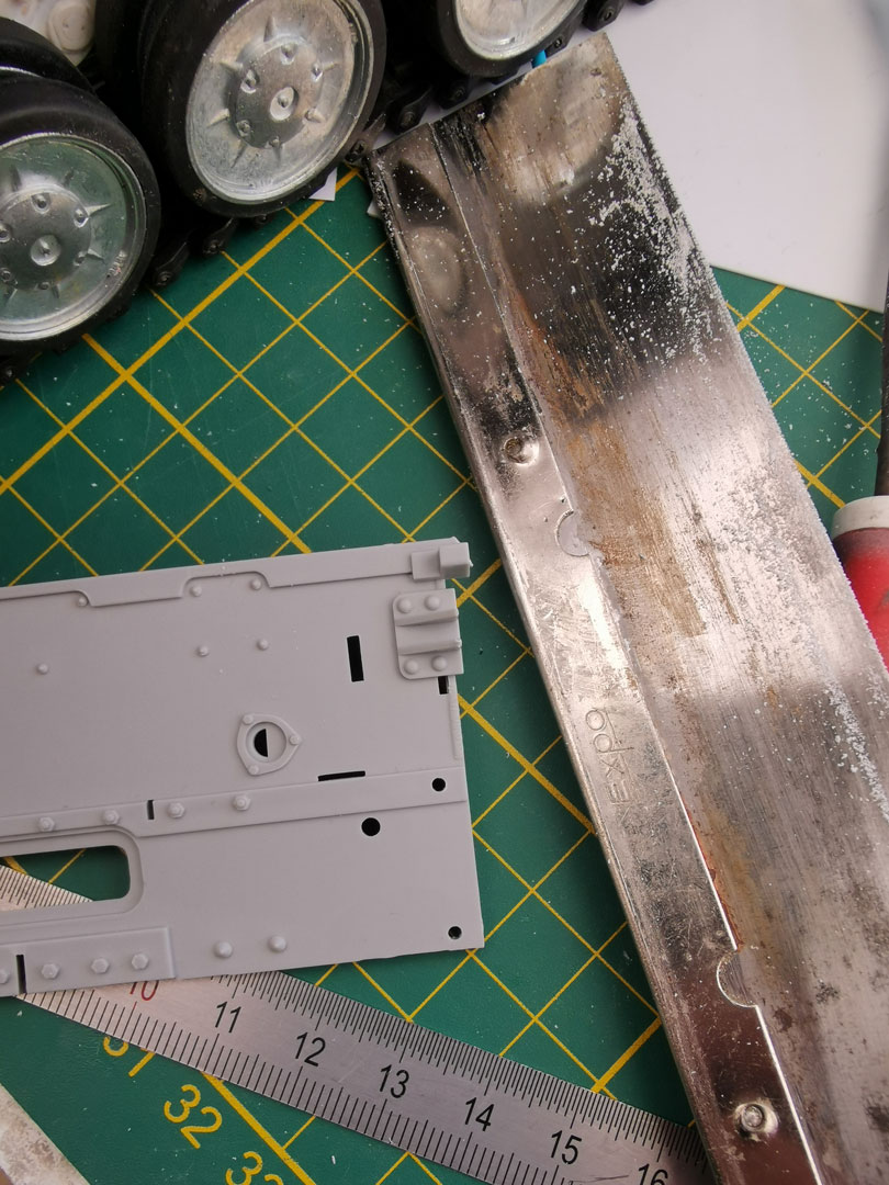

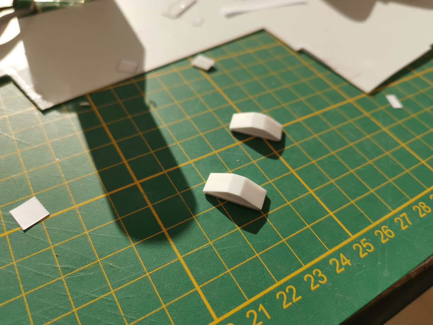

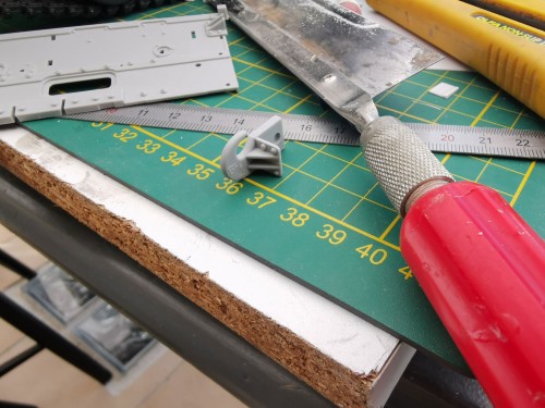

On the Hummel and on several other german tanks like the Panzer IV, they used semi perforated right angle brackets all over the tank. Of course none of them have the same hole diameter and spacing, it would be too easy. :lolno:
I decided to make them in styrene using the mill to drill the holes and then finishing with the hobby knife. And made the several styles and sizes used on the hummel.

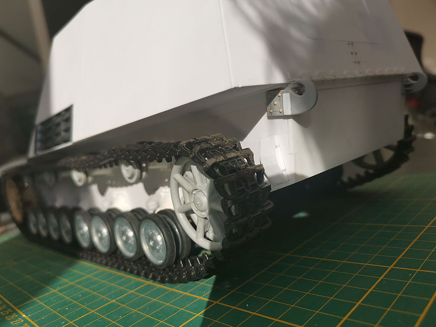

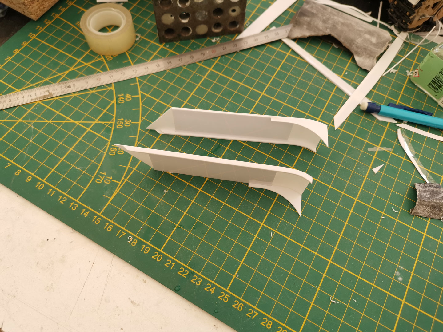

I made the fender in styrene. I used Aber dotted pattern (PP03 if I'm correct) to put on them, unfortunatly I had the bad idea to use strong double sided tape but it was not that strong haha... after some days in my hot veranda they started to came off partially, I decided to removed them and I have been very careful doing that because the bond was still strong in the center but the PE is so thin that it has been damaged (creating some kind of "waves" on the plate). I tried to straighten it as good as I could and I glued it back with CA.

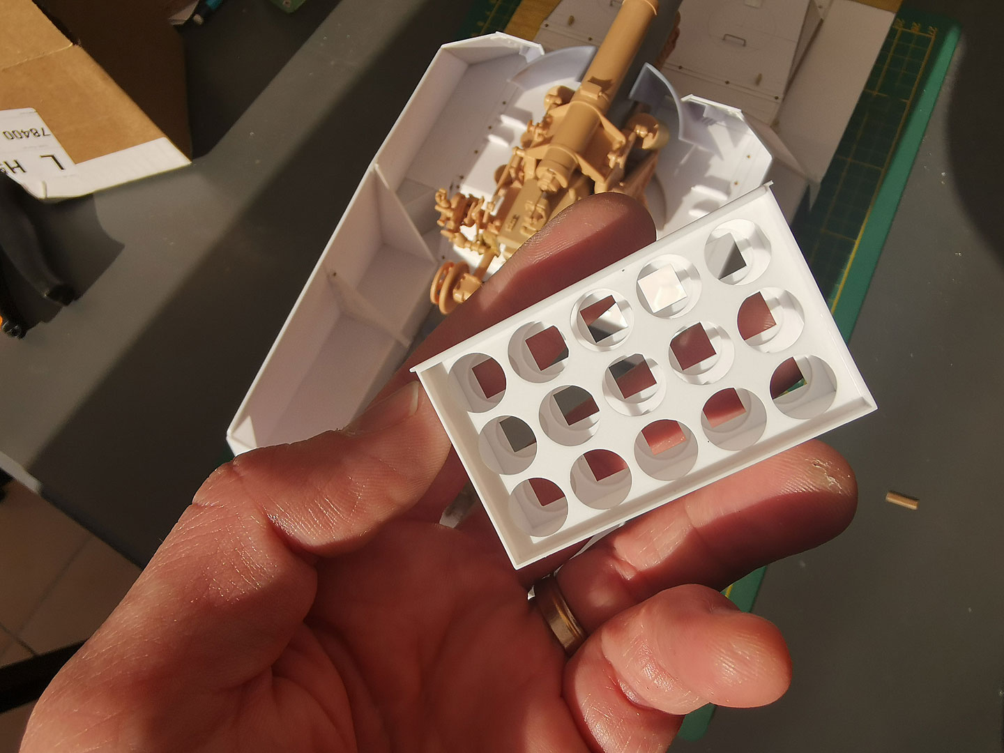

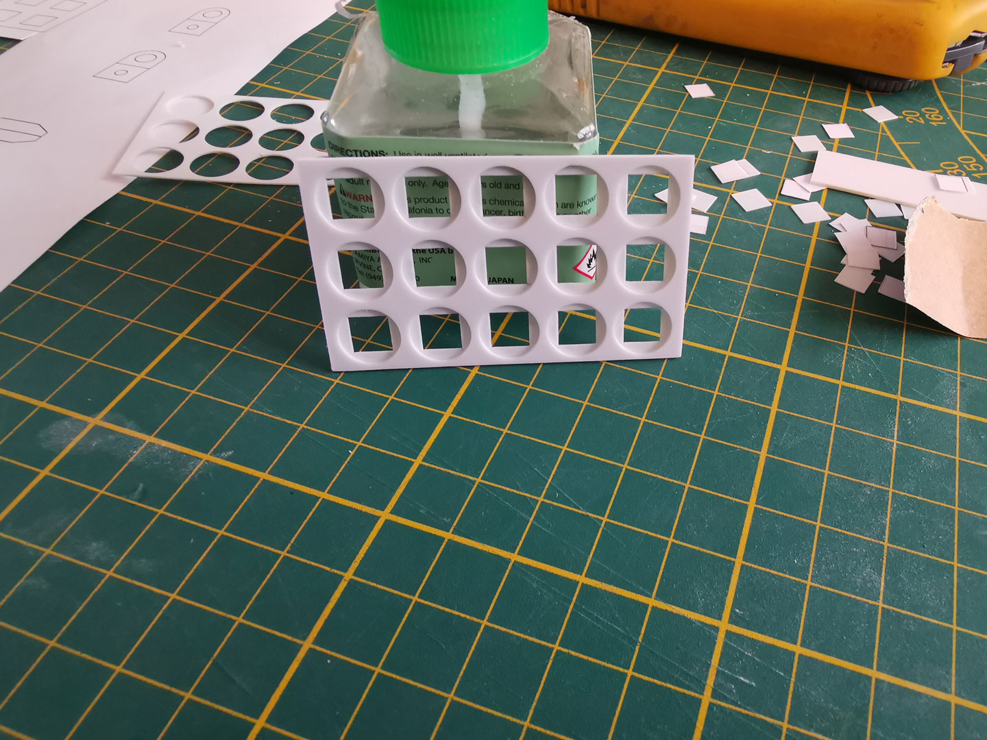

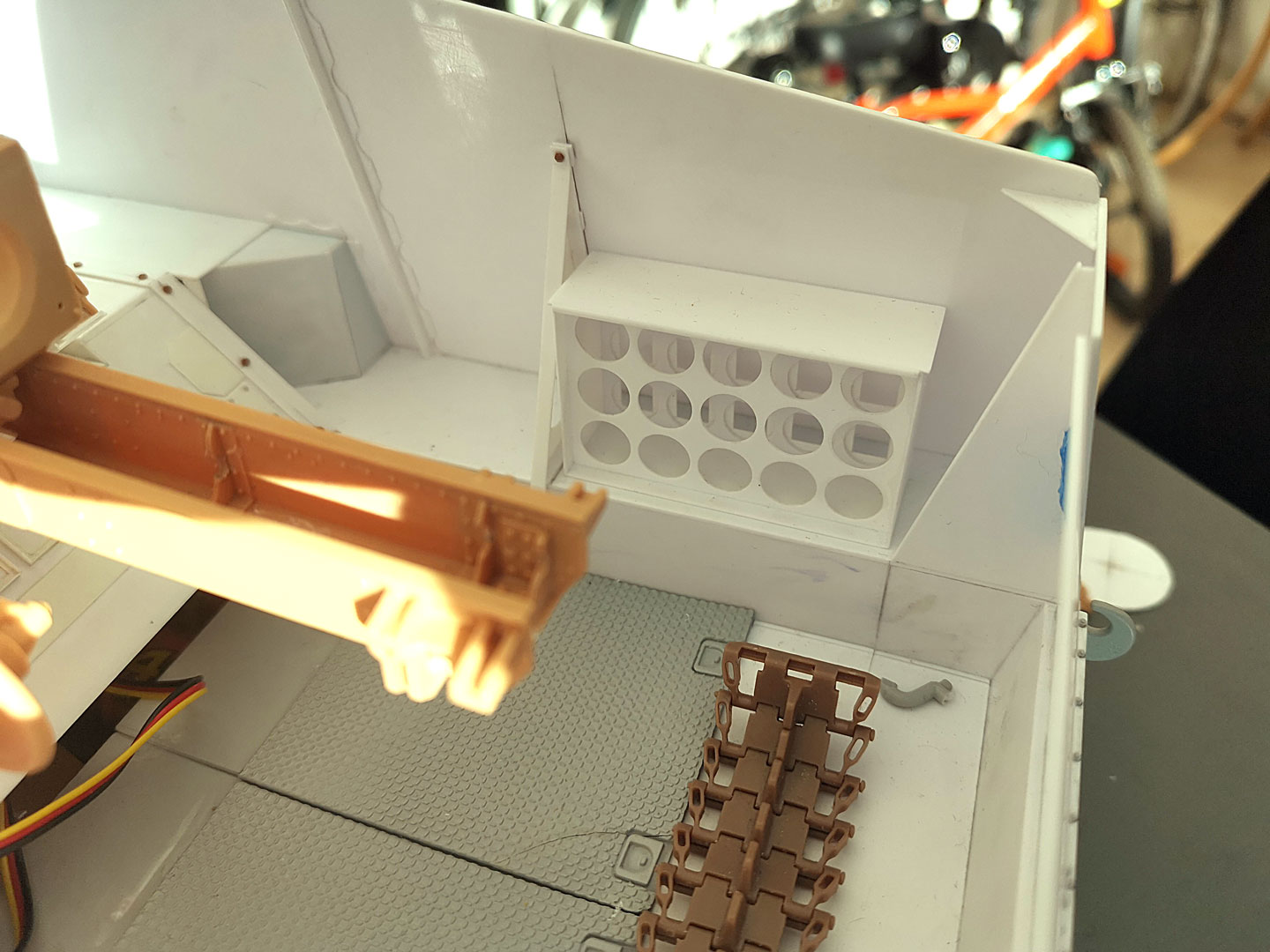

I then worked on the ammo box. Once again I used the mill to get evenly spaced and aligned holes, the square ones have been cut by hand.
This the first box I made, the proportion was a bit off (slightly too large and not deep enough). I built a second one.
Here's the final box :

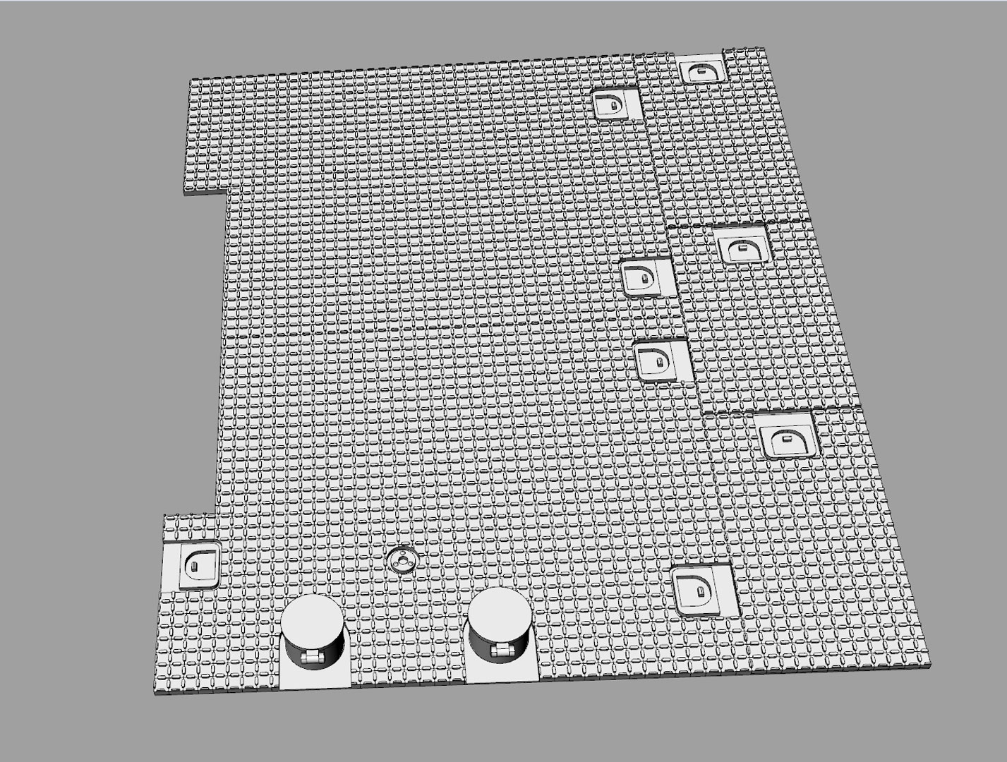

You can notice in that last pic the textured floor. I found a nice facebook page of guys restoring a Nashorn with plenty of pics (too bad I did not know it earlier !). There were some great pics of the original floor plates showing the exact pattern (same as the Hummel of Saumur and probably that every Hummel/Nashorn), I have been able to find the right size of those squares and the I cound them to get the right numbers :/ . Well I modeled that textured floor in my 3D software, it was a very heavy file !
The print was just a proto to see if it worked, it worked well actually. But I did not properly cured it and it warped over time (and I broke one piece when trying to get it back to shape). I'm going to print new floor plates soon.

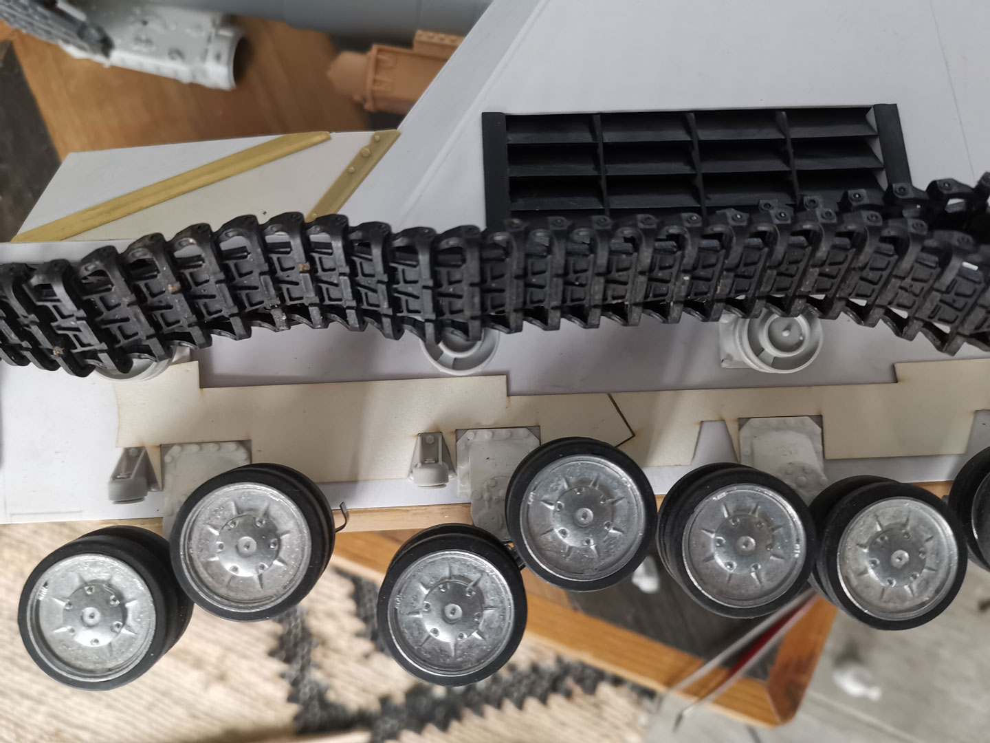

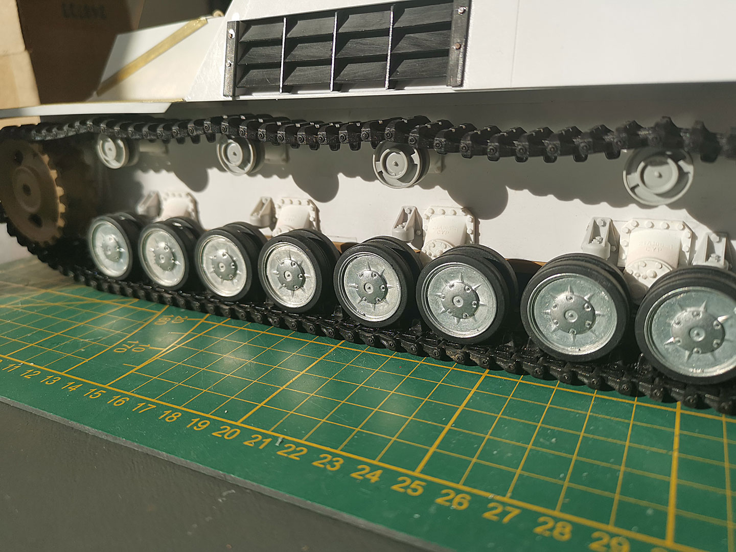

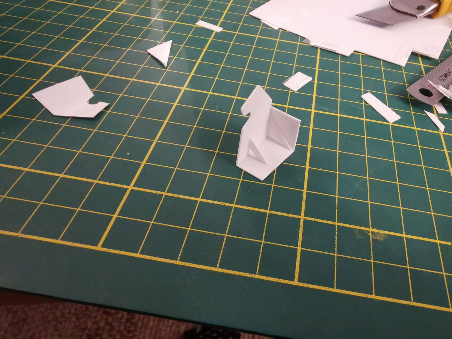

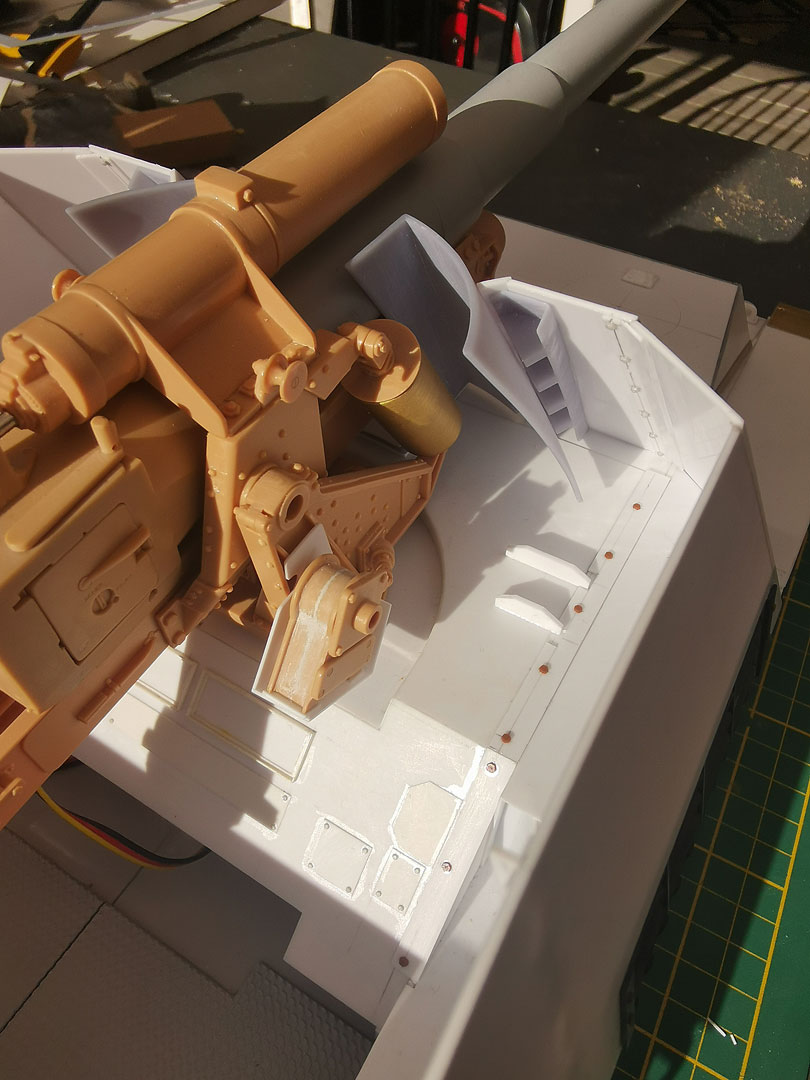

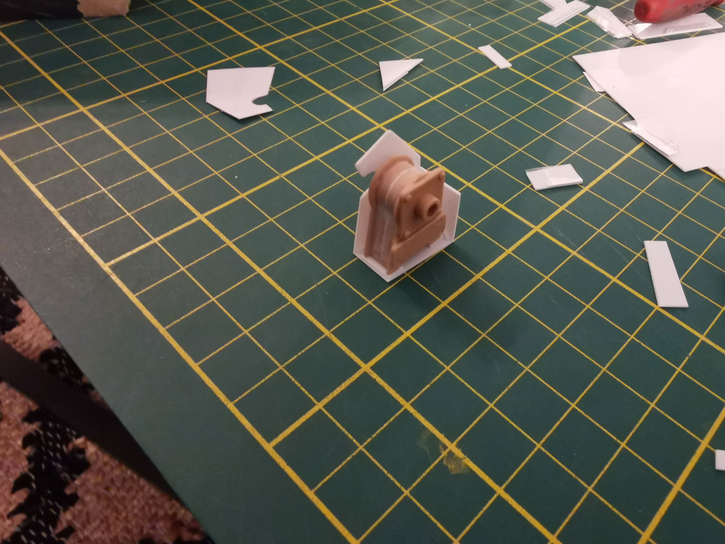

I made the bracket for the elevation mechanism of the gun. In its tracted version, the gun elevation mechanism is on the chassis.
Louis's thread has been a great inspiration, why reinvente the wheel, I'm using here's what he used, the BK-1602 dampers made by BitsKrieg. Very nice parts and the lasercut jig to glue them is great (and it allowed me to checked I glued the suspension with the right spacing :haha: ).

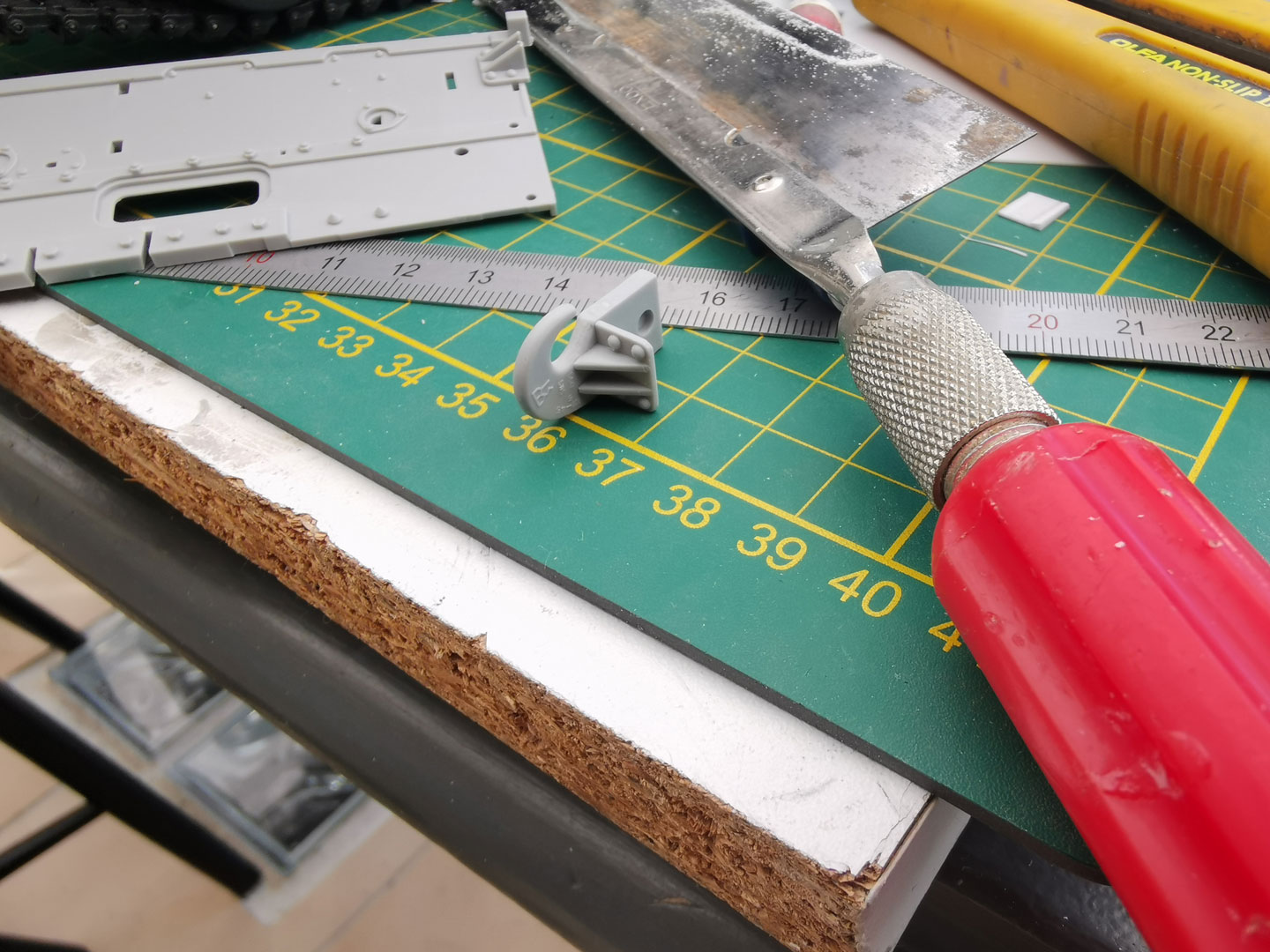

I made the track pin pusher or whatever it's called in styrene. There was an early and late version, shape and position were different. Of course I am replicating the late version.

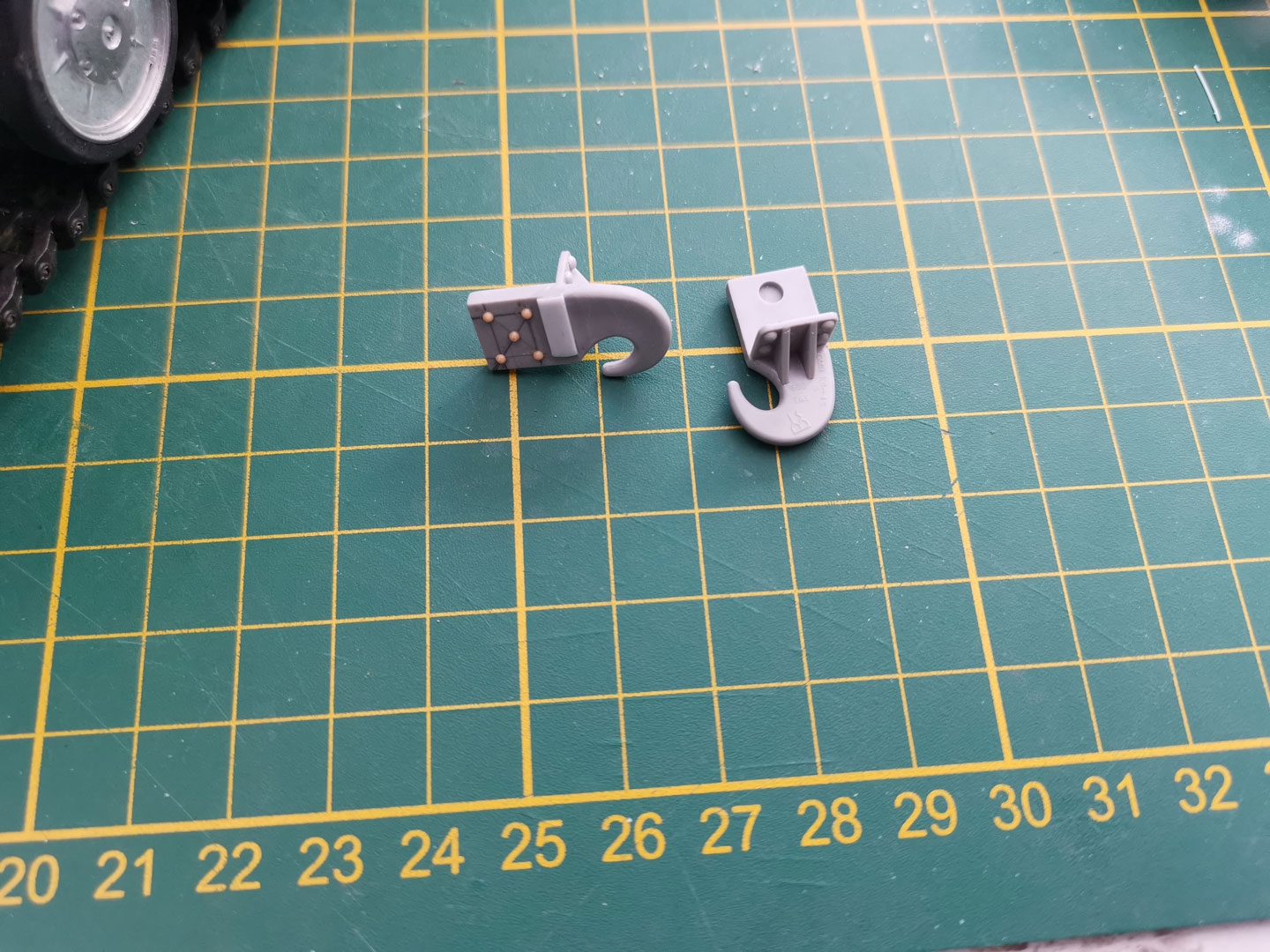

The hooks are from the Trumpeter Panzer IV. I chopped the small bracket from the Panzer IV rear plate and assembled the hook and bracket together, added some detail and glued it to the hull of the Hummel.

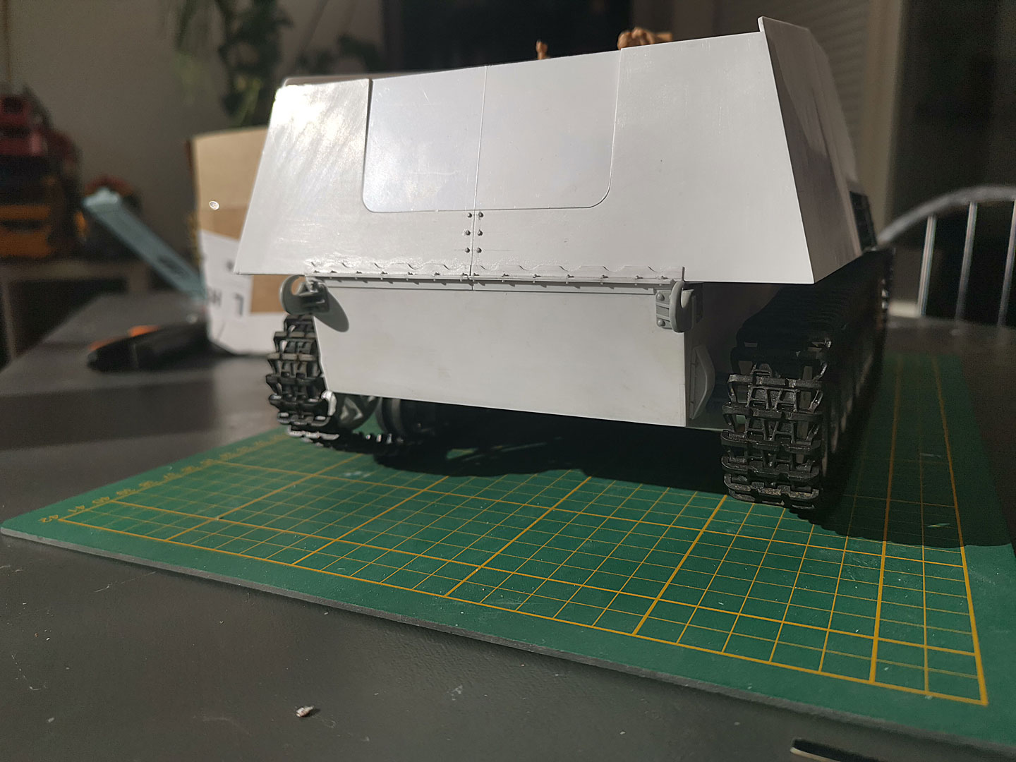

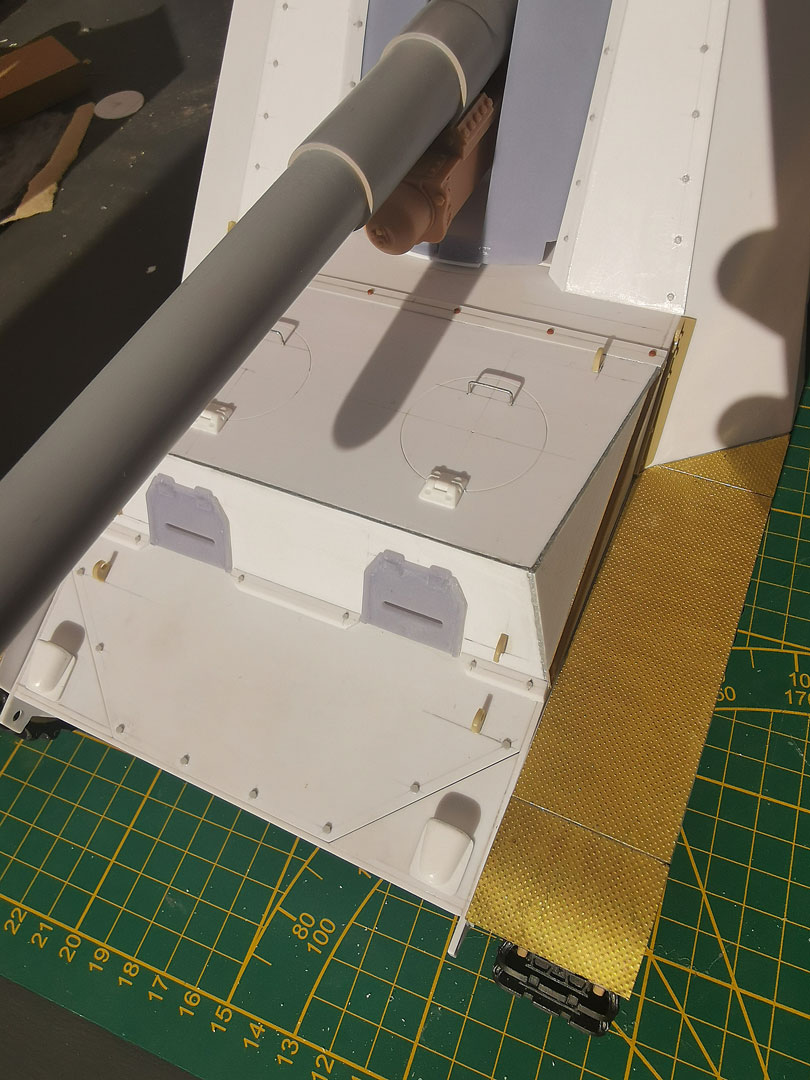

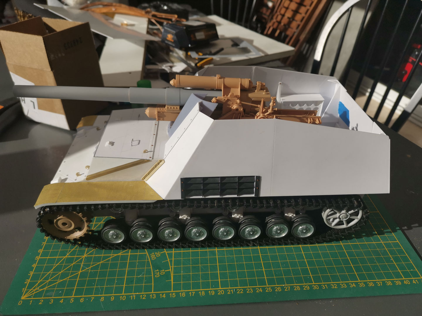

Here are some general overviews.
I 3D printed the shield in resin. I don't know why I designed it that thick but well I don't plan to print another.
I have also 3D printed the angled brackets which themselves have U channel reinforcements. I designed them with the correct thickness this time (0.3 mm).
I've glued several bolts and nuts that I chopped from unvisible aeras of the Trumpeter Panzer IV (kit I am using to build an hybrid HL/Trumpeter Panzer IV, see my other thread).
The hinges of the pilot and radio guys hatches are molded and casted from the 1/16 Heller StuG III (kit Im using to make a hybdrid HL/Heller StuG III ;)).

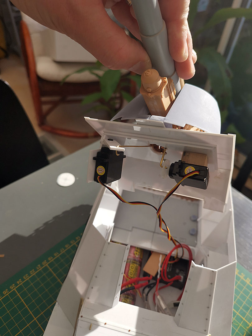

I found a TK 6.1S which allows me to use servo for elevation and recoil of the guns. Its not as good as other option but it does the job and work well.
