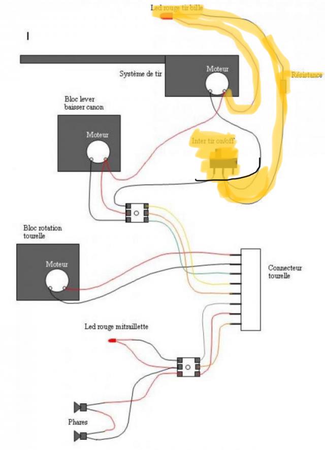

:D here is the wiring diagram RX 18 or Taigen V 3, have deleted what does not exist on a WSN it seems to me?
it is an old diagram, do not take into account the 2 small plates 3 pads, but simply respect the colors of the wires :thumbup:

Yes, so what I deleted in yellow? it is the switch which allows to turn off the engine of the gun, and the red led it is to indicate the shooting, personal is not used much and can be removed, without altering the functioning

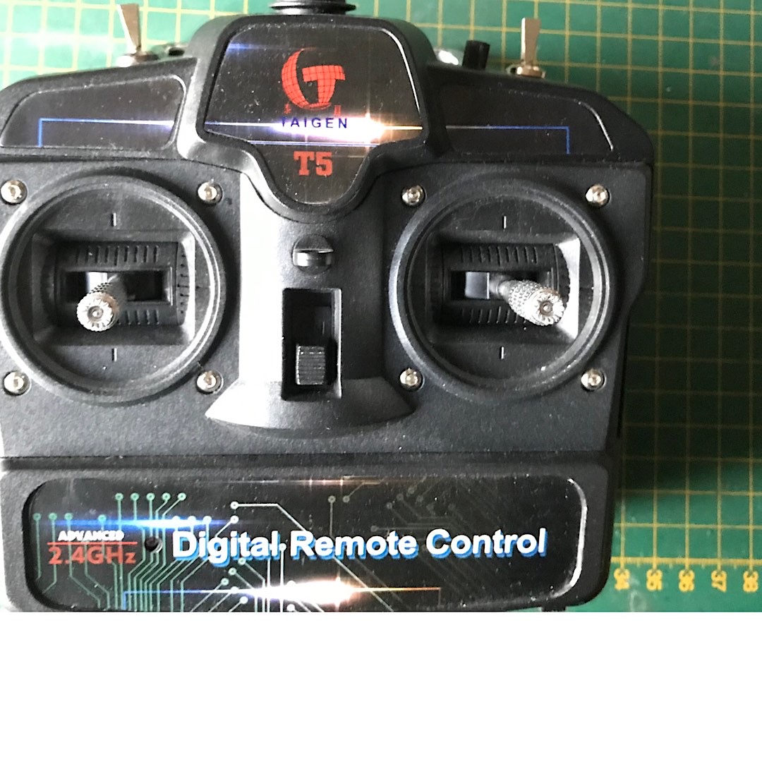

the mance on the left does not come back to the center on its own? that's right ? a photo of the transmitter please, is it the one that goes with the turntable? or an internal mechanical problem

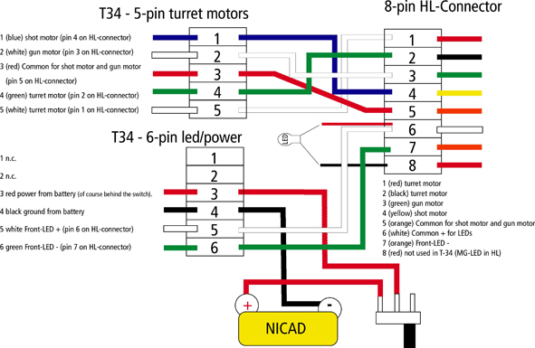

:'( sorry but me again i just found this .. WSN T 34 schematic to Taigen V1 / 2/3, should help :D
attention, the colors on the right 8-pin connector are different for some, because old wiring Heng Long. Take those already provided :thumbup:

I found the same diagram a few days ago and thought this maybe the solution. I will build wiring looms to both this and the ‘airsoft’ wiring diagram today & connect temporarily with connector blocks. I will advise
J’ai trouvé le même diagramme il y a quelques jours et j’ai pensé que c’était peut-être la solution. Je vais construire des métiers à tisser de câblage à la fois pour cela et pour le schéma de câblage « airsoft » qui se connectent temporairement avec des blocs de connecteurs. Je conseillerai.

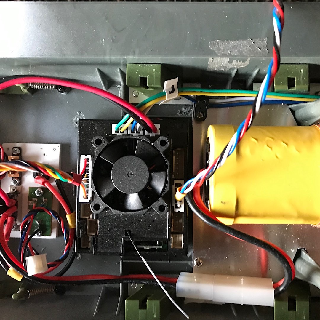

Here are the photos of the Taigen Transmitter & Receiver/MFU.
Voici les photos du récepteur émetteur Taigen / MFU.
Best regards,
Transmitter
Transmitter
Receiver
Receiver
