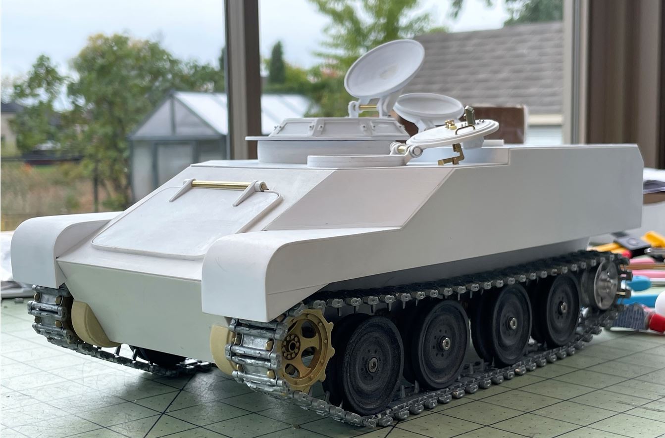

RC 1/16 M113 Lynx C & R - Canadian army 1970s UN mission
Re: RC 1/16 M113 Lynx C & R - Canadian army 1970s UN mission

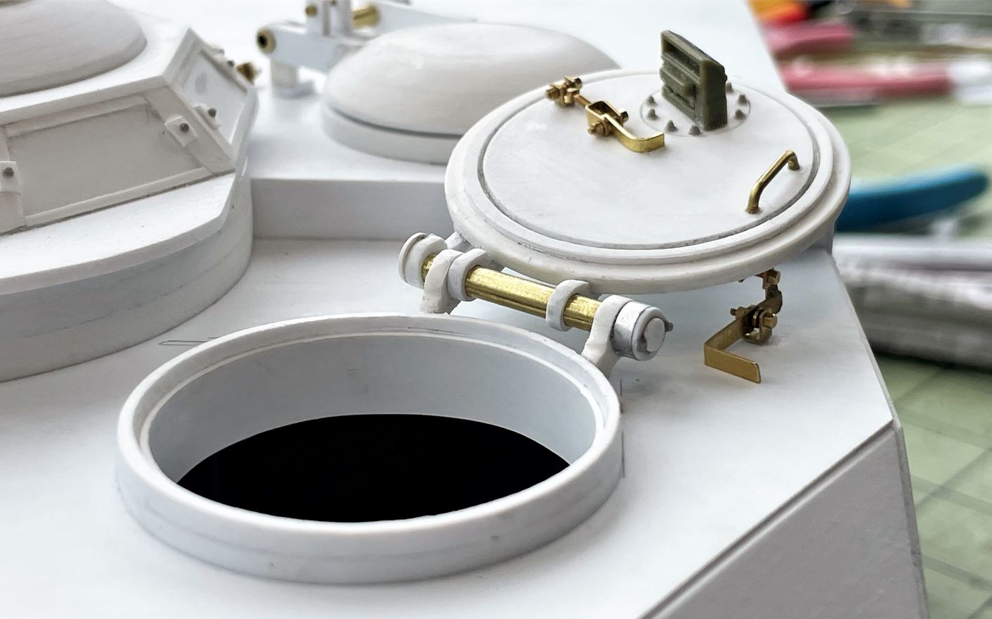

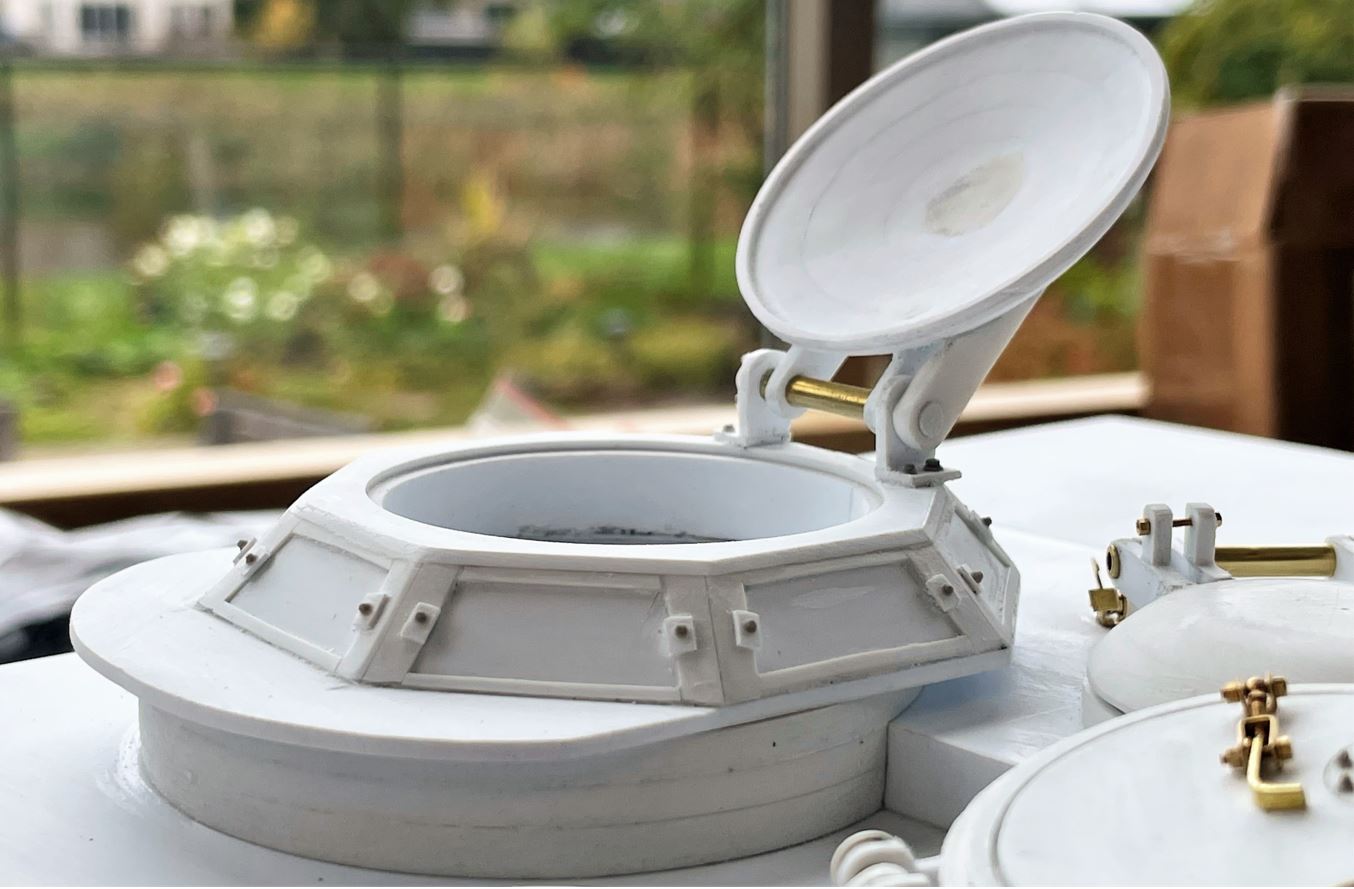

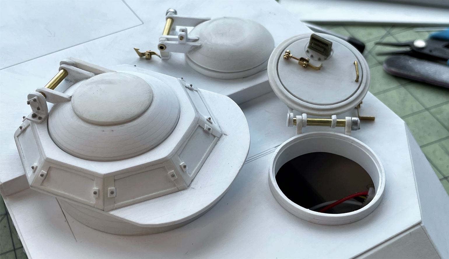

The hatch is made functional. Notice the layered plasticard structure on how it was made. The hatch was then shaped with a nail file.

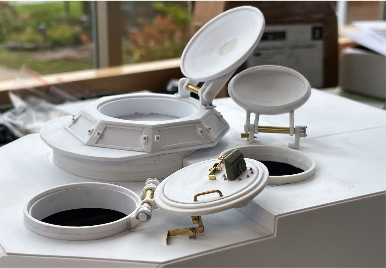

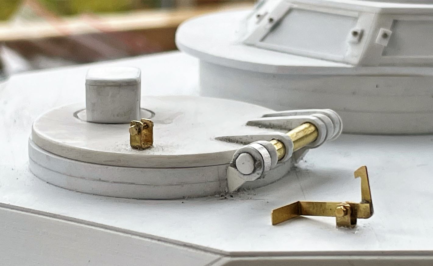

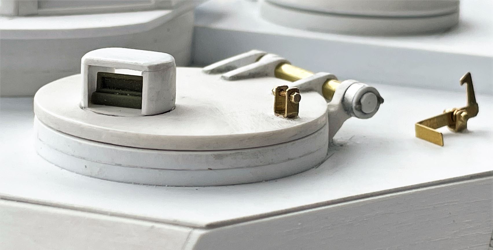

The driver's hatch is a standard M113 driver's hatch with a locking mechanism at the rear. The most complex aspect to recreate are the hinges.
RC 1/16 M113 Lynx Command and Recon tank - build

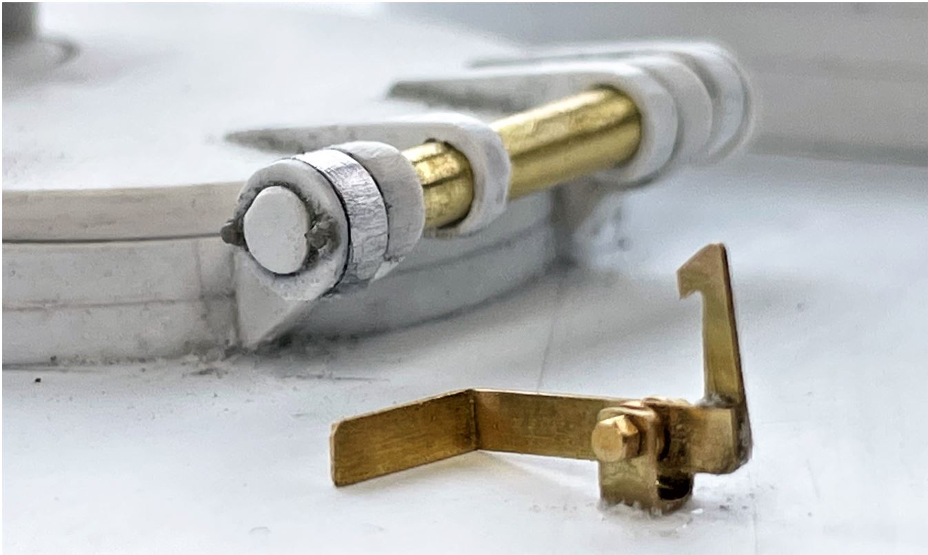

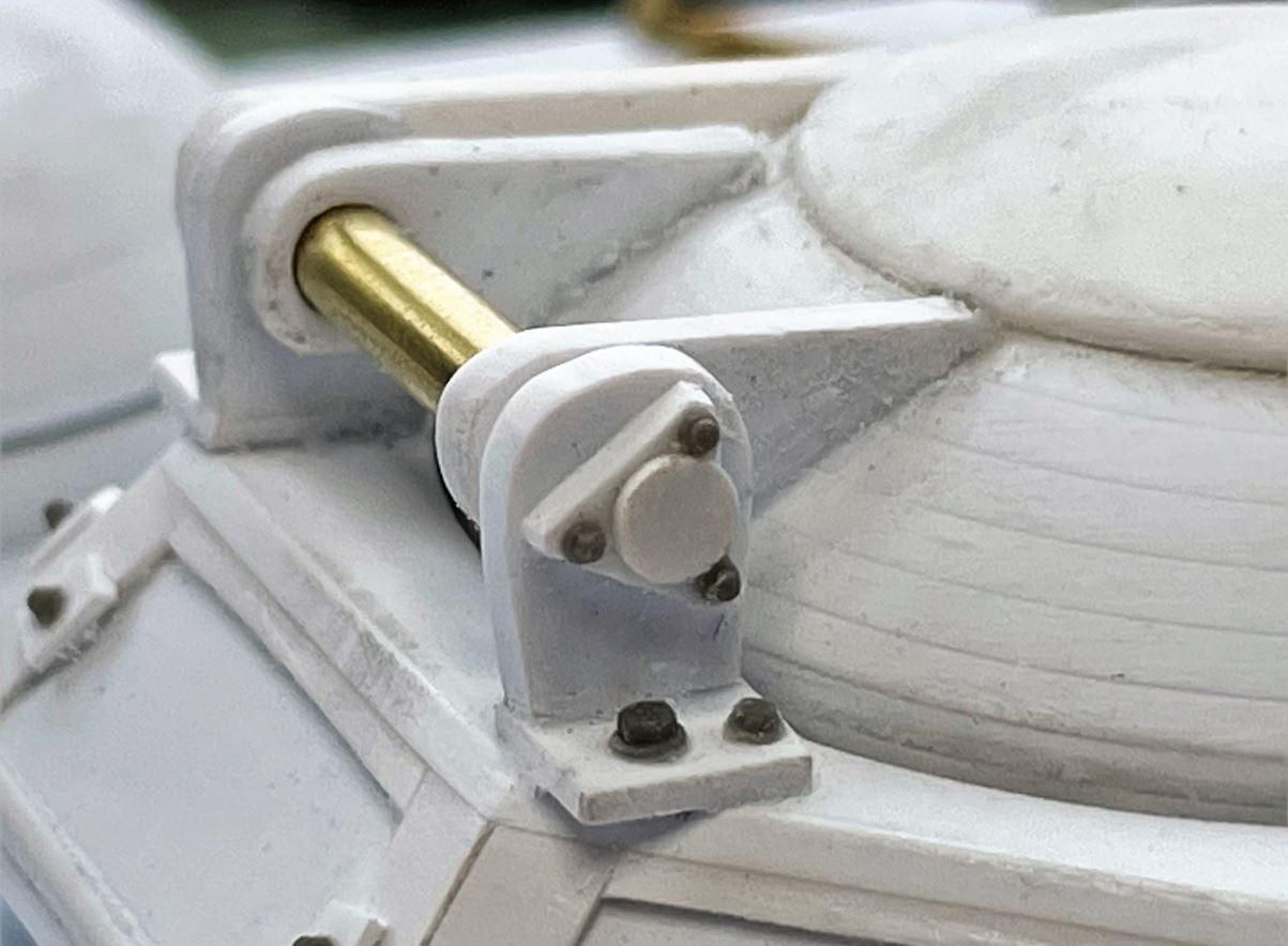

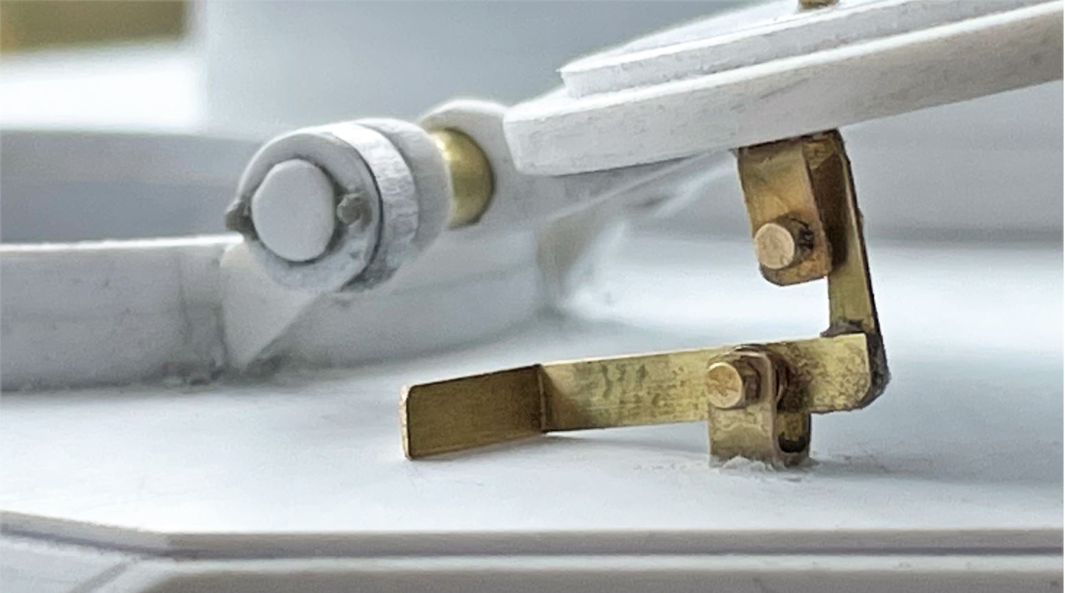

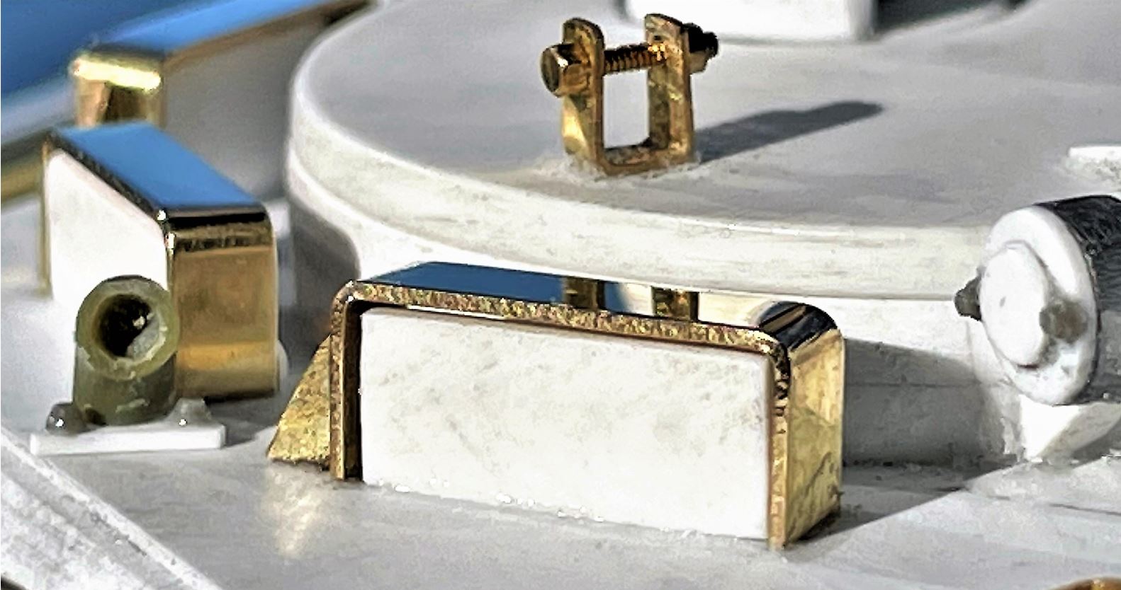

This working locking mechanism was easily made with 2mm brass strips and M0.8 bolt and nut.
It locks well.

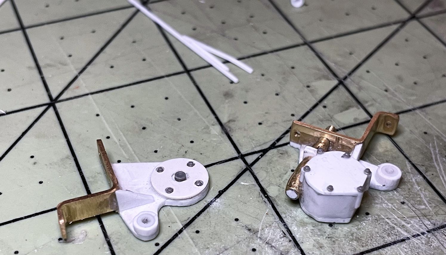

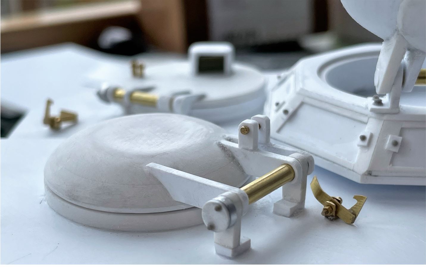

The interior of the hatch was given its periscope and locking latch seen in reference. It will be given a driver's figure.

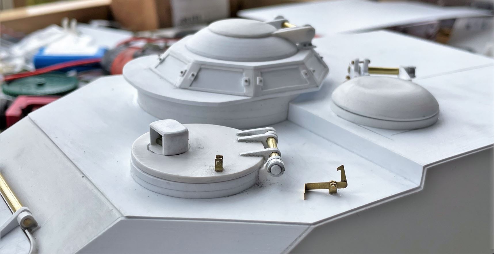

This is the observer's hatch.
The observer's hath is also given a locking mechanism.

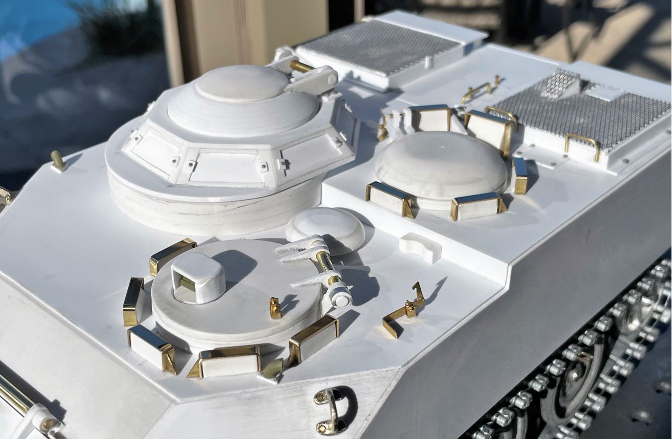

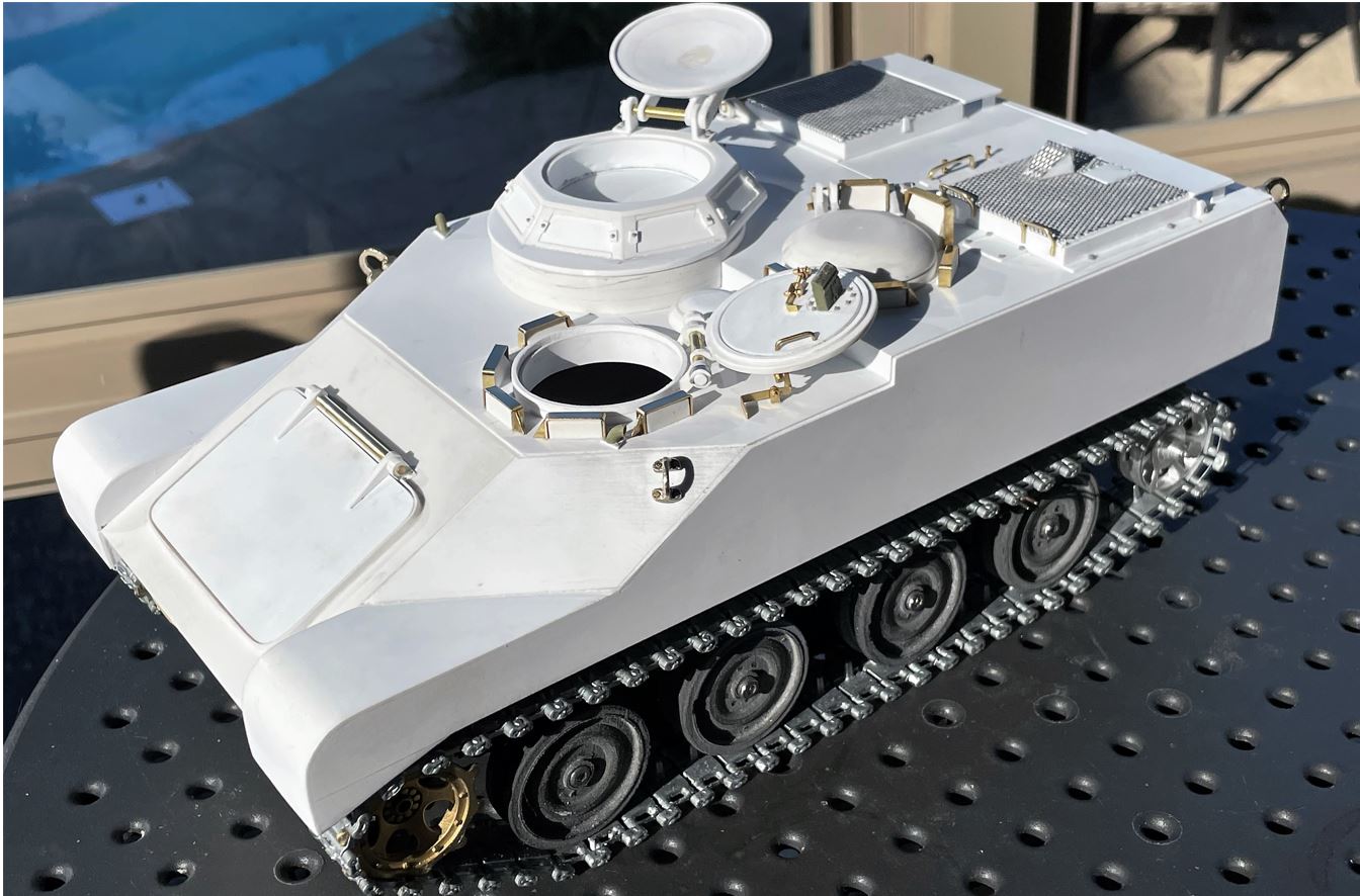

Overview of the hatches.

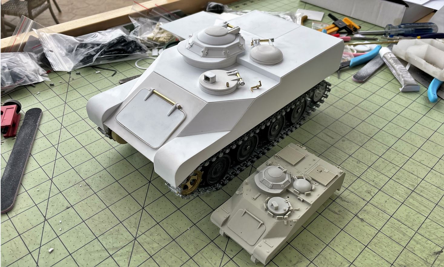

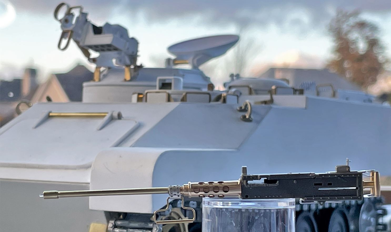

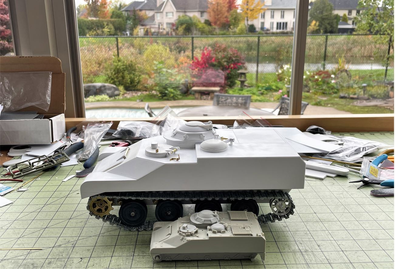

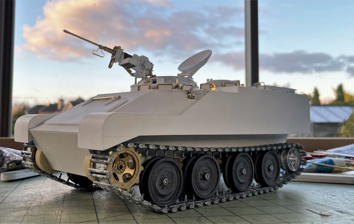

Overview of the model as it stands today. You can see where this is going.

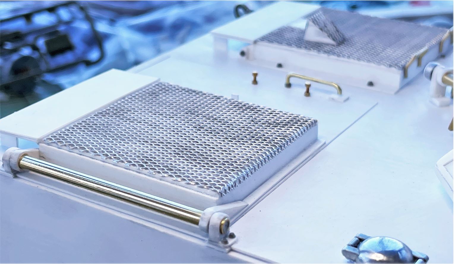

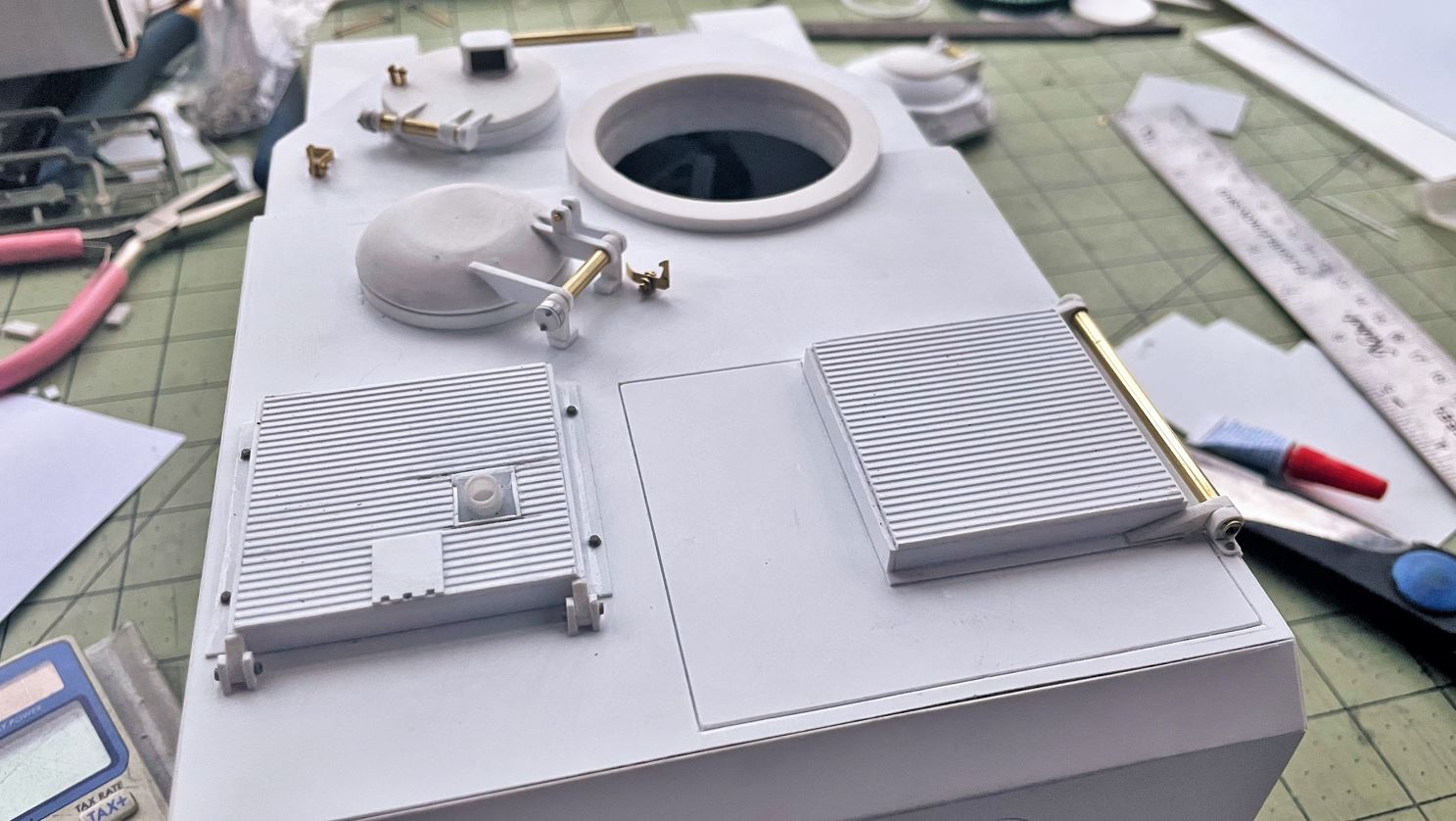

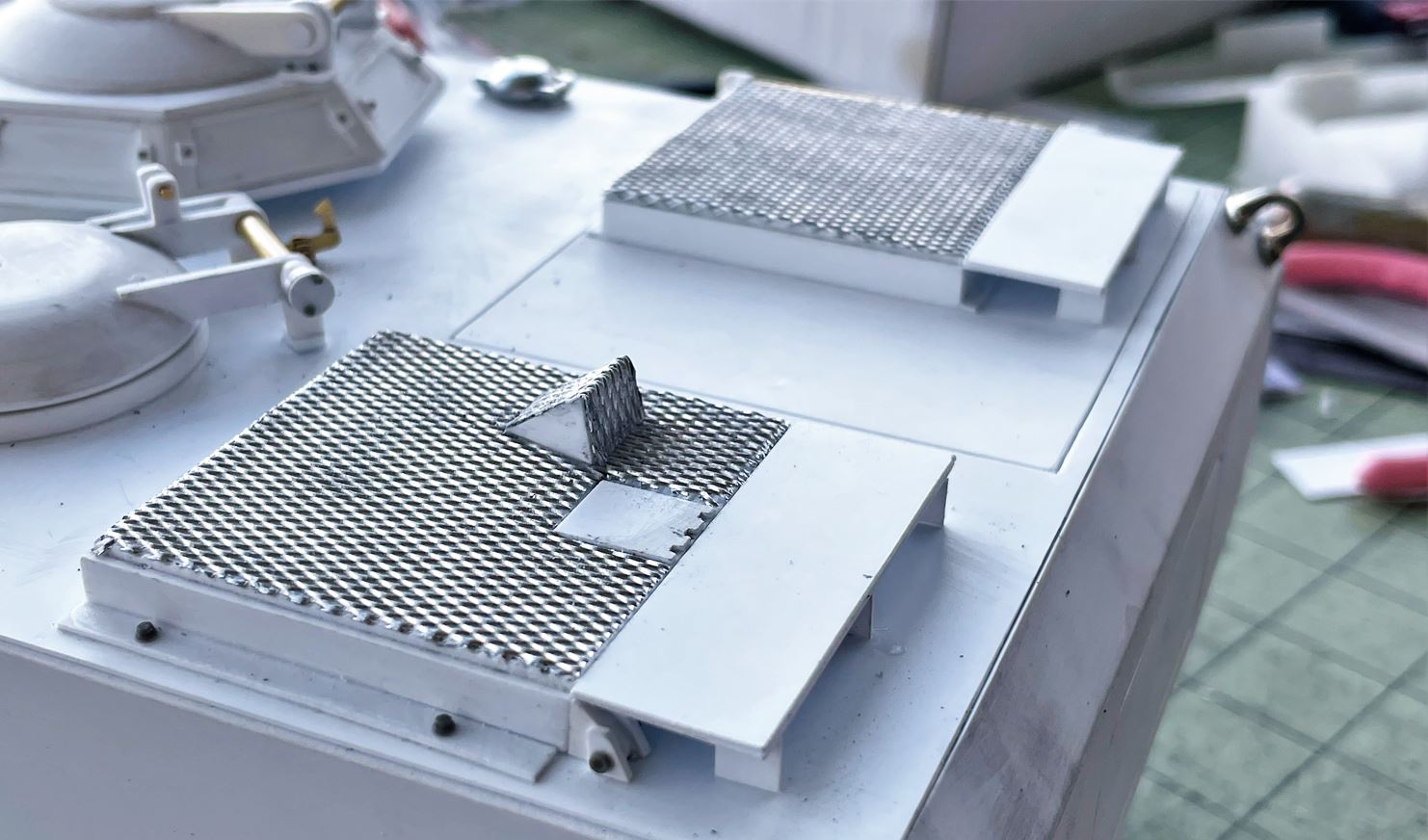

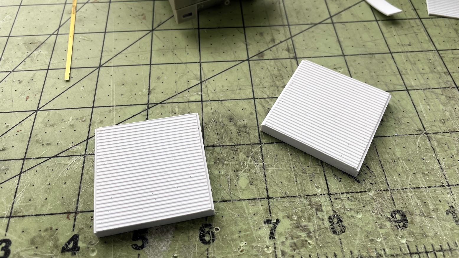

Contrary to other M113, the motor on the Lynx is installed at the back. The two air intakes grills are equipped with a folding metal protection that can be raised. They likely helps kept water and dust away when required.

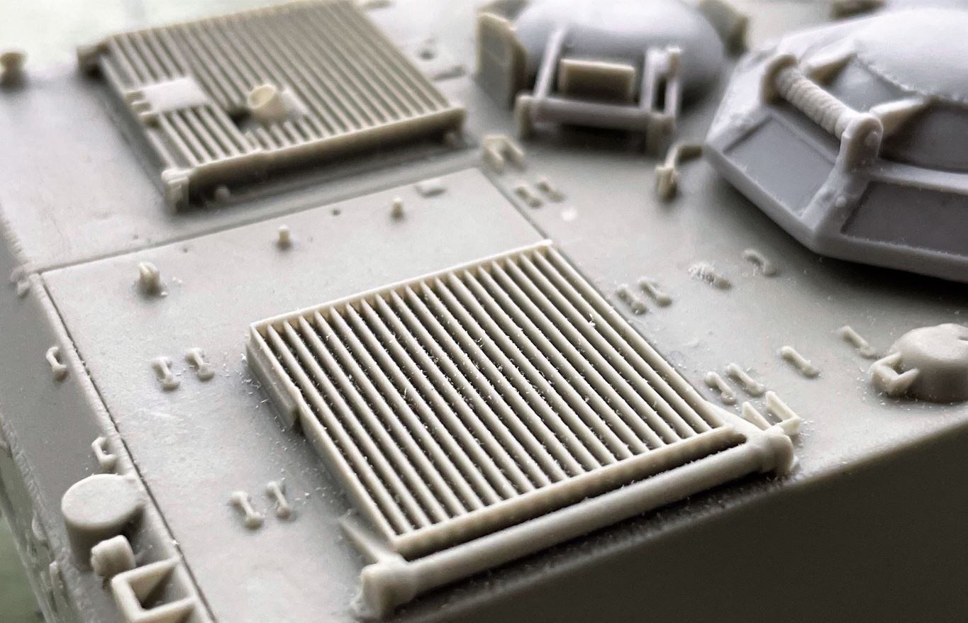

The air intake on the right side is part of a large hatch to access the engine.
The 1/35 kit provided dimensions and shapes.

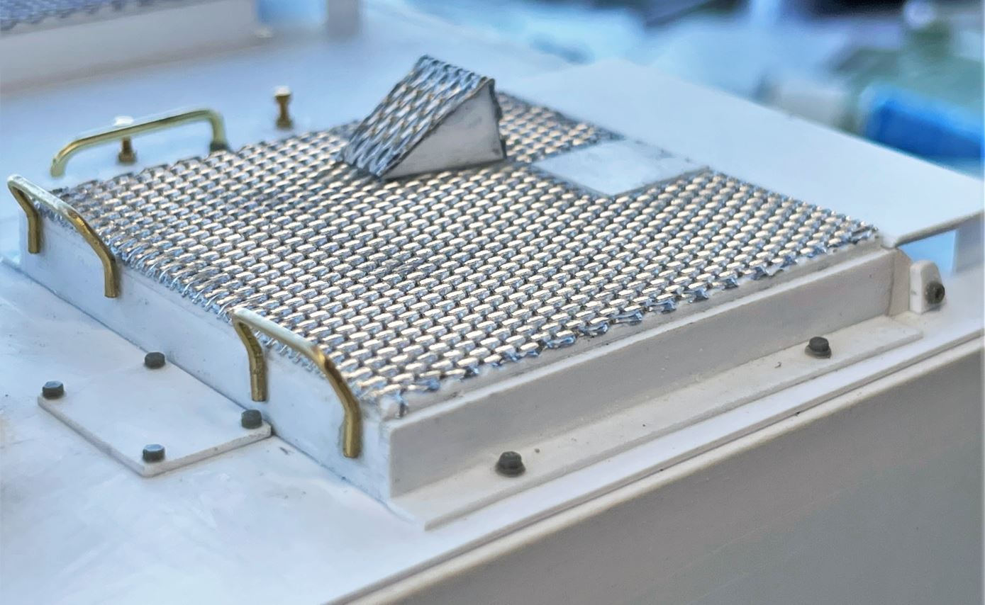

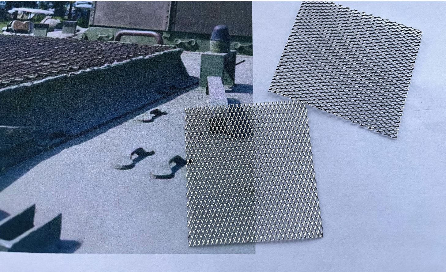

As the air intake is covered by a metal mesh, there is no point in reproducing each blades individually, they will be mostly hidden and painted black. Instead, a shaped plasticard sheet provides the general look of the ventilation blades under the mesh.
From what i can deduce, the air intake on the left has the exhaust pipe coming out.
Metal mesh with the right type purchased on eBay is cut with scissors.
The exhaust has its own little cage in the middle of the grill. An attempt was made to repro what was seen on the 1/35 kit.

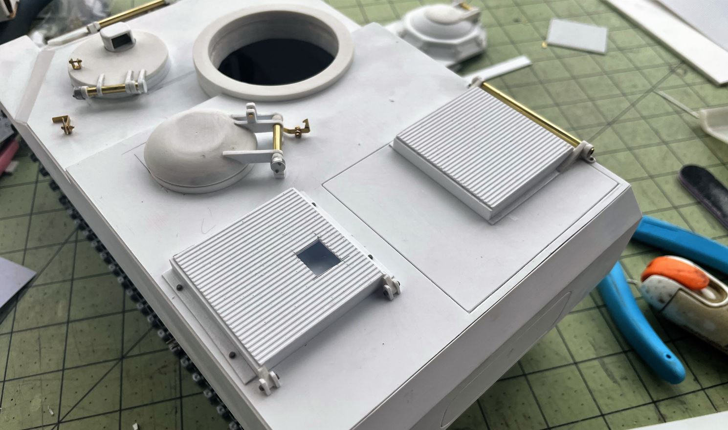

The engine grills and engine access door are done.

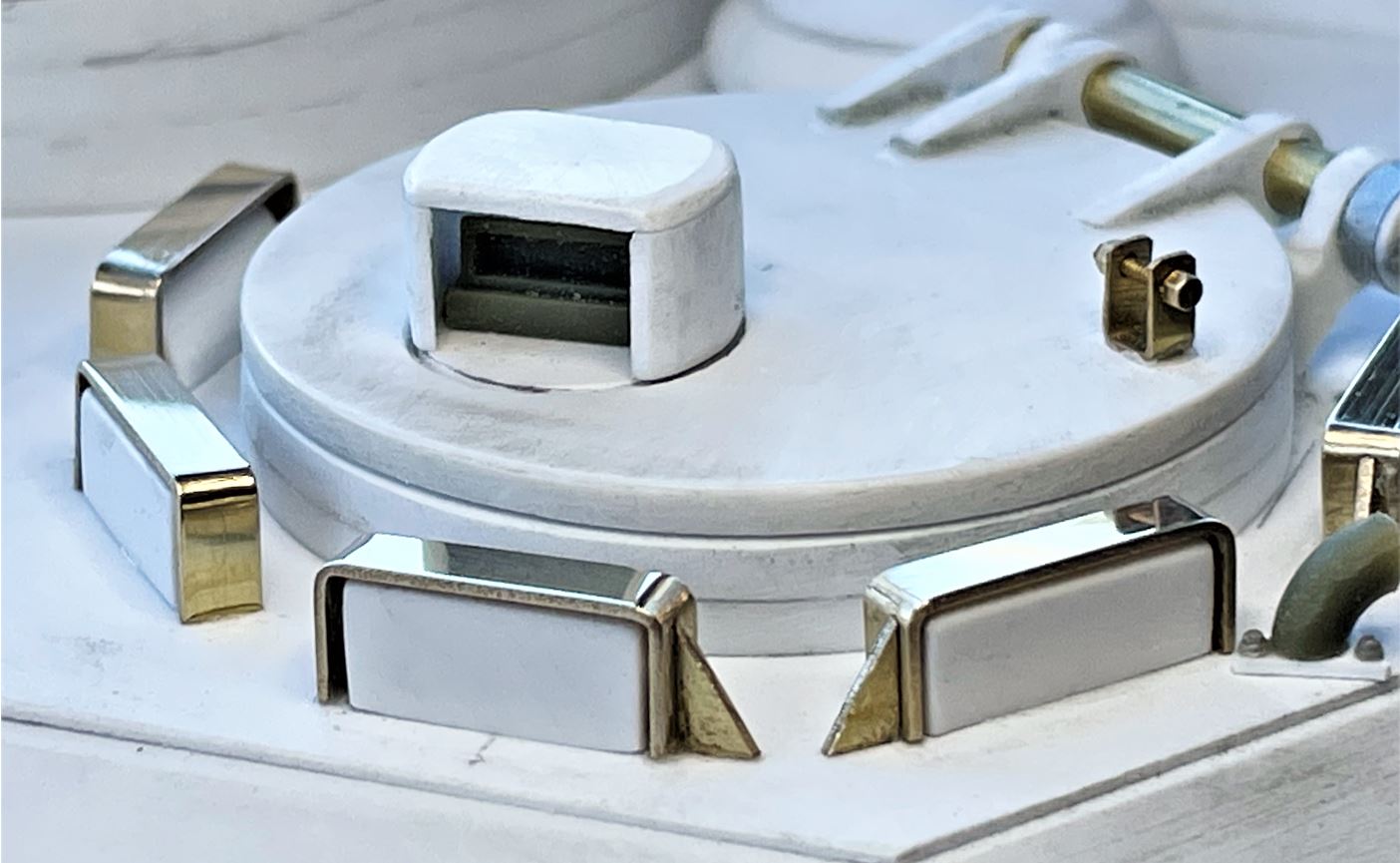

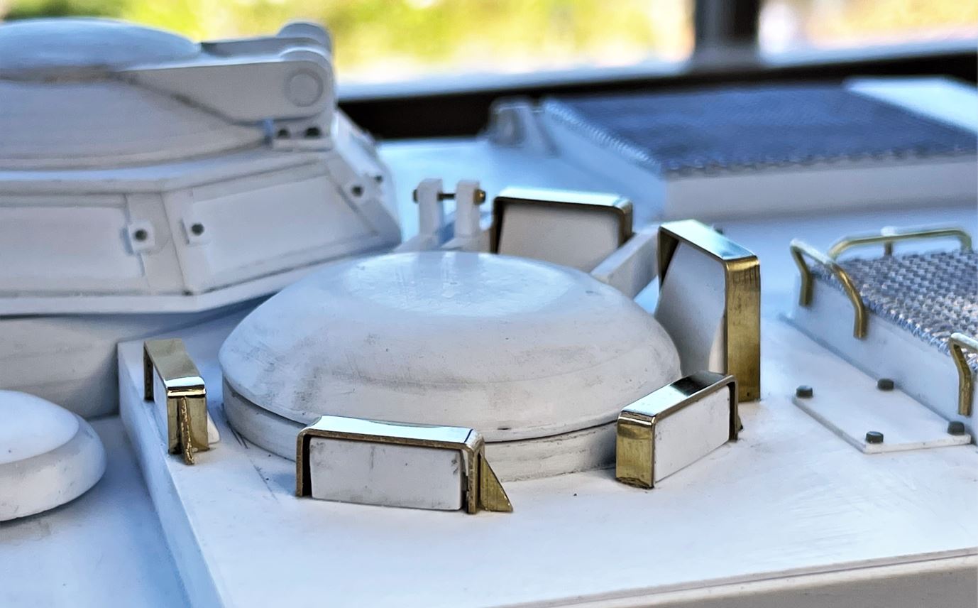

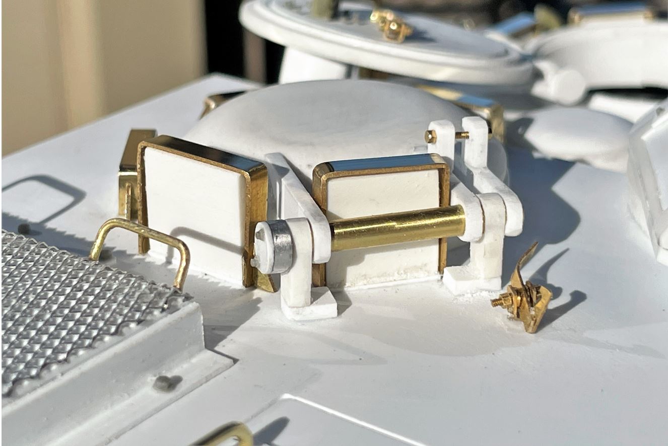

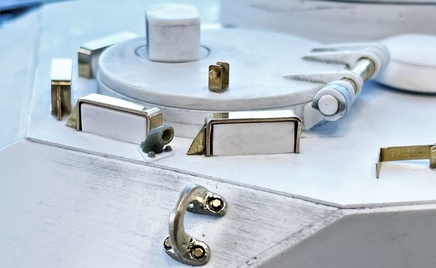

The Lynx driver has standard M113 periscopes but i noticed a small reinforcement bracket only on one side of each periscope guard.
Periscopes were created in 4mm thick plasticard. Oh, I could have spent more time on them but that will do.
The periscope guards were made in 3mm x 0.5mm thick brass strips. The issue here is that 2mm brass strips seemed too thin and the 3mm strip are too large. Well, that will have to do. They look good.
The little water drainage pipe is made from items from the junkyard, actually coming from the M5A1 Stuart build leftovers.

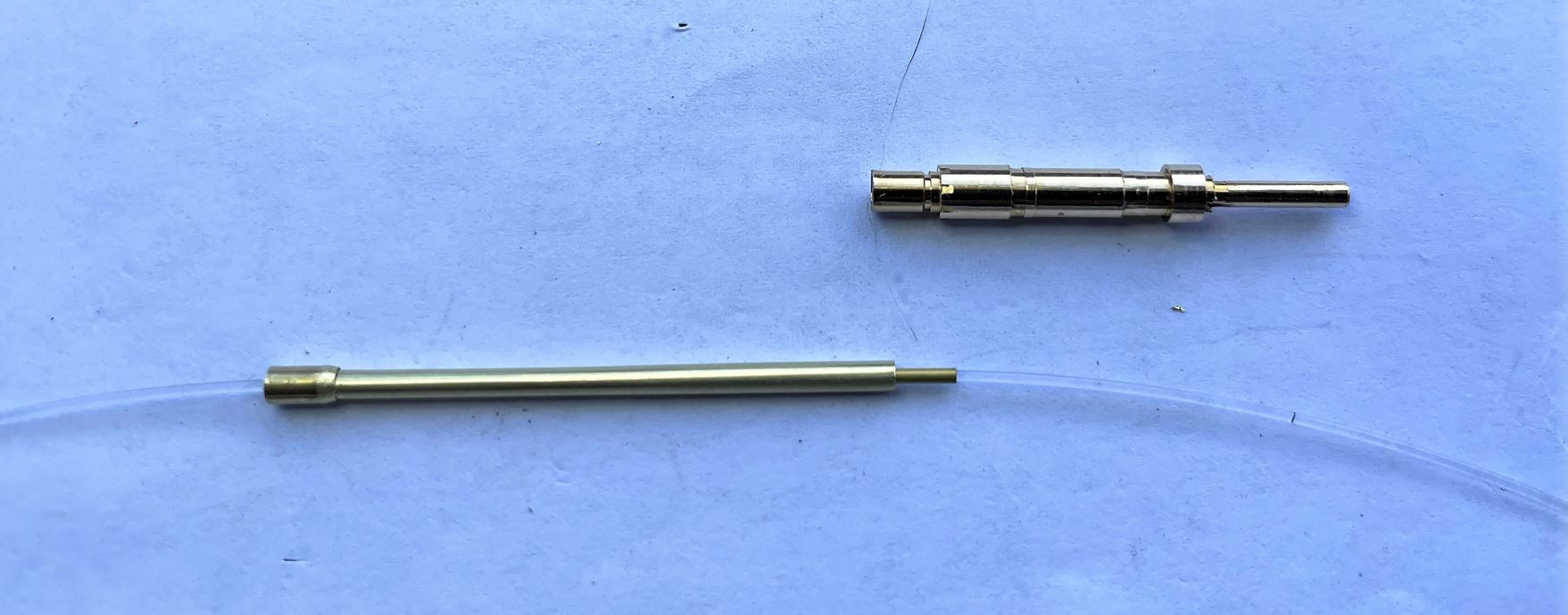

The metal lifting hook are MLRS hooks from AFV-Model, same as used on the M113.
All brass strips, bolts and nuts come from Knupfer.

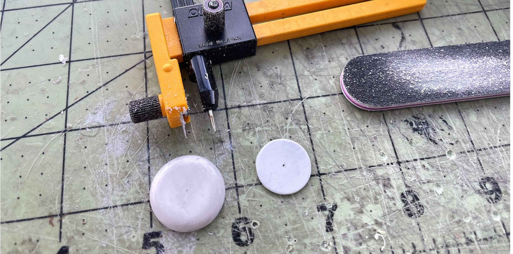

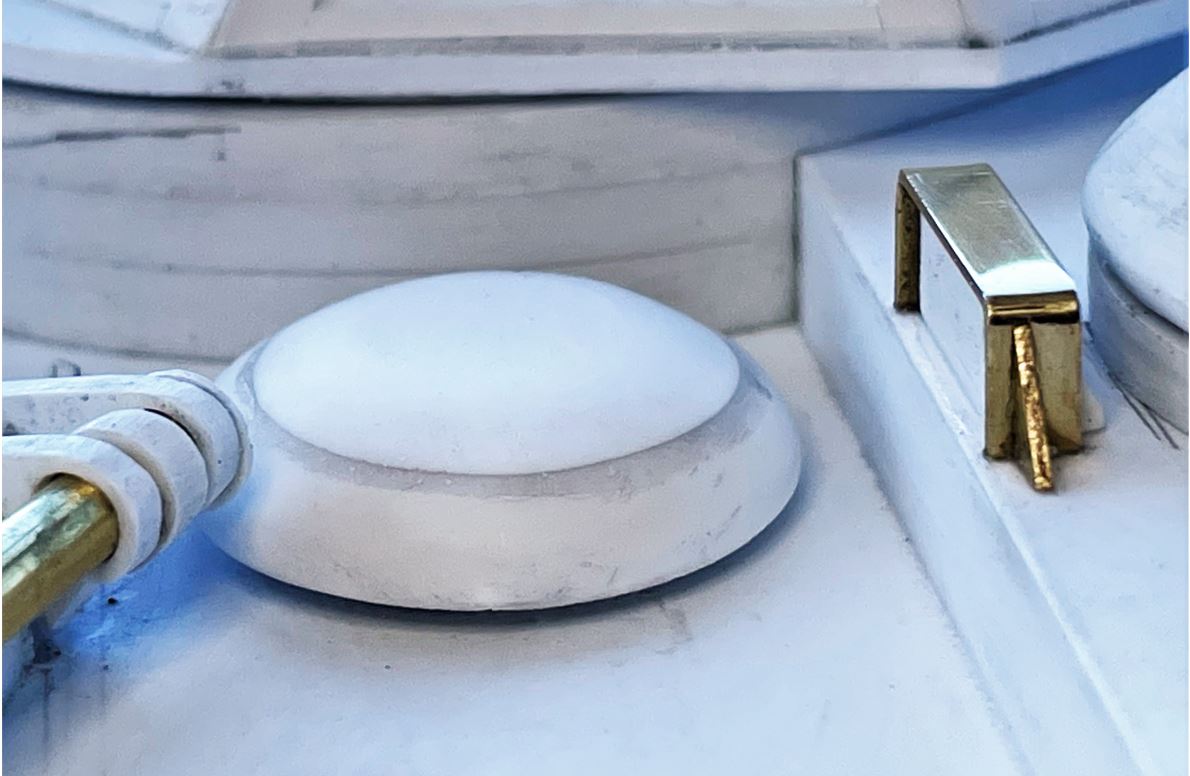

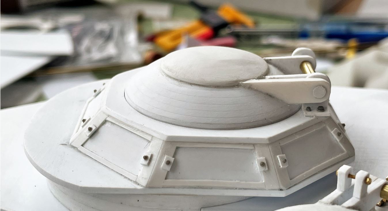

The Lynx ventilation cover.
Made with the roundel maker. I later added an extra 2mm layer for more thickness.

Overview of the model as it stands today. Notice the flat panel in front of the commander's hatch has been given its final shape and dimension for the upcoming machine gun mount.

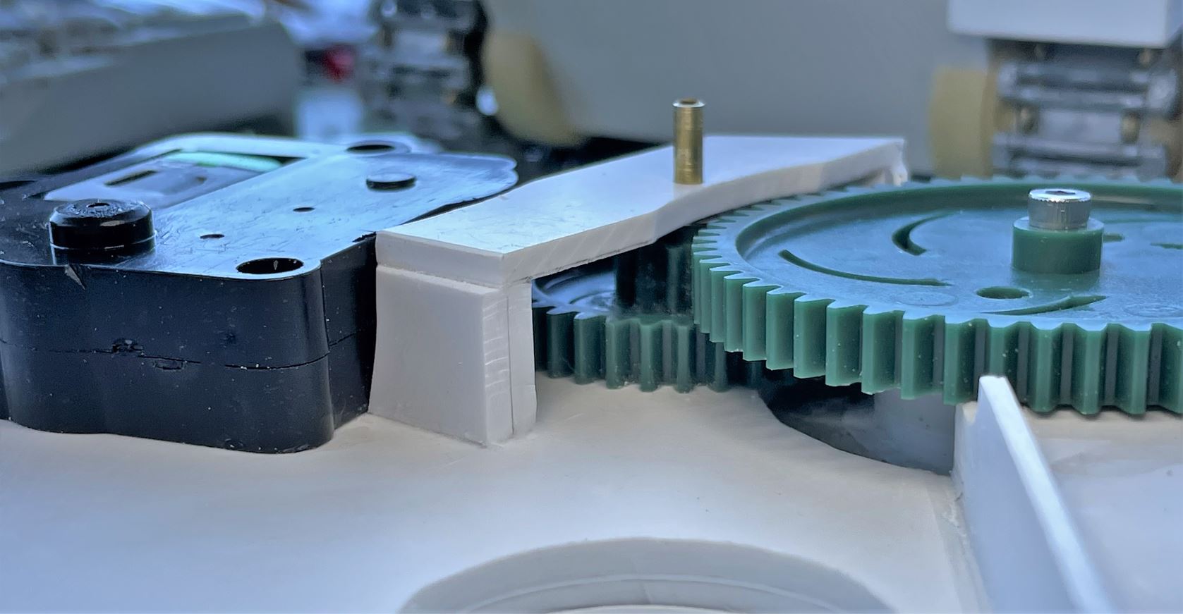

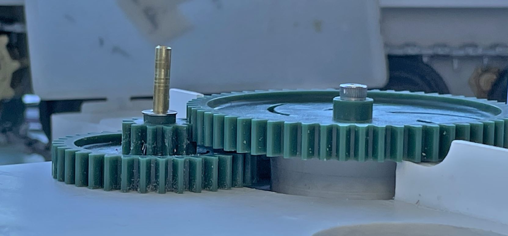

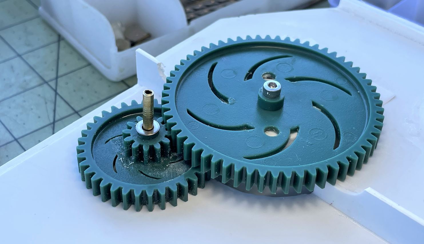

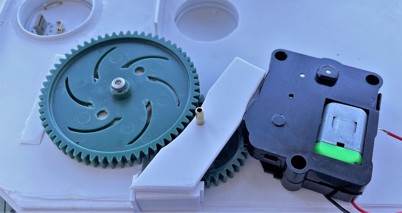

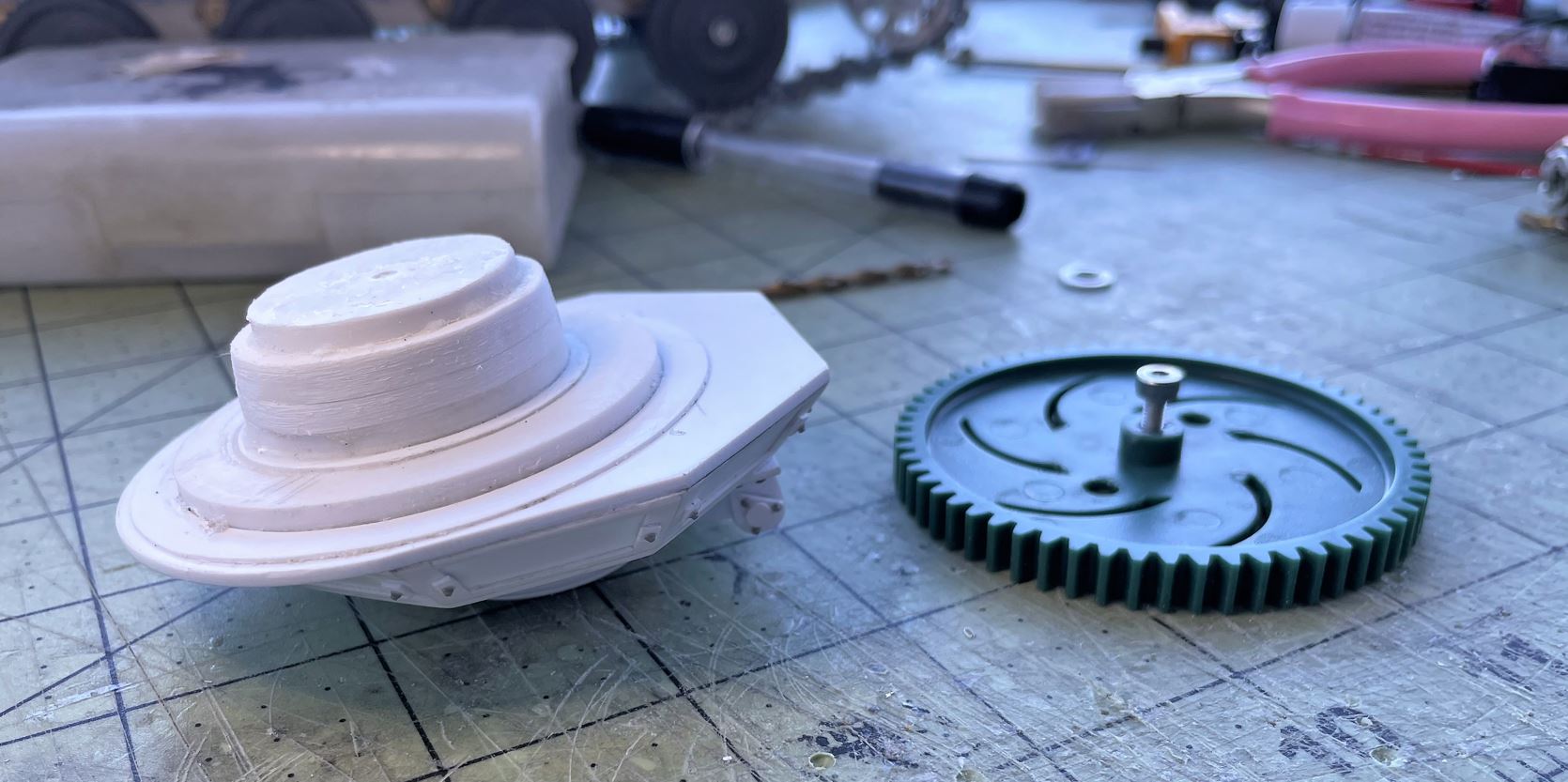

In preparation for the design of the Browning M2 mount and elevation, i gave the turret its rotation system. As the Lynx has a manually operated turret, i wanted something with very slow traverse.
A plasticard spacer was created under the turret to accept a medium size Vex Robotics gear that fits the hull size. It has a easy process with a single M3 hex bolt to install and remove the turret for maintenance.
As the main gear wheel is small, i cannot put on a HL rotation unit directly on it, rotation would be too fast. I created some reduction gears using a small and very small Vex Robotics gears, installed and glued on top of each other with a main axle.
This shows the two level upper deck and how i am making use of the available spare to create a rotation system. The elevation servo will be installed on top of the main gear. Now you understand why the thin spacer for the main gear was created.
A regular Heng Long rotation unit is installed.
Here we have a very slow turret rotation system designed on the fly. It makes the noise of a motorized rotation system instead of a manually operated system, but its what i can do with the Clark control board used.
Next step, the machine gun mount and M2 Browning.

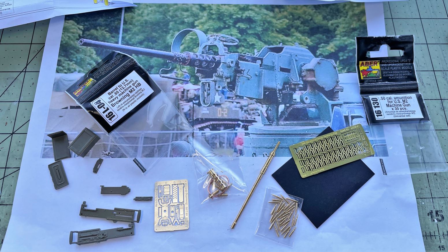

The following posts are for the machine gun mount and Browning M2.

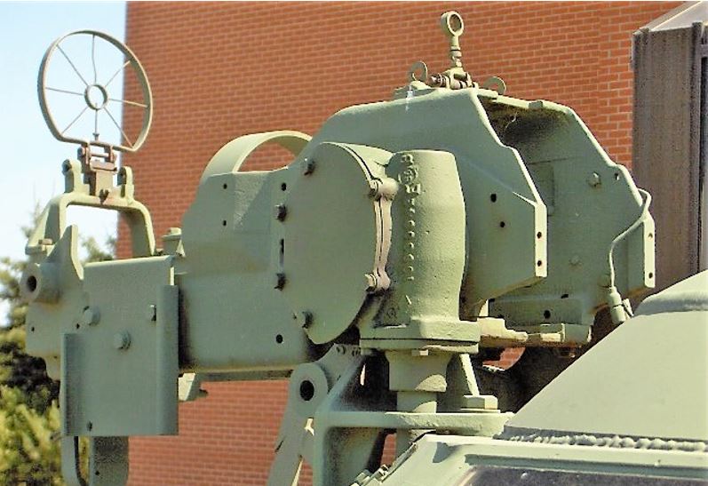

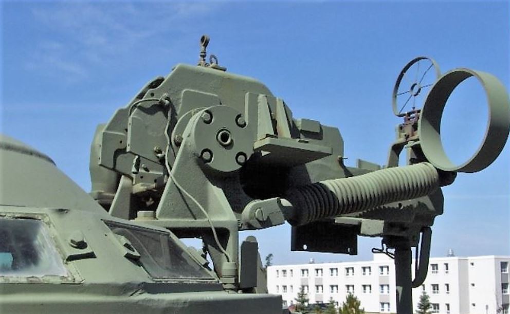

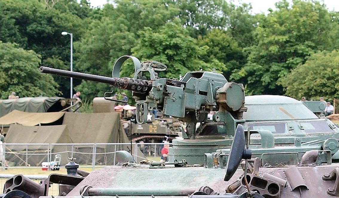

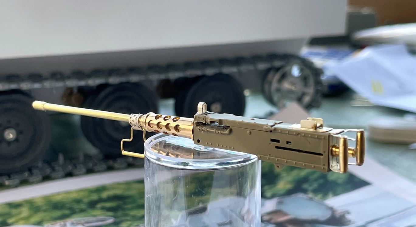

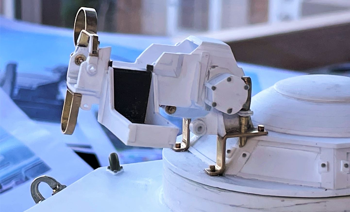

The M26 cupola is equipped with an 12.7mm M2 Browning manually operated by the commander. It can be fired from inside. At first sight, the mount seems complicated, and it is actually worse than it looks. This machine gun mount was more work than the whole Churchill turret on the previous build. But it is one of the highlight of the build so i had to do a good job. Forget about 3D printing this.
Some other views of the real thing, enough to demoralize even the most experimented scratch builder. The mount is composed of a base connected to the cupola at 4 points with a platform for the machine gun that elevates. The feeding mechanism for the M2 can be on the left or right. I do not understand why that is the case, i picked the ammo box on the left side as this is how the Tamiya M2 is setup. Various pictures show the ammo box on both sides for no obvious benefits one way or another.
I have not found the purpose of the large ring on the right side. I am guessing is it part of an additional AA sighting apparatus that is not installed here. There is a one large spring that can obviously be switched sides as the mounts are also on the left side.

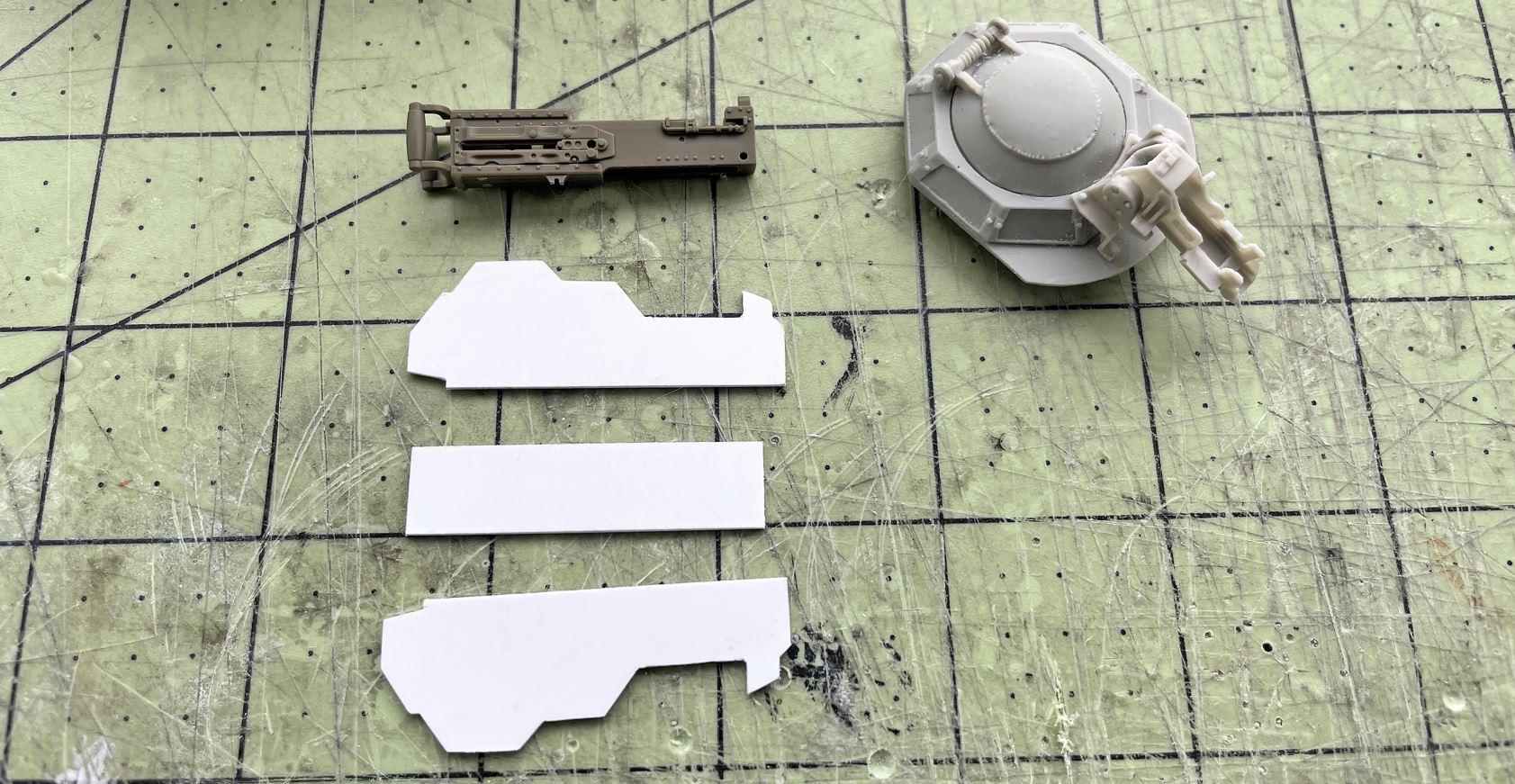

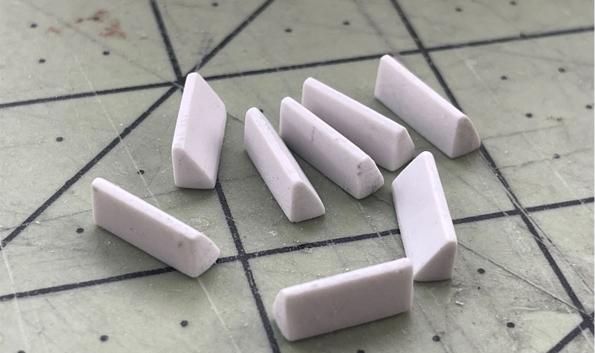

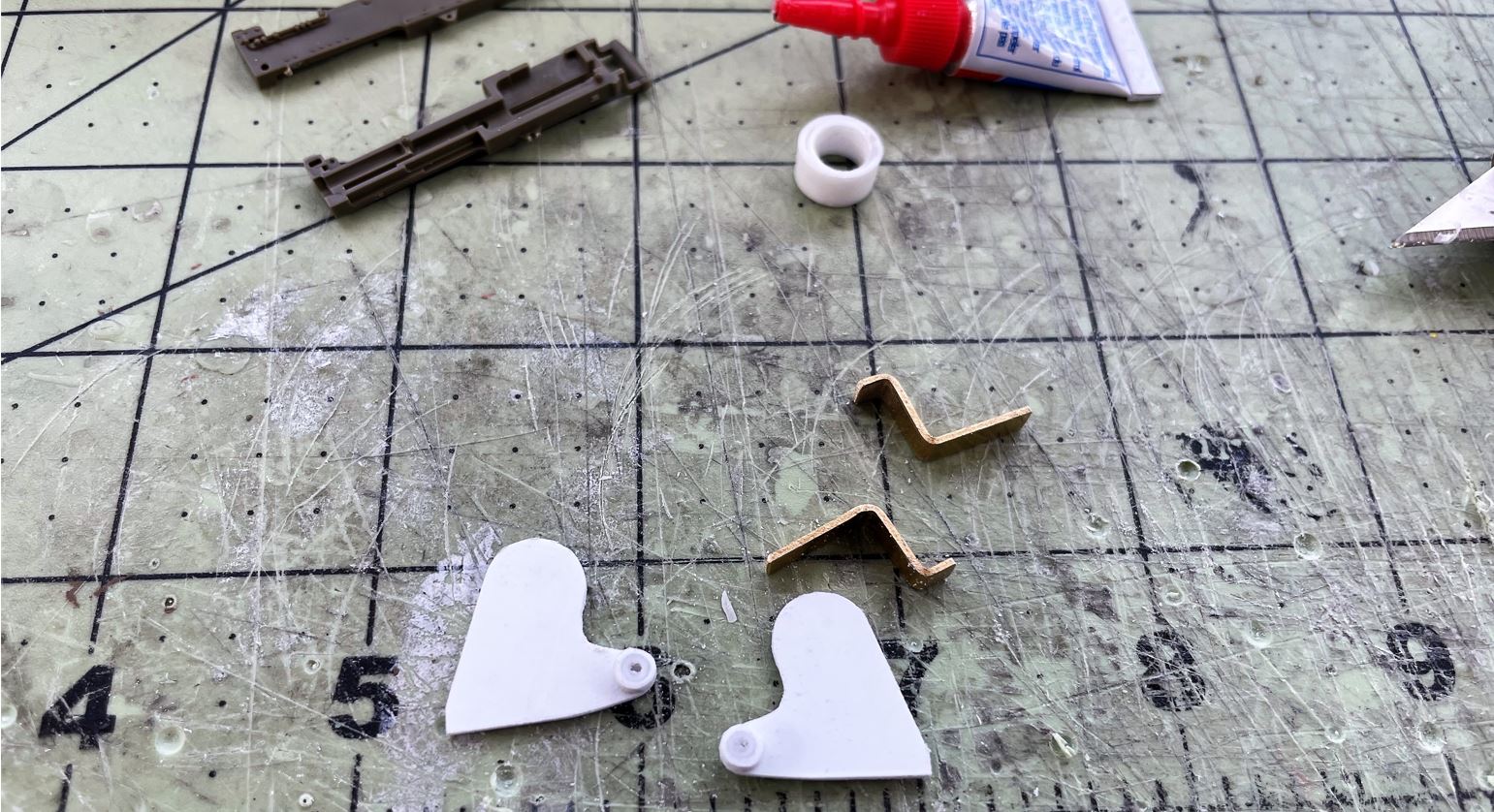

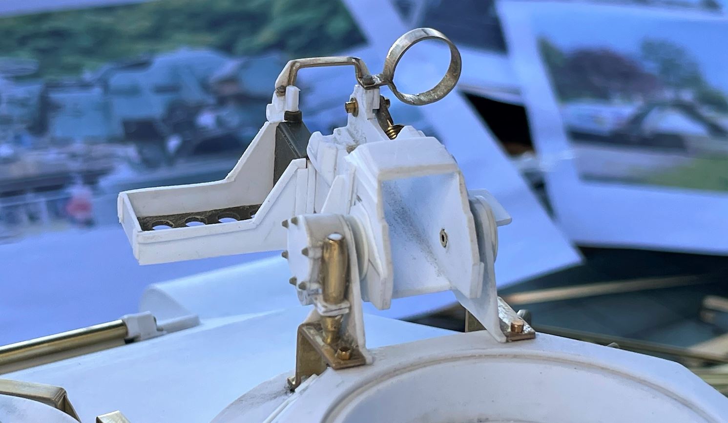

Need to start with what makes sense, the two mounts on the cupola. A modest start here that leads to a completed gun mount designed in a telescopic fashion, one item at a time. It took about 3 days, quite a few hours here and there.
The mounts were given supports in thick brass strips for solidity. These would not last 10 seconds in the field if they were made in other material.

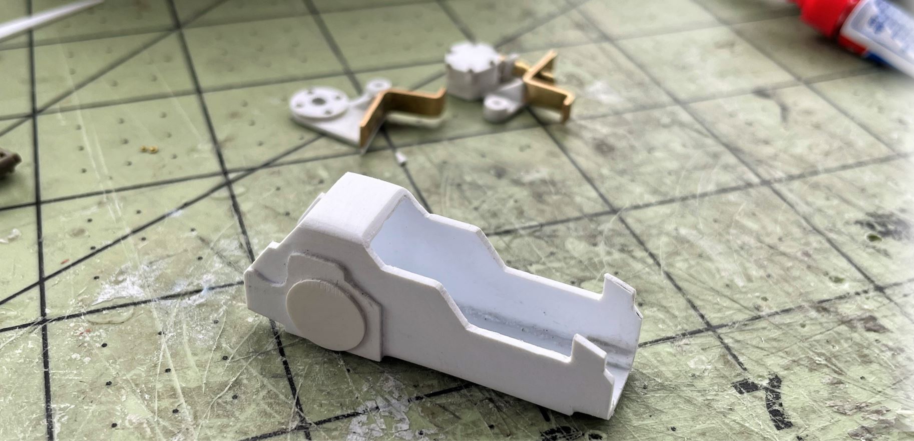

The platform for the machine gun is started in the same fashion. The 1/35 kit was not too useful for details, too simplified, but helped for dimensions. I had to rely on pictures from available walk arounds for all the detailing.
Its getting somewhere.

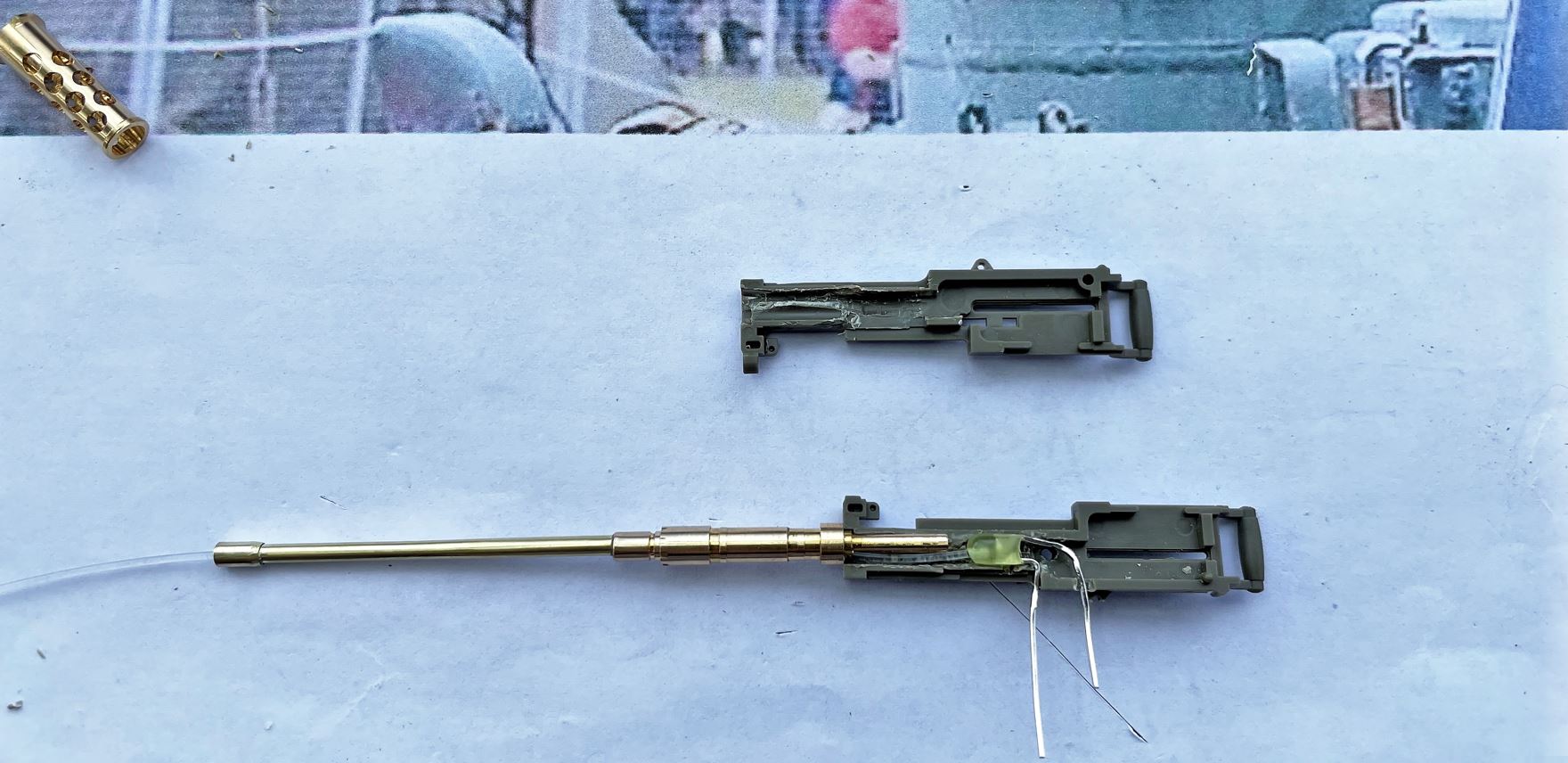

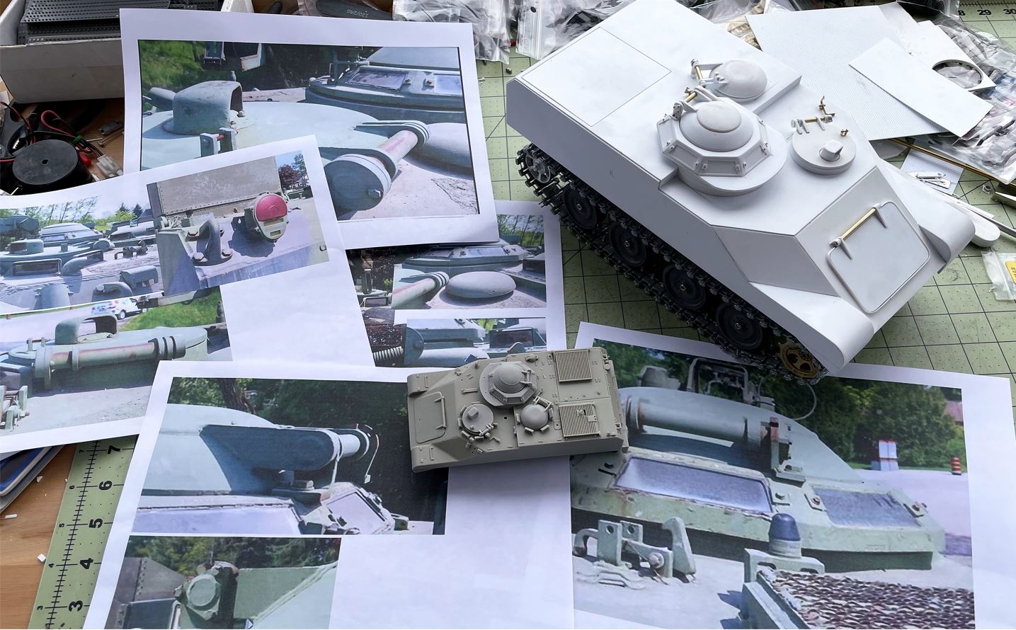

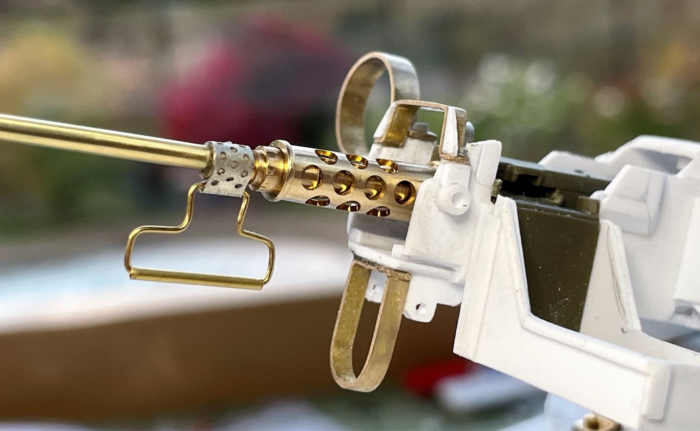

I managed to find and print about 15 close up pictures that really helped with the creation of the machine gun mount. Sadly, no one seems to be able to climb on a tank to take pictures from above...
continuing on following post.

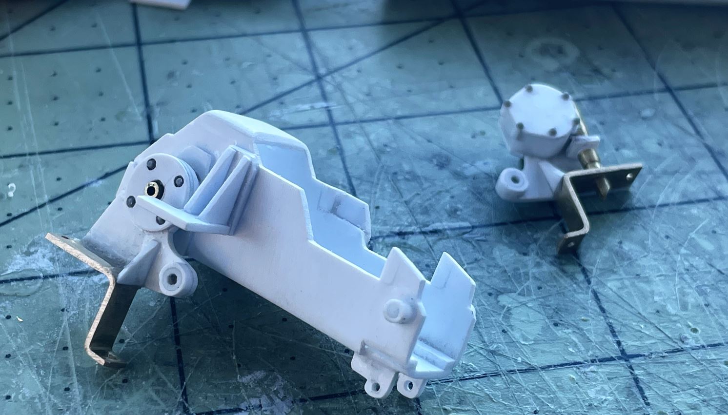

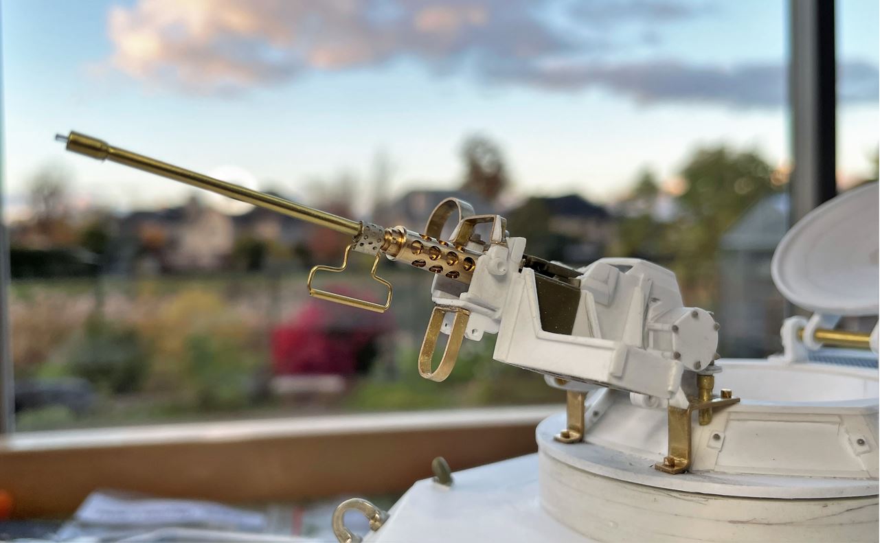

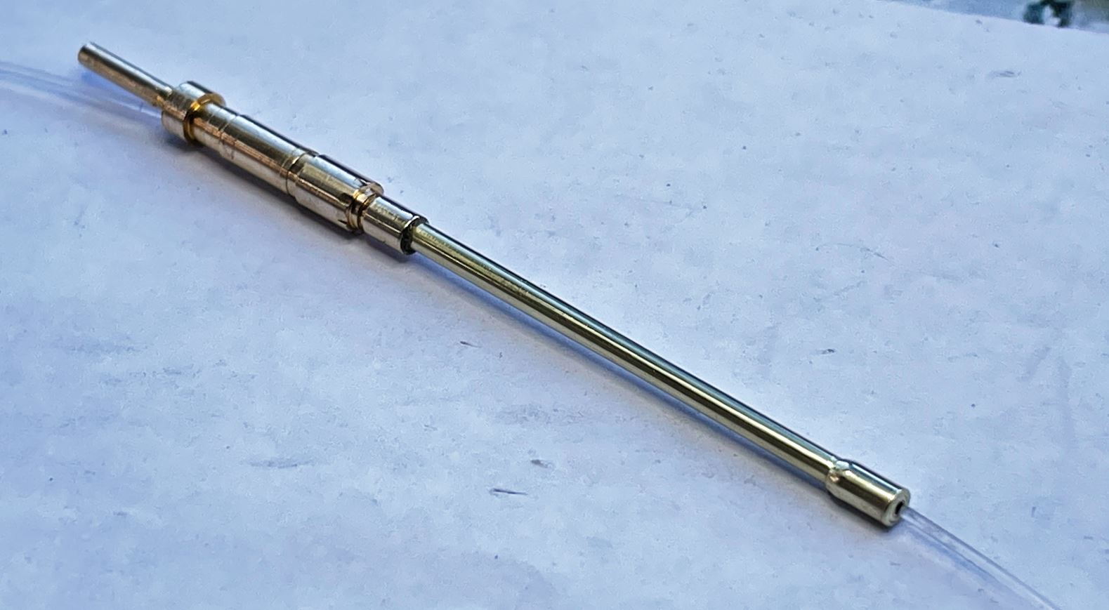

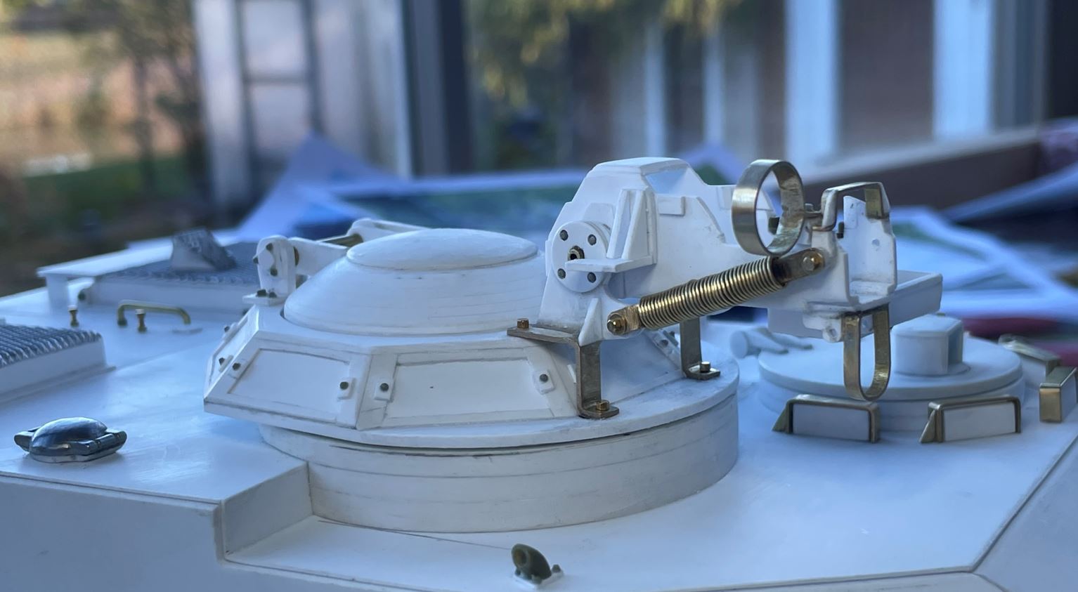

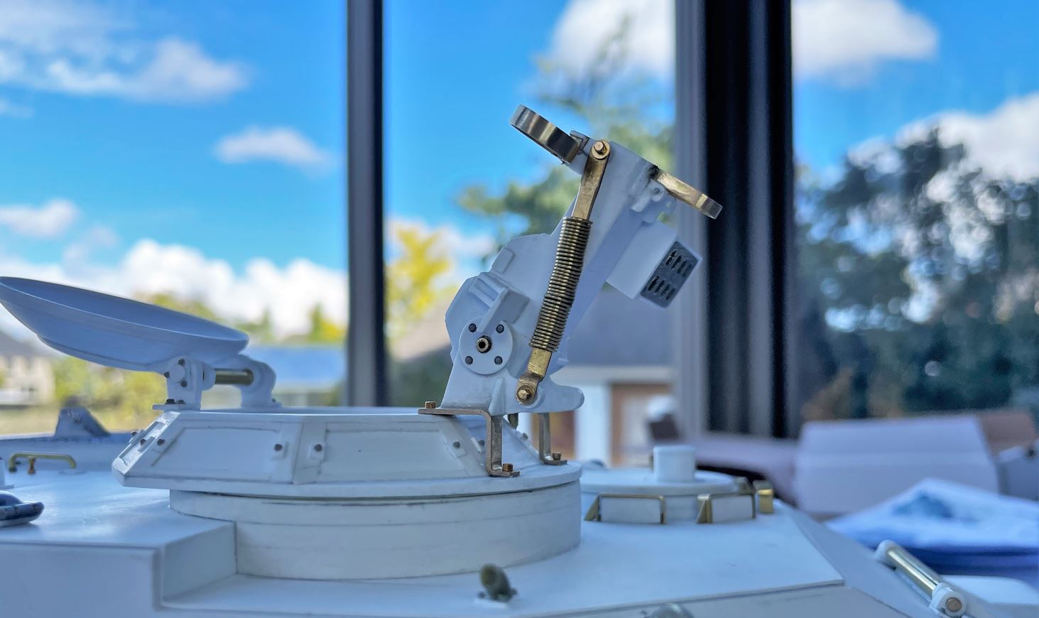

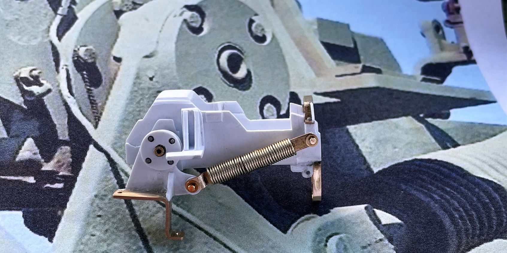

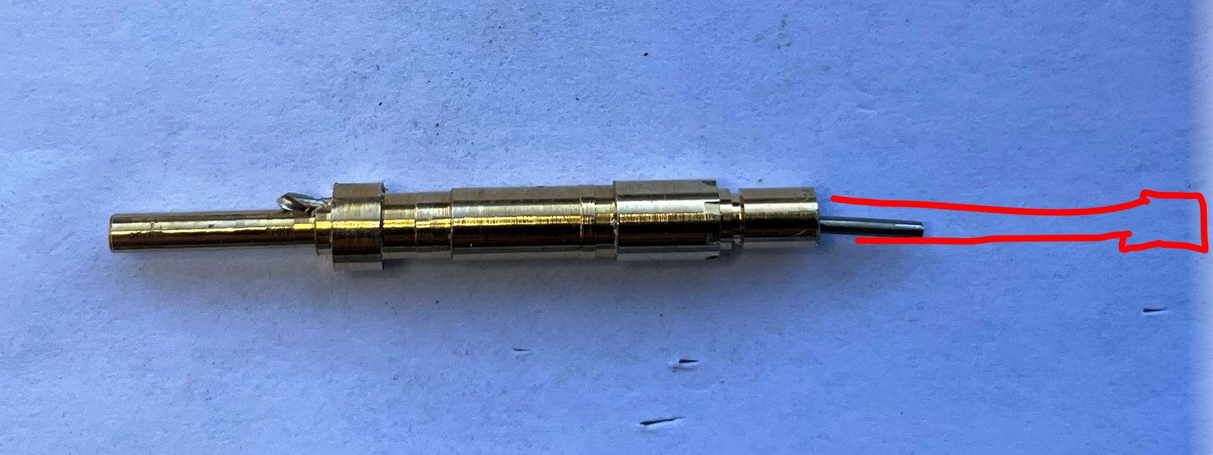

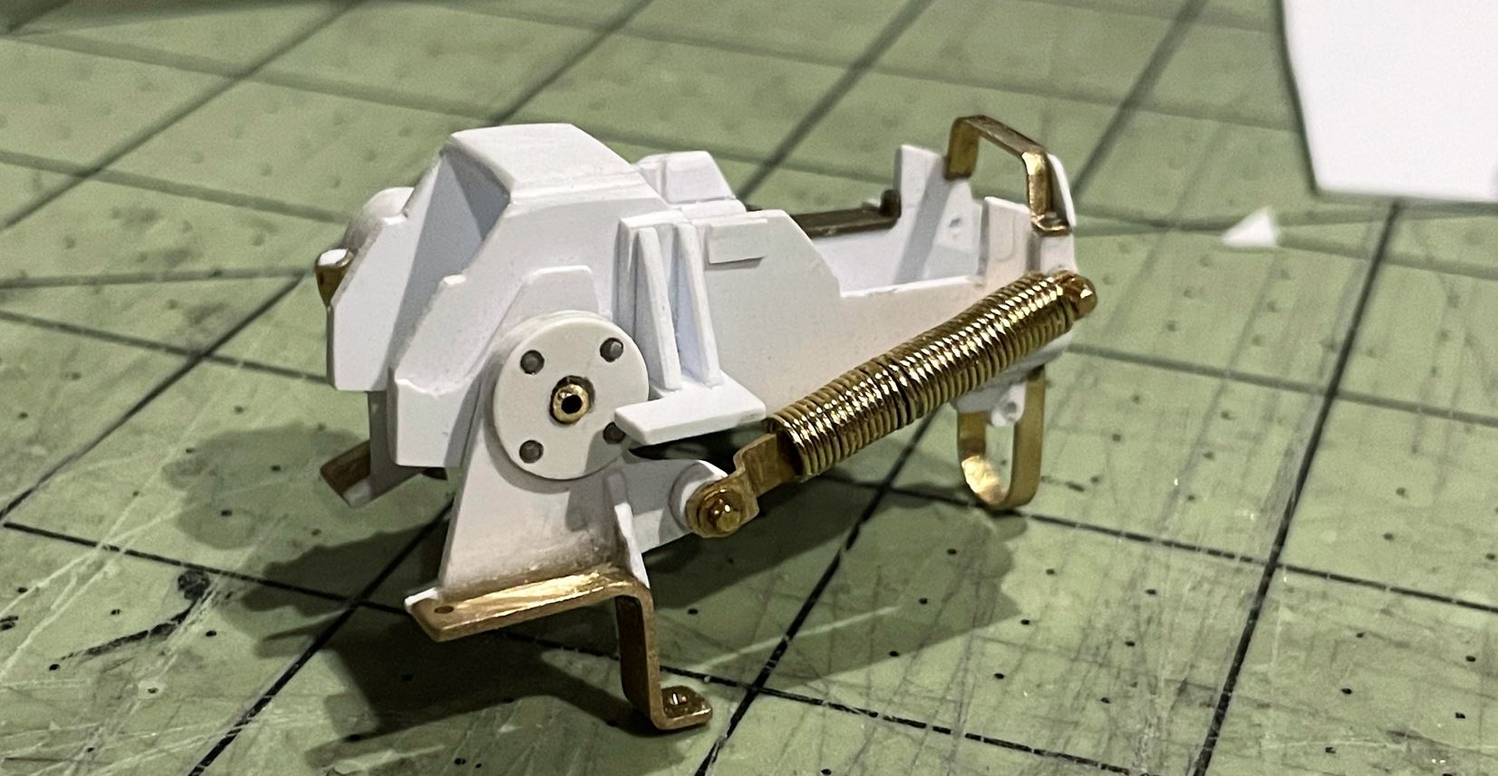

The gun mount is almost completed, minus the small sights that are too fragile to install at this time. I am also finding new stuff to add on the mount all the time, so it will be further improved.
The mount will be given servo elevation with a push rod, not yet installed.

Overview of the mount without the machine gun, a common sight for Lynx base monuments.
Starting the Browning M2. It will be given flash. Shown here are the parts assembled for the build, including Tamiya M2 and Aber PE update set and ammo. I have built these so many times in previous builds, I will just make a short summary here.
As the Aber barrel is solid brass, i cut the thin section for replacement by a thick wall brass tube of the same size. As for the remaining section, it is drilled in order to install a fiber optic cable. Notice where the micro bit exits, this is calculated in order to orient the fibre towards the embedded LED inside the machine gun.
A new barrel is created in brass tubes of 3 overlapping sizes, and will be connected to the larger ABER section. The barrel was shaped with a nail file and then polished.
This is the new barrel ready for mounting on the Tamiya M2 body. The connection between the two barrel sections was done with superglue mixed with brass dust.
The LED is installed inside the Tamiya main body, and the fiber optic cable is connected to the LED. A small hole was created in the LED plastic without touching the LED element. The LED wires exit from the bottom of the machine gun. Everything is thoroughly tested before sealing the Tamiya M2 body.
And here we have a fully enclosed, LED armed Tamiya/Aber M2 Browning machine gun.

Overview of the M2 Browning. It was fully enhanced with Aber PE.
The Browning is temporarily deposited on the gun mount for further planning. Looking good.
