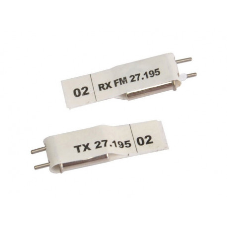

tankme wrote:You are going to have a lot of fun trying to find out which radios go with which tanks...

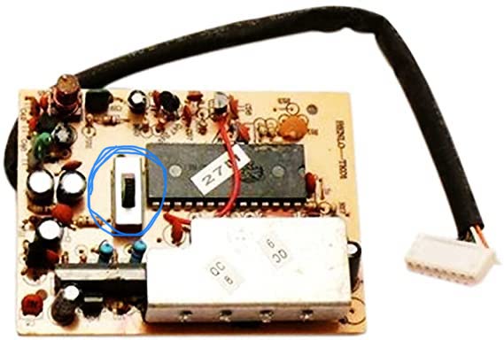

No, it should be quite simple, it's 27 Mhz, and in principle there is a (white) label on the chip (quartz) and check that the emitter is the same as the receiver. Be careful, it existed at the very beginning, old enough, a system with a 3-position switch, to change frequencies, both on the transmitter and the receiver, from memory? ABC
like this
Transmettre HL 27 MHz avec quartz
Quartz 27Mhz
Récepteur 27 MHz HL

That was, indeed, impressive John1970. Cschaffer: I speculate that many of the tanks you have are earlier HengLong tanks with batteries that fit in a box closed by a single screw and 27MHz electronics using "chips" of quartz.
