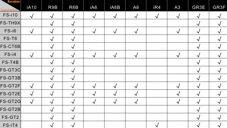

i dont know if can help? found this on youtube, and on the net the different
Flysky 'transmitters and receivers compatible with each other, good reading
https://www.youtube.com/watch?v=9-Z0rTVEkHI

Thank you Jofaur: good idea to check a compatibility chart, and I thank you for your troubles. I had a compatibility chart printed out on the modeling table. The FlySky I have is an FS-i6 and. as the chart you found shows, it's compatible with the iA6 and iA6B receivers. I have no reason to doubt compatibility. (I did buy the iA6 receivers on eBay, so I suppose it's possible that they were both kaput from the outset, but it seems unlikely: the seller has a longstanding, good reputation and I have no reason to doubt it.)
