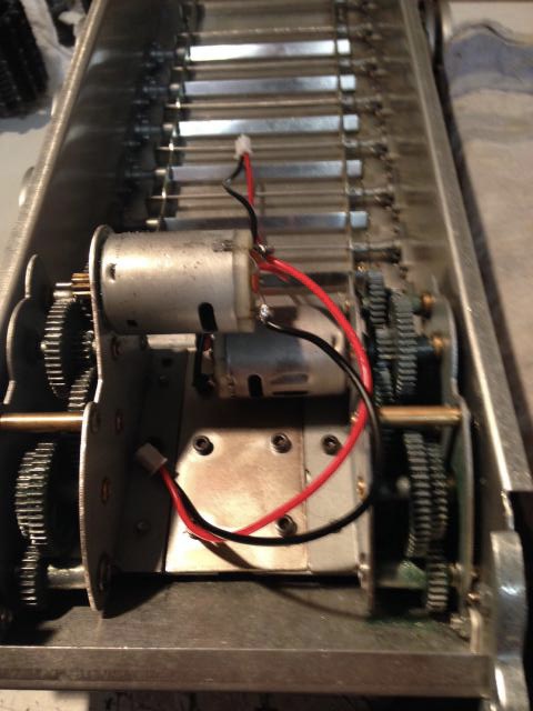

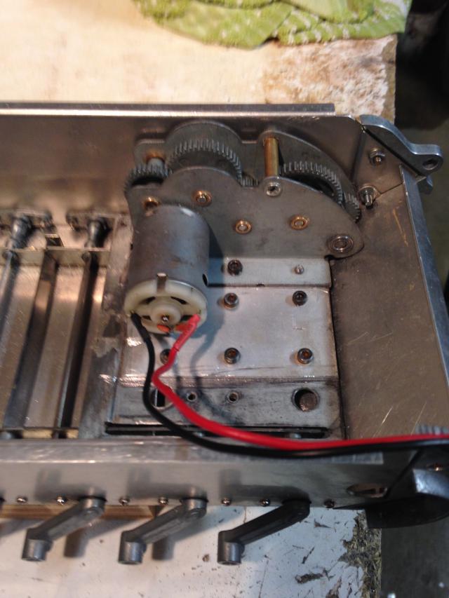

:thumbup: Everything to your credit .... if I understood correctly, the existing boxes are no longer functional? the tracks are in principle plastic, if original?
here are some pictures that I had taken for my KT Tam.
original Heng Long support, cut in the middle and lengthen by aluminum 1.5 mm
The worries ? is that the tamiya axis has 2 m?flats for the Sprocket, and HL 1 only? then either make (with a file) the second flat, or use HL sprockets if compatible with existing tracks? in my case the metal tracks from RC Tank.de, work with Tam toothed wheels.
on the other hand, it is possible for you to keep the existing system of rotation, and elevation, you will just have to adapt the connection on the plate.
