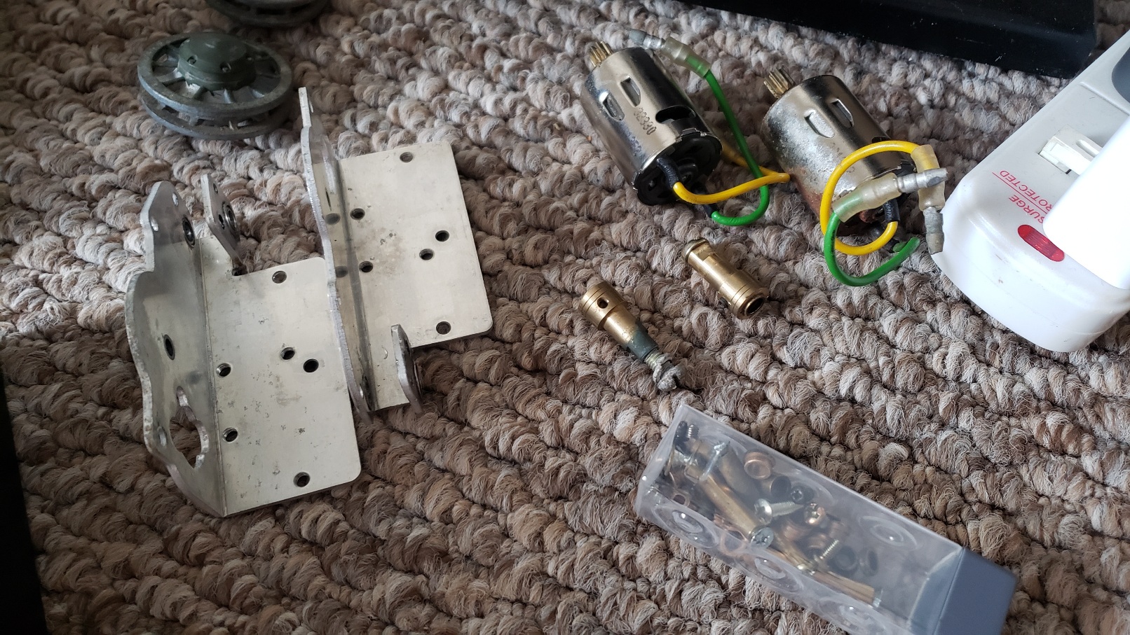

Tamiya boxes stripped ready to form the bases for HL boxes.
I shall evaluate the motors once I have the HL electronics etc.

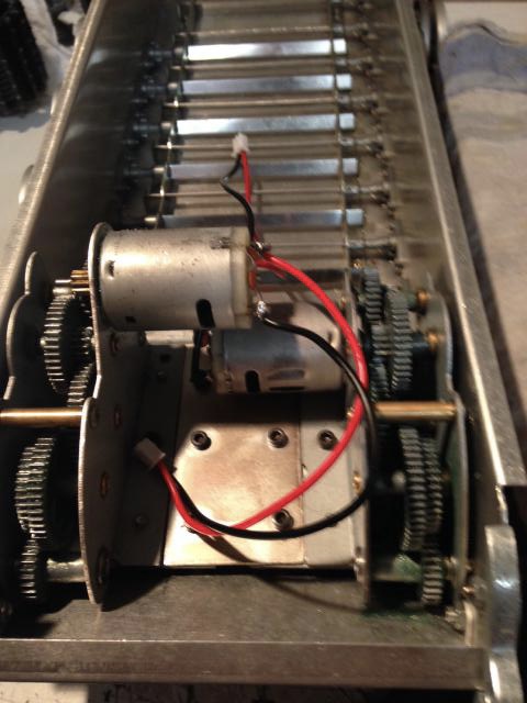

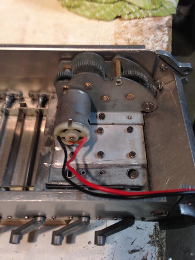

Personally, here is what I had done on a KT Tamiya, adapting HL engines,

Nope. You continue to underestimate me sir. I plan to use the shells of the Tamiya gearboxes as platforms to mount the HL gearboxes on. I will probably have to cut them down in places to adapt them but thats cool.
Makes for a similar method to your ingenious work on your own conversion.

The gearbox swap looks to be fairly simple. I have some threaded brass tubes/supports from the original boxes that can be cut down to form spacers between the floor of the tank and gearboxes.
