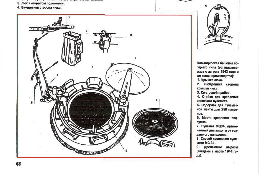

Topper wrote:Thanks jarndice
I would have never of though of that, can you tell me how the MG42 is attached please?
on the cupola in place currently there was no MG, on the other hand on the one under plastic there is above the Episcopes a Rail or a sliding part was fixed
we can also see on this photo, the MG support raised (red arrow)

Re: Taigen late war Tiger 1 build
If you goto www.forgebeartanks.com you will find a Tiger 1 LATE metal cupola with an MG42 and its mount for £9.99.

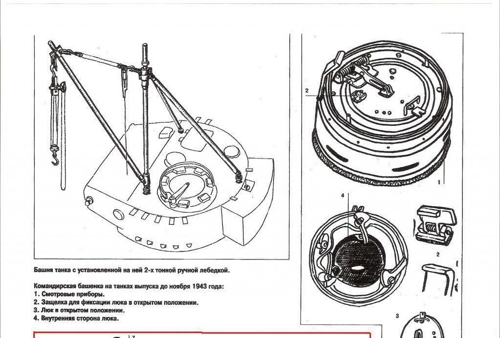

For infos…

:( also found this? can be said a nonsense?,
Posts: 8470
As you said earlier Jofaur there was not an official mg mount for the Tiger 1 early but lots of pictures show them with Cupola mounted MG34s, These were all conversions that were engineered by forward workshops at the urging of Troop and individual Tank commanders,
Some were really well carried out whereas others were quite simply a Bodge. Your pictures clearly show the difference :haha:

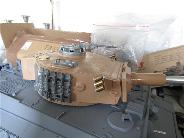

Tiger gun 001 (600 x 450).jpg (51.71 KiB) Viewed 1478 times

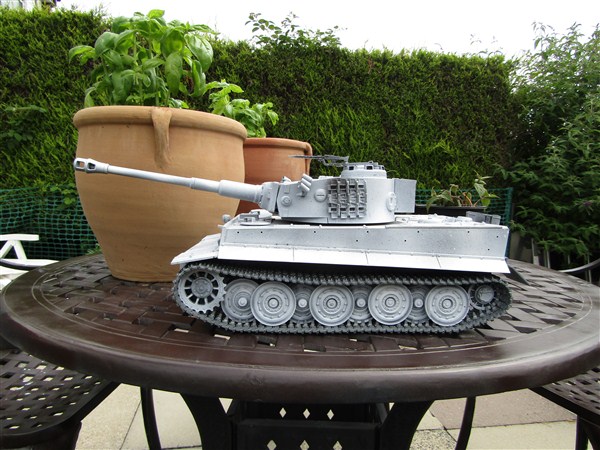

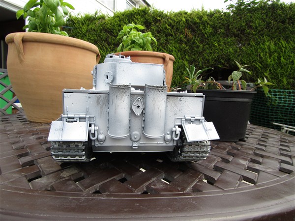

Hello
90% done,
Tiger 1 late war 001.jpg (77.47 KiB) Viewed 1452 times
winter tiger 003.jpg (84.99 KiB) Viewed 1452 times
winter tiger 001.jpg (94.28 KiB) Viewed 1452 times

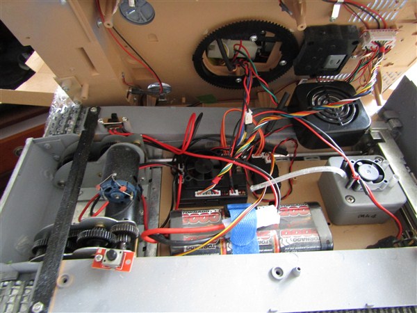

Thanks
Have you ever come across the smoker in the pic? it did not come with instructions, I cant get it to work, I connected the plug to the taigen unit but there are 4 other wires which I do not know what they connect to.
Thanks in advance
Frank
Posts: 8470
Your smoker looks like it is a "Tarr" unit,
Do you have a Taigen V3 control board in your Tank?
Tarr Smokers will not work with a Taigen V3 board,
Also if you decide to use an aftermarket transmitter with a V3 board the hull MG will not work,
The answer is fit an aftermarket control board such as an IBU/ELMOD etc and receiver and your Tank will be transformed.
