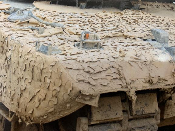

I haven't been totally satisficed with my rendition of Barracuda mobile camouflage.

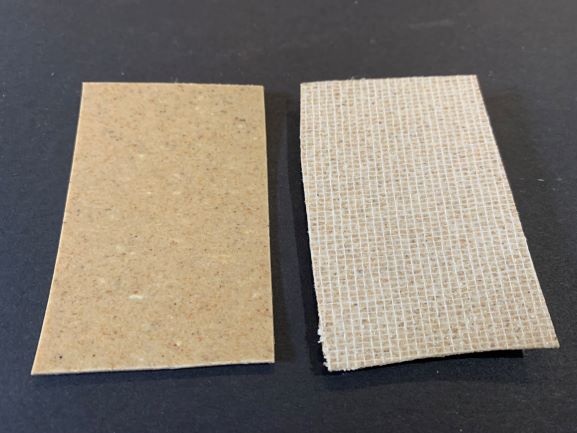

My original test pieces used a thermoplastic sheet with an embeded structural mesh. I've now sourced a version of the thermoplastic sheet without the mesh.
Thermoplastic sheets
themoplastic .JPG (38.51 KiB) Viewed 3072 times

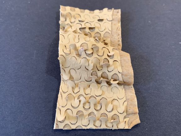

Not only is the sheet noticeably thinner but has a putty like consistency when heated. Because the heated sheet is quite sticky , I tried pressing the garnish directly onto the soft plastic. This has worked nicely and has eliminated the need to use glue.
MCS test
MCS test
Because this type of sheet doe not have the structural mesh, it also conforms more snuggly to curves and sharp angles. I think I will get to something close the original. The thermoplastic sheet itself will also accurately replicate those areas of high crew traffic where the garnish has completely come away from the heat absorbing material.
MCS applied to the Leopard hull

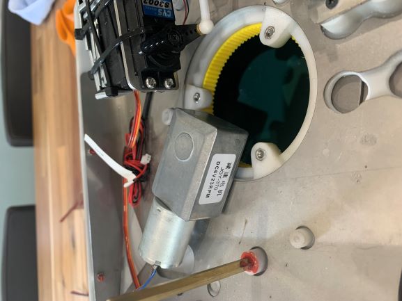

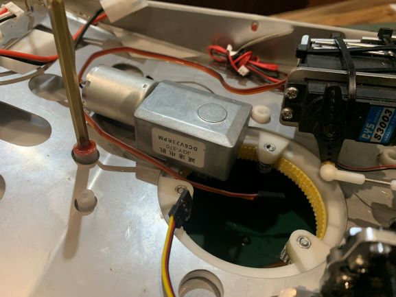

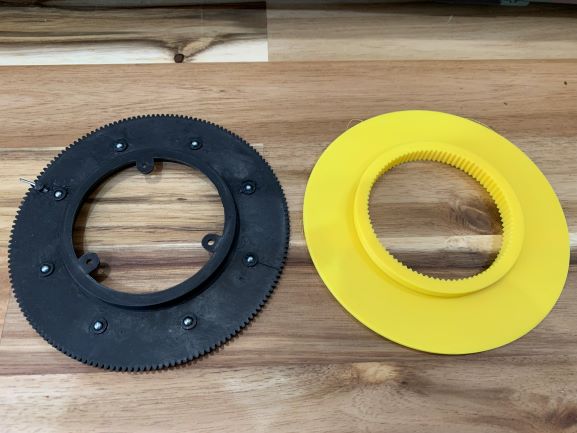

Moving the turret drive.
I had some time this weekend to move the drive from the hull to the turret itself. This will let me use an IR link from hull to turret rather than a slip-ring.
Moving the drive motor wasn't too difficult but switching the turret drive gear required printing a new part.

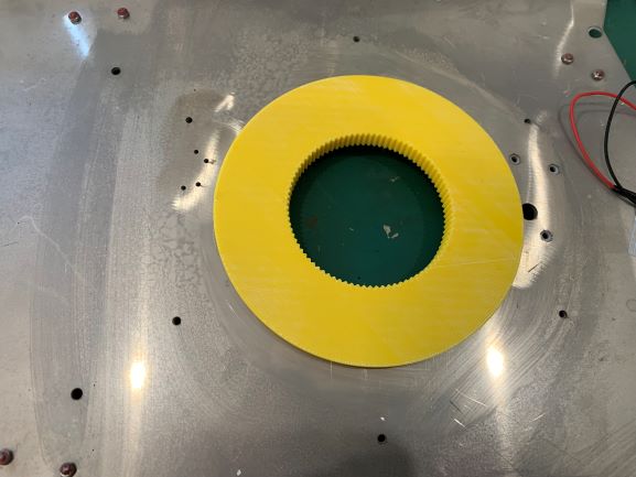

Original turret drive gear (in black) and new drive gear.
The new part in place

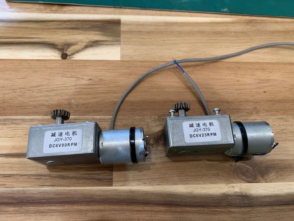

Turret and elevation drive motors and reduction gearboxes.
The new turret drive arrangement

After some test runs, and I made some rollers for a more secure fit of the turret into the race.
Rollers added to the old turret gear attachment pints. The rollers hold the turret in place and prevent any wobbling during traverse.

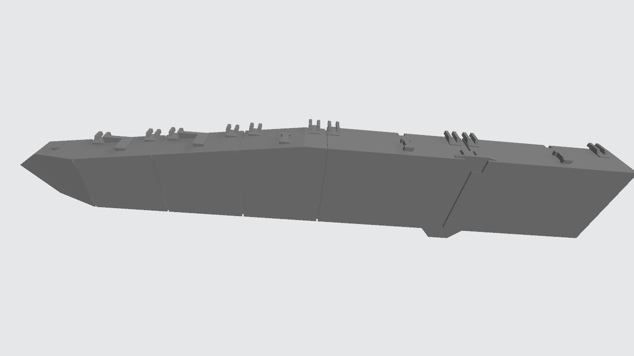

Howdy, some progress on the 3D models for the conversion Leopard 2A4 to 2A4M CAN.

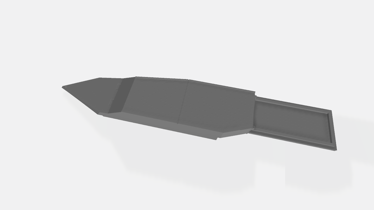

Hull Armour Left Side
Hull Armour LH.png (26.74 KiB) Viewed 2960 times

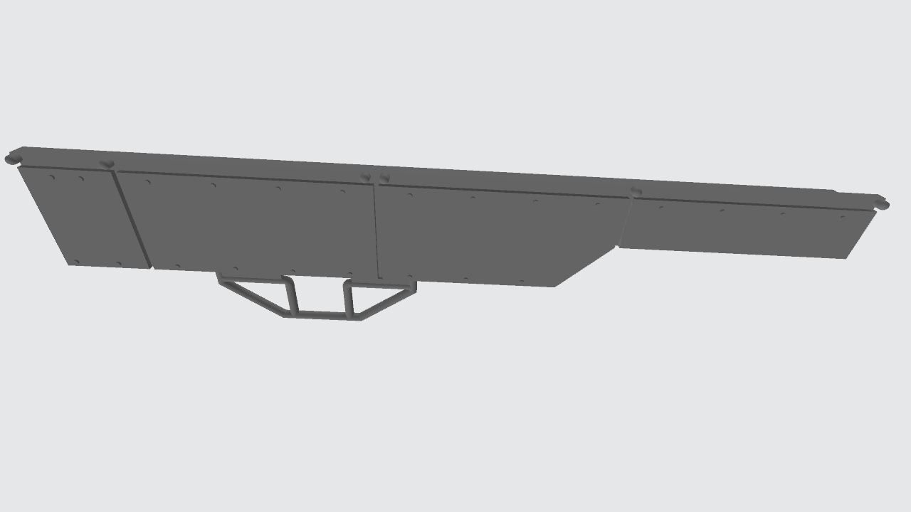

Left Track Skirt
Left Track Skirt
Skirt LH.png (21.85 KiB) Viewed 2960 times

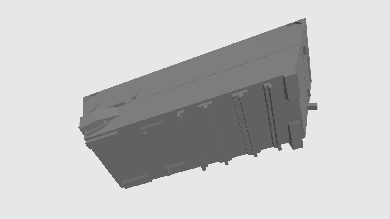

Turret Bustle.
Turret Bustle.
Turret Bussle.png (32.44 KiB) Viewed 2960 times

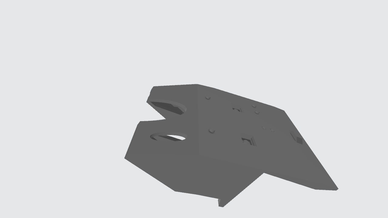

Turret Spaced Armour Left Side
Turret Armour LH.png (65.02 KiB) Viewed 2960 times
All the 3D models are ready for printing, and I have sent the first batch for the turret conversion to the printers.
I haven't been happy with the new turret drive arrangement, so I have made some modifications to the drive gear. I'll be re-installing the drive at some point this weekend.

At the moment, I have had a small challenge crop up in the turret drive alterations. Out of the box, the turret is held in place by turret drive "cog" - same layout as most Heng Long models. Moving the drive into the turret has meant not having the turret held in place by anything other than turret race and ring. Because there is some play at the moment between the ring and race, the turret jitters on traverse. I think the issue can be fixed by fitting some tiny roller bearings which should fix the problem.
Re: Hooben 1:10 Leopard 2A4 build log
For the turret, you could try to create some sort of turret basket with a large rod at the bottom center that anchors on a ball bearing at the bottom of the hull and that keeps the turret firmly in place when it rotates.

Now that's a very good idea - thanks!
