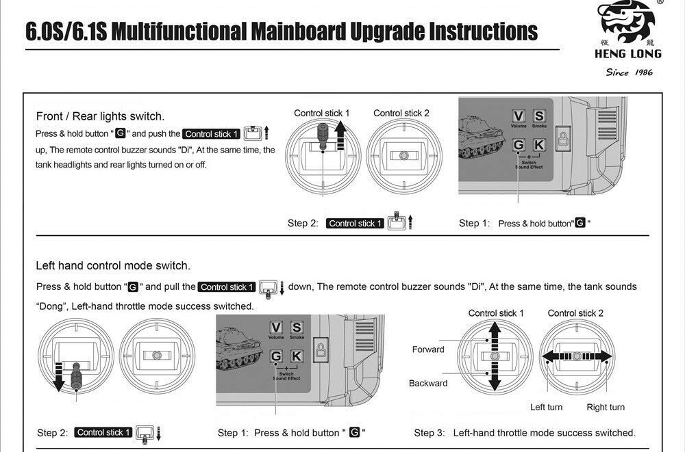

abramsky wrote: Wait a minute ... But you can turn the lights on / off separately (back and front) in TK 6.1 ... Are you sure you have / are using version 6.1?.
Absolutely. With my HL 6.1S whatever is plugged into LED3 and LED4 is switched on and off together by the Joystick/button G command. Can’t find the reference (there is one somewhere), but that’s what happens.

abramsky wrote:
Weird. In mine it works normally in each of the 3 MFUs (6.0, 6.1 and 6.1s).
Try:
G + Left stick Up = front lights (each time stick up - turns the headlights on and off)
G + Left stick Down = rear llights (each time stick down - turns the rear lights on and off)
You will find it in points 1 and 2 in the manual TK 6.0/6.1 ...
Interesting - with mine...
G + Left stick up toggles both front and rear on and off
G + Left stick down toggles joystick control modes.
From reading posts on other forums it appears to be a ‘feature’ of the ‘S’ MFUs. I wish it didn’t work like that, as I can separate front and rear on my 6.0 MFUs, but I can live with it as I like everything else...
