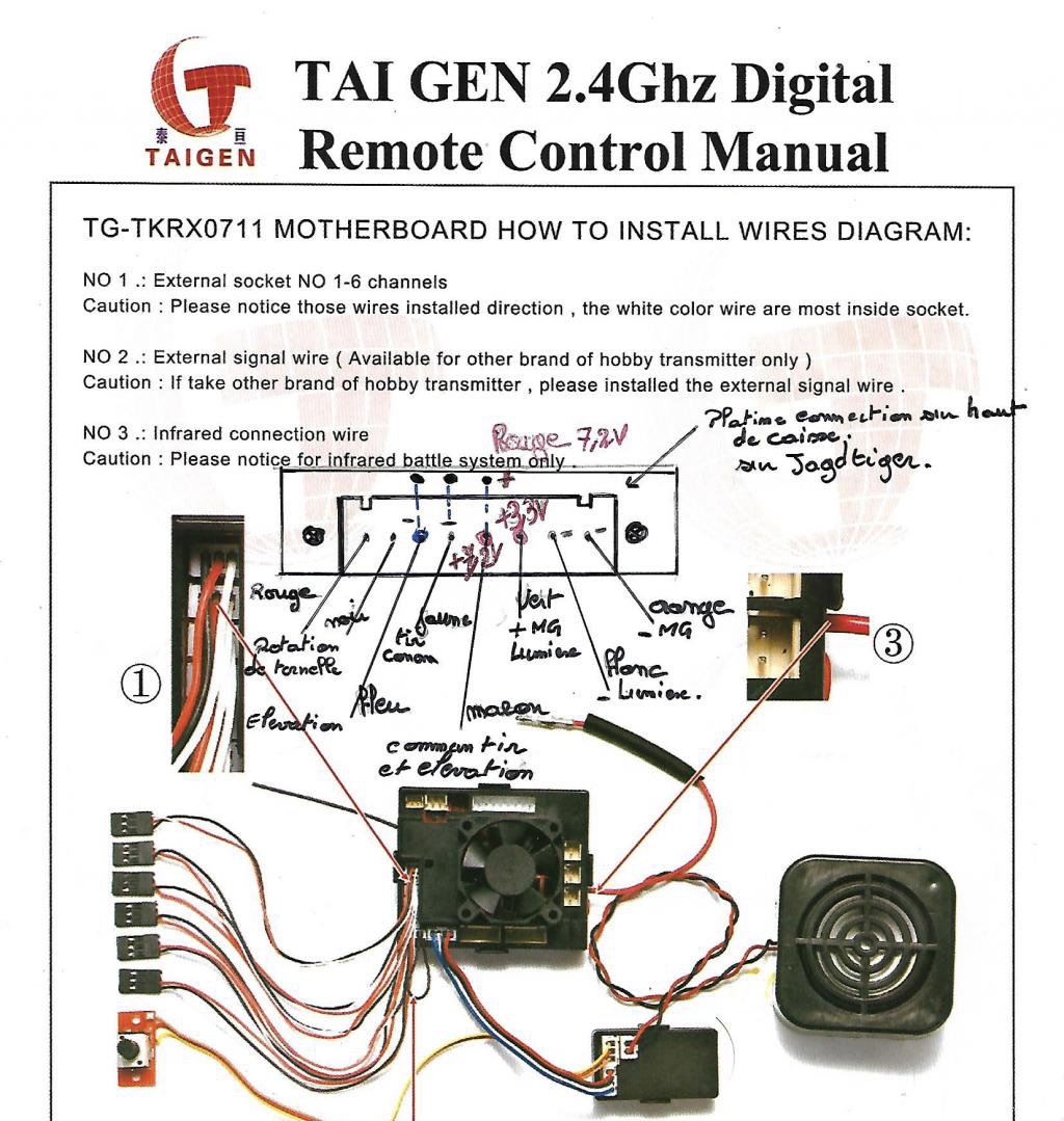

:D or am I surprised? this is why if one does not make a short circuit on an output, for what the MFU would burn out? following connection Led bad voltage? but not know everything. At one time I had found this for an RX 18 in 2.4 ghz
