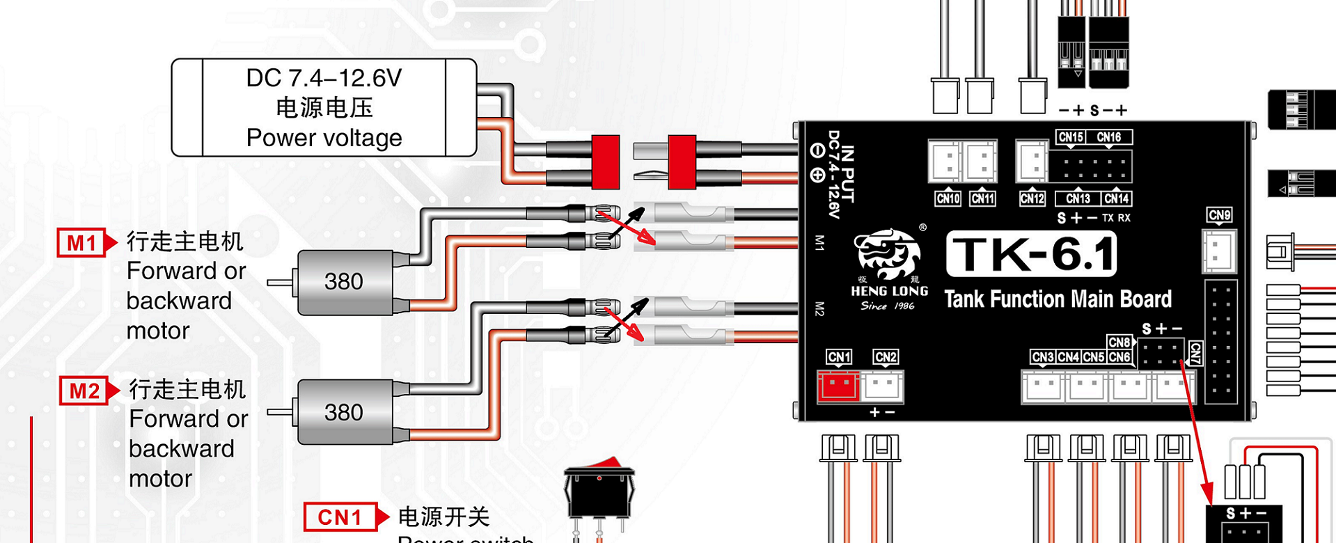

This is a standard problem with the HL MFU 6.0 / 6.1 . Wires are reversed
You need to connect the wires as I shown in the first pictures in this link. It should work fine.

abramsky wrote:This is a standard problem with the HL MFU 6.0 / 6.1 . Wires are reversed
http://rctank.pl/forum/viewtopic.php?f= ... ead#unread
P.s. You wrote earlier that you checked the entire suspension and drive system, so I did not mention that you should check by hand turning the tracks if there is any noticeable resistance. Pulling the tracks with your hand, the drive should not put too much resistance.
I checked and one of the suspension arms was out place pushing really hard against the right idler. I remove the road wheel and put the suspension arm back to its normal place. I think the binding is what caused the tank not to move forward or making the turns. But I am glad I exchanged the 6.0 motors for the 5.3 because I thought the gears run smoother on the 5.3. I could not open up the link of the photo. Can you please post the photo here. The only problem the reverse of the motors. Thank you ! Dai

And here is the picture you asked for:
