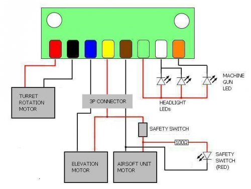

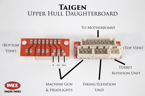

The worse thing about swapping to Taigen would be getting everything correct with the 8 pin plug at the main board and daughter board, and then in the turret. Everything else like motors, smoker and speaker would be self explanatory, although believe you need to swap the smoker unit.

Looks like I've ordered the wrong board, mine has 8+3+2 but I can directly wire the head and machine gun lights so thats not a problem, what I dont understand is my tank has 4 wires for the BB firing unit and the taigen only uses 3, I imagine one from each plug has to be connected together giving 3, but no idea which ones to join and there is no safety switch anywhere. I have bought a Taigen smoke unit so thats one problem solved. Also, I dont understand where the 3 pin channel wires go or are they not needed?

There is something somewhere about eliminating a fourth wire.
As for getting the wrong daughter board. You may not have, these bloody things have changed a few times, it's hard to know whether we're coming or going.

Looks like the Taigen elevation and BB gun share a common live at that plug.
