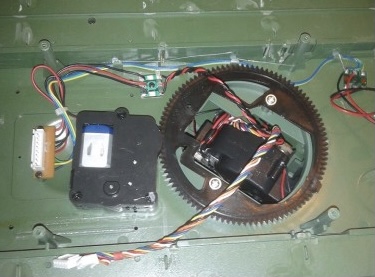

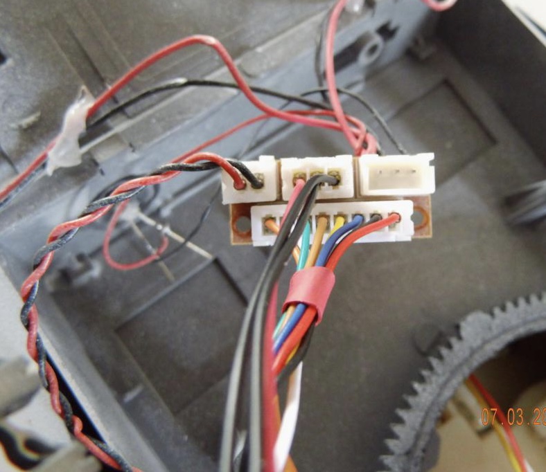

Would it be possible to have a photo below the upper frame? In order to see existing wiring ?the are several types .....
Jofaur86
Posts: 2216
Location: Centre France
Re: HL to Taigen swap
Post by Jofaur86 »
Like this

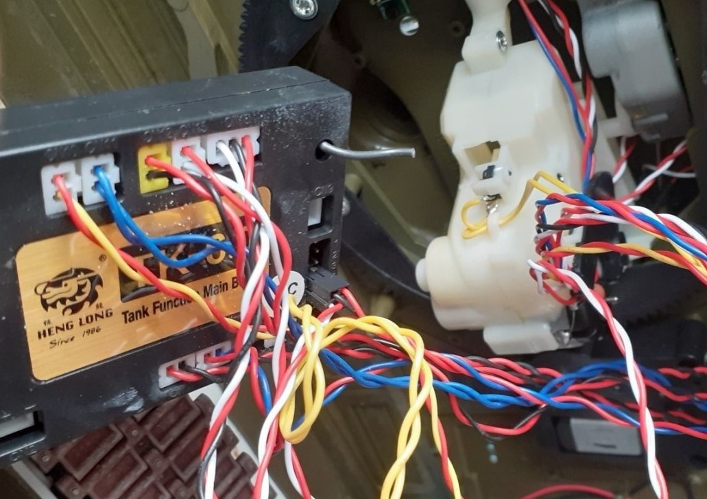

Everything in the top hull is directly connected to the main board, no upper hull board. I have bought an upper hull board with 8+3+2 pin plugs and a cable set, just have to figure out what goes where!
