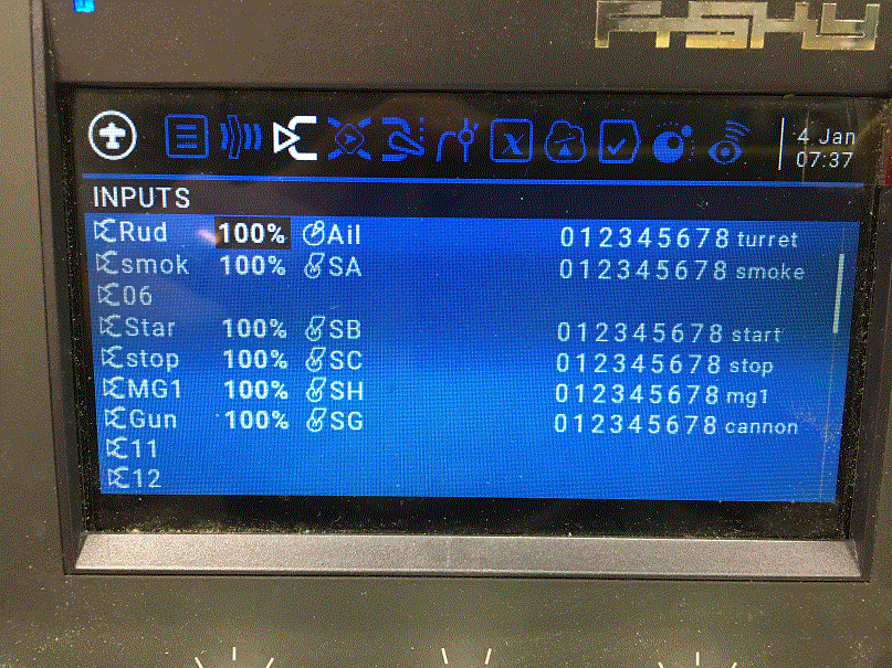

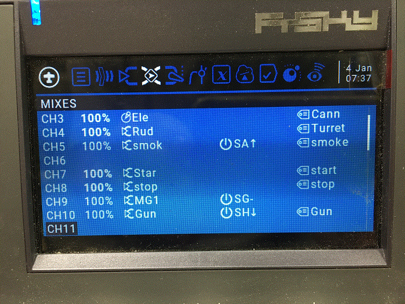

It would be great to get the mg sound back, how did you manage do it?

My Input page
My Input page
Here are some shots of my screens.
Mix page
Mix page

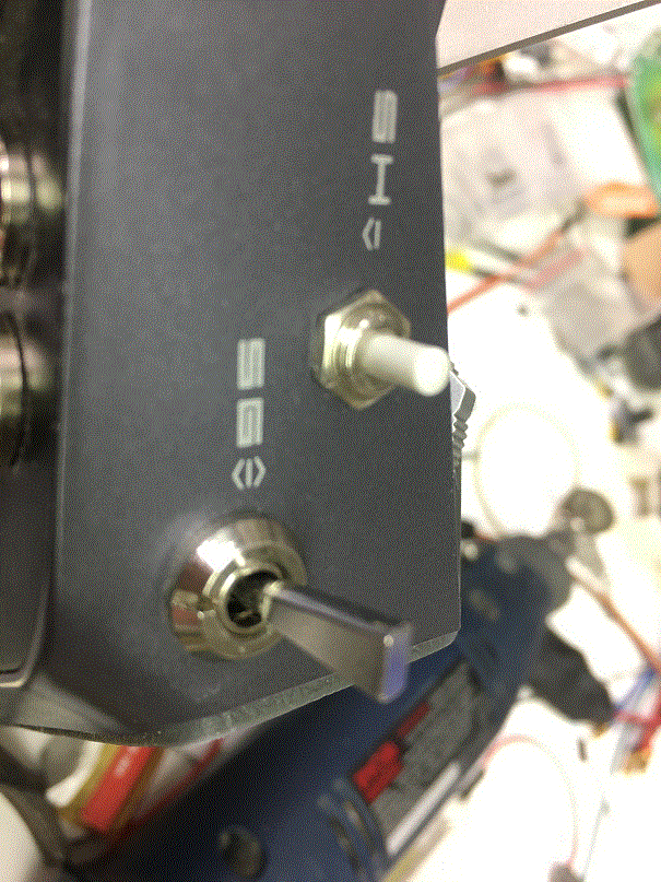

Momentary switch.  This I added to my radio.  It is a cell phone style that has a nice trigger feel.  I can find the link to where I bought it later
I am able to get my smoke and all three guns to function on my radio. If I left something out please feel free to ask questions. OpenTx is a real headscratcher sometimes. Sometimes I don't even know how I got to where I was that made it work.

Many thanks for that, I’ll give it a go.

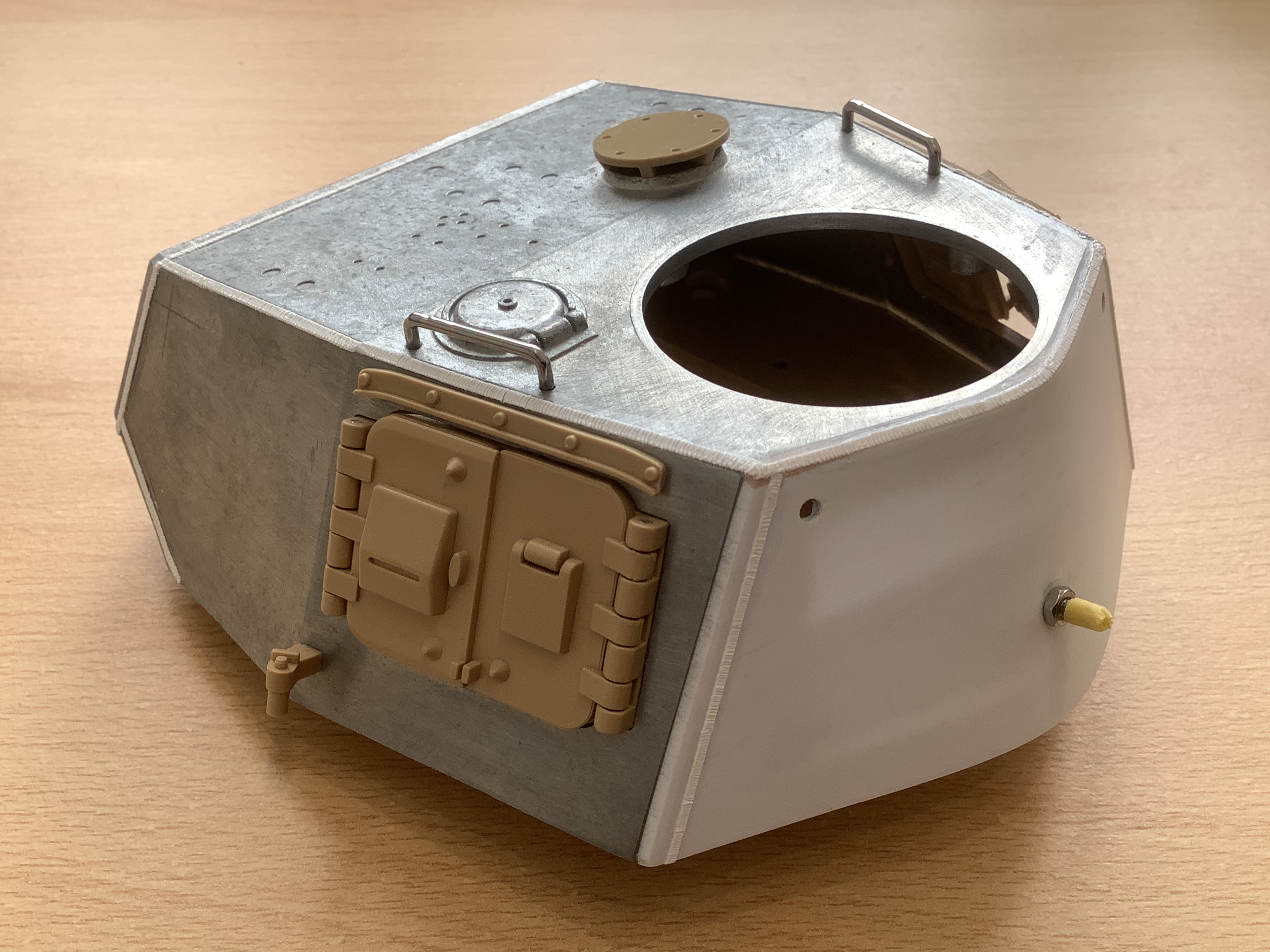

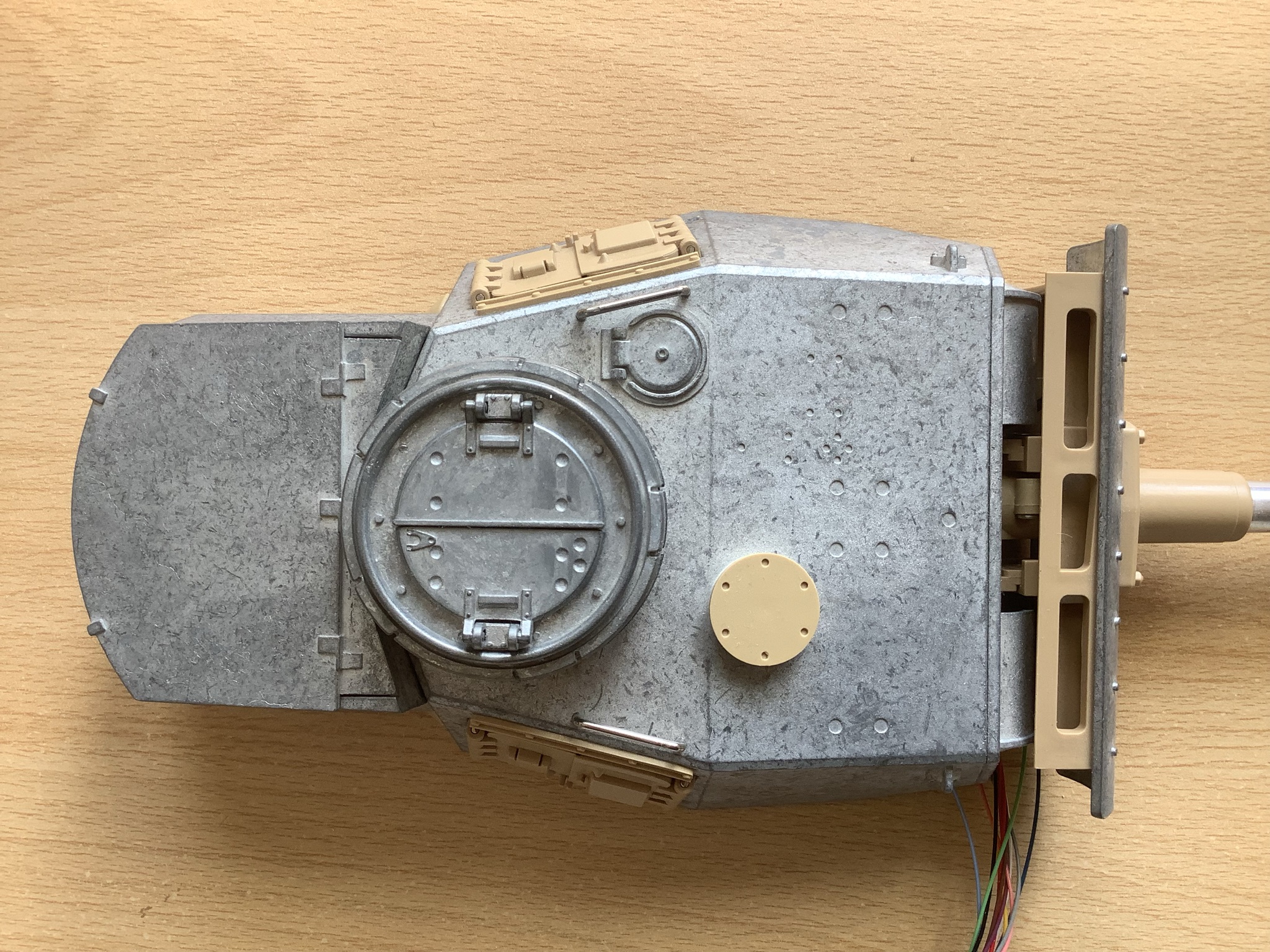

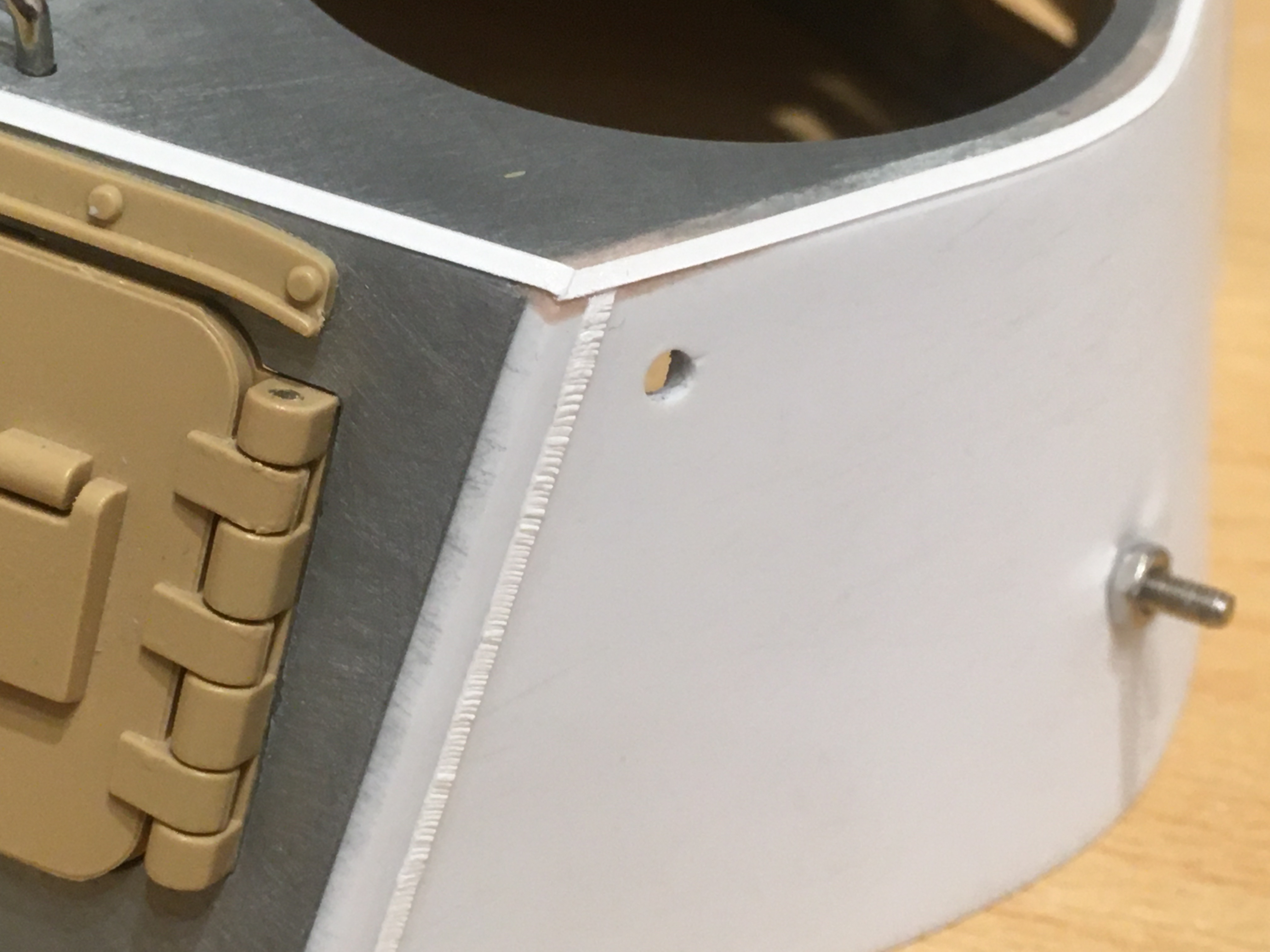

I couldn’t use Milliput for the weld seams on some parts of the metal turret, so I had to experiment with various options. I found that using very thin strips of plastic card superglued in place worked well. After glueing in place I softened the plastic with liquid cement & then added the weld pattern with the brass tools I’d made.
Weld Seams Turret Front RHS
Weld Seams Turret Front LHS+Top
See top edges of turret - the thin plastic strip added for the weld seam before applying the weld pattern with the brass tool.
Weld Seams Turret Front 1/4 RHS
See top edges of turret - the thin plastic strip added for the weld seam & then after applying the weld pattern with the brass tool.
Weld Seam Turret Front 1/4 LHS
Weld Seams Turret Rear 1/4 RHS
See top rear edges of turret - the thin plastic strip added for the weld seam before applying the weld pattern with the brass tool.
Weld Seams Turret Rear 1/4 LHS
See top edges of turret - the thin plastic strip added for the weld seam after applying the weld pattern with the brass tool. Turret storage bin attachment points.
Weld Seams Turret Rear+Top+Storage Bin Attachment Points
Weld Seams Turret Rear LHS+Top
Turret lifting hooks (before cleaning up)
Weld Seams Turret Lifting Hooks (Before Cleaning Up)
Turret lifting hooks.
Weld Seams Turret Front RHS+Top
Weld Seams Turret LHS+Top+Storage Bin
Completed turret & storage bin.

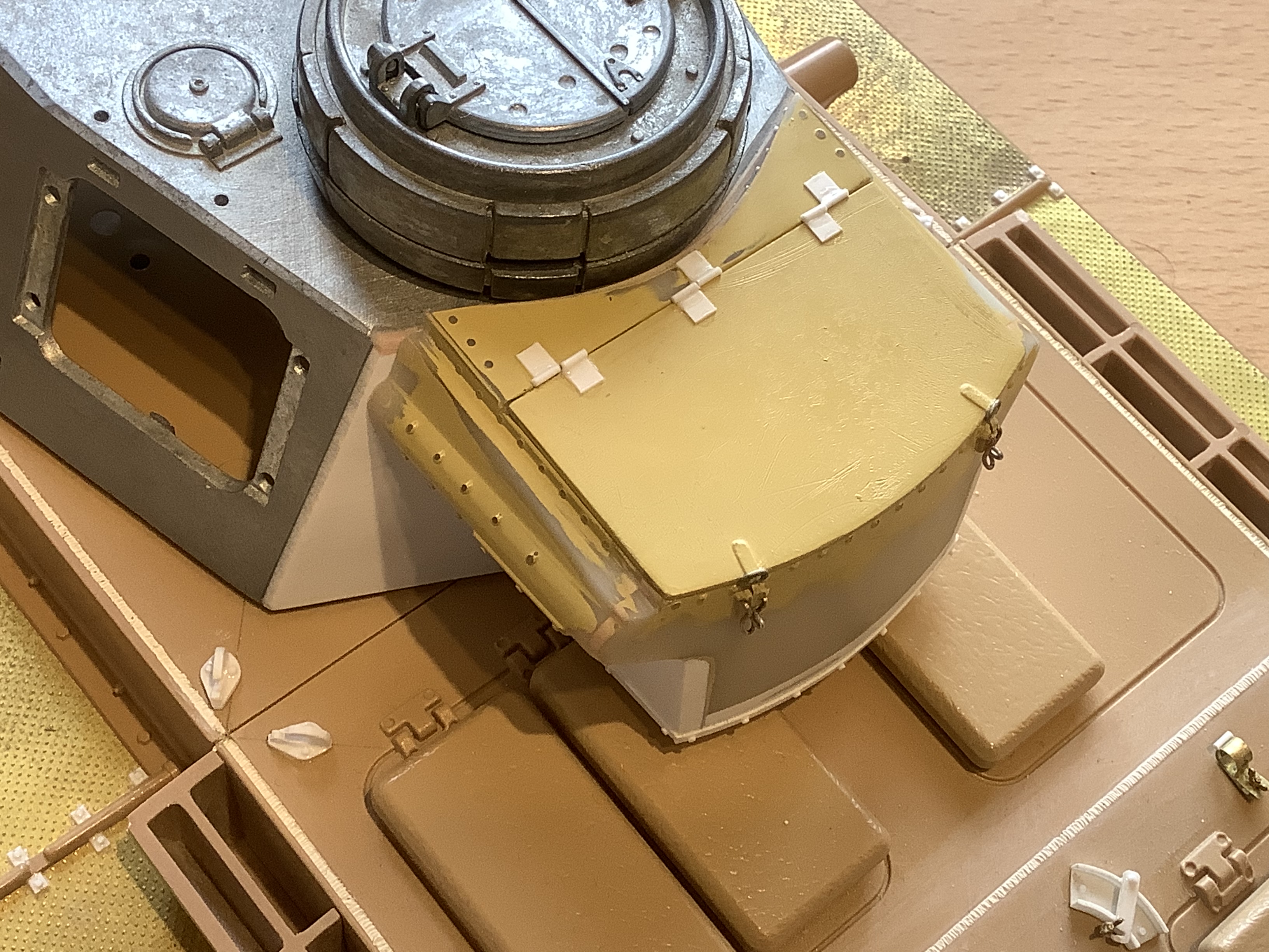

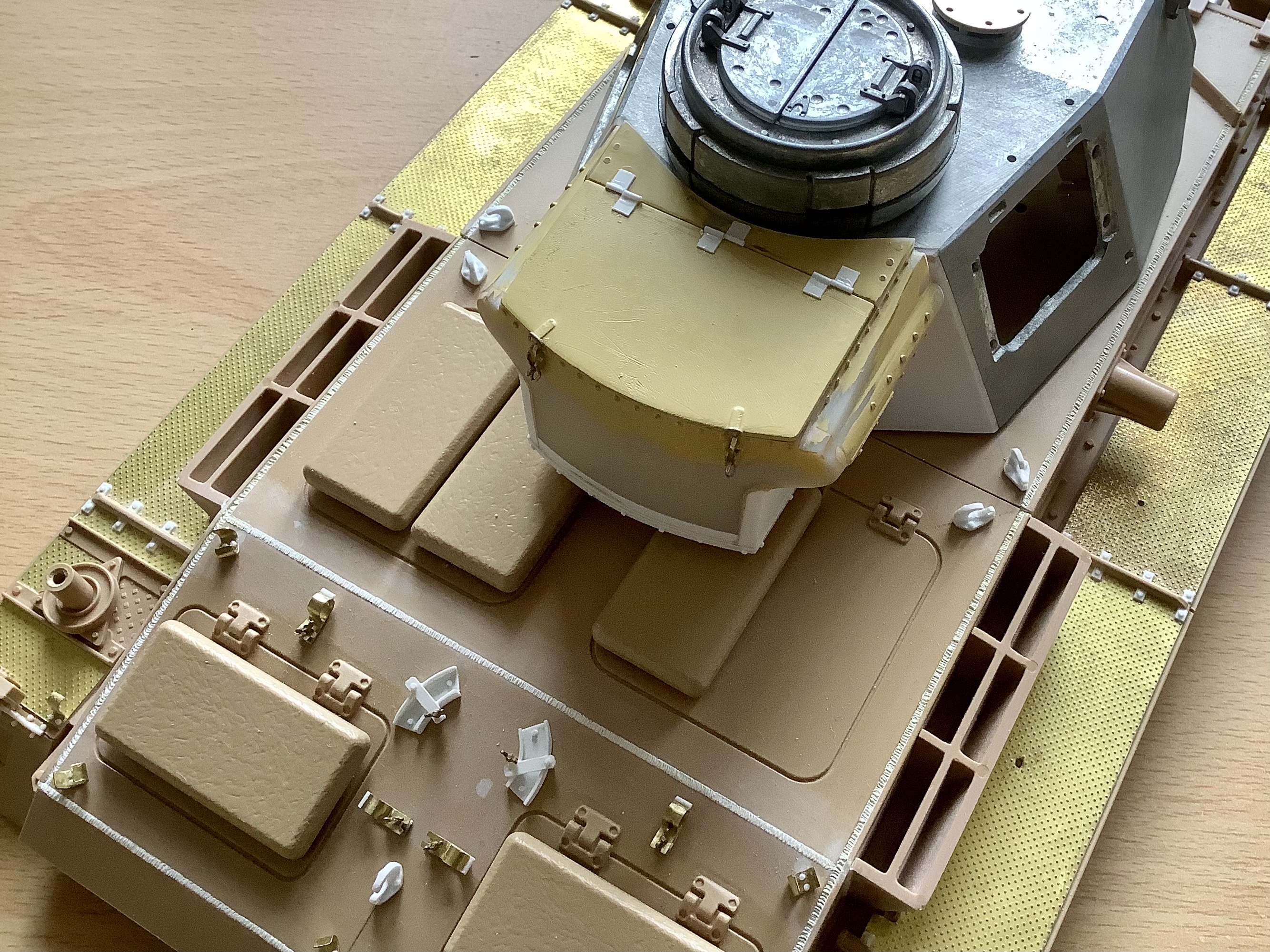

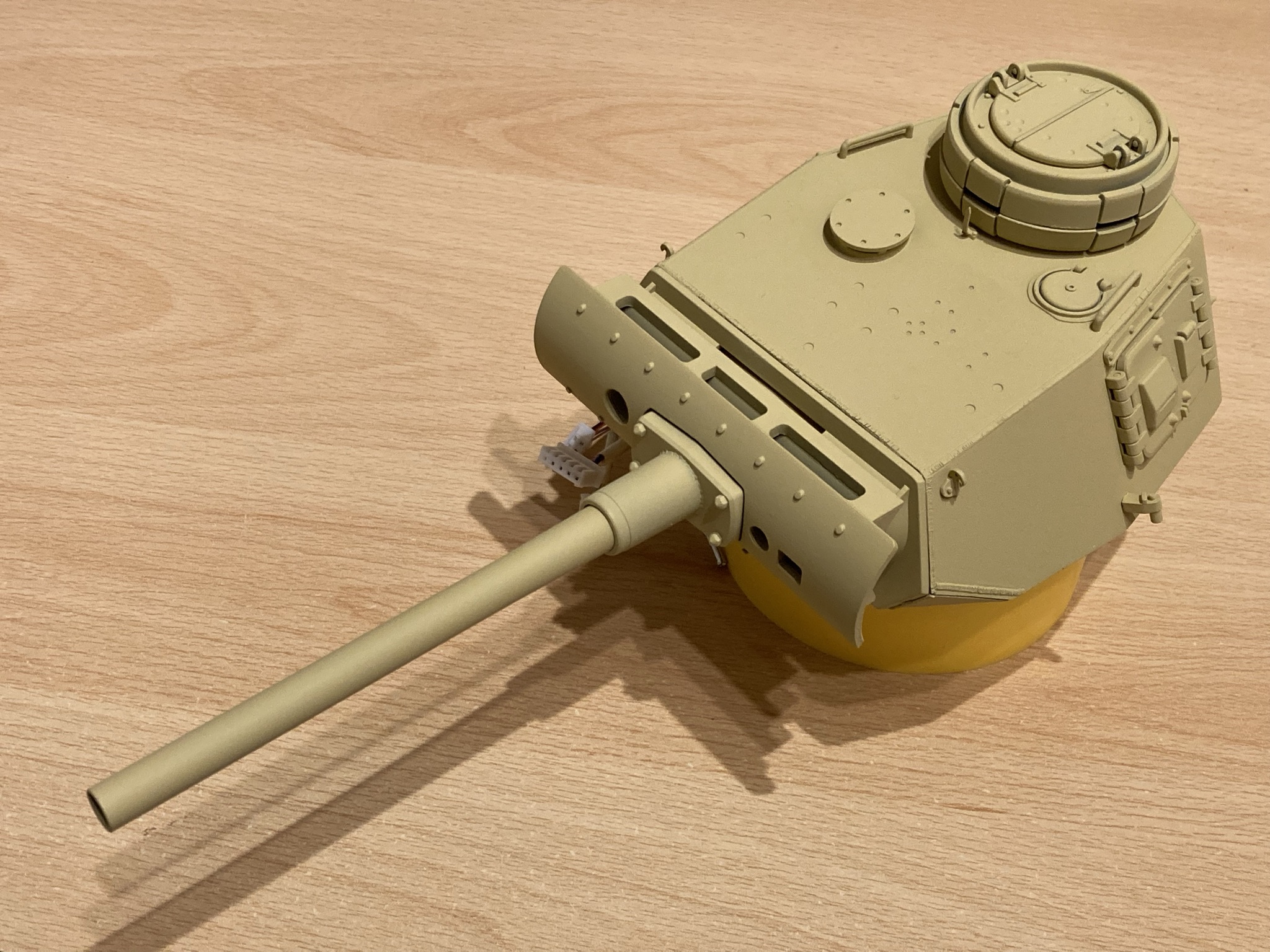

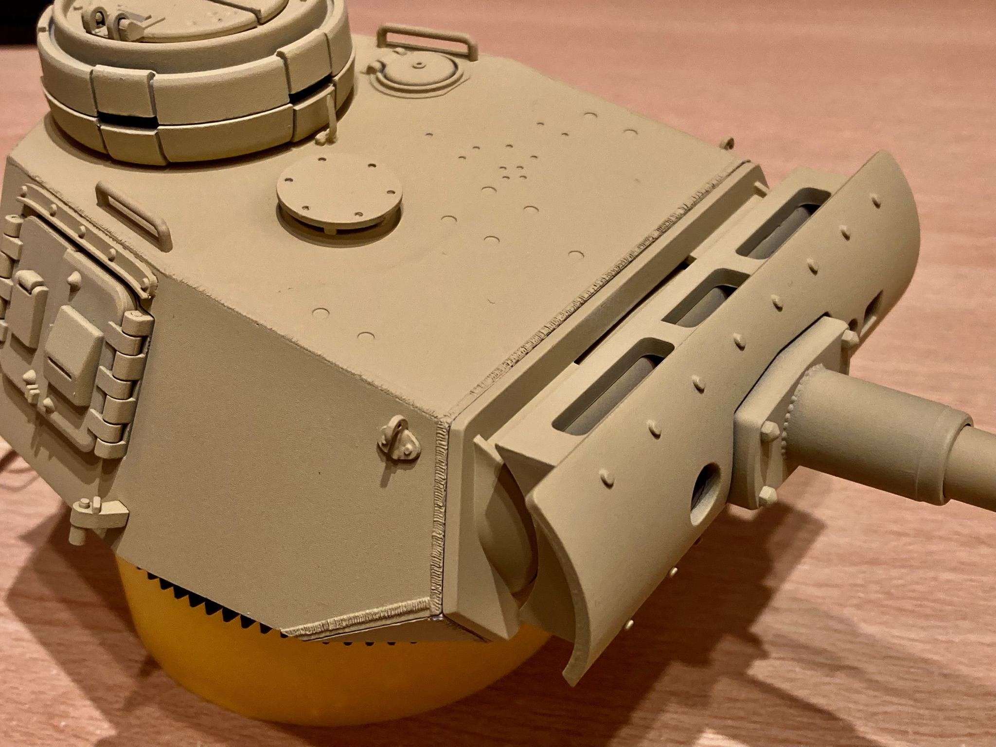

Correcting the problems with the gun mantlet:.
The gun mantlet didn’t sit quite right or line up correctly, also with the top of the mantlet left open & the elevation mechanism on view the model looked unfinished. I decided to correct the alignment problem & also improve the appearance by making a cover to replicate the top of the mantlet in order to close up the opening.
It looked like a quick & easy job!!! :haha:
As it turned out correcting the alignment wasn’t to difficult, but I found it quite challenging to get the cover to fit correctly & not interfere with the elevation mechanism. The cover turned out to be quite complex, as it had to be hinged at one end & be able to slide in order to allow the gun elevation to still work correctly, after some perseverance & some trial & error I managed to get it working ok.
I can now see why Taigen left the top of the gun mantlet open. :lolno:
For photos of the completed mantlet please see my later post (19 Nov 2022)
Please see photos below:
Unfinished Open Top Gun Mantlet

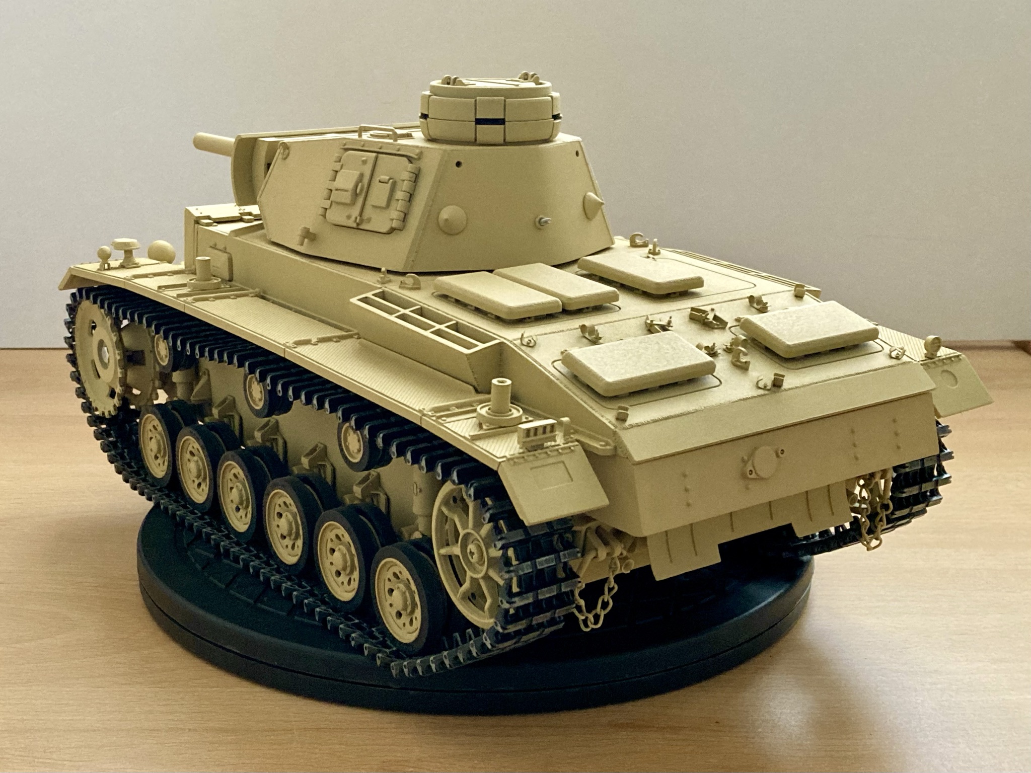

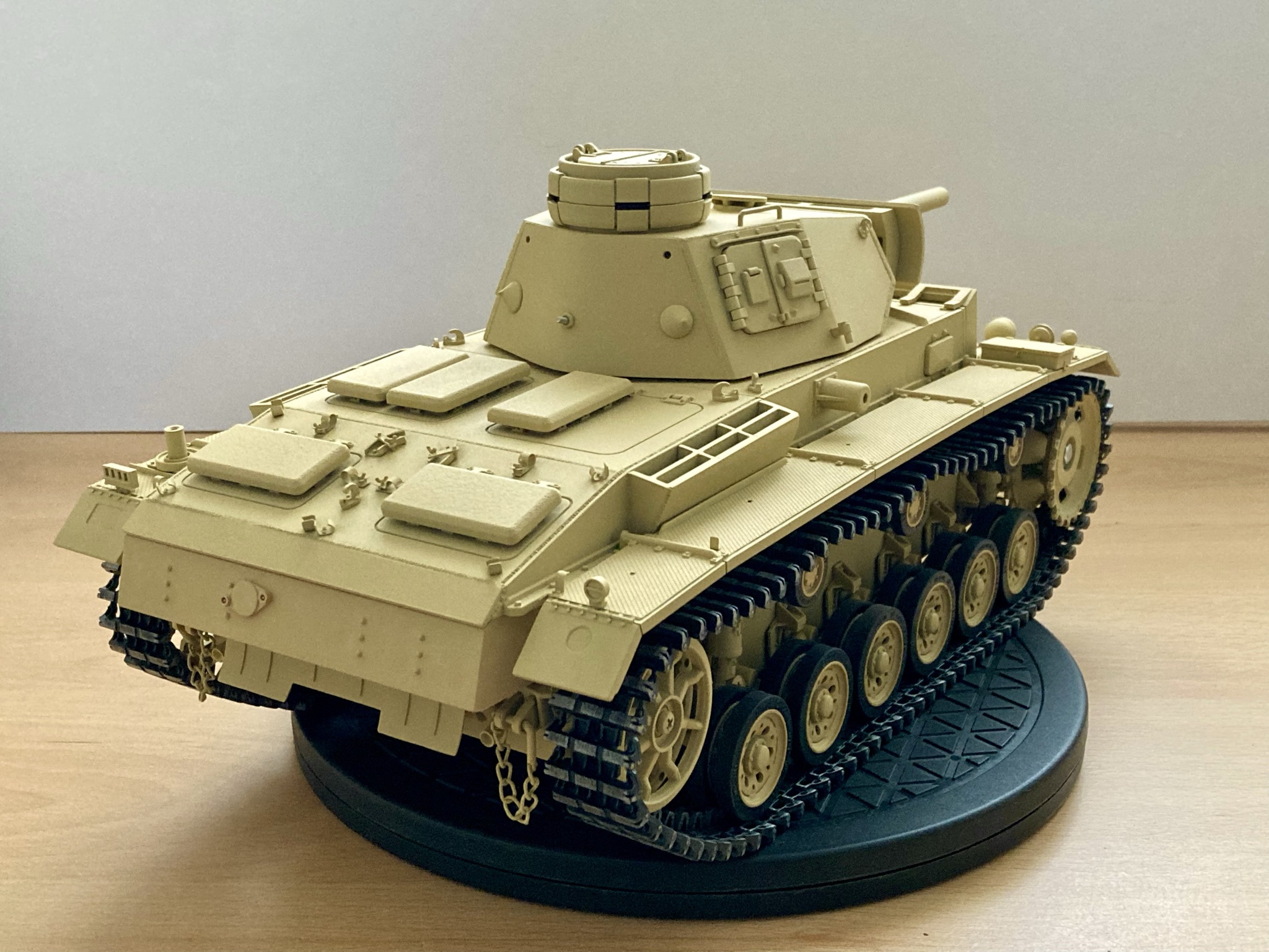

Applying The Primer & Base Coats To The Tank:
The primer & base coat was applied before the model was assembled.
I’ve used AK Grey Metal Primer for all the metal parts & AK Grey Plastic Primer for the plastic parts.
Next a light coat of AK German Grey, followed by a base coat of AK Dunkelgelb (DAK Dark Yellow) - Ref: AK1023.
With the base coat applied any imperfections are more apparent, these are then rectified before any further paintwork is applied.
Turret+Hull LHS
Turret+Hull LHS
Turret+Hull RHS
Turret+Hull RHS
Turret LHS
Turret LHS
Turret Rear LHS
Turret Rear LHS
Turret Rear RHS
Turret Rear RHS
Turret Top+Gun
Turret Top+Gun
Turret Front LHS
Turret Front LHS
Turret Front RHS
Turret Front RHS
Turret Front+Gun
Turret Front+Gun
Tank LHS
Tank LHS
Tank RHS
Tank RHS
Tank Rear RHS
Tank Rear RHS
Tank Front LHS
Tank Front LHS
Tank Rear LHS
Tank Rear LHS
Tank Front RHS
Tank Front RHS
