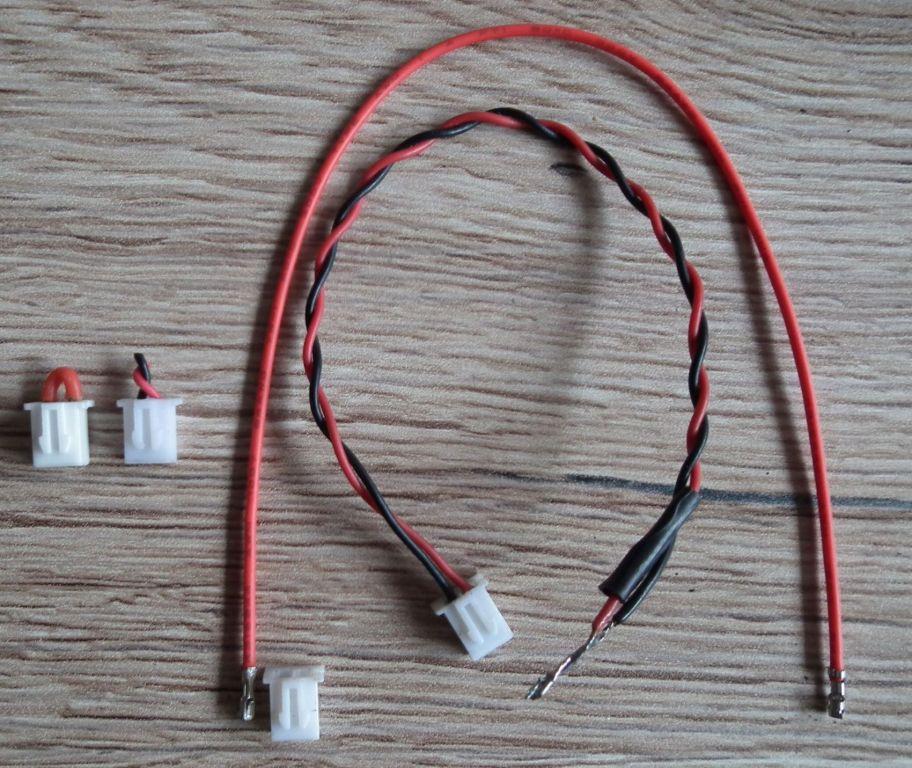

Is it really so hard to make such a jumper yourself ???
For example, such as:
It only takes a few minutes of work and costs almost nothing ( OK maybe a few cents ).
When I know the price you are willing to pay for a set of "original" HL cables, I start to think about producing them myself ... o-
I will do it cheaper and with better quality cables than those from HL :haha:
