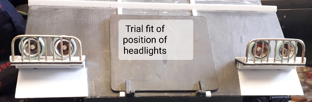

Hi.
Position test for headlights and brackets, nothing glued just held in place by wires and brackets.
Sub.

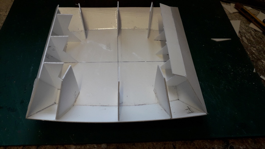

Hi.

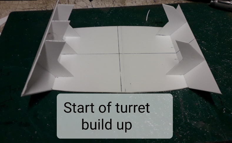

Turret construction.
Due to its complex shape and angular design, was not an easy task.
Sub.

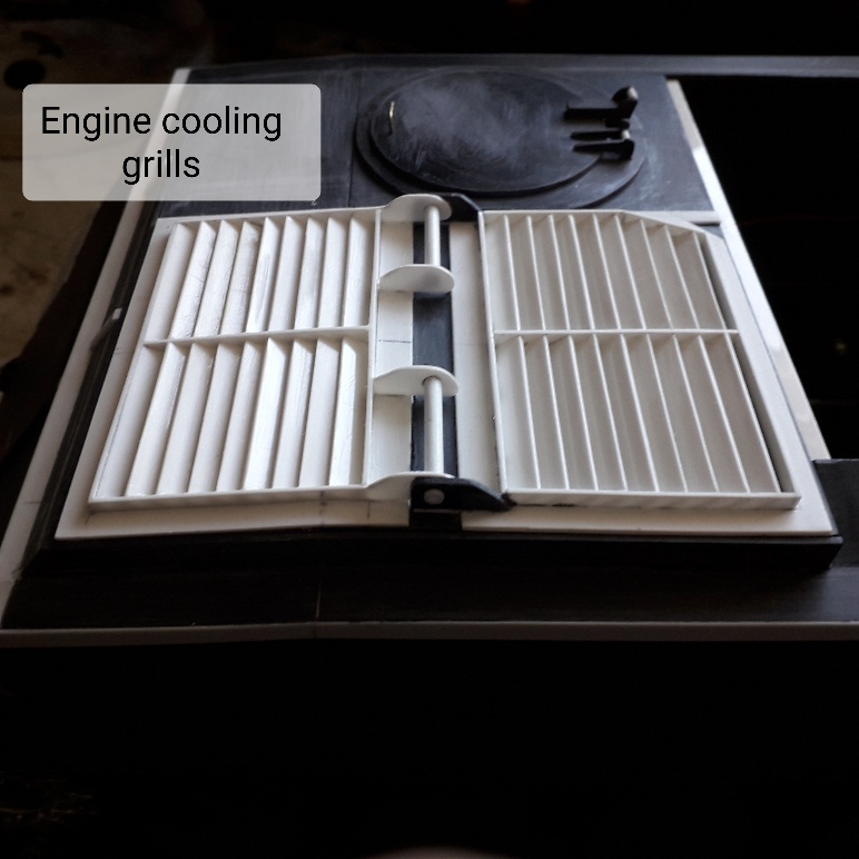

Post by Sub »
Further.
Engine cooling grills added.
Sub.

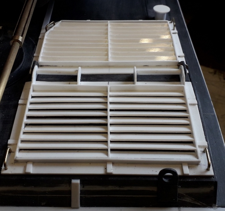

Sub
Posts: 732
Location: UK
Re: British FV432/30 Bull dog

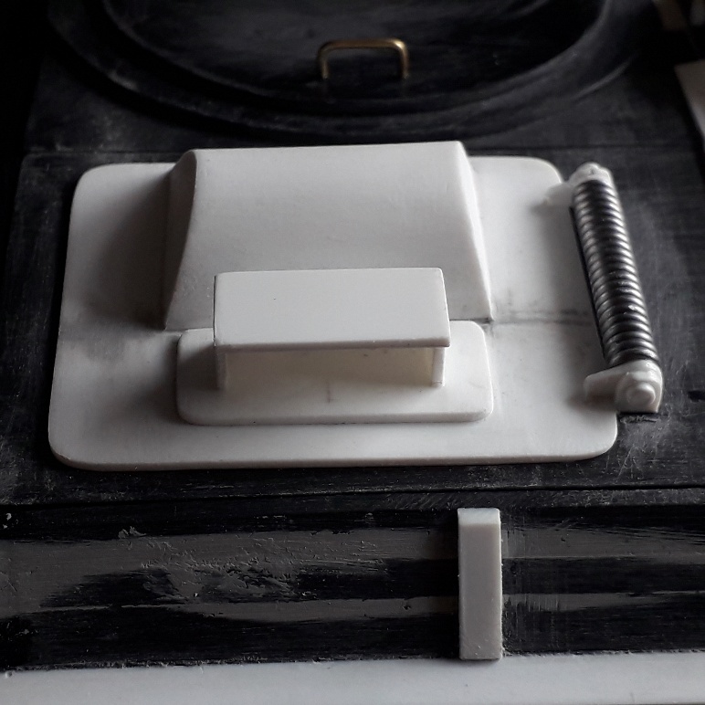

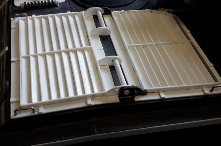

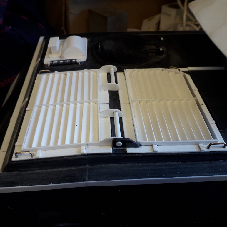

Post by Sub »
Further,
More work on the engine grills plus drivers hatch.
Sub.

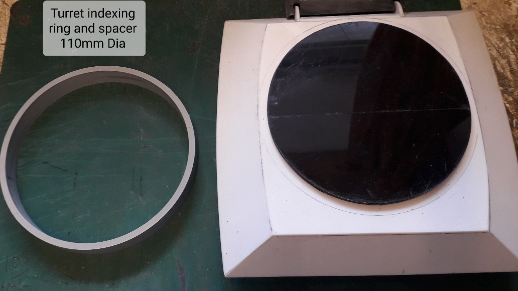

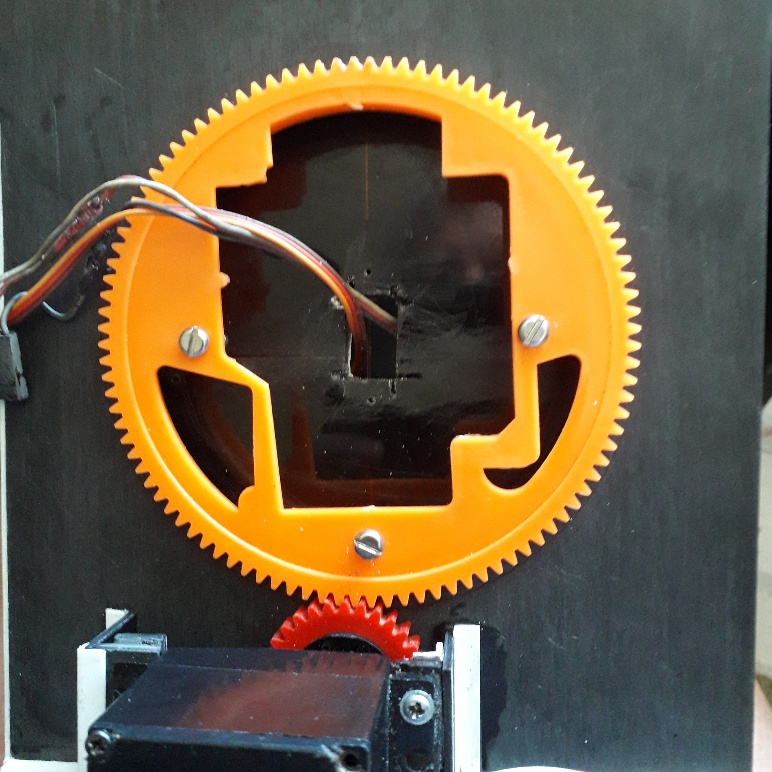

More.
Turret indexing ring added plus turret spacer as the turret is raised up off the upper deck on the FV432
Turret rotation Futaba FPS148 servo modified for 360 ° and output gear added to modified heng long turret ring to give full 360° rotation.
Sub.

Further.
More work done on the engine grills plus hull lifting eyes added.
Sub

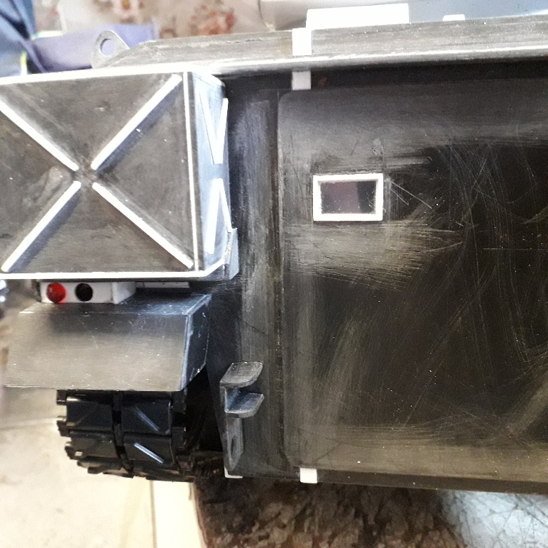

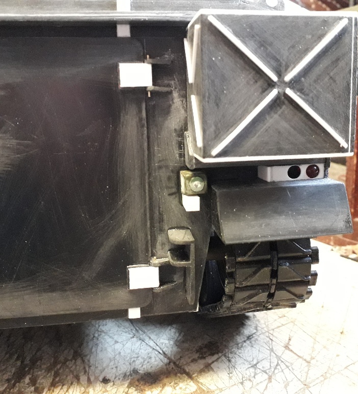

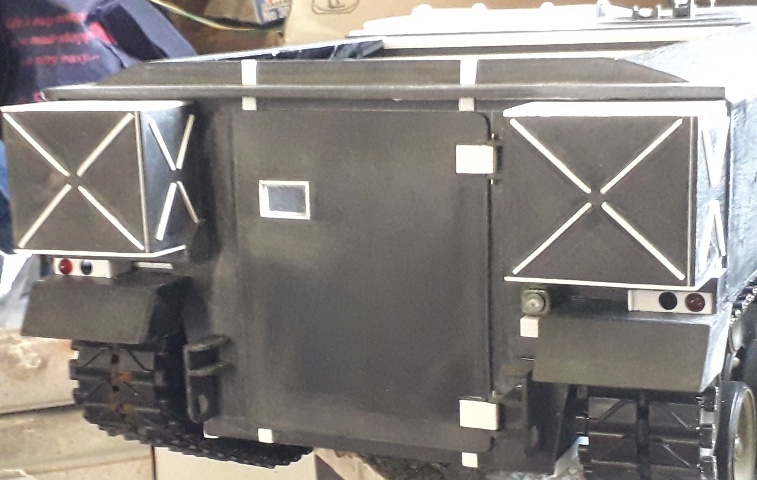

Post by Sub »
More pics.
This time the rear of the vehicle, troop door added with armoured viewing port, HD hinges, rear towing mounts and track pad holder and offside electtrical outlets plus rear light boxes and temp fitted and unfinished storage bins just to make sure it all lined up and fitted in the space available.
Sub.
