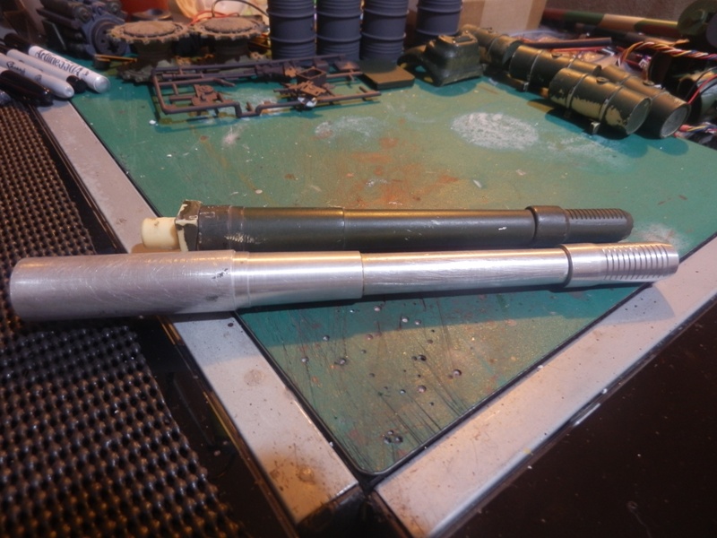

As Ive been trying to finish the R39 Bunker, not a lot of progress here.
But thanks to a Forum Member in The Netherlands, I now have a metal barrel for this "Blunt-Force-Trauma" weapon !
I can say that now this significant & iconic piece of hardware has turned up............GAME ON :D

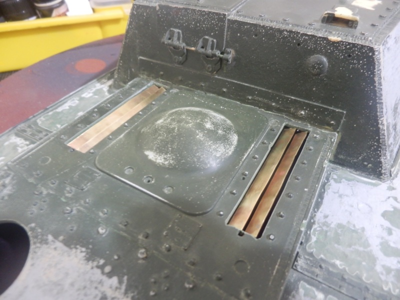

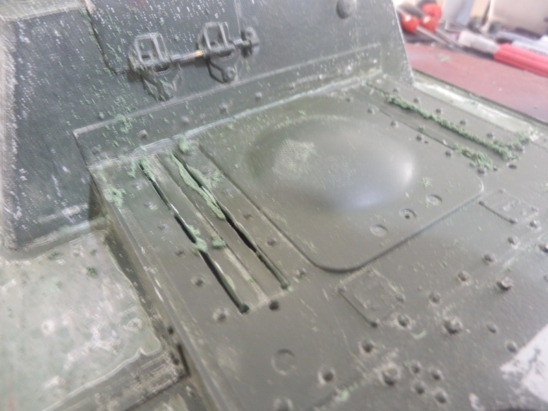

I took a dislike to the vents on the engine deck.
Out with the power tool & away with the H/L plastic.

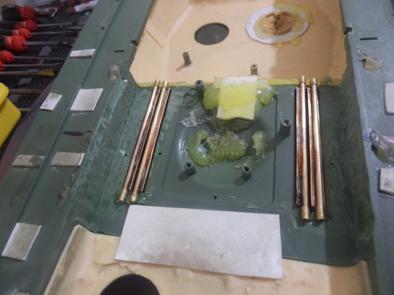

Dressed the opening with a small file then made brass louvers soldered to rod pivots.
These are super glued onto the underside of the deck using telescoping brass tube(thats 'toob' to you left hand drivers!) on each end to allow them to be moved.
very similar to the T34's Ive done.
Once they are set I will make the mesh covers.

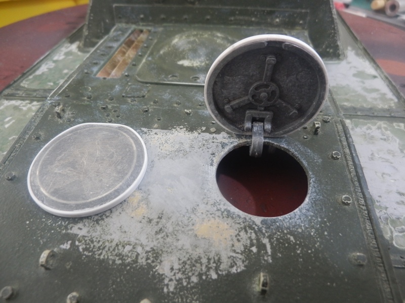

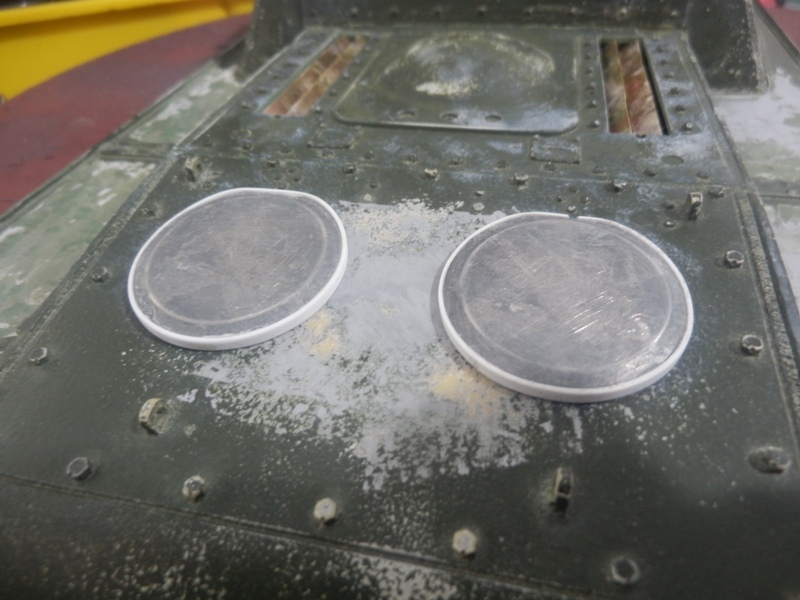

Added rims around the engine deck hatches. Used this styrene superglued around the edges.
Apparently the rims were not flat on the deck side, but always look so due to being squashed from repeated brutal opening.
These will need small recesses drilling into them to look like the key holes.
